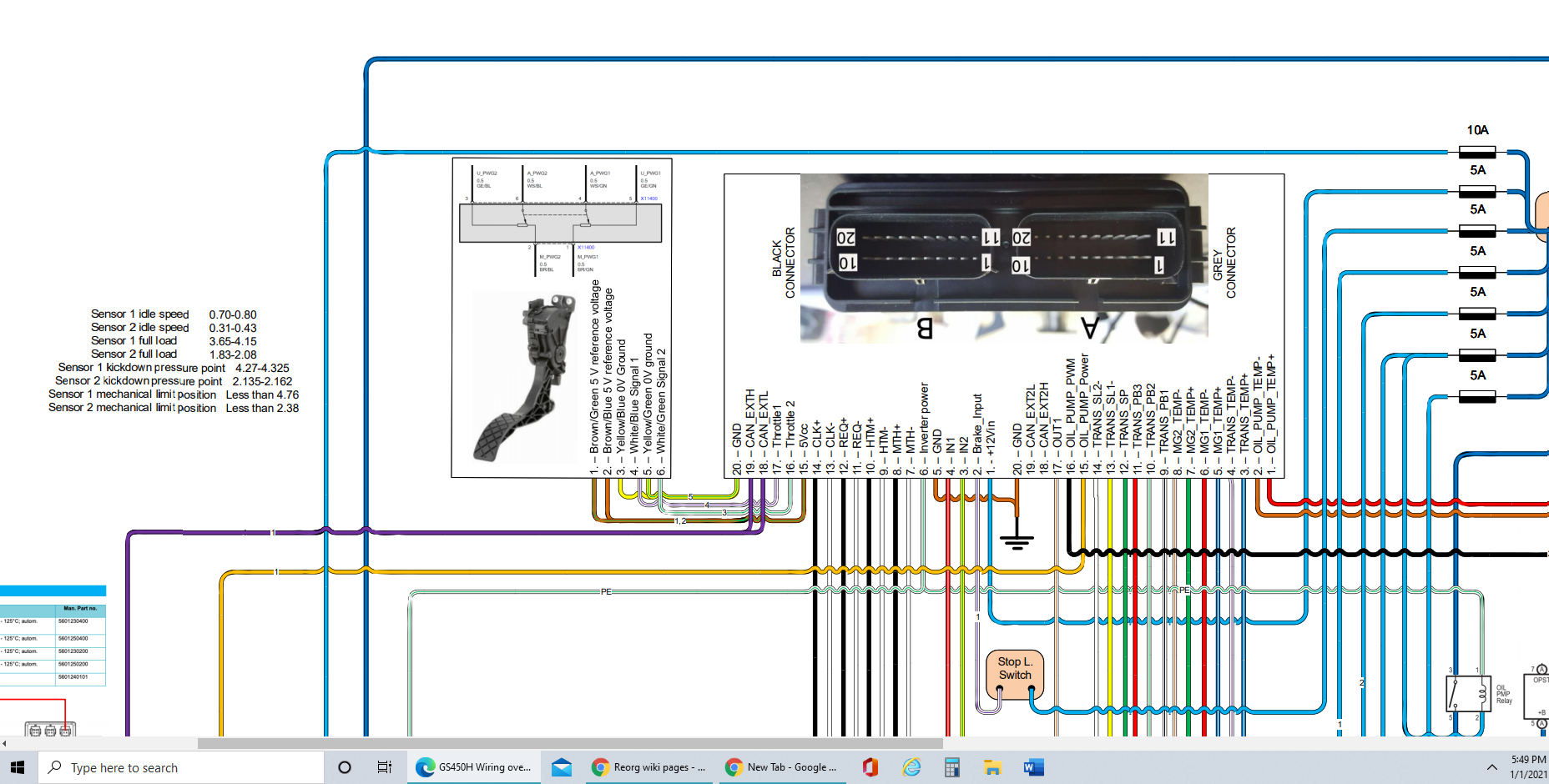

Hi everyone,
started bench test wiring for the 450H transaxle.
I have a question:
from the gas pedal, wire #3 and #5 go to GND pin #20 on the VCU,
Is pin #20 the same as pin #5 GND?

I’ll not had any issues bench testing when supplying the throttle pedal ground via VCU versus another ground. I’ll assume there is a specific reason for the VCU supplying ground versus it being feed elsewhere
- celeron55
- Posts: 805
- Has thanked: 39 times
- Been thanked: 136 times
You want to avoid there being any unwanted current flowing in the pedal ground or 5V wires, as those currents would fluctuate the pedal output voltage. Thus either use a separate ground and 5V pins or split those wires right where they exit the VCU.

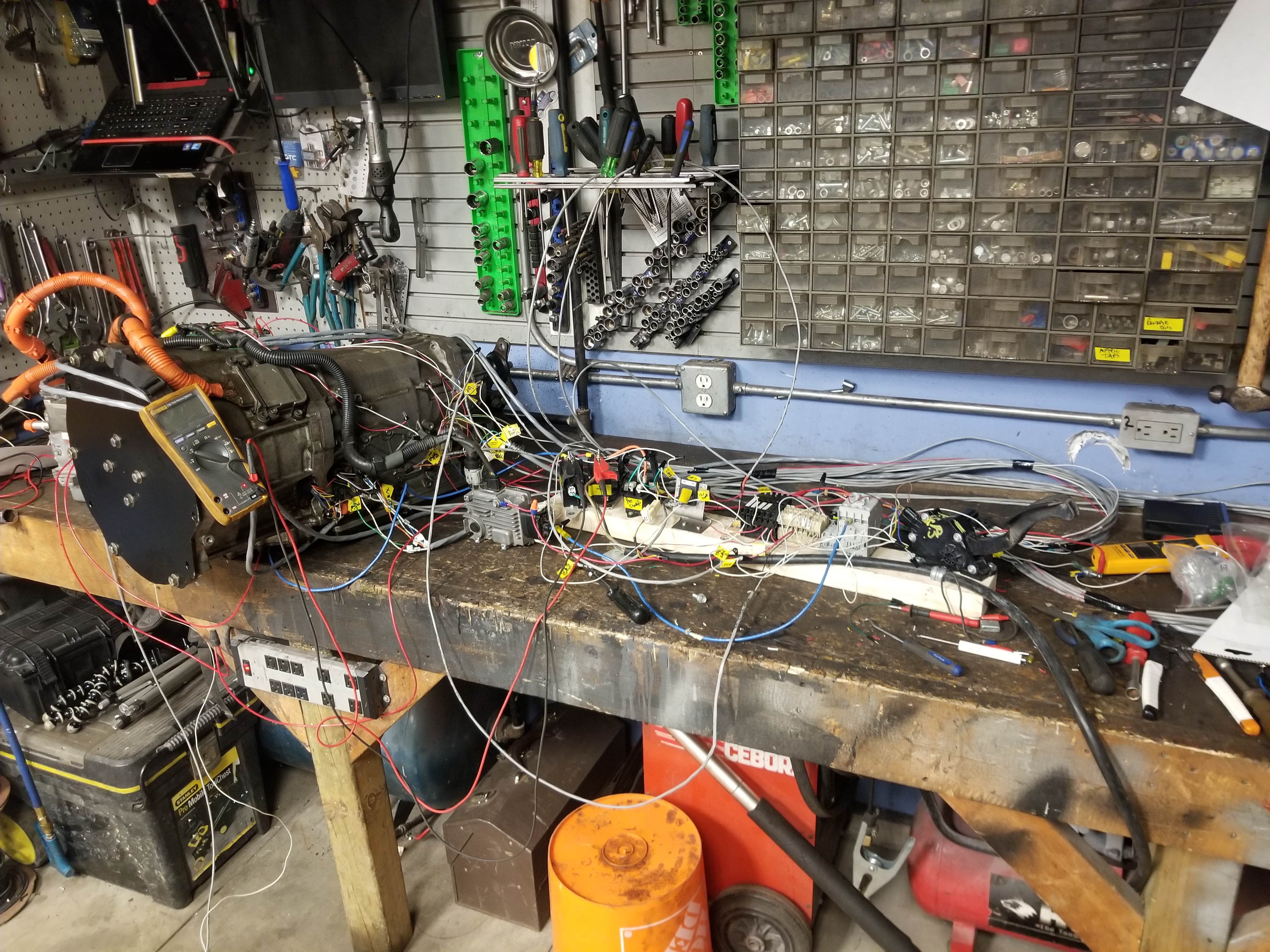

Hello everybody!
I am new to the forum and a gigantic noob so go easy! I have reached a stumbling block with my GS450H vcu and I am crying out for help!!
I have a bench test set up following the schematic v2.4 composed my rrobertjanzen... which is brilliant I might add.
I built Damien's v2 kit and uploaded the gs450h_v7.ino firmware and all the lights are flashing as they should.
I have checked my wiring to the diagram many times and I'm certain its correct.
when I power up VCU the positive contactor closes for maybe 5 seconds then opens... why is this happening it should stay open while the pre charge circuit does its thing... I have changed the pre charge value to 12 in the code also as i'm running at 12v for test.
the pre-charge and negative contactor should close first but they do nothing.
the inverter relay coil is energized for maybe a second before it cuts out so no 12v is getting to the inverter....
It seems like my wiring must be off but I have followed the v2.4 wiring closely... what am I missing? am I not running the most up to date code?
Many thanks in advance!!

Jack do you have an isa shunt connected? This is how the vcu reads voltage, current , power and stuff like that.

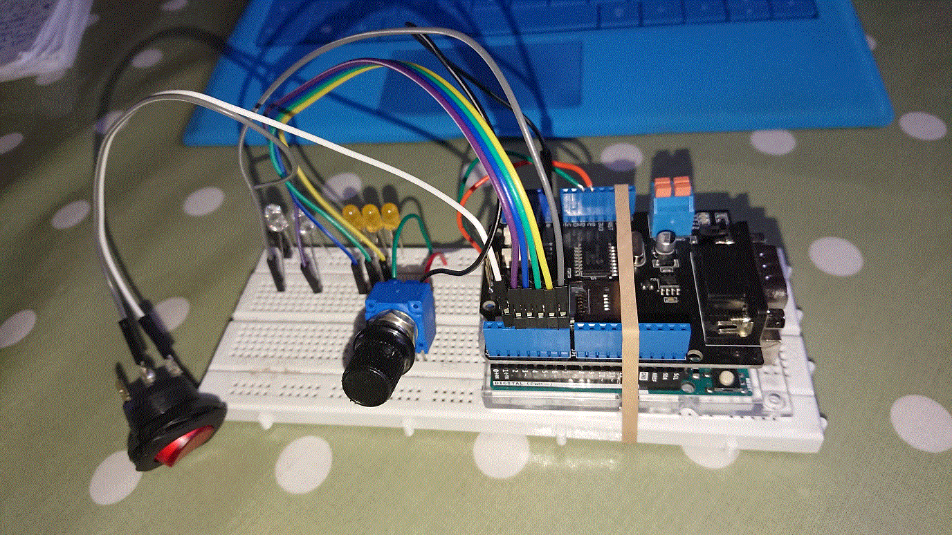

JackK and TonyV, just checking, if using V7 of the GS450 code, are you doing anything to accommodate the CAN messages that code is expecting to receive for the BMW E65 it was intended to work with?
Just recently got my GS450H setups running on the bench. Started with V3 and some light mods to get the motors turning and prove the inverter/transmission was ok before worrying about the oil pump or HVJB.
Moved onto the V7 code but it needs to see some CAN from a BMW E65 to fire up and get gears selected etc. Maybe you've addressed that. I Just put together a basic arduino sketch for an UNO with a Seeed Studio CAN shield to mimic these, ignition on, gears.

Put up a quick video, might help. Switch for T15 or 'on', pot for rotary gear select - P-R-N-D.

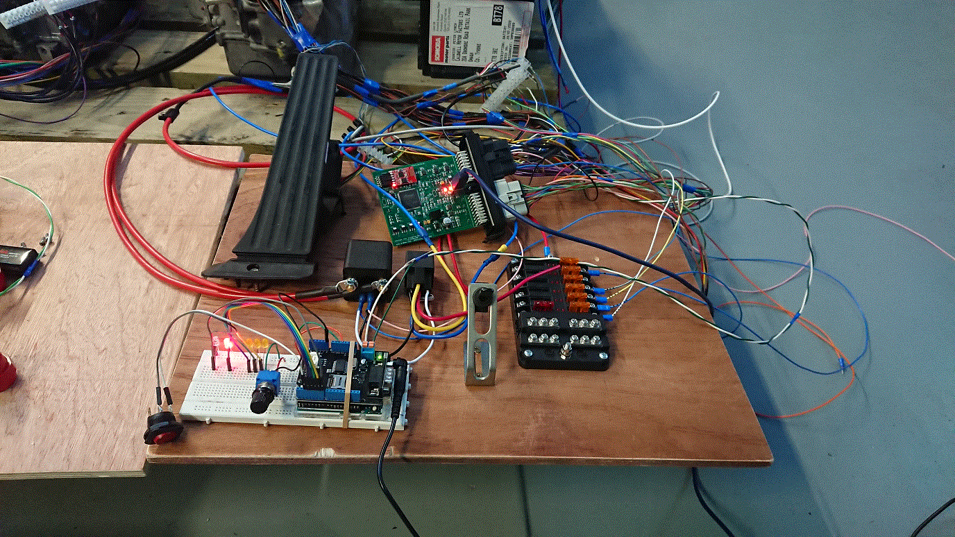

That is news to me...are you doing anything to accommodate the CAN messages that code is expecting to receive for the BMW E65 it was intended to work with?
I purchased my VCU from Damien about a month ago, thinking I wouldn't need to deal with programming at all.
But I did have to do your fix to get the MG2 RPM back to zero from constantly reading 9000. (That was a nightmare trying to figure that out)
I personally don't know how to check the version that is on the VCU but I would assume it would of been the latest version.
would you be willing to share your code.
I would be happy just to see the thing turn.
here is my disaster

Absolutely, no issue sharing what I have and trying to help. I know there are a few of us at the early stages with the GS450H kit. It'll be tomorrow before I get to the computer, so hope that's ok.
