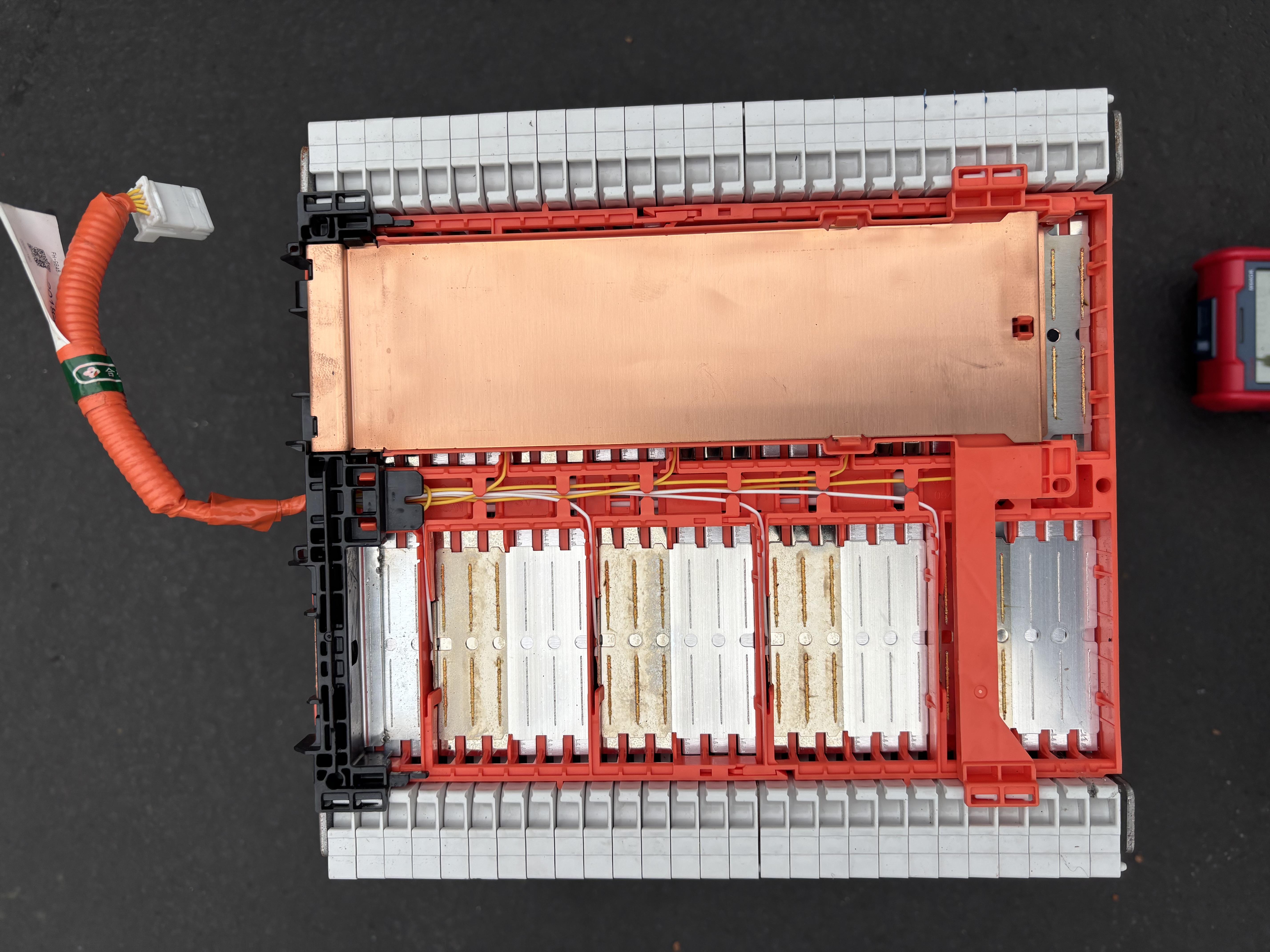

I did consider this, and decided to completely rewire the harness that contained the cell in question. I replaced the Orion connector with a new connector and all 36 wires that go to the cell taps with tinned wires. It didn't fix the issue. The only accessible thing that I didn't replace was the Nissan connector that brings the cell taps out of the module. Here it is pictured. The last thing I can think to do is bypass this connector on the neighboring cell tap to the cell in question (the cell in question is tapped by a physical spade connector that I have previously replaced). I will bypass the neighboring cell tap with a solid wire and see if that fixes the issue, but I doubt the factory Nissan-crimped connectors are the culprit. Any other ideas?Another thing... did you consider your BMS wiring is not correctly assembled?

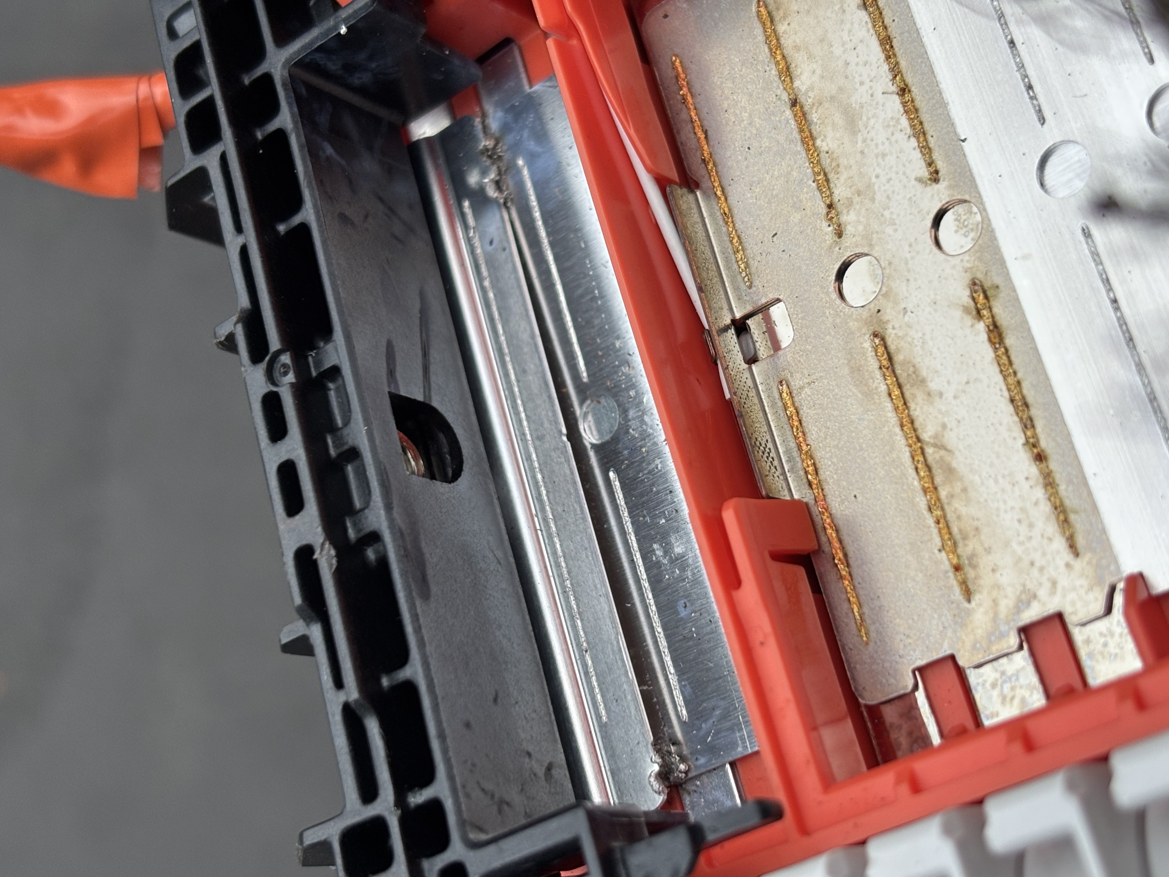

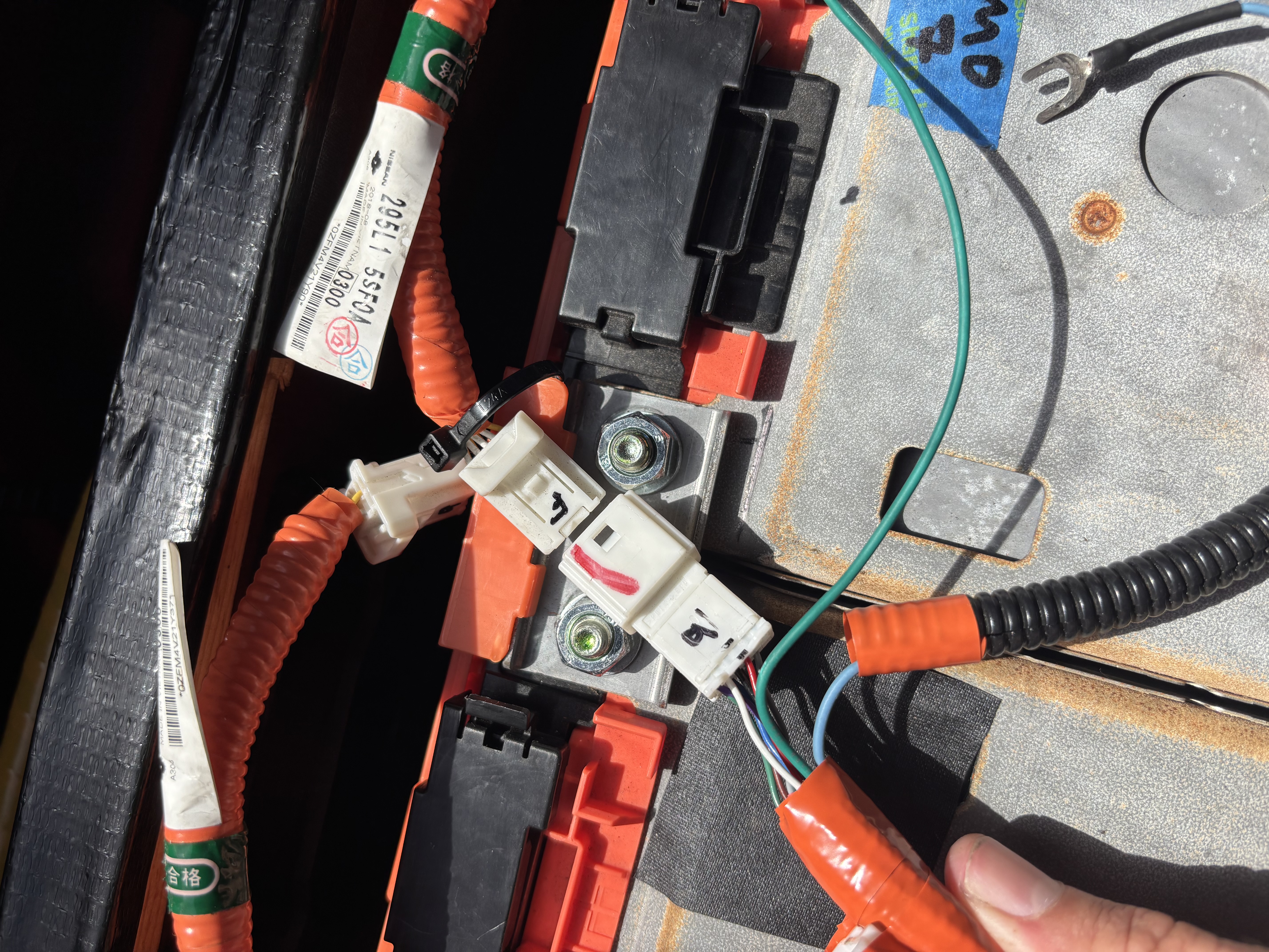

I decided the module itself needed a visual inspection. I removed the front cover:
When trying to remove the black plastic piece at the top of the upper image, I noticed something. The left terminal is clipped onto the black plastic piece, and when I pulled the plastic away from the module, the area where the terminal was welded onto the cell stack pulled off.
This is most likely what has been causing the intermittent connection issue. I have a traction wire attached to that terminal that was pulling away from the module, and the vibration of the car coupled with this pulling makes a strong case for it being the culprit. I'm going to post in the Nissan section for any ideas on how to fix this connection. Thank you everyone!
