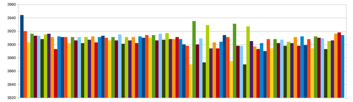

It looks like the pack is actually quite well balanced. The low and high voltages that stick out are right next to each other. I'm assuming the chips work much like my BMS: they measure 4 voltages in series and arrive at cell voltages by subtraction. So if one voltage is measured too low, the one next to it will measure too high. I guess I have to check my wiring. Only the very first voltage doesn't follow that scheme, will measure it by hand to see whats happening.

Re: Nissan Leaf BMS
Alright I took the plunge and measured all 96 voltages with a multimeter. Little surprise, the variation isn't nearly as large as the BMS suggests. Lowest voltage was 3978mV 3878mV and highest was 3904mV, so 26mV delta, not 70mV.
I'm thinking there are some weak connections in my adapter cable that cause a voltage drop. The LBCs inputs seem to be fairly low impedance, so these weak connections don't show up on the multimeter. The BMS might also notice an unusual voltage drop when trying to balance.
Will go over the adapter cable once more and see if I can get some valid numbers.

Re: Nissan Leaf BMS
Today I took a left over pin and put it into each of the "jacks". Most jacks will hold on to the pin so it doesn't just slide out. But some jacks did not hold on and the pin can just slide out. This will also cause bad contact, I suppose. I must have damaged them when I pushed them back out with a sewing needle because they were in a wrong slot.
I'm hoping when thats repaired I get valid readings and no more errors

Yes I used these.
Finally: success!! The DTC is gone, I get a valid charge and discharge rate and I'm seeing one balancing flag
So the problem actually was my unconcerned way to pull wrongly populated pins from the connector. as I couldn't pull them out the back without ripping the cable out I decided to push them from the front. Which worked, but also bent the little spring that actually makes contact. So I tested each jack as described above and removed all those who were loosy-goosy. Bent the spring back, plugged back in - joy
Cell voltages 1 and 2 still read a bit high (3940mV instead of 3920mV) but it seems close enough for the LBC not to treat it as an implausibility. I know this derivation will cause early charge termination and mis-balancing further down the line, but for now I'm happy.
