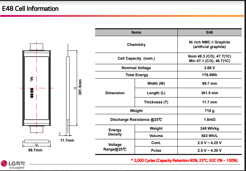

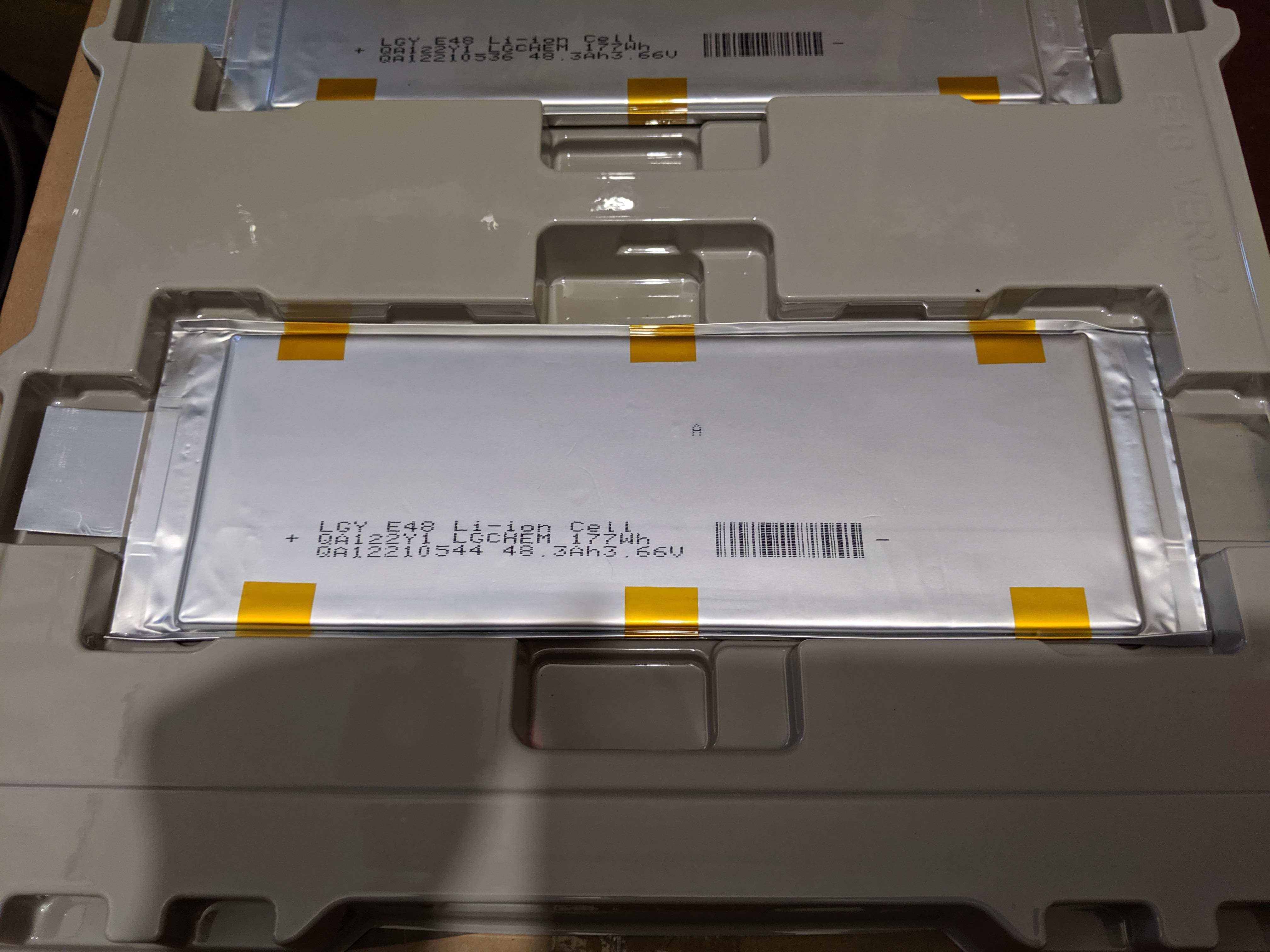

I recently came across some LG Chem E48 pouch cells. The company selling them is an EV car company that is getting rid of some excess stock. These particular cells are new old stock. Look to be around 2 years old.

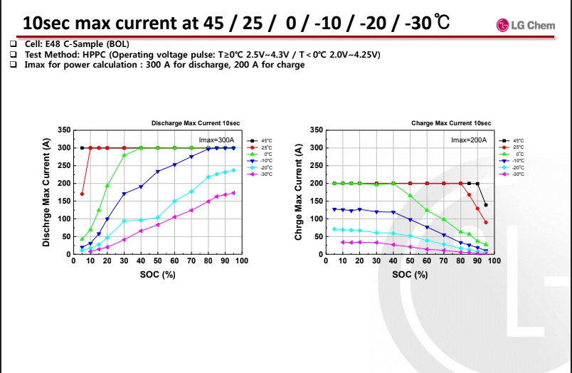

There doesn't seem to be much info about them online but the company did give me the data sheets. The stats on them look pretty good. 300A max discharge, 200A max charge. 1C normal charge rate, but they are 48AH 3.66v cells.
I bought 26 for my quad project. There are 74 left.
They are currently asking £200 for 10 cells. Sold as seen. But for that price they seem very cheap per KwH.
