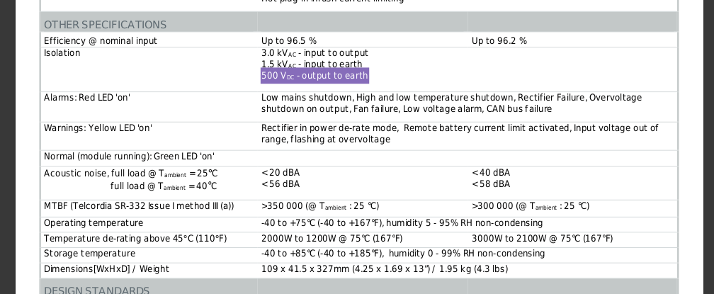

Another option is to use 9pcs of Eltek FlatPack HE2 48V 3000W power supplies connected in series. That will give you 400-518V output voltage and 27kW capabillity or 62A. I run 7pcs for my 96S pack.
Not using this a charger any more.
I just relized that in your case, with that high voltage, it is no longer possible to do it as above. The battery side of a Prius Gen3 can handle 400V. Maybe 470V if you modify/remove the DC/DC.
Re: Wanted: 500V 30kW charger / Prius G3 + logic board ?
The funny part is that I am already building a charger with 9 R4850G2's in series, at 58,5V 3kW per unit gives 526,5V 27kW. But I worry running into unknown safety issues and/or control issues putting so many in series. HV isolation and voltage fluctuations between units for instance. How did you deal with that, do you experience any issues keeping the system stable over the full charge range. Seen any effects of units starting to fight each others CC CV control?

Well, in the FlatPacks case they are specified 500Vdc to earth.
So should be almost within spec with 9 in series.
I have 7 isolated CAN buses, one for each FP to control them. One of the FP are doing the current limitation and the others just tags along and supplies a specific voltage.

It really a problem, charger wise when you need voltage above 450Vdc.
EDIT: No issues with the FP fighting each other. I do keep them within there voltage operating window at all times.

Regarding the CAN-bus, it is referenced to the 48V negative output in order to get reliable communication. When they are connected in series all units have different potential at there 48V negative output hence can-isolators are needed. I do not know if the R4850G2 can better handle all CAN-buses connected in parallel?
I start all FP at 44V, slowly ramp up the "master" to 48V since it can't do current limiting to the set current below 47V voltage. Then slowly increase the 6 "slaves" up to the same voltage as the master and then increasing the master one step, then slaves one step, all while monitoring actual voltages and current.
