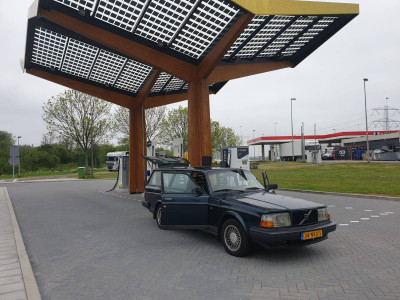

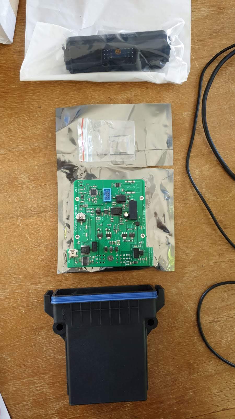

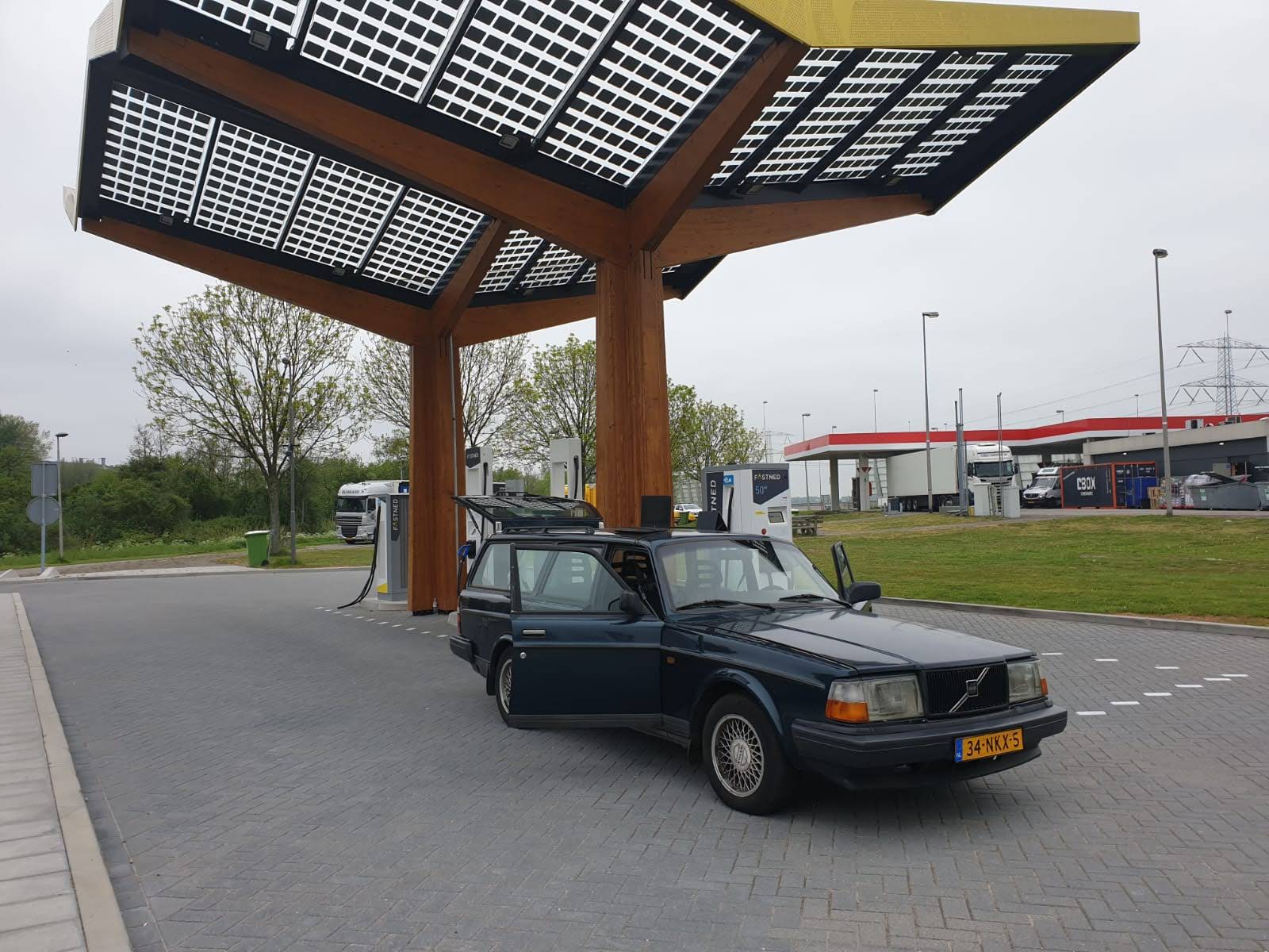

Update 30/10/2019 - NE has released this project as open source and Damien will take it forward 8-)
Some questions have been asked about the CHAdeMO controller used by Damien (here). I thought i'd start a thread with what I know today and then update everyone after the Fully Charged Live Show.
The controller is an updated version of the JLD505 developed by EVTV and friends in 2015. Today it interfaces directly to a number of BMS controllers, has CE tested hardware, and an optional app for configuration.
The controller has undertaken extensive compatibility testing on two vehicles that have been driven around The Netherlands visiting the various rapid charging vendors and operators. The fact it worked the first time for Damien is encouraging 8-)

A small update on this one.
Last week I received the last version of the schematic. That version is even easier to implement / wire up as the previous one.
Cannot say anything about availability and pricing unfortunately.
New Electric is currently sourcing a manufacturer for a first batch of assembled boards.
