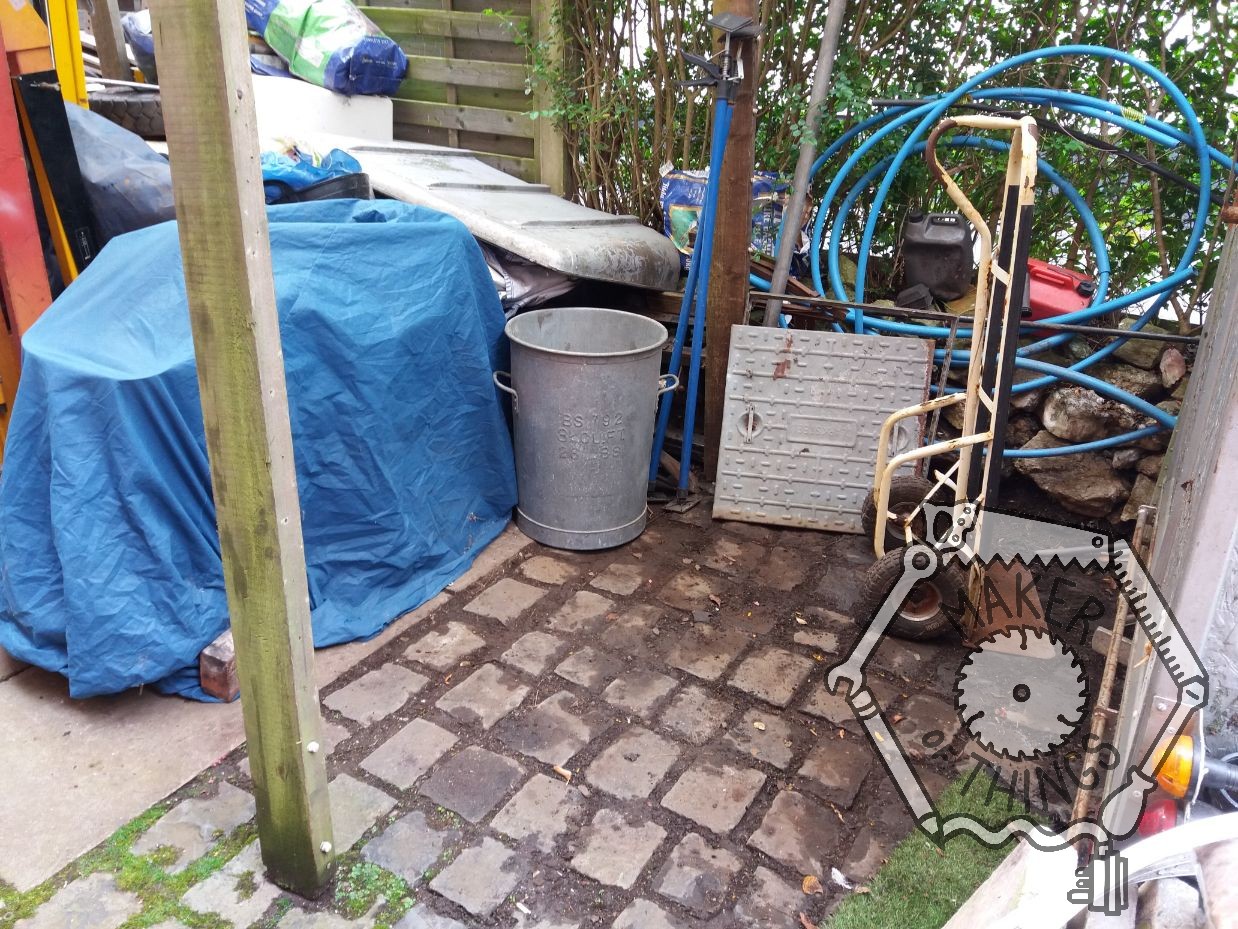

Not the usual sort of Yak shaving one has to do before converting a car to electric but a couple of hours this afternoon, and a couple hours yesterday afternoon, got me a little more paving to work the engine crane and trolley jack on. It will also be cleaner and more comfortable to lie down on too.
Before: After: I only had six of the 600mm squares but I had two 600x900mm slabs so I used them in the middle to extend the 'comfy' zone.
Now I just need to find somewhere to stash this lot! There will be more actual car stuff soon, honest!

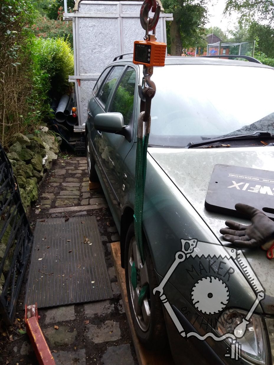

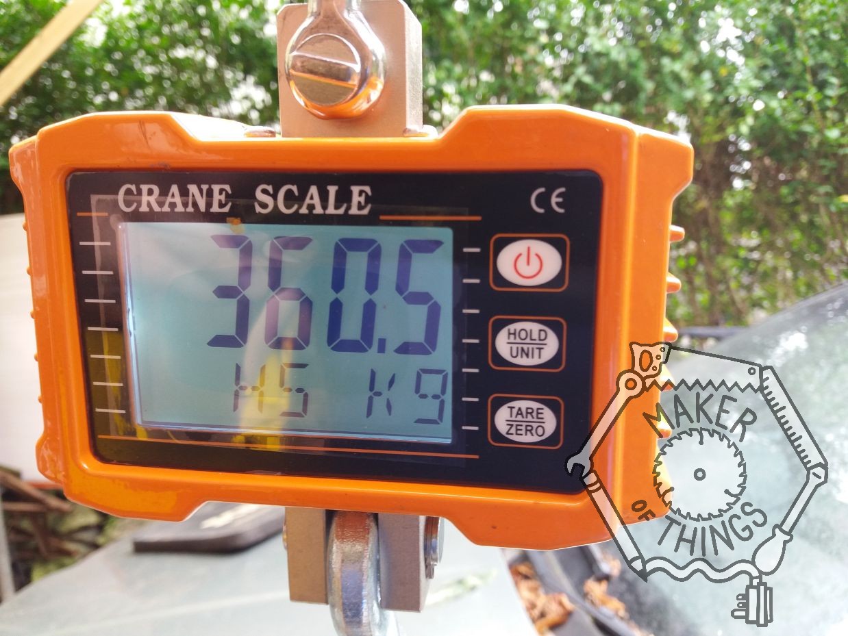

I bought a 1000kg capacity crane scale to weigh the car with.Kevin Sharpe wrote: ↑Thu Aug 20, 2020 2:32 pm If you get a chance can you weigh the car before and after conversion?
I also bought some proper rated lifting straps too, you know, just in case I want to use them for something else...
("Hello, my name is Alfred, and I have a winch addiction....")
Nearside rear: 336.5kg. Offside rear: 283.5kg. Nearside front: 360.5kg. Offside front: 497.5kg.
So total weight is 1478kg.
Front axle weight 858kg.
Rear axle weight 620kg.
That gives a 58/42 split.

Fabulous... it will be interesting to see how the final electric drive conversion compares to the ICE versionMaker_of_Things wrote: ↑Thu Aug 27, 2020 3:05 pm So total weight is 1478kg.
One comment... can you post photos direct to the forum not via a third party website? We're trying to ensure that the forum is readable long into the future... many thanks.

There's going to be some error in those measurements as you have to load the suspension a bit extra to get the wheel all the way off the ground (as the wheel was originally compressed by the weight of the car). I wonder how much.
Or did you measure how much you lift the measured wheel, add the same amount of spacers under the wheel on the other side and then re-measure?

I didn't compensate, and might do it again to check.celeron55 wrote: ↑Thu Aug 27, 2020 6:44 pm There's going to be some error in those measurements as you have to load the suspension a bit extra to get the wheel all the way off the ground (as the wheel was originally compressed by the weight of the car). I wonder how much.
The main difficulty was getting the engine crane into position. The car was too low at the front, and the cobbles and sets around the back made it hard work in the time I had to do it in. The crane is 120kg and quite a bit bigger then the standard Machine Mart crane I used to have.
Anyway, as the car is now on blocks I can find a suitable day and re-weigh it just to check.

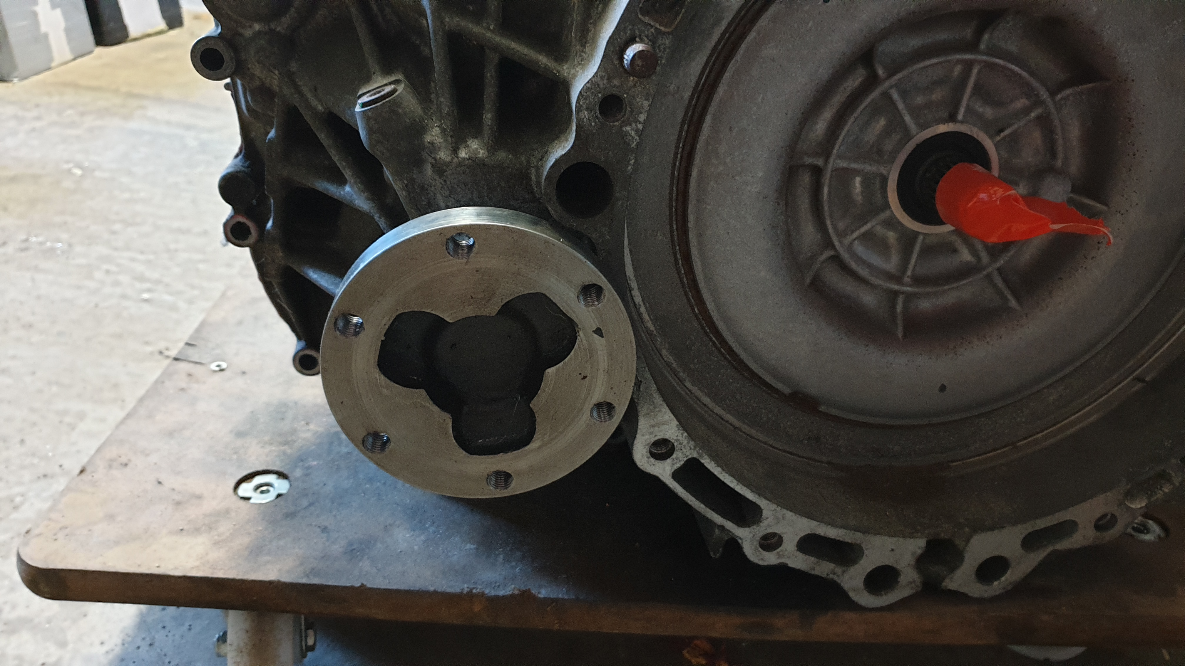

Toyota and Skoda working CLOSELY together:) Picked up the driveshafts and adapters from the machine shop this morning. Talk about a tight fit! I'd need a feeler gauge to measure it but everything spins perfectly:)
- Maker_of_Things
- Posts: 67
- Joined: Sat Aug 08, 2020 8:01 am
- Location: Greater Manchester
Re: Skoda Octavia Estate 2001
They look great!Jack Bauer wrote: ↑Sat Sep 12, 2020 10:24 am Toyota and Skoda working CLOSELY together:) Picked up the driveshafts and adapters from the machine shop this morning. Talk about a tight fit! I'd need a feeler gauge to measure it but everything spins perfectly:)
Only thing is, those are tripod joints, mine are ball and cage CV joints. Does that matter?

Today I decided to split the engine and transmission. It make them smaller lumps to stash on the drive, and I would sell them separately anyway.
Also there is the option to use the transmission with a motor for a conversion.
Anyway, I remembered I have a crane scale! So that is a 221kg oily lump removed from the car.

Pallet of bits to fill that empty space you just made:)
- Maker_of_Things
- Posts: 67
Brilliant, thank you so much, Damien.
Hopefully the courier, next Wednesday, will be able to collect it without too much trouble.
