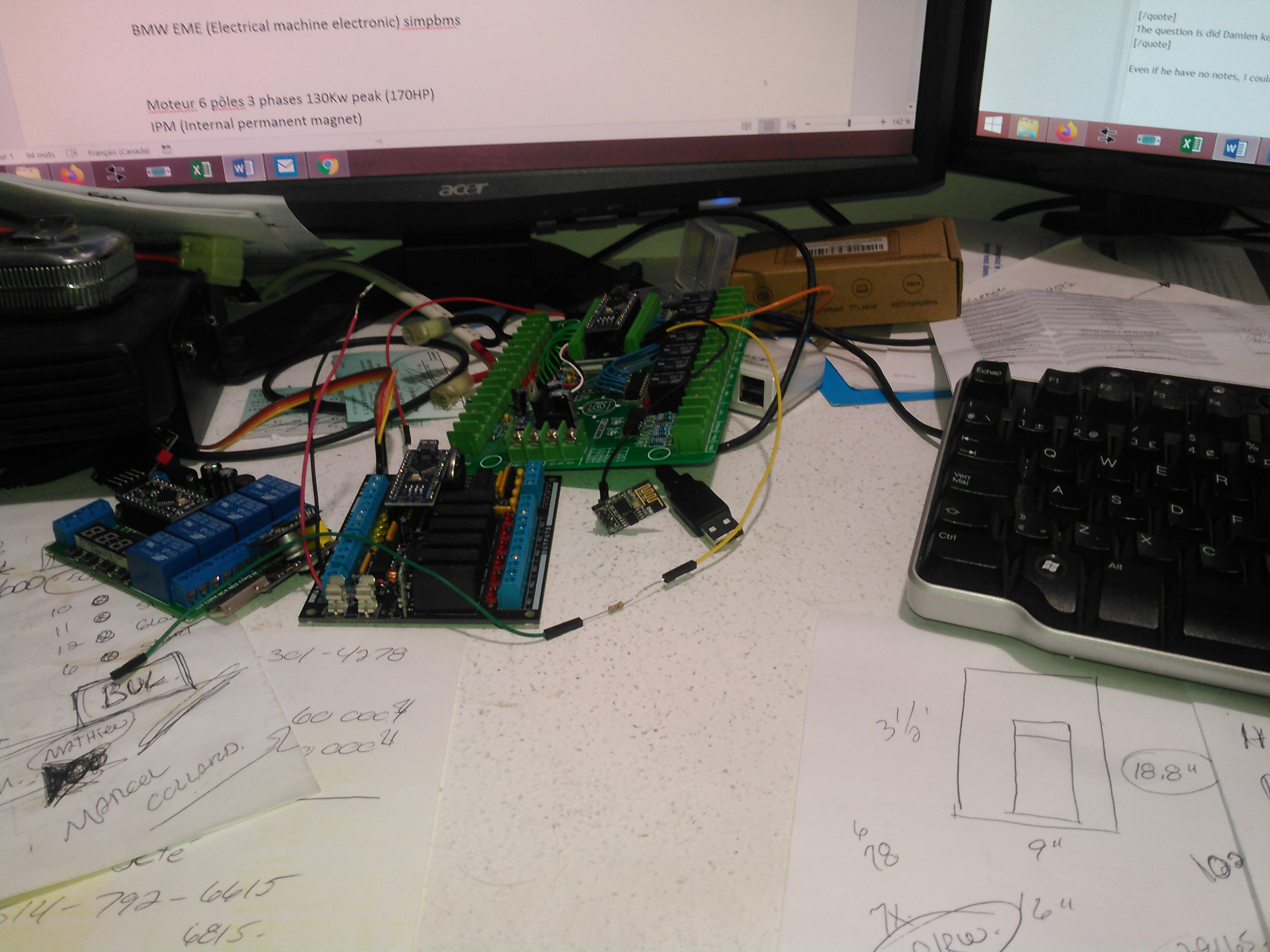

Basically i'm an electro-mechanical technician, with a lots of background in industrial automation and control, I'm now self-employed for the past 6 years working on renewable energy "Design, installation and service of solar system, wind turbine and hydro" http://www.maxenergie.ca. I have my electronic lab "to repair and build electronic stuff", I do play with arduino, ESP, robots as a hobby, I have dismantled hundred's of VFD, off-grid battery based inverter and grid tied inverter... So it should not be a problem...
kiwifiat wrote: Sun Apr 26, 2020 10:59 pm The question is did Damien keep any notes on the gate drive connections for the inverter?
Even if Damien have no notes, I could simply get rid of the power board and use only the power component of the BMW inverter
While I'm typing this... here is a picture of my desktop :D
Thanks for your feedback, it's much appreciated !

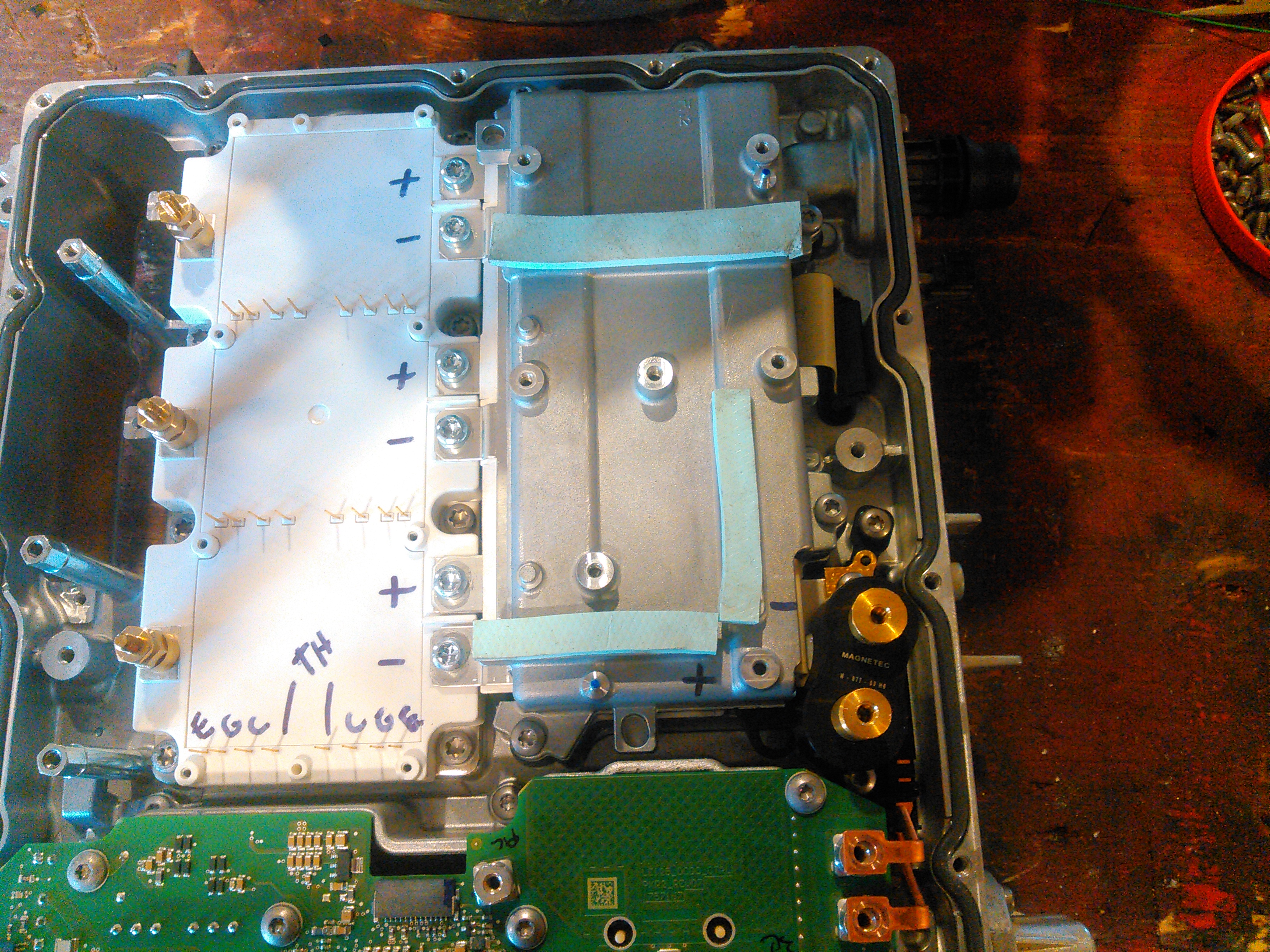

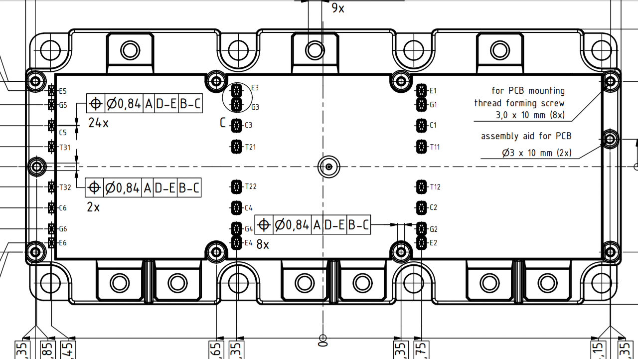

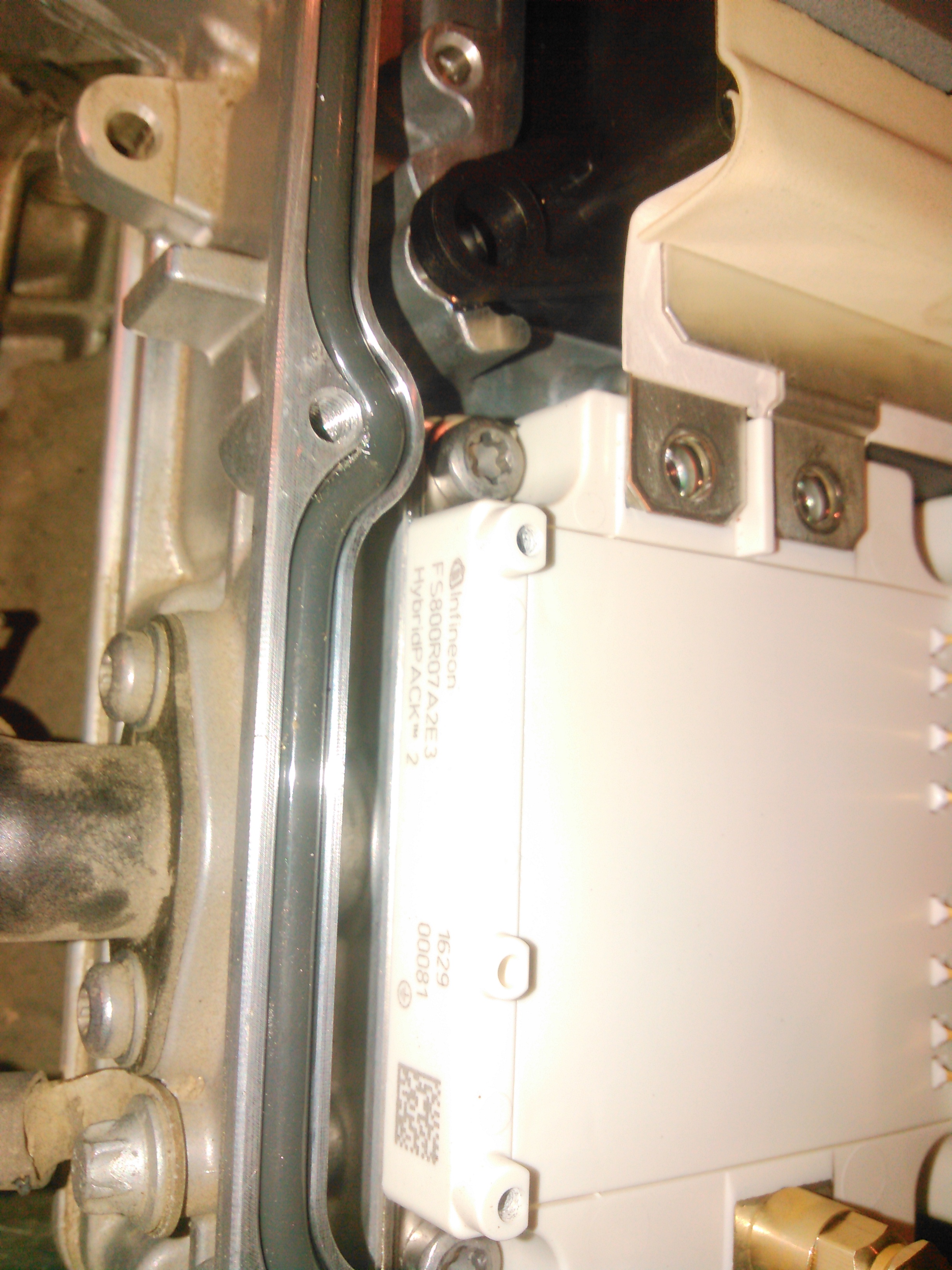

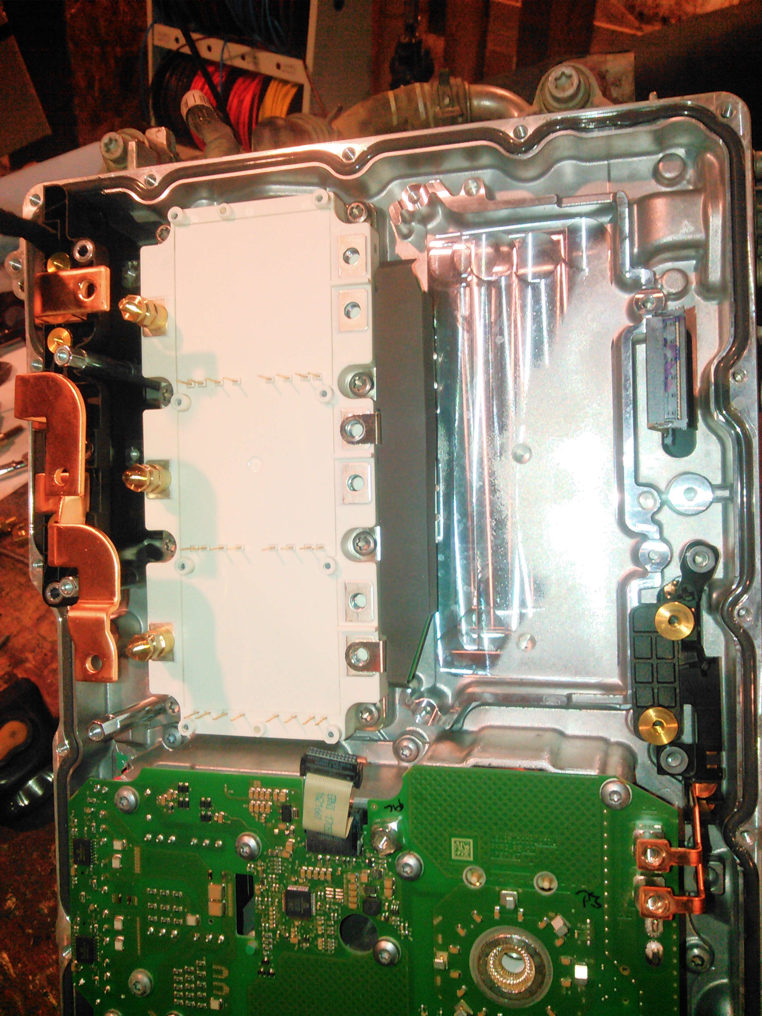

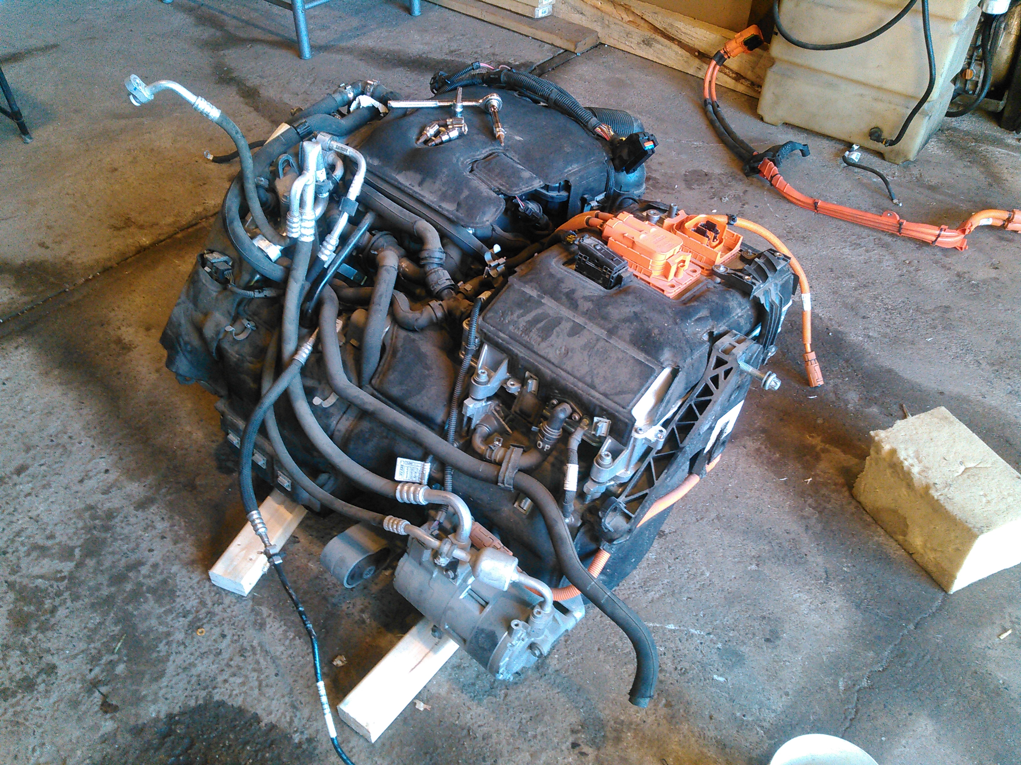

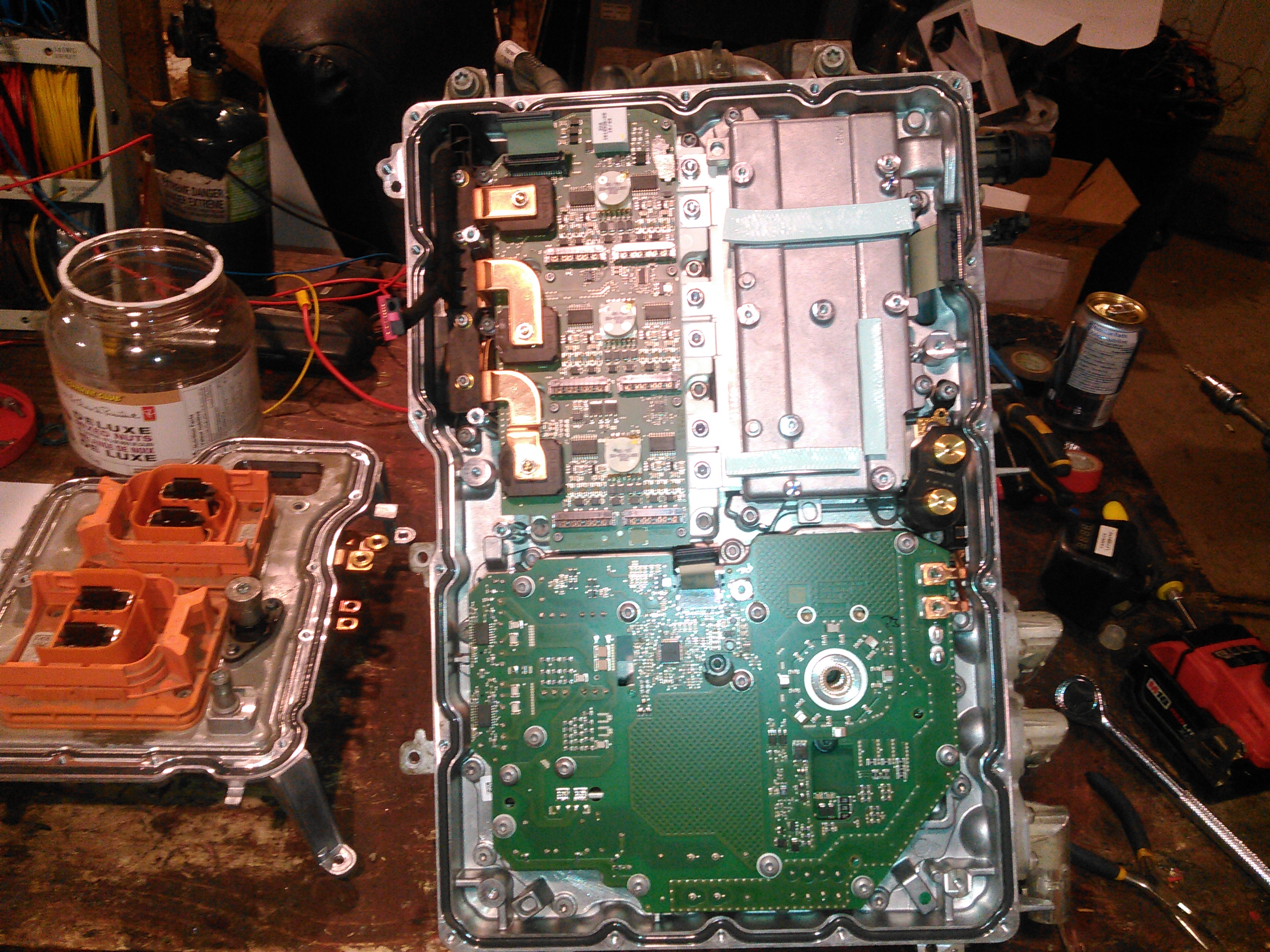

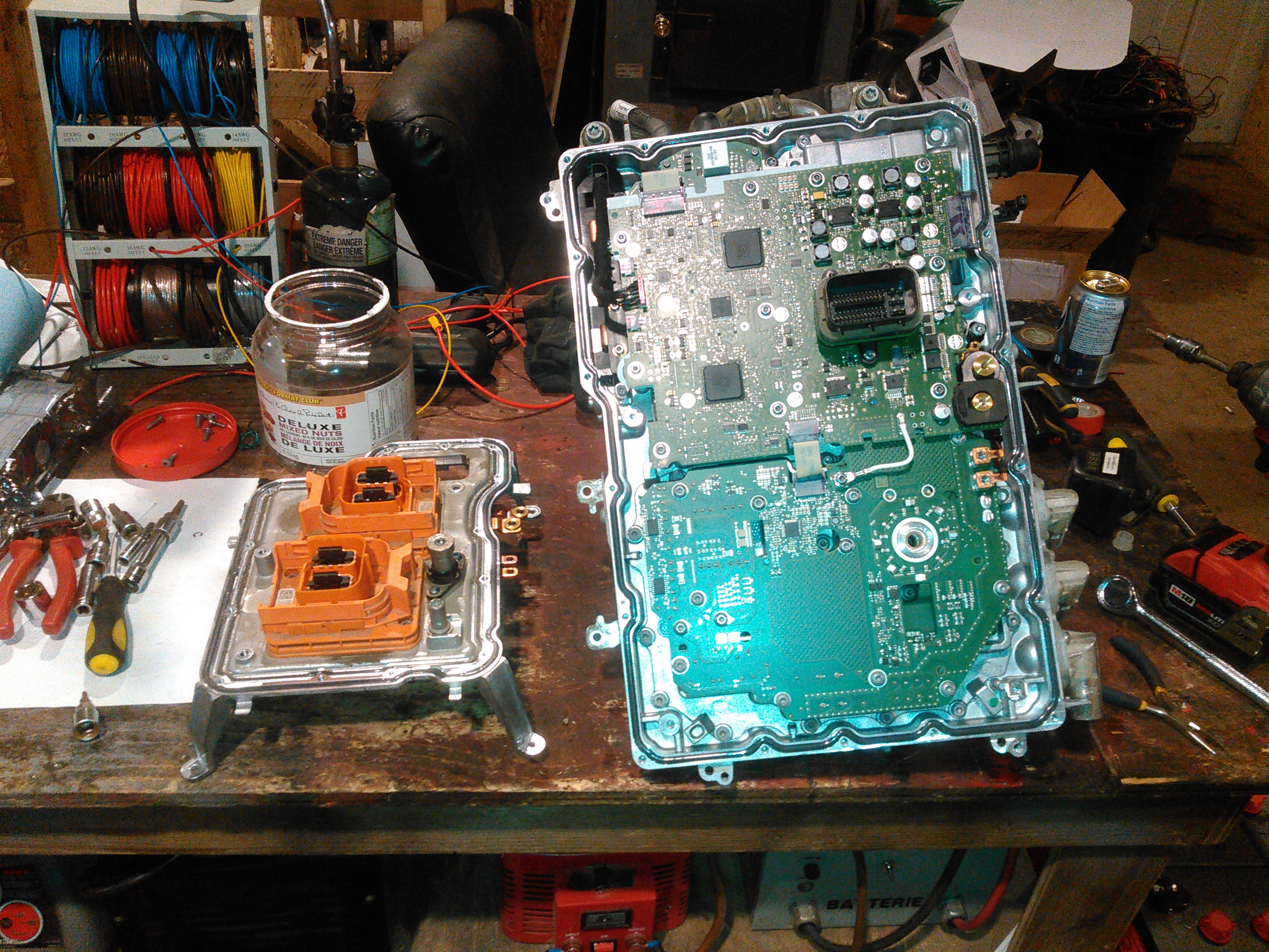

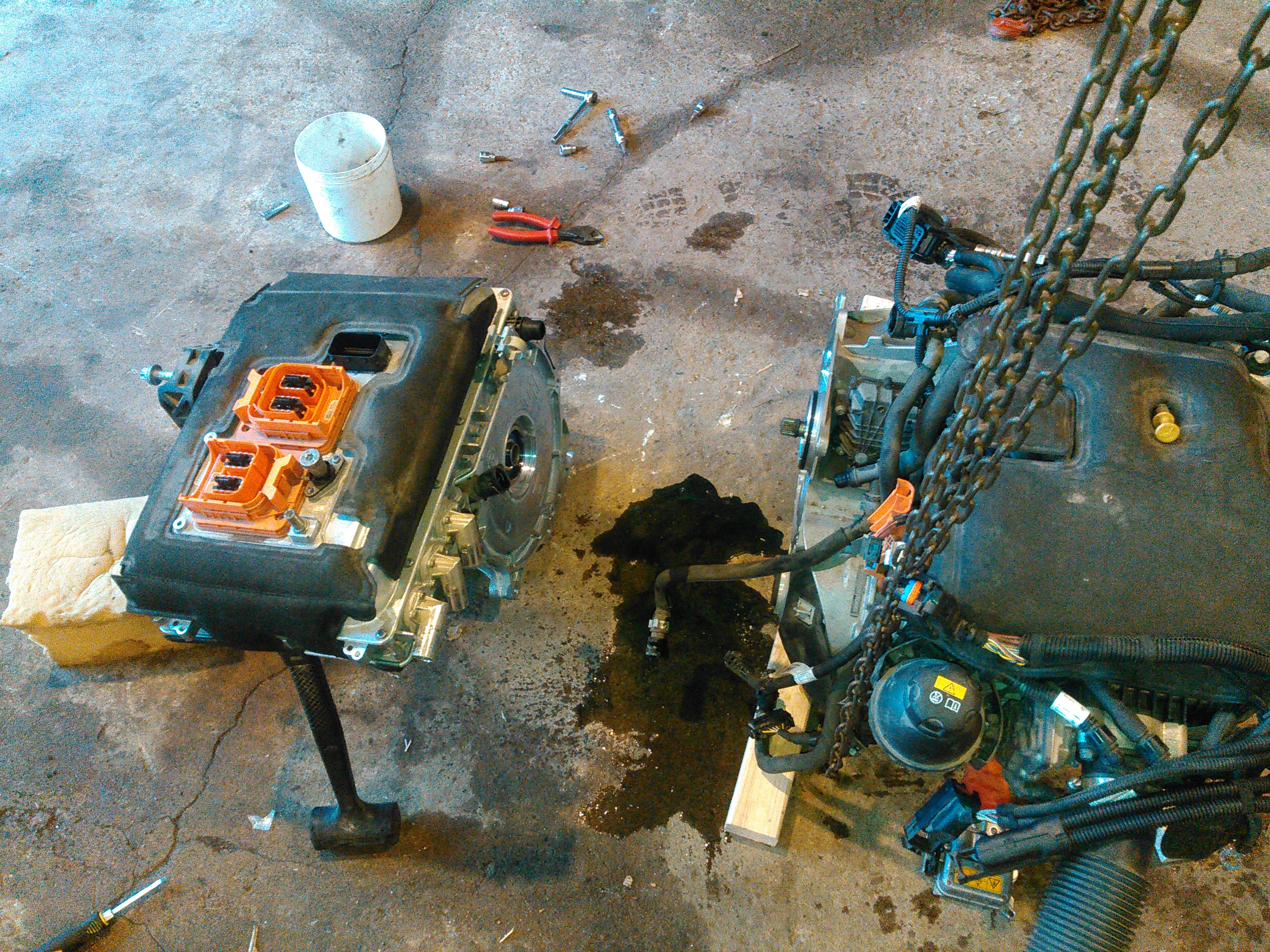

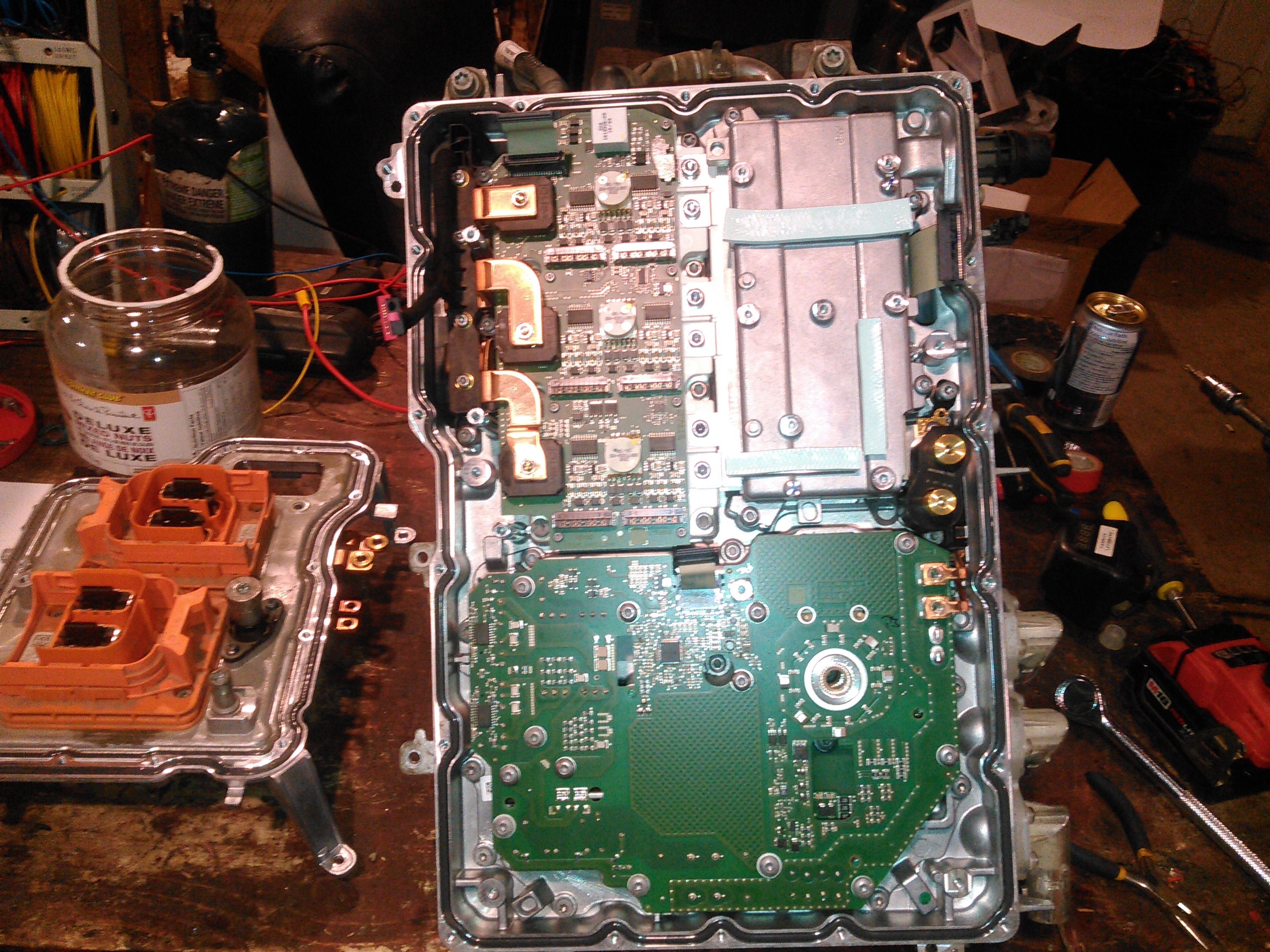

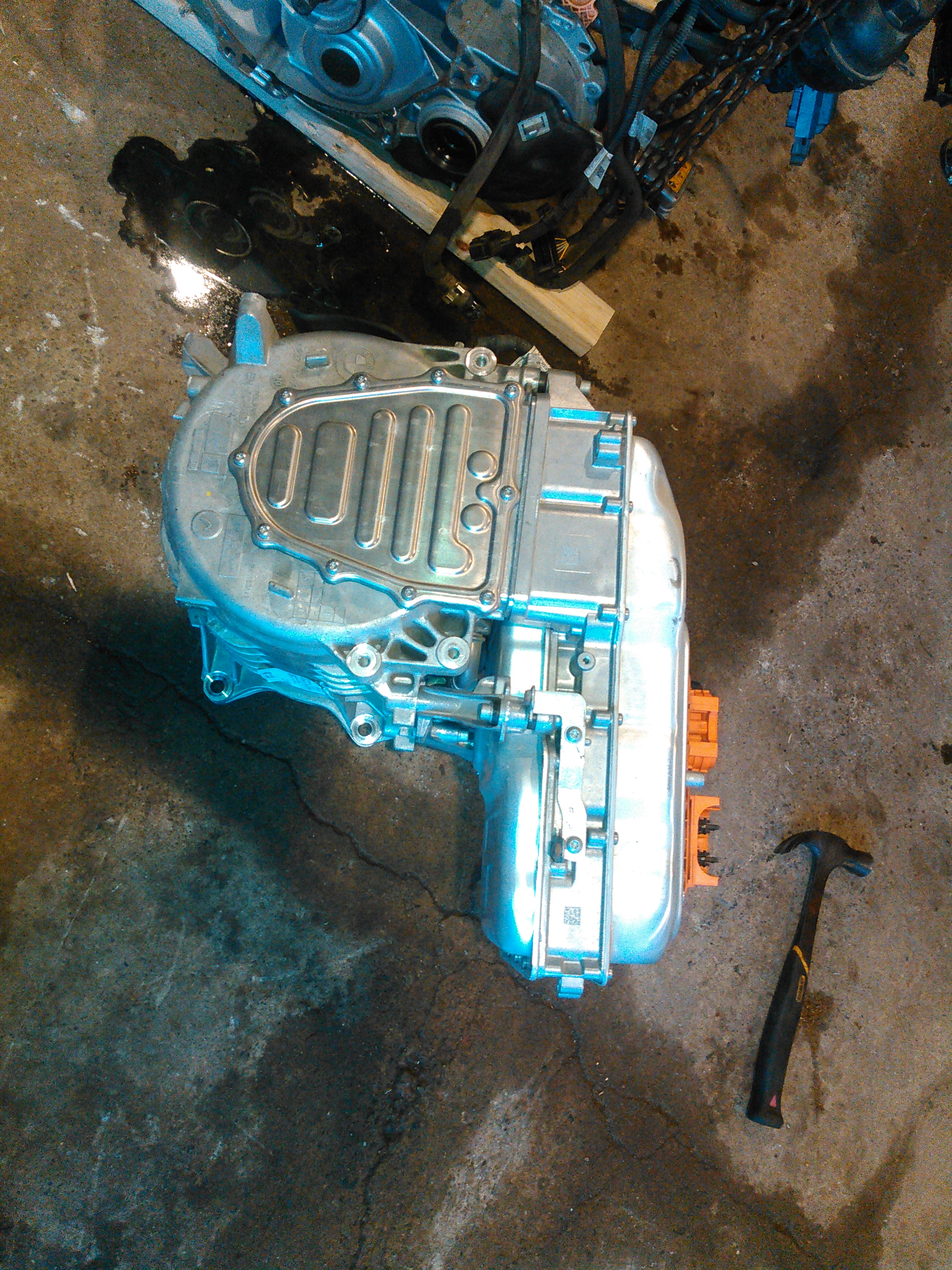

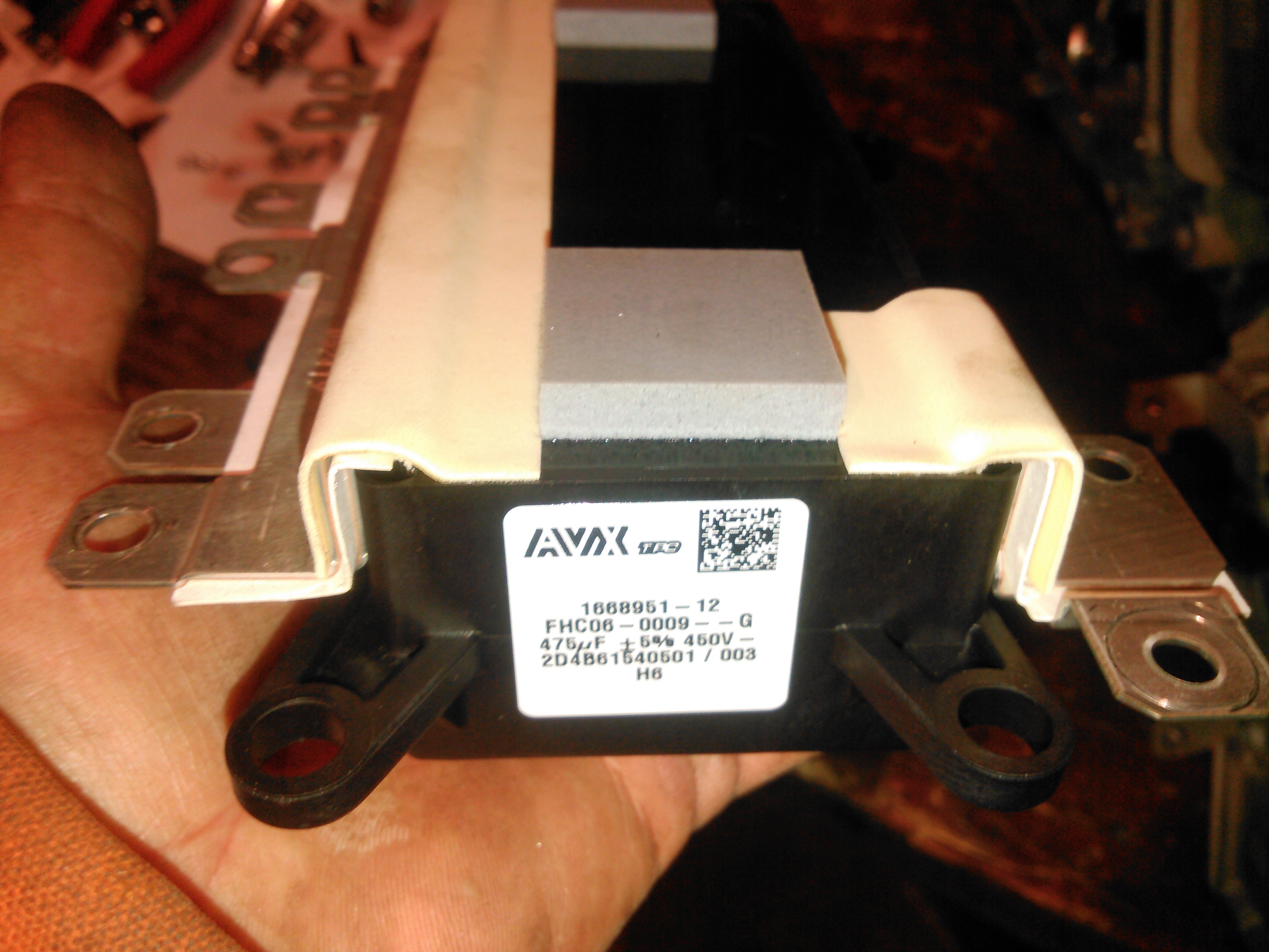

Today we have removed all the guts from the car and dismantled the controller, what a surprise... A single bloc 3 phases IGBT... here is some pictures of the progress
Sorry if some sentences make non sense... I'm French!
lumax
Posts: 57
Joined: Sun Apr 26, 2020 2:26 pm
Re: BMW I3 Project
Post by lumax »

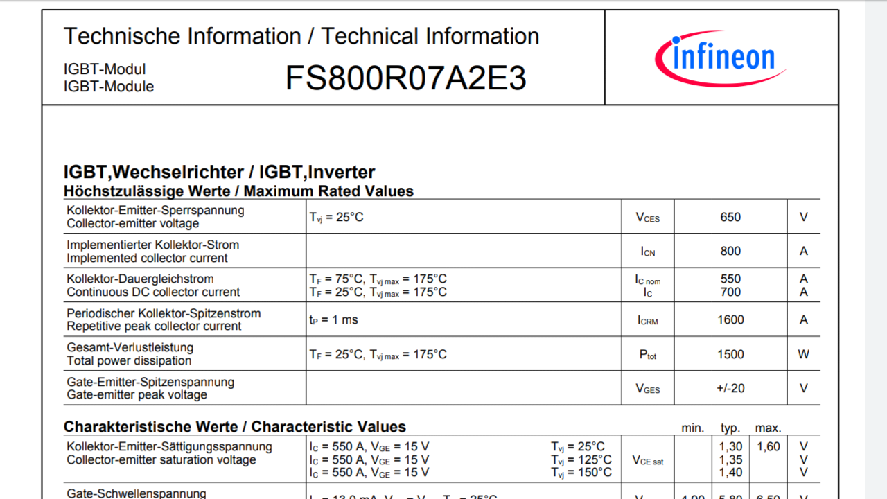

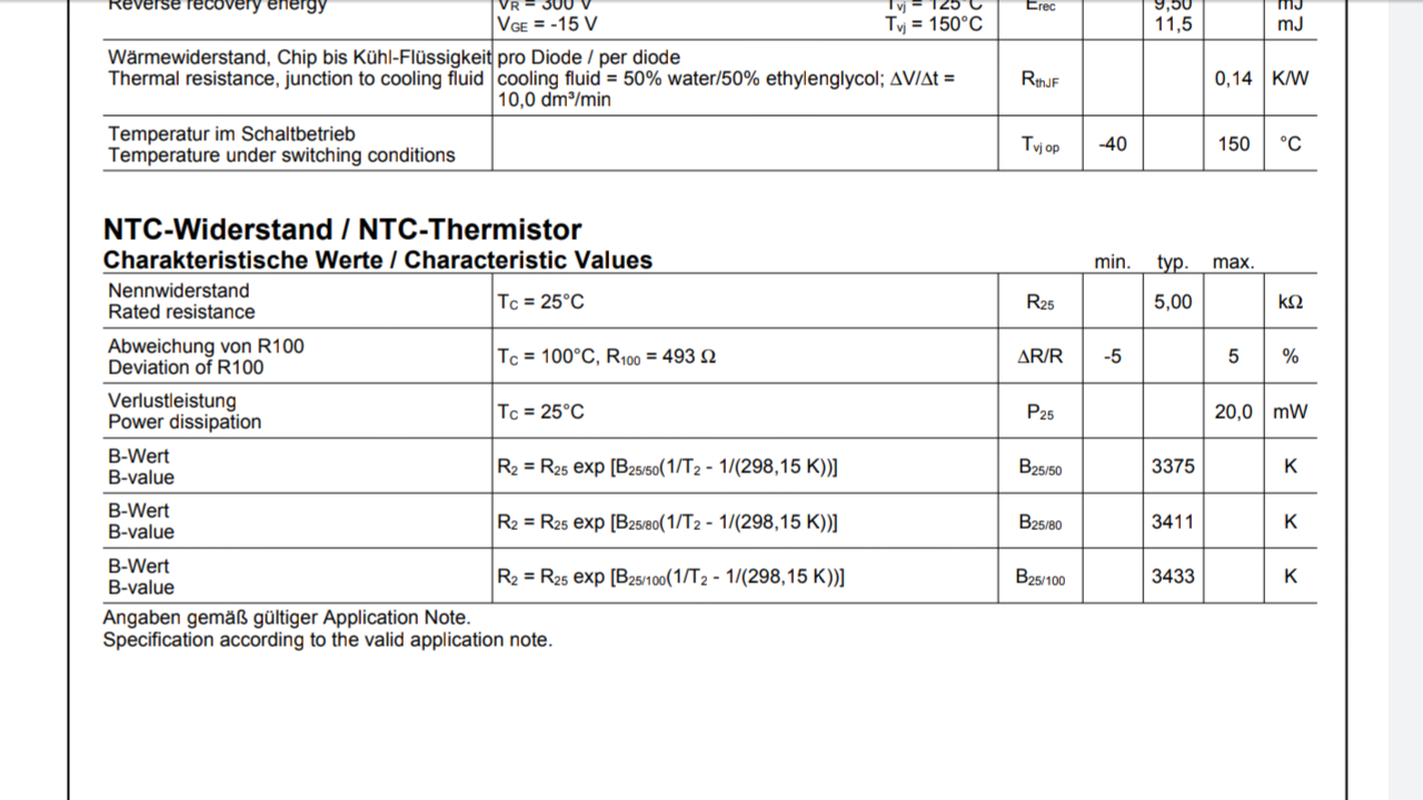

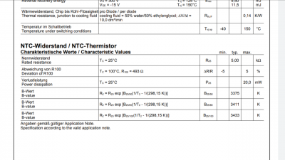

IGBT specs, they have 3 NTC thermistor built-in!!!

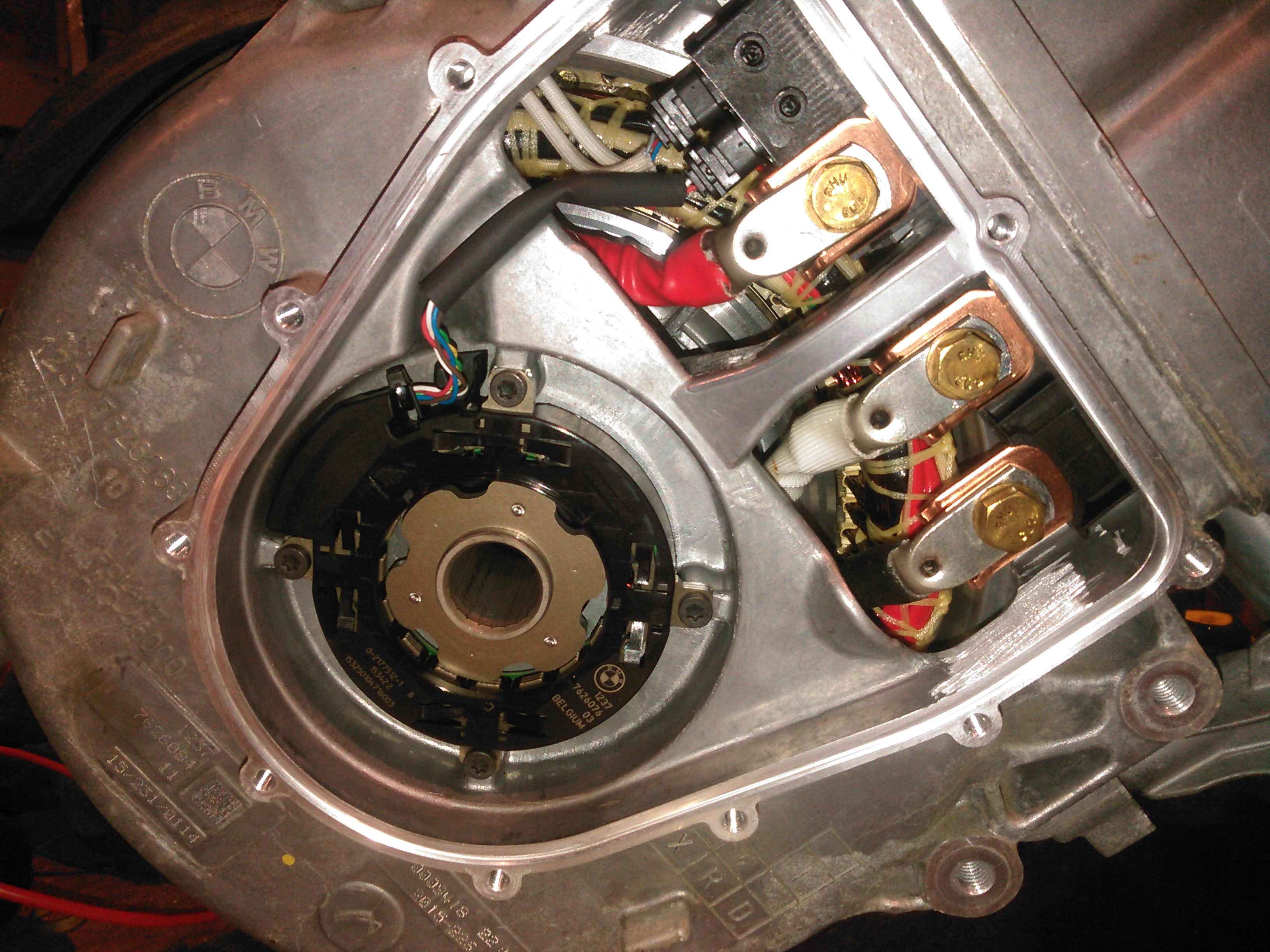

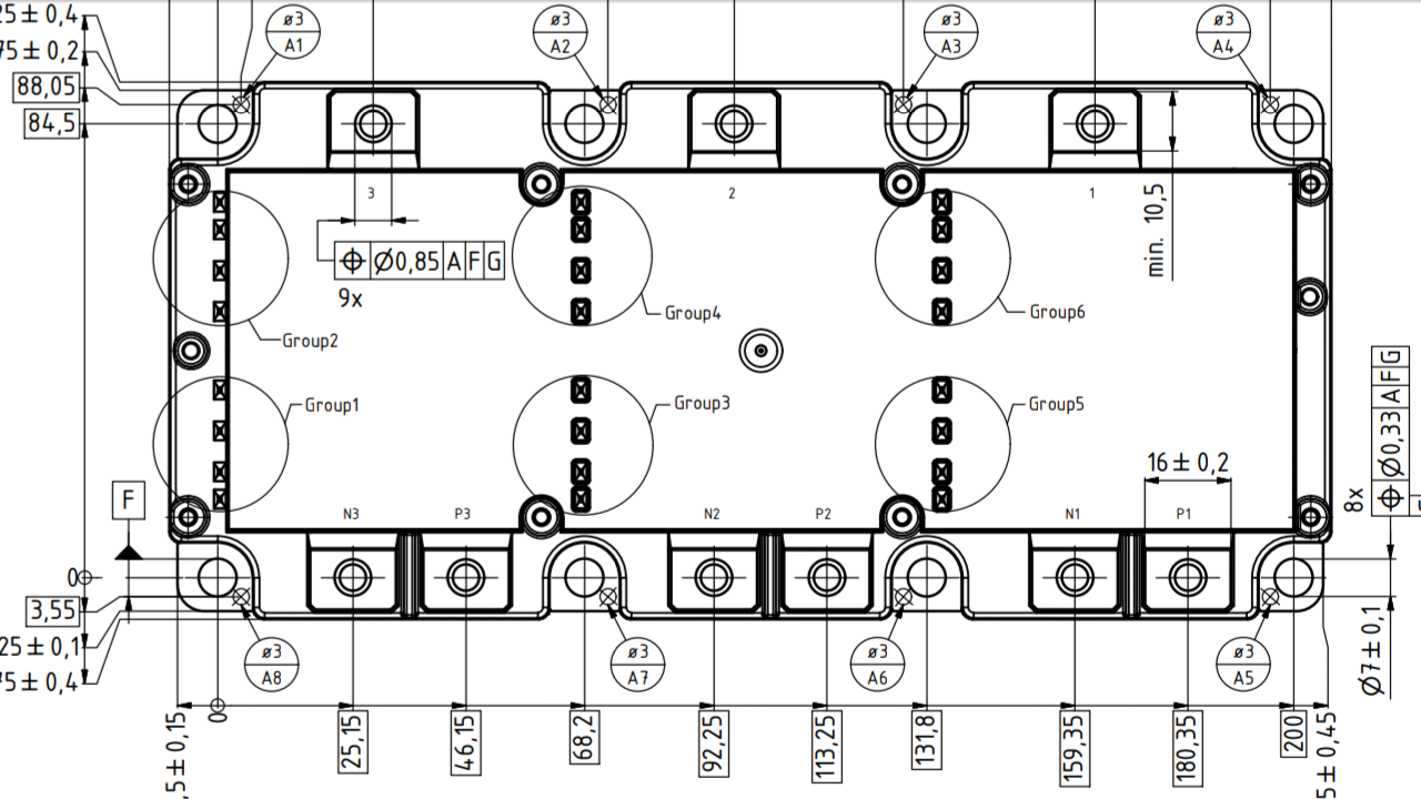

I have mapped most of the required signal from the original BMW inverter, here is a quick reference if somebody need it
The RESOLVER signals
Resolver
Resolver
Yellow and green pair (16 ohms) = EXCITATION
Red and white pair (26 ohms) = SINE or COSINE
blue and brown pair (26 ohms) = COSINE or SINE
The motor Winding signals
(Look like to be 10K NTC... more testing needed)
Bleu and gray pair = 10K NTC thermistor
Red and gray pair = 10K NTC thermistor
The complete signal cable pinout (resolver and winding thermistor)
Signal cable
Signal cable
TOP VIEW, LEFT TO RIGHT (AS PICTURED)
1= N/C
2= N/C
3= Winding thermistor #1
4= Winding thermistor #1
5= Winding thermistor #2
6= Winding thermistor #2
7= Resolver Cosine or Sine
8= Resolver Cosine or Sine
9= Resolver Excitation
10= Resolver Excitation
11= Resolver Sine or Cosine
12= Resolver Sine or Cosine
IGBT module
IGBT
IGBT
1= E+ (output+)
2= G+
3= C+ (input+)
4= T1 (5K NTC thermistor)
5= T2 (5K NTC thermistor)
6= C- (output-)
7= G-
8= E- (input-)
IGBT SPECS SHEET
Infineon-FS800R07A2E3-DS-v03_02-EN-1226878.pdf
IGBT specs sheet
(705.12 KiB) Downloaded 253 times
Now waiting for the open inverter complete kit to come

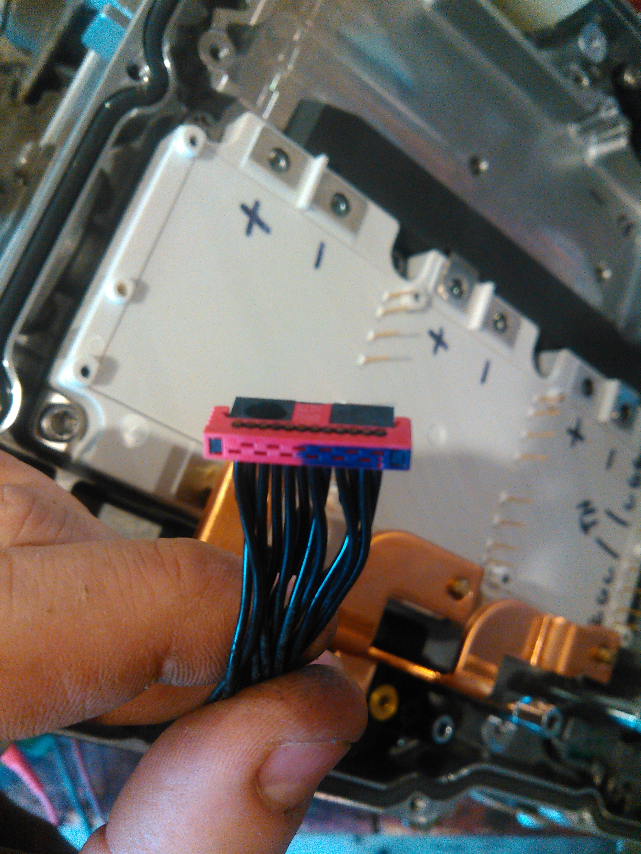

Went through my notes on the i3 inverter. Attached what I could find.
Here is my old thread over on diyelectric :
https://www.diyelectriccar.com/forums/s ... p?t=190418&
