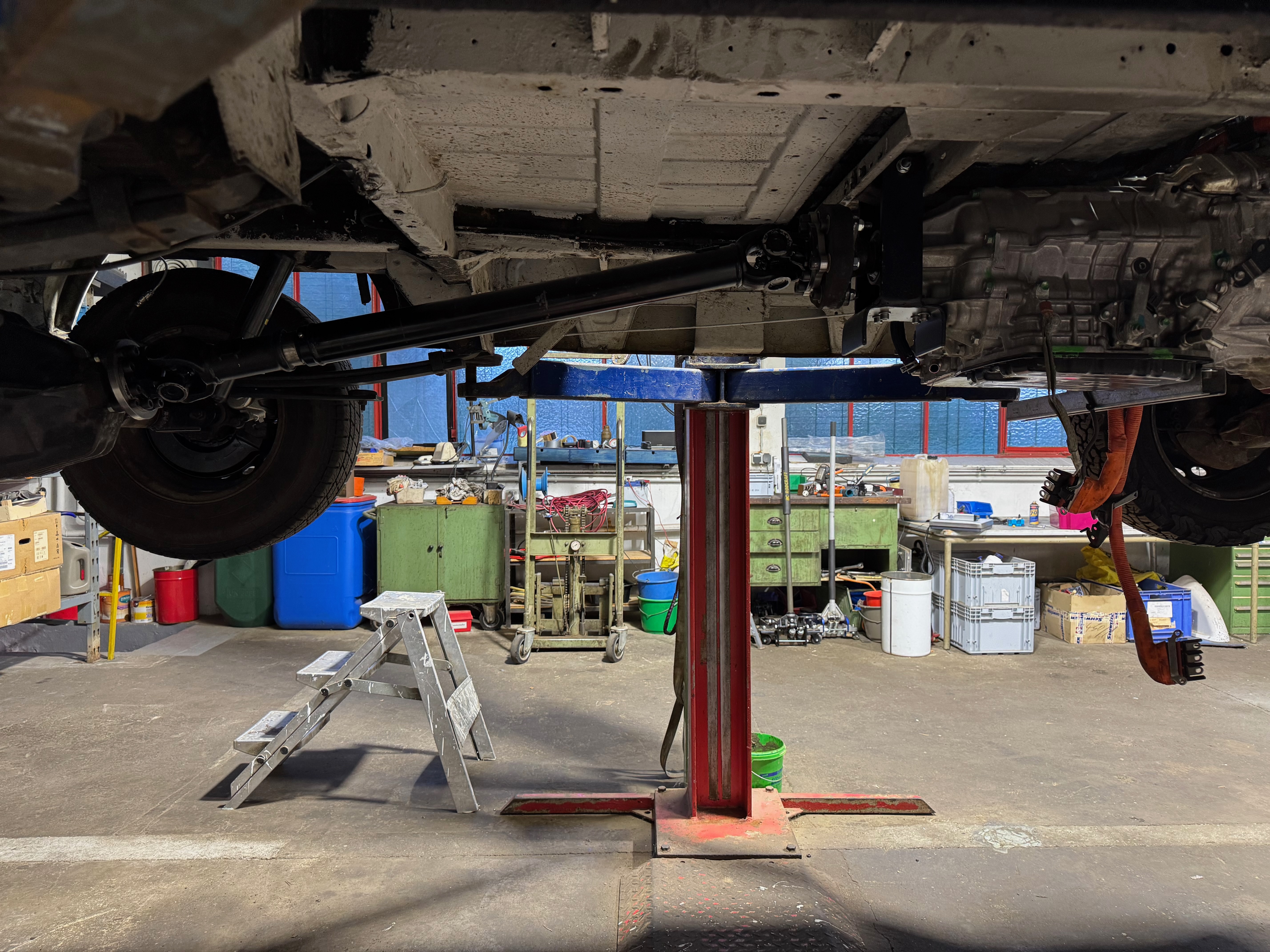

I was familiar with GS450h conversions, and at the time, Damian’s work on the GS300h caught my attention. I sourced a GS300h motor and inverter, mounted them in the van, and began the long journey. Progress was slow since I lived 1,000 km away from the vehicle, but I kept collecting parts and refining the setup — multiple LV-VCU wiring versions later, I’m finally happy with the result.

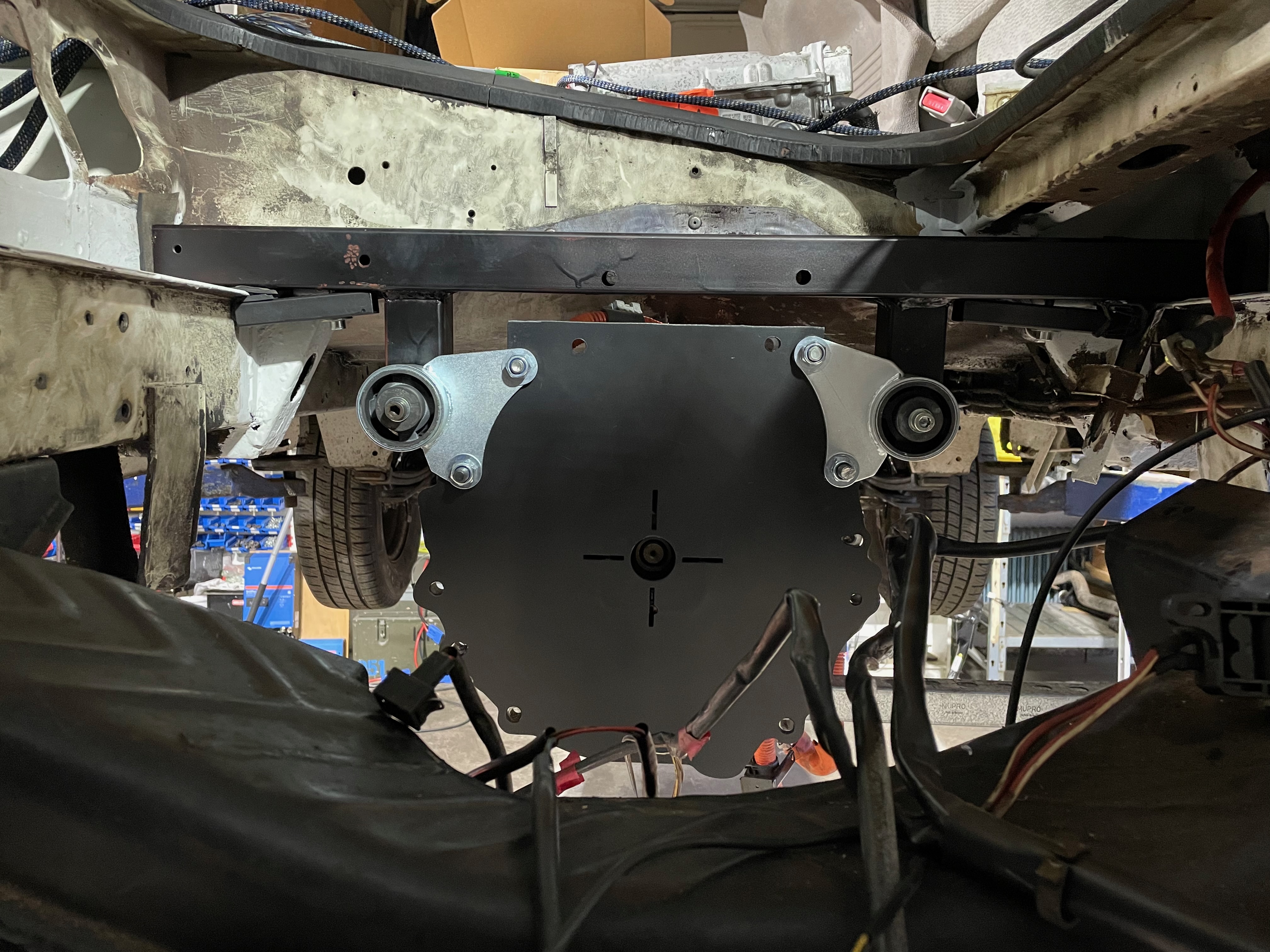

The motor is mounted using the original LT gearbox mount at the rear, while the front is supported by a laser-cut steel plate and a pair of Peugeot motor mounts.

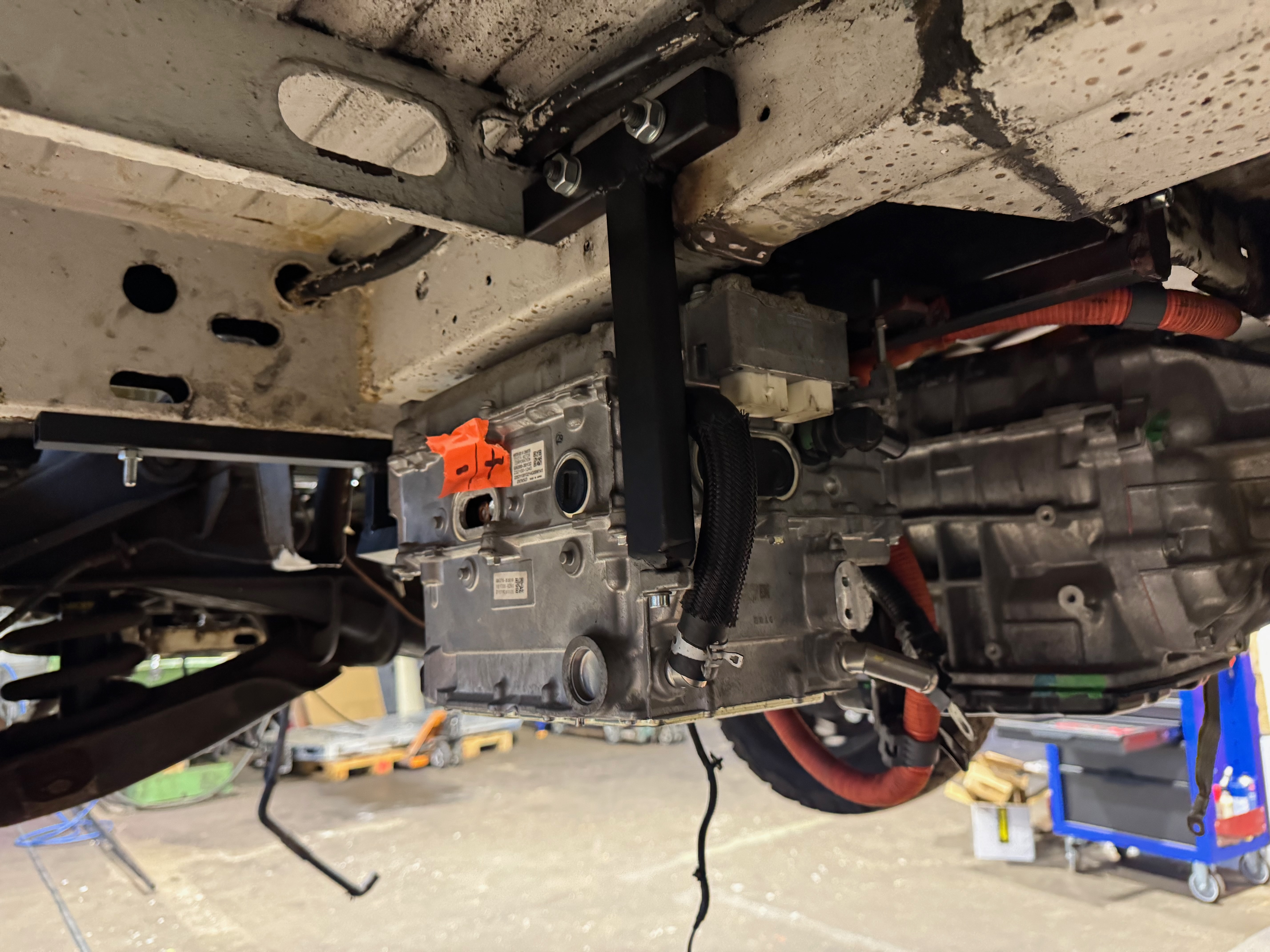

The inverter currently sits beside the motor on the driver’s side but will move soon to the passenger side to make space for the battery pack. The battery will be split between the original fuel-tank area, the driver-side underbody, and possibly the old engine bay if more capacity is needed.

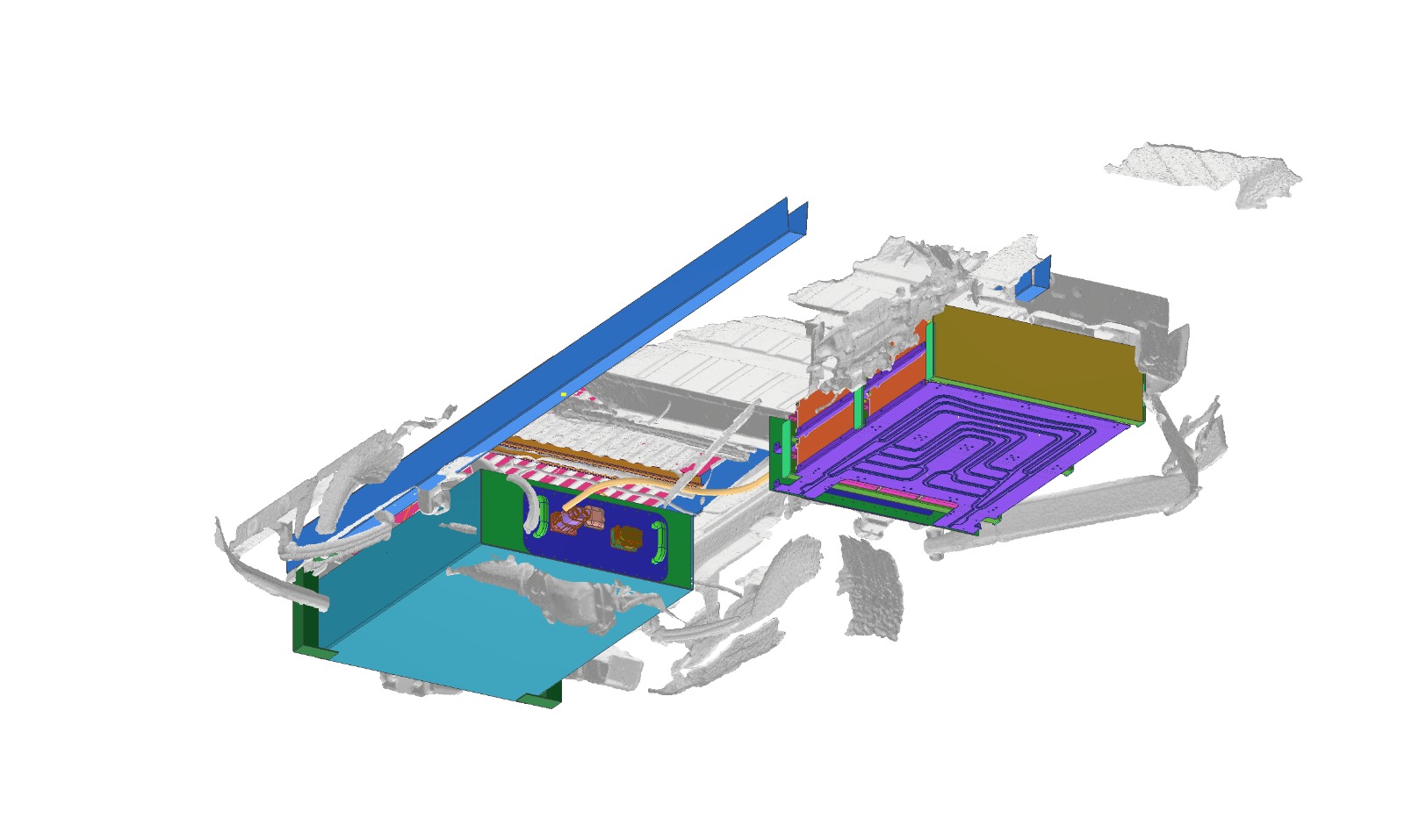

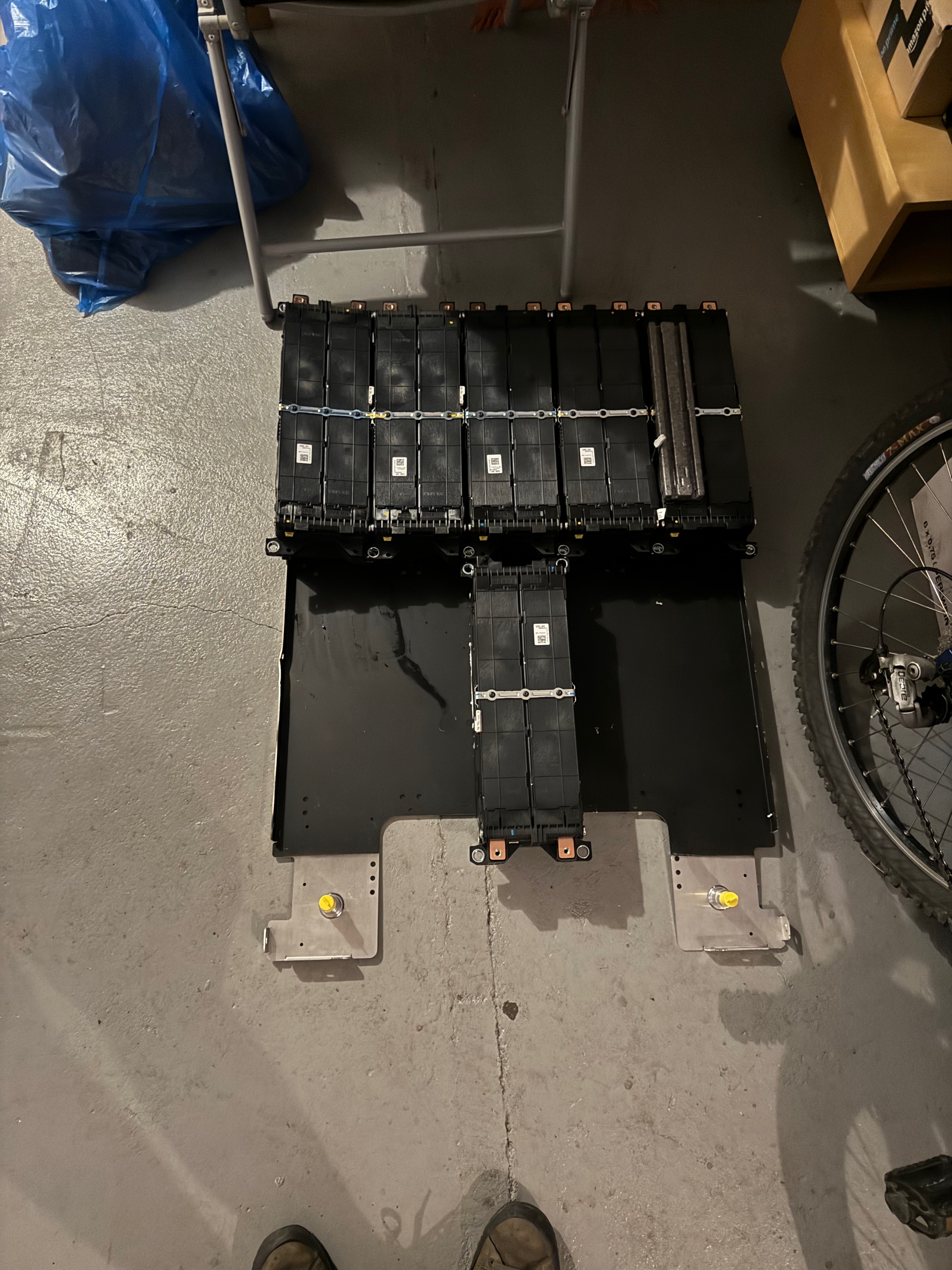

* Battery: 30 × Hyundai Mobis modules (≈ 72 kWh). Hoping for around 200 km range and decent fast-charging capability. All in series. In future if all works super well and I have weight capacity to spare I might go double or lower the voltage but upper the capacity, let’s see. For now it stays at it is.
* Cooling: Roll-bonded cooling plates from an electric truck conversion company; they fit well enough to support liquid cooling in the vehicle to make fast charging possible..

CAD_SCAN+Build
CAD_SCAN+Build
Ioniq5 Modules on Cooling Plate
Motor & Driveshaft Installed
Motor and Inverter Mounting
Motor Mounting VW LT1

Yes, the plan is to keep all 30 modules in series for 650V i think this is the best way to make this an actually usable van as it will be able to fast charge. I will either reuse the original thermal compound. But they are also sold by ESDI or similar.
