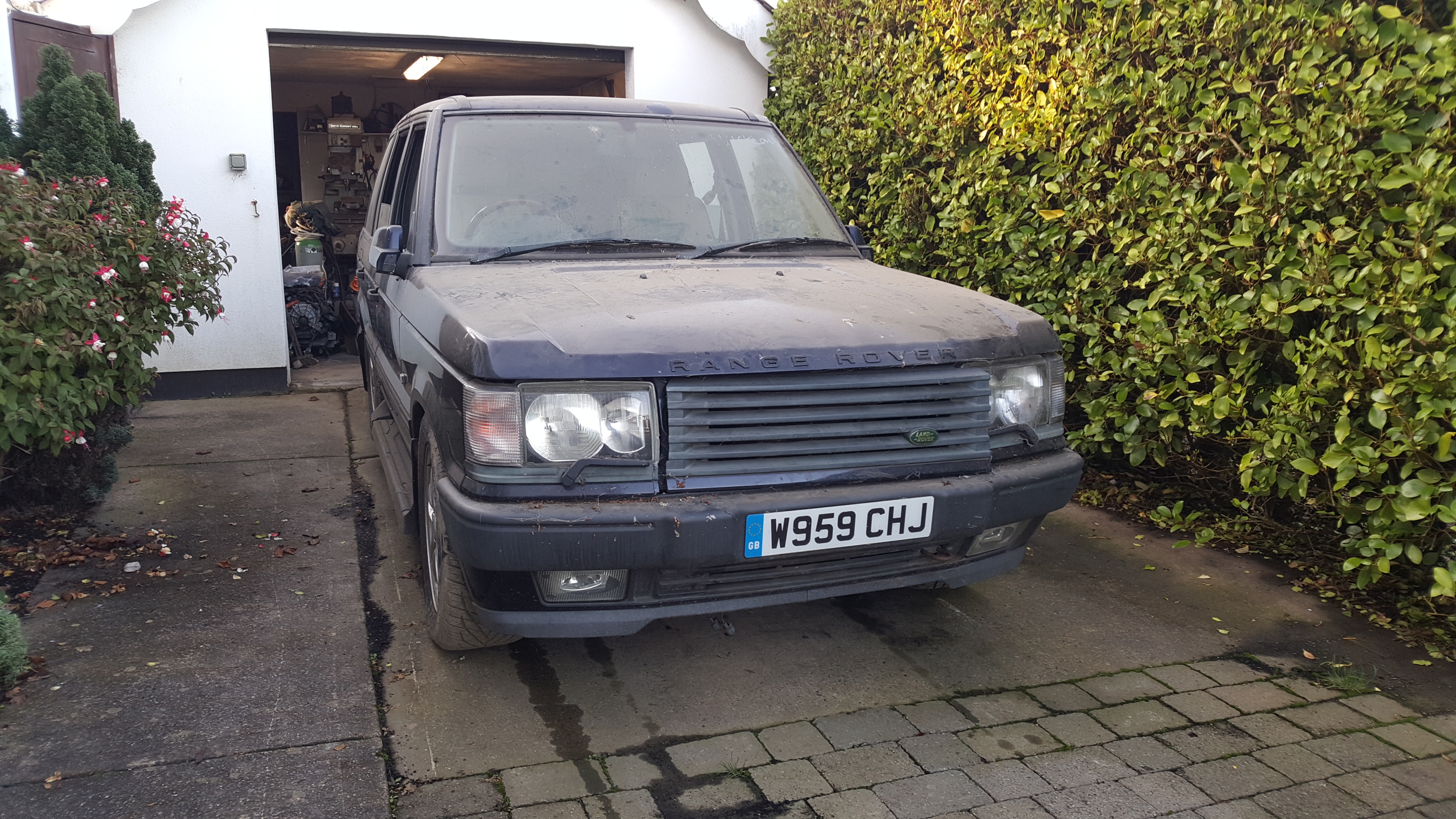

So yeah. I really need another project with all that pesky free time:)
Owned by a friend of a friend (actually a relation of a friend!), partially converted in the UK and now in my drive way sits a Range Rover P38.
Equipped with two of those horrific Enova motors that I can't seem to get away from and a REALLY dodgy front battery box that going to die by acetylene flame (on camera of course) very soon.
then we're gonna stuff in two Prius inverters and see what happens.
Here is a video of it when it was at Dave's :

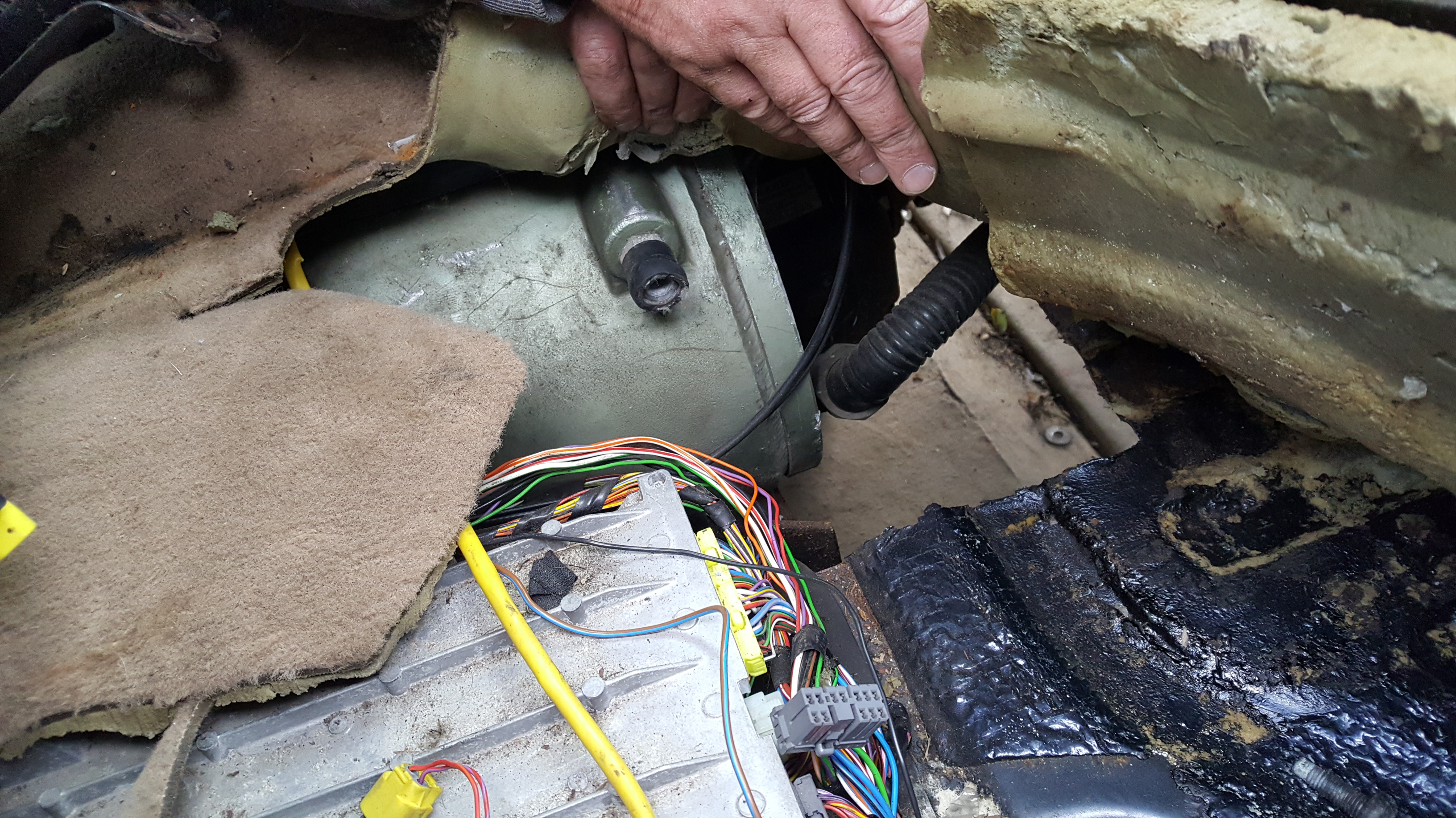

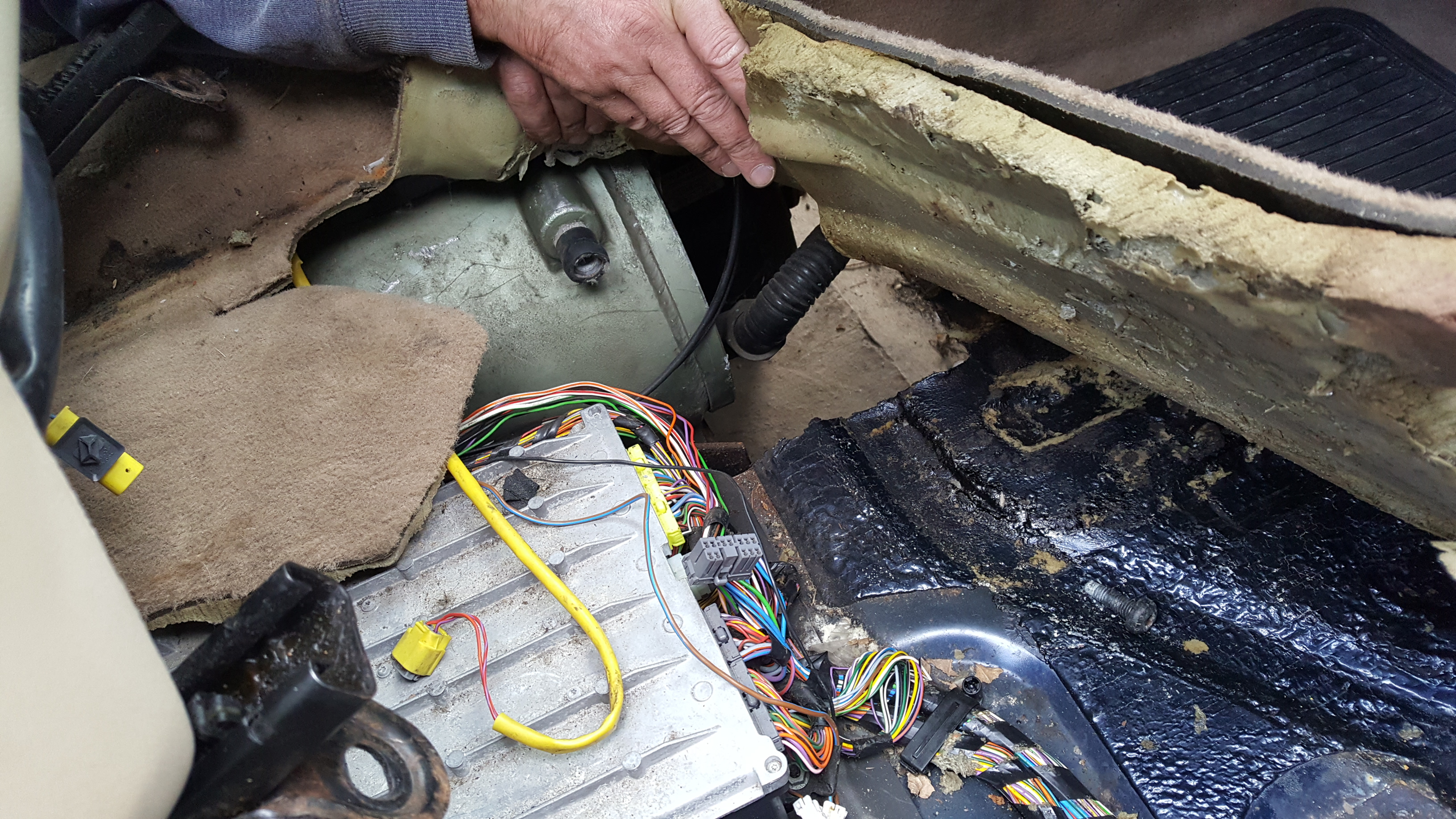

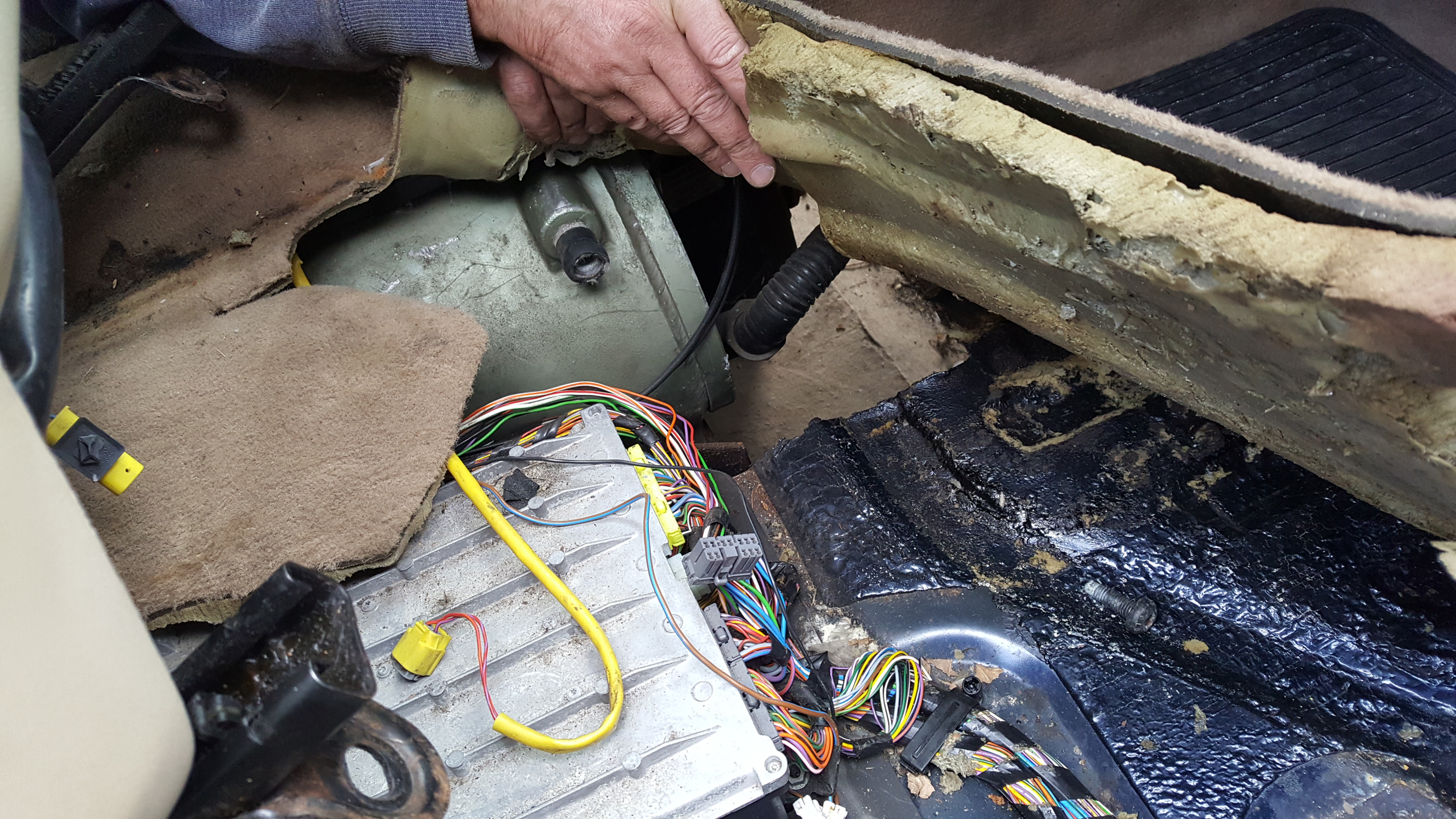

Today's lesson in how NOT to convert an ev. Guy who fitted the motors chopped out most of the floor under the driver and passanger seats including the front seat mounts to get the motors to fit. Then cleverly refitted the carpet to cover it all up. The air suspension tank was in his way so that was professionally re mounted.
Re: The Rover of Ranges
Oh dear god.
Has this been setup with 2 motors in the drive tunnel connected to each of the drive shafts?
The drive shafts are offset from center as they are fed from the transfer case at the back of the gearbox and on the left side of the car.
Are the dimensions of the motors at issue?
Could it be possible to mount 1 Leaf motor directly to the diff on each axle? That way you could lose the drive shafts and the extra unsprung weight would hardly make a difference to the axle. It's already a huge heavy thing.

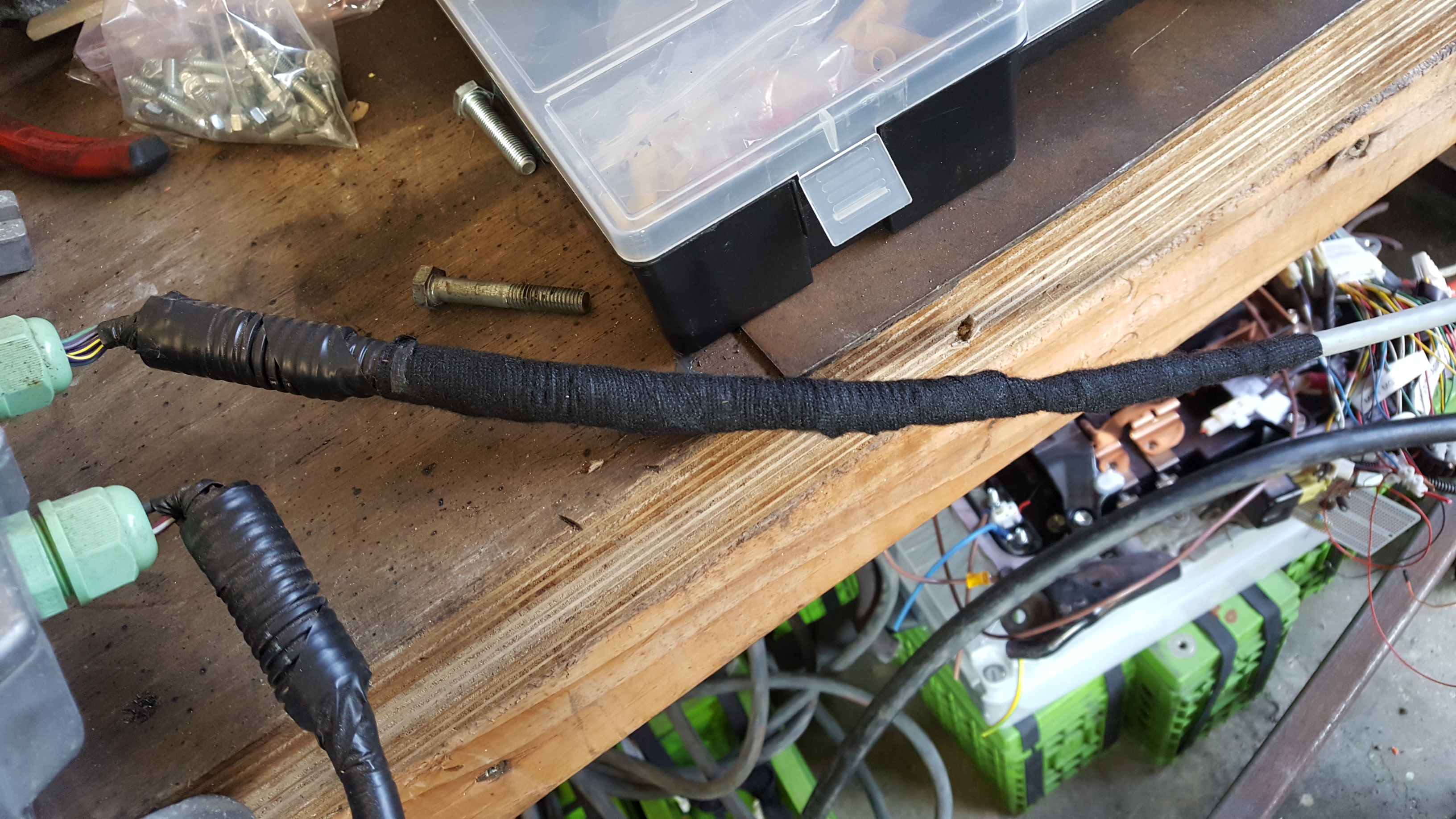

You know Damien if you connect one of the wires to 12V "Enable ignition" relay and after that apply the other one to "latching start" relay the pump will start immediately and stabilize pressure in like 1 second. Try it, i am not sure which colour wire is "enable" and which is "start" since i spliced them my own wires quite close to the casing. You just try any of combinations and then mark correct wires.
EDIT: I did write about EHPAS wiring in my blog. Black wire is enable signal and blue/white is engine running signal after ignition.
https://leafdriveblog.wordpress.com/tag/steering/

Wow, structural carpeting. I'd be careful lifting up any more of that carpet. It may be all that's holding the floor together.

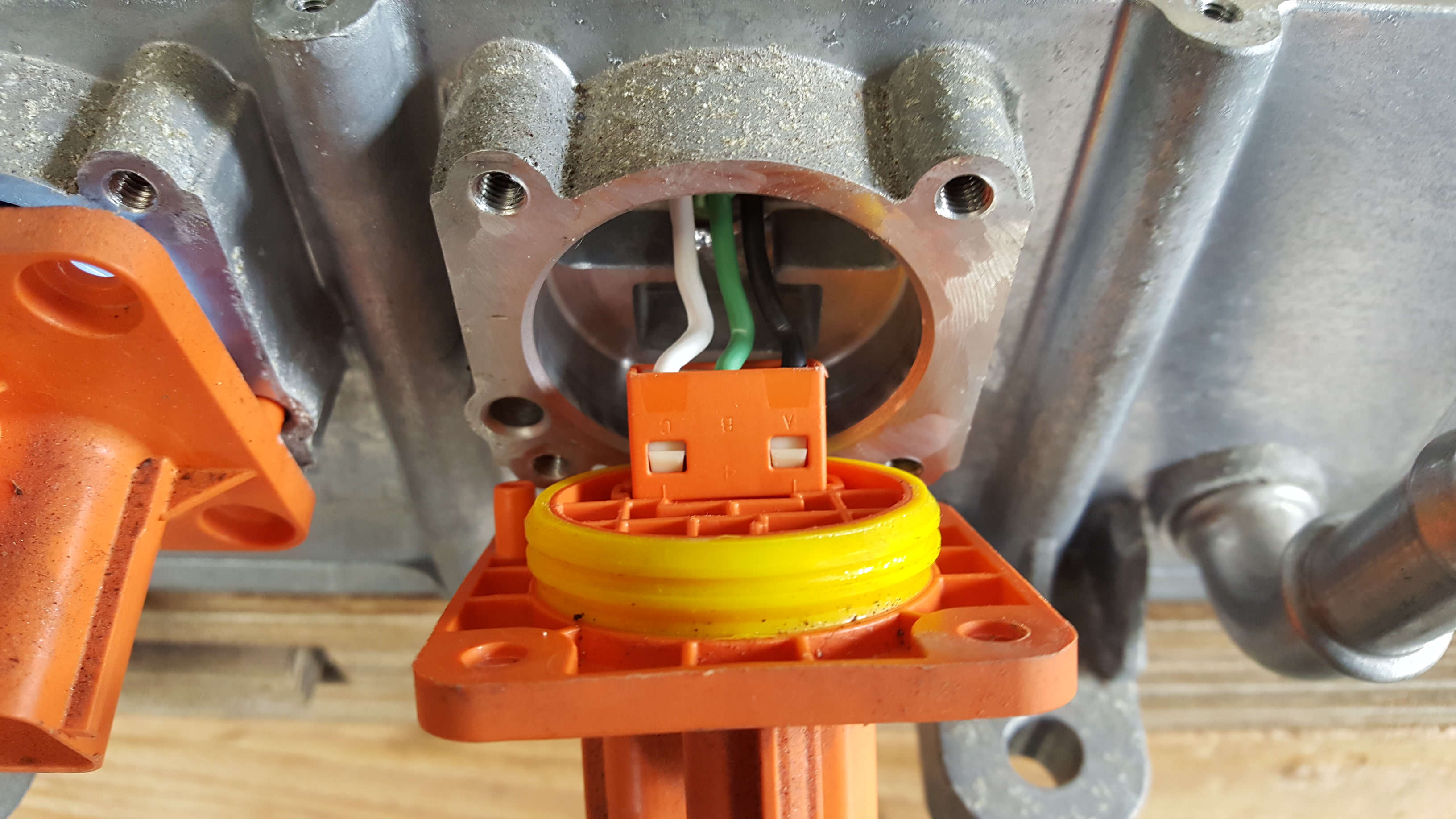

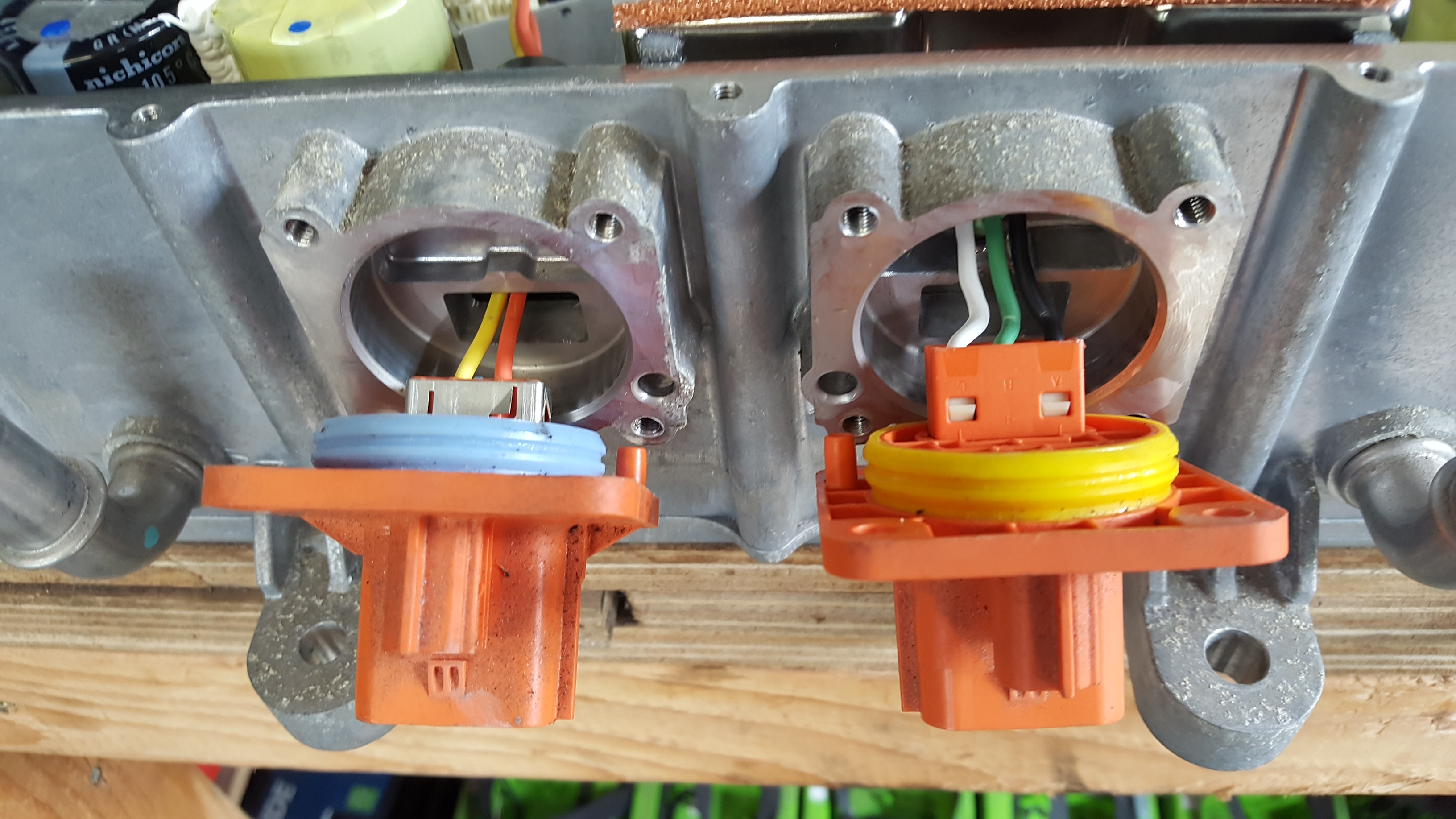

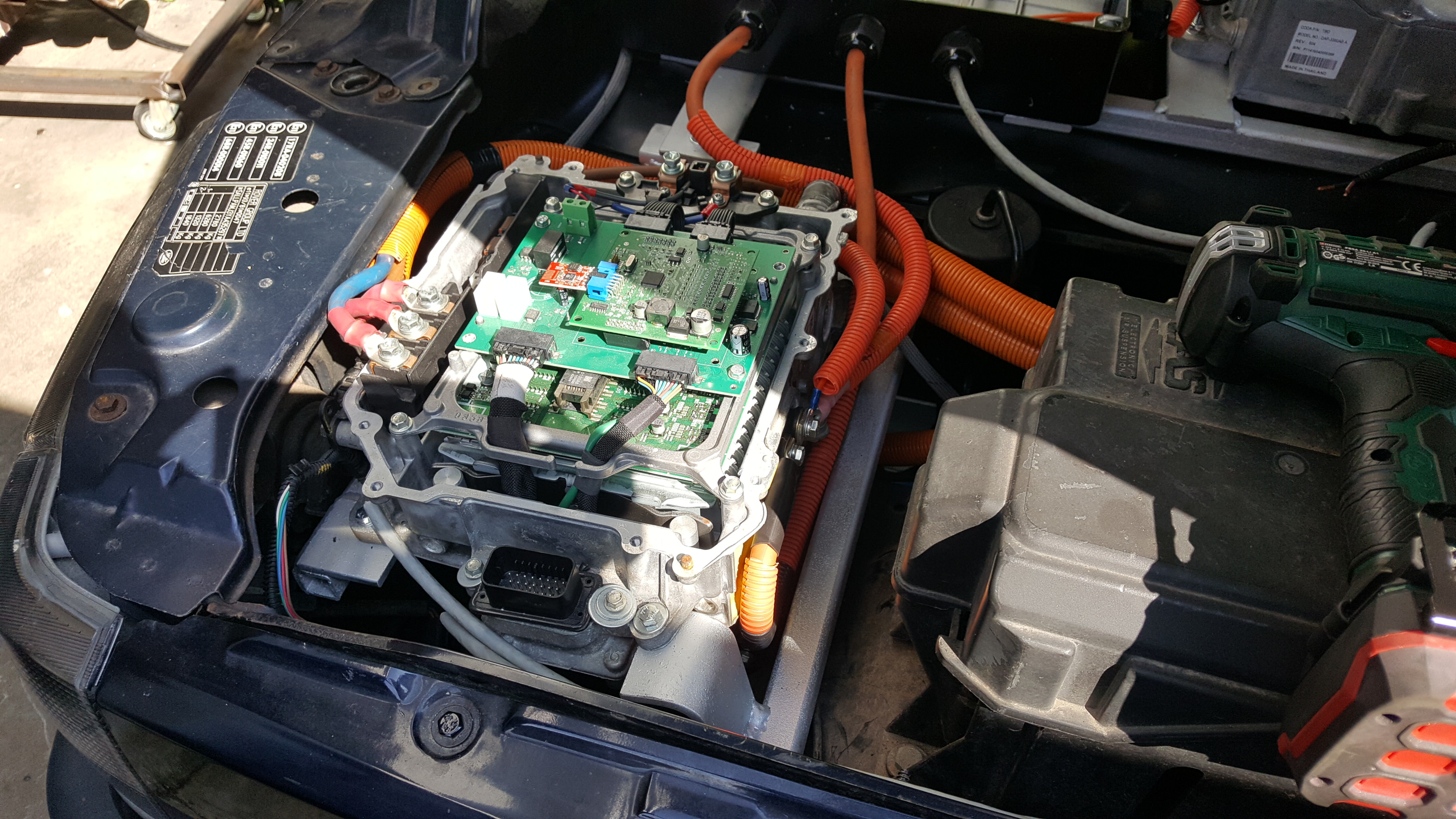

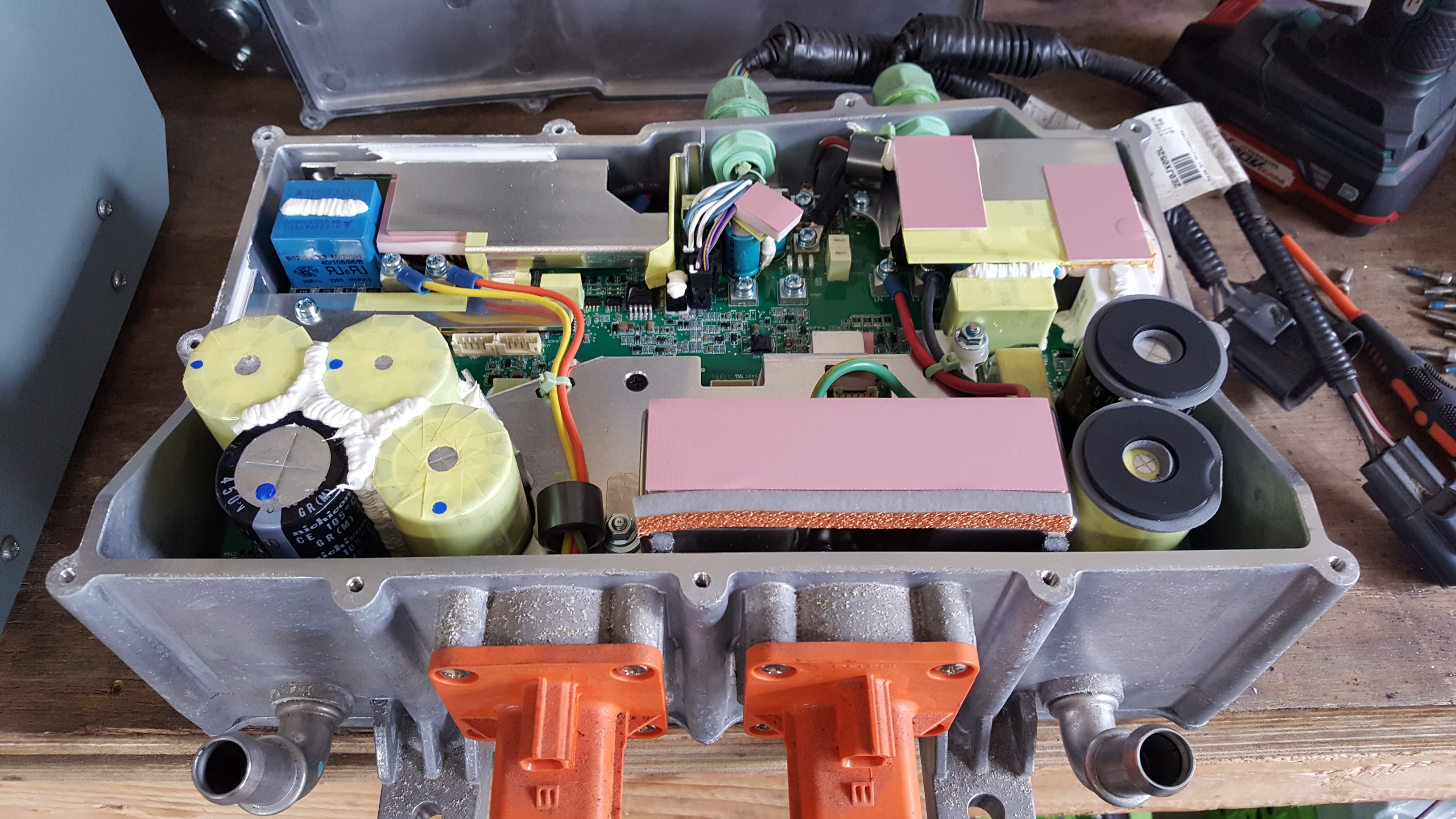

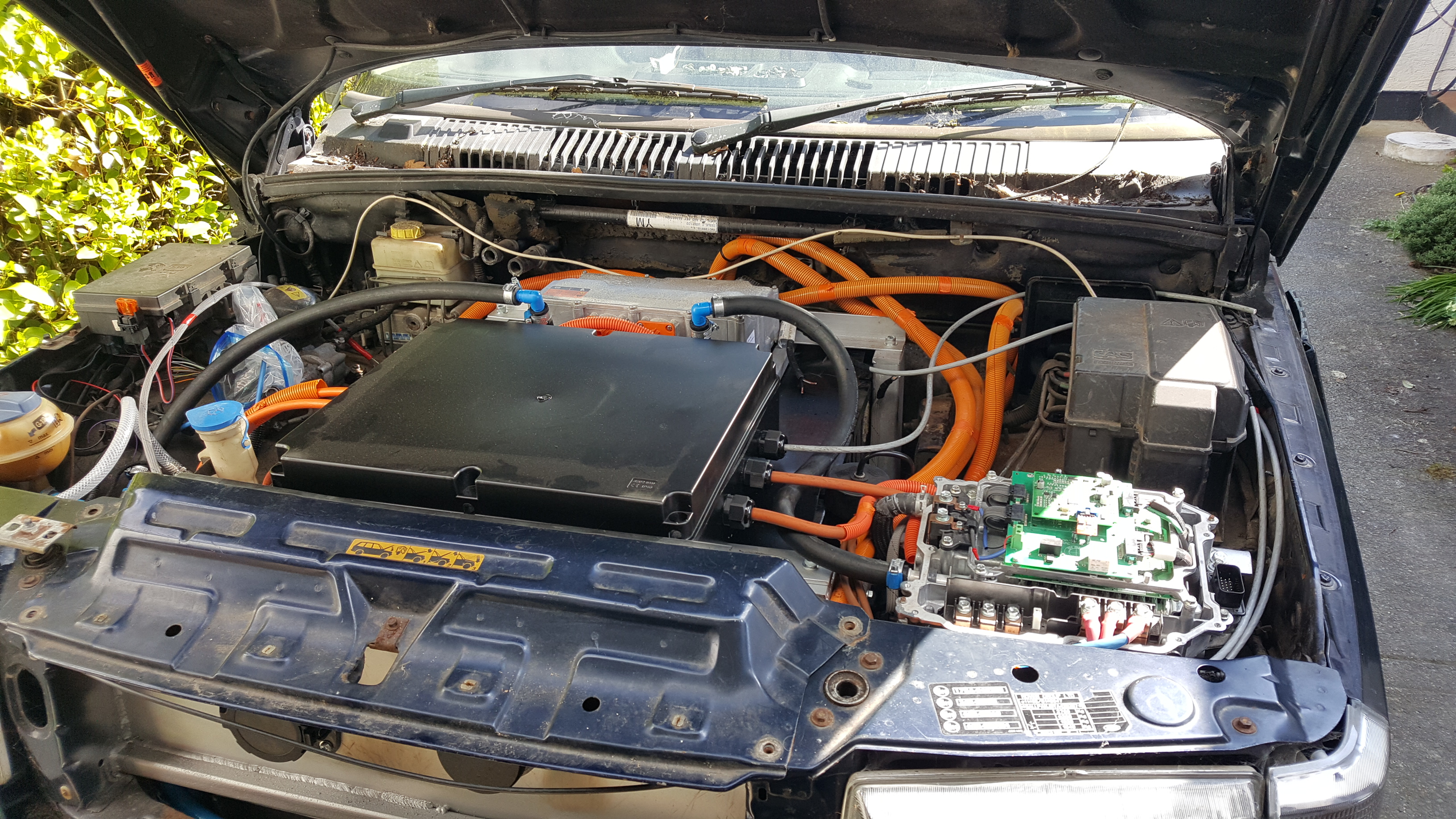

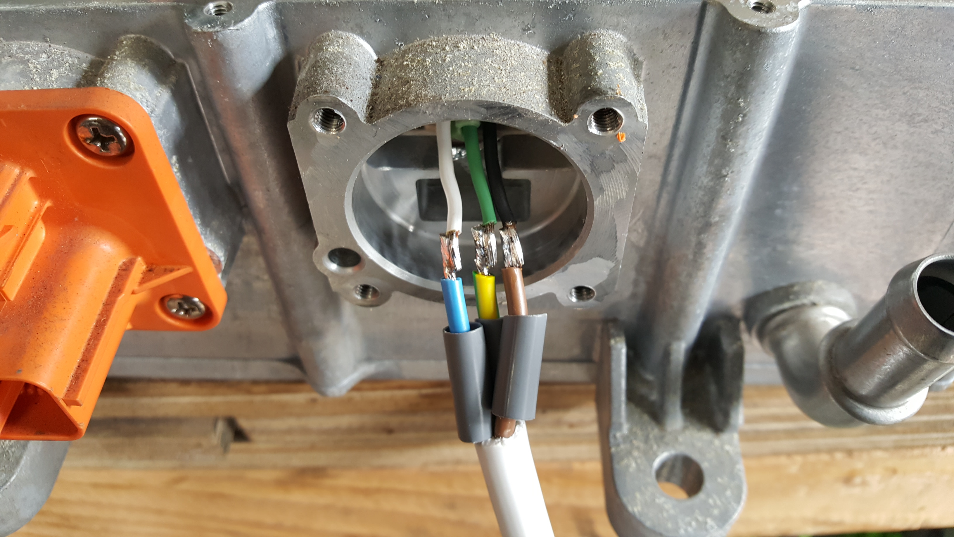

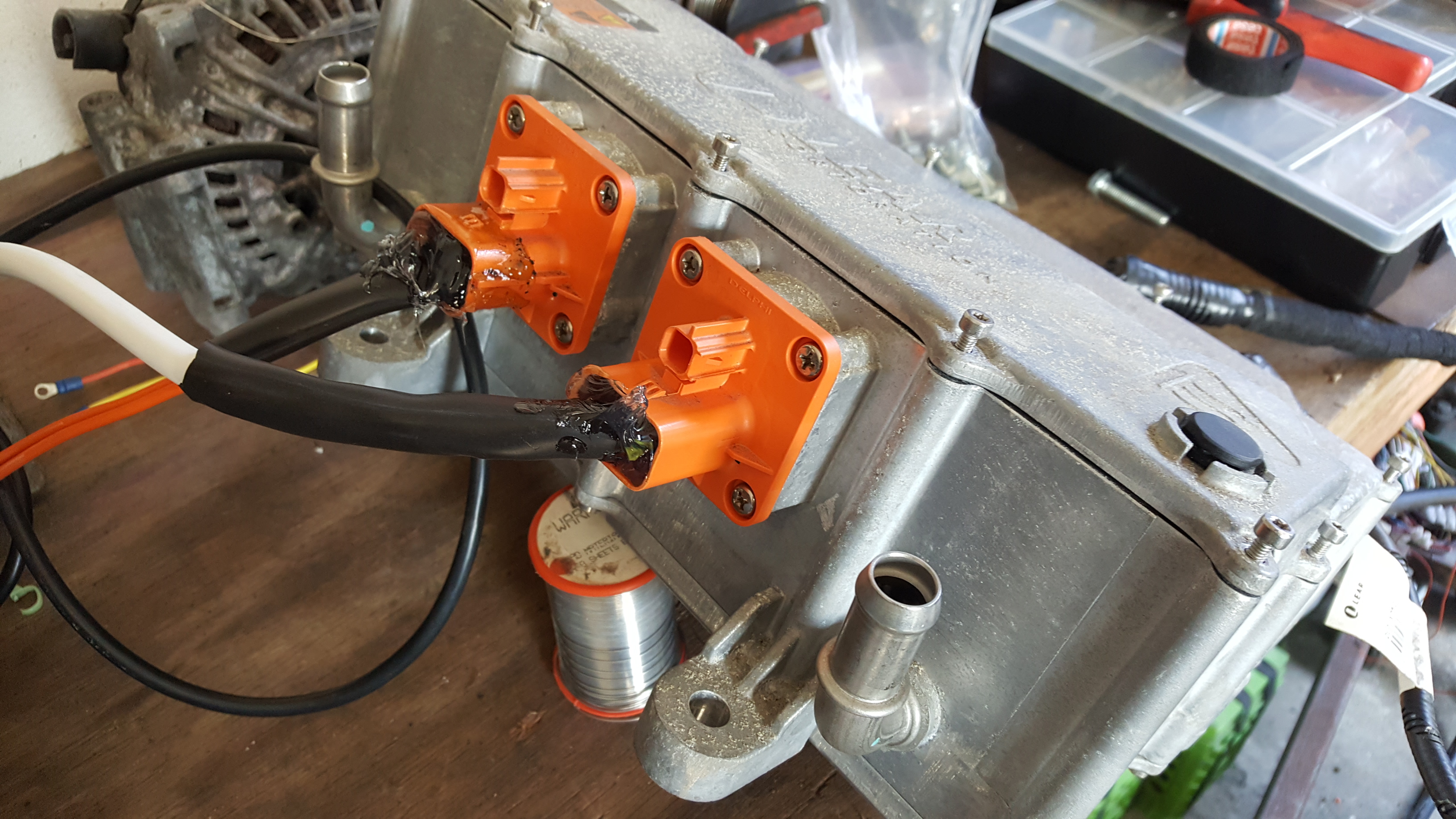

Back roving the range today.

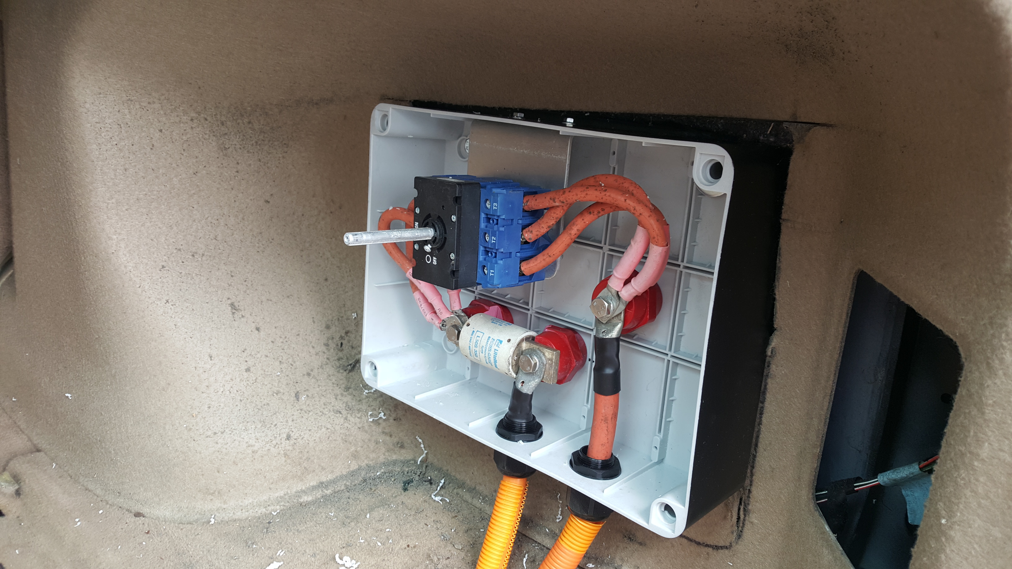

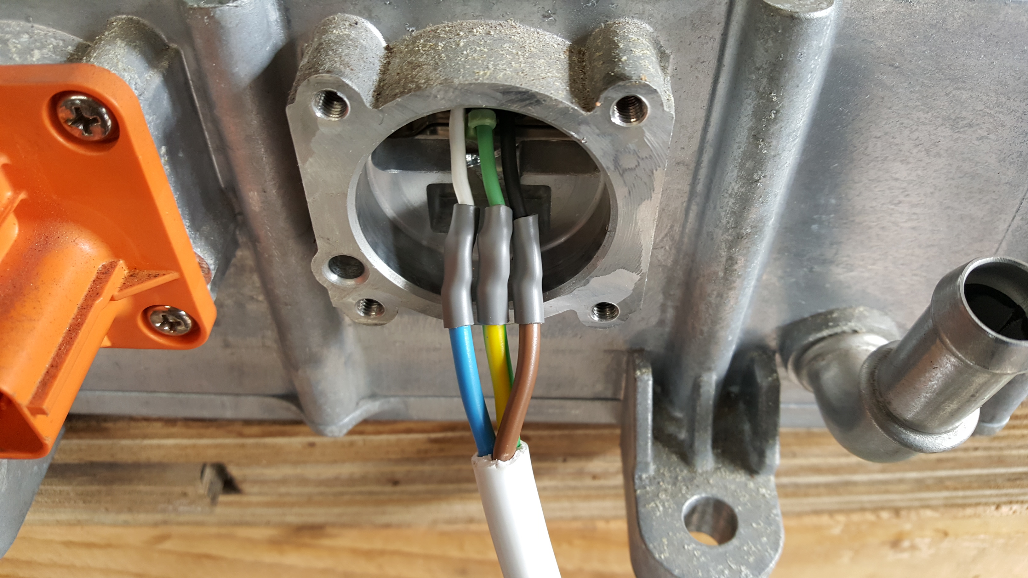

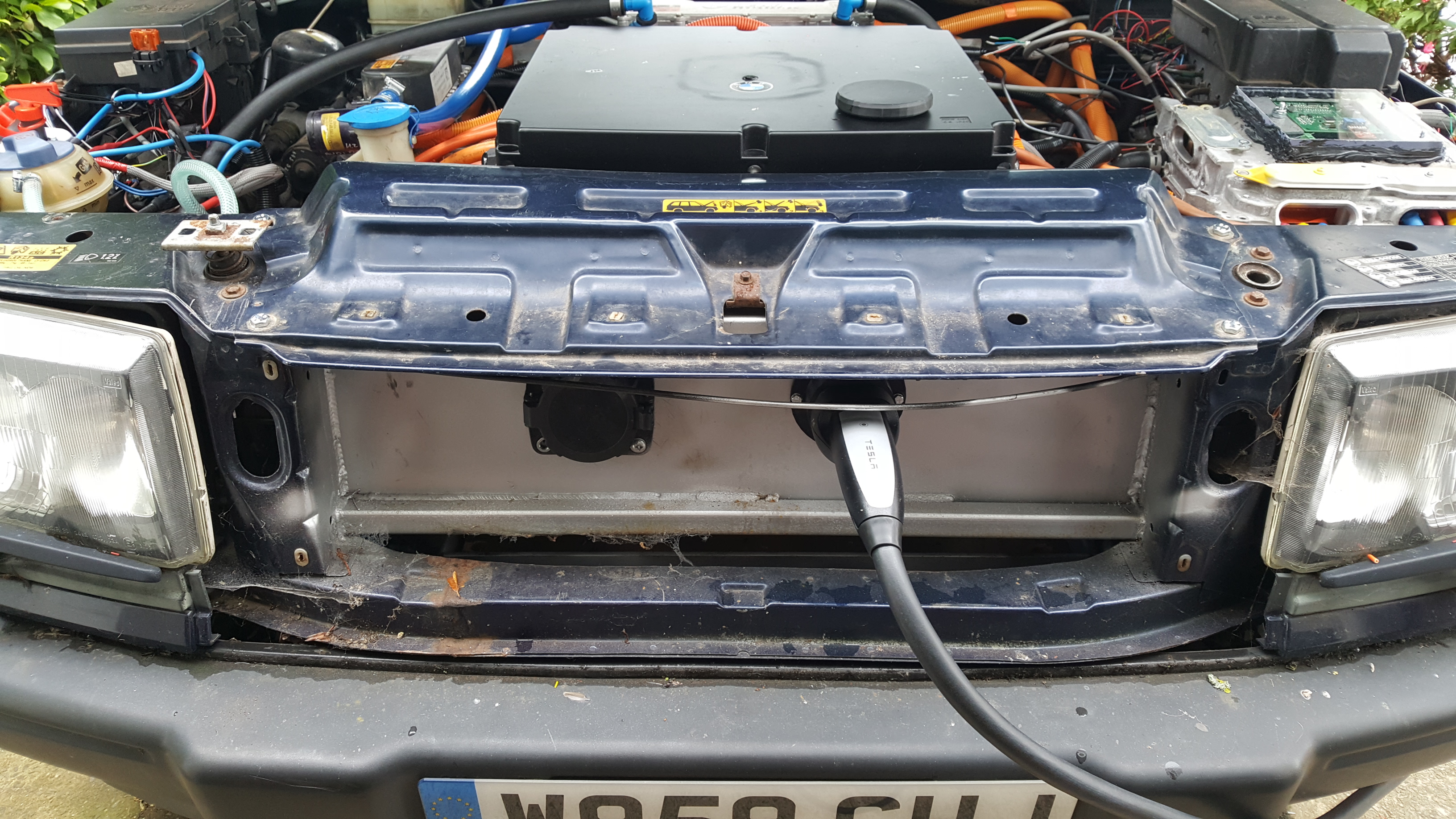

High voltage junction box nearly done so decided to modify the Ampera charger to get the cables ran in as of course dont have the connectors. Also started wiring up the front battery and hv wiring. Thanks to Arber for the info on running the charger :
https://leafdriveblog.wordpress.com/201 ... a-charger/

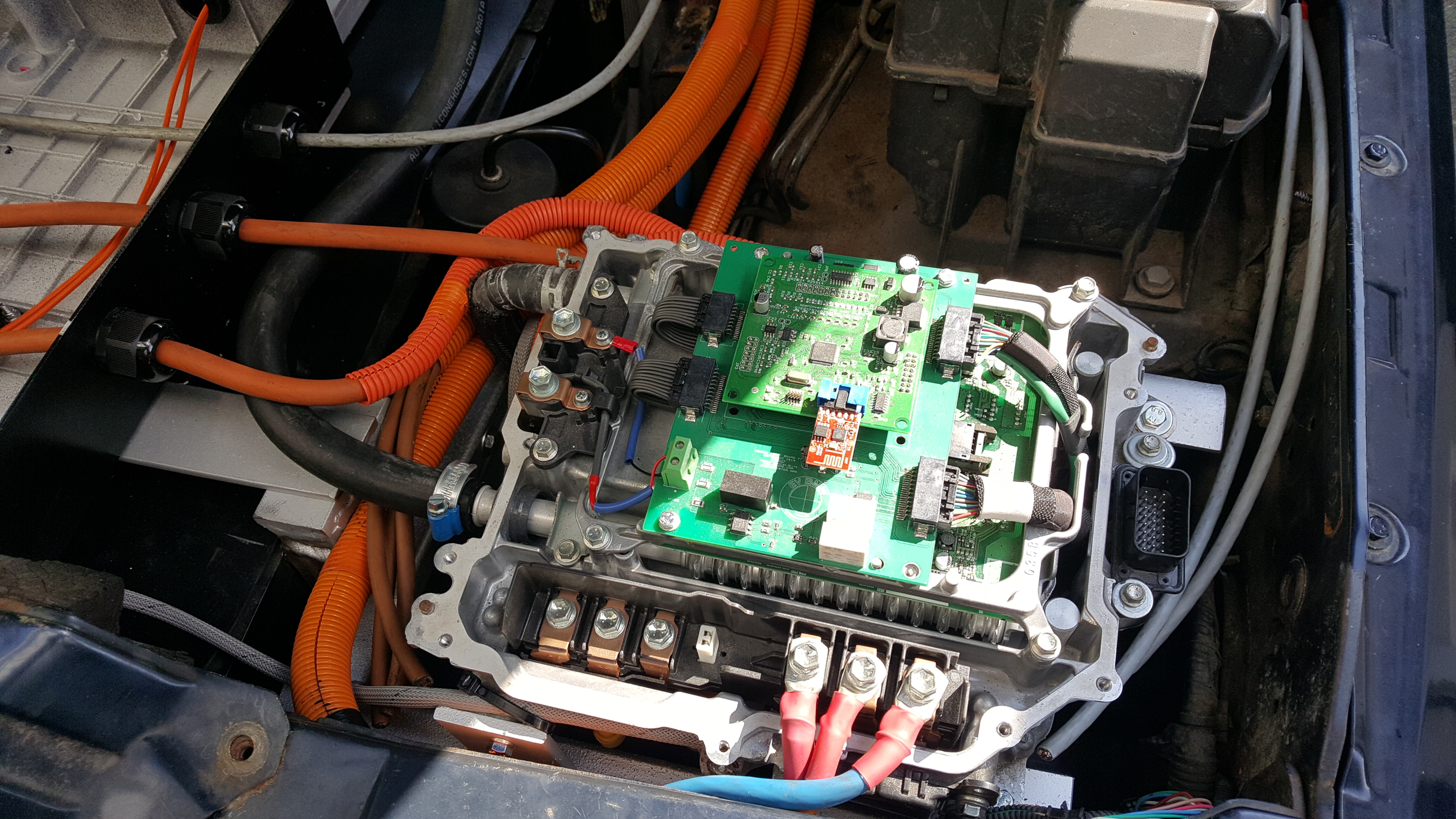

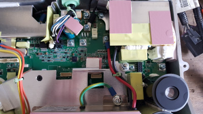

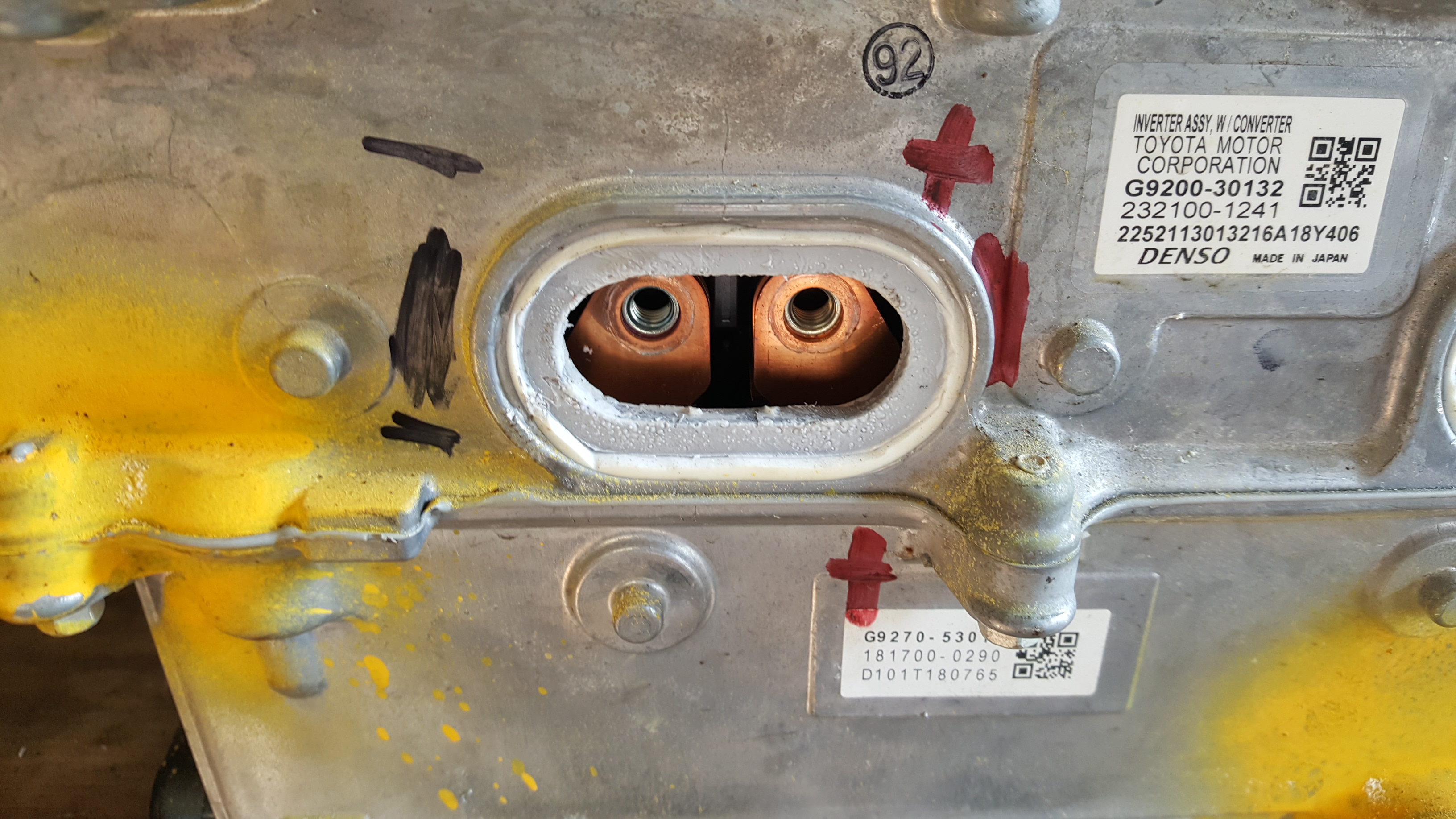

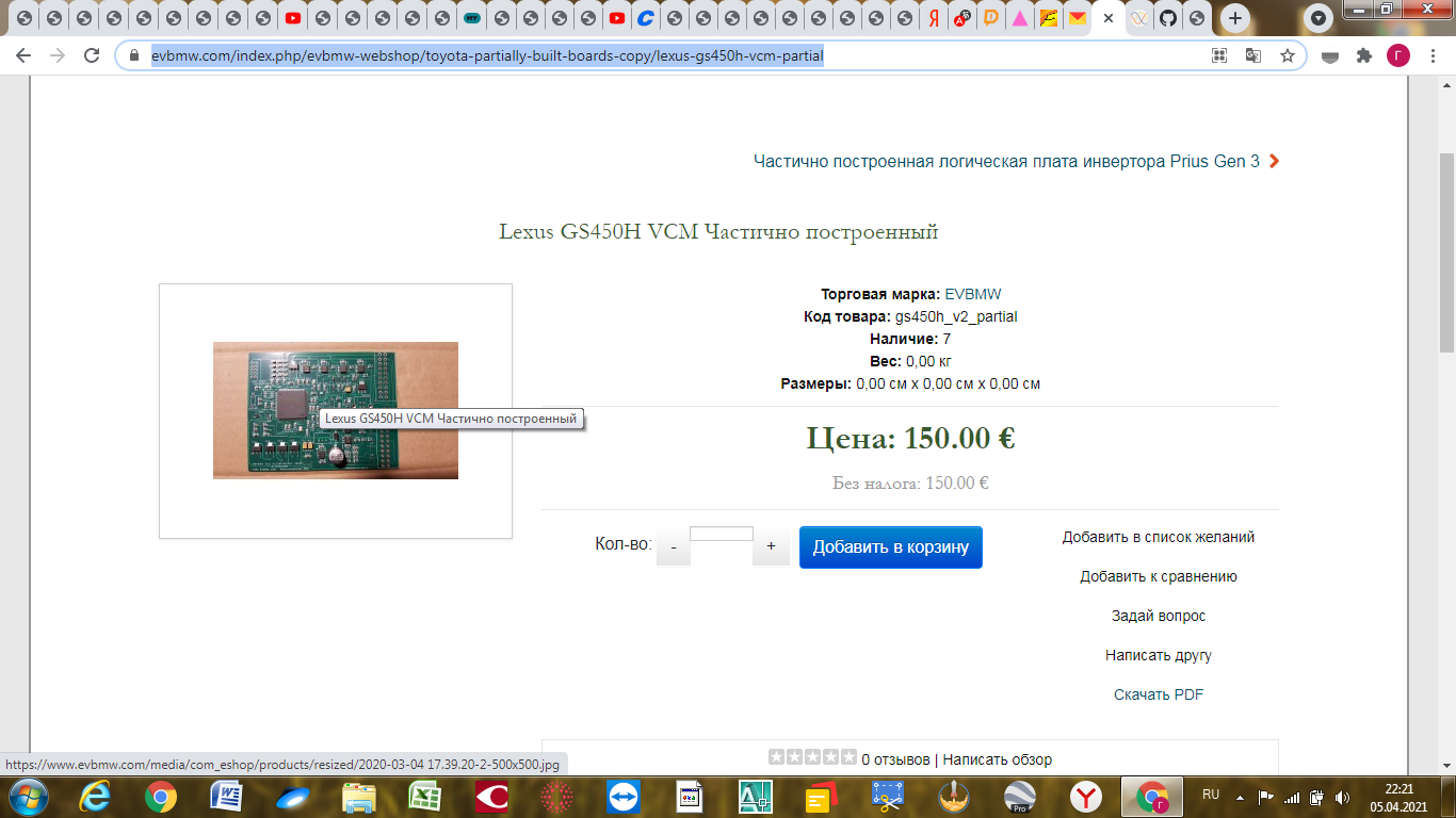

Given I'm running an ISA shunt for battery monitoring decided to use a modified GS450h vcu for control of the charger , precharge and hv monitoring.
- Posts: 4000
- Been thanked: 1115 times

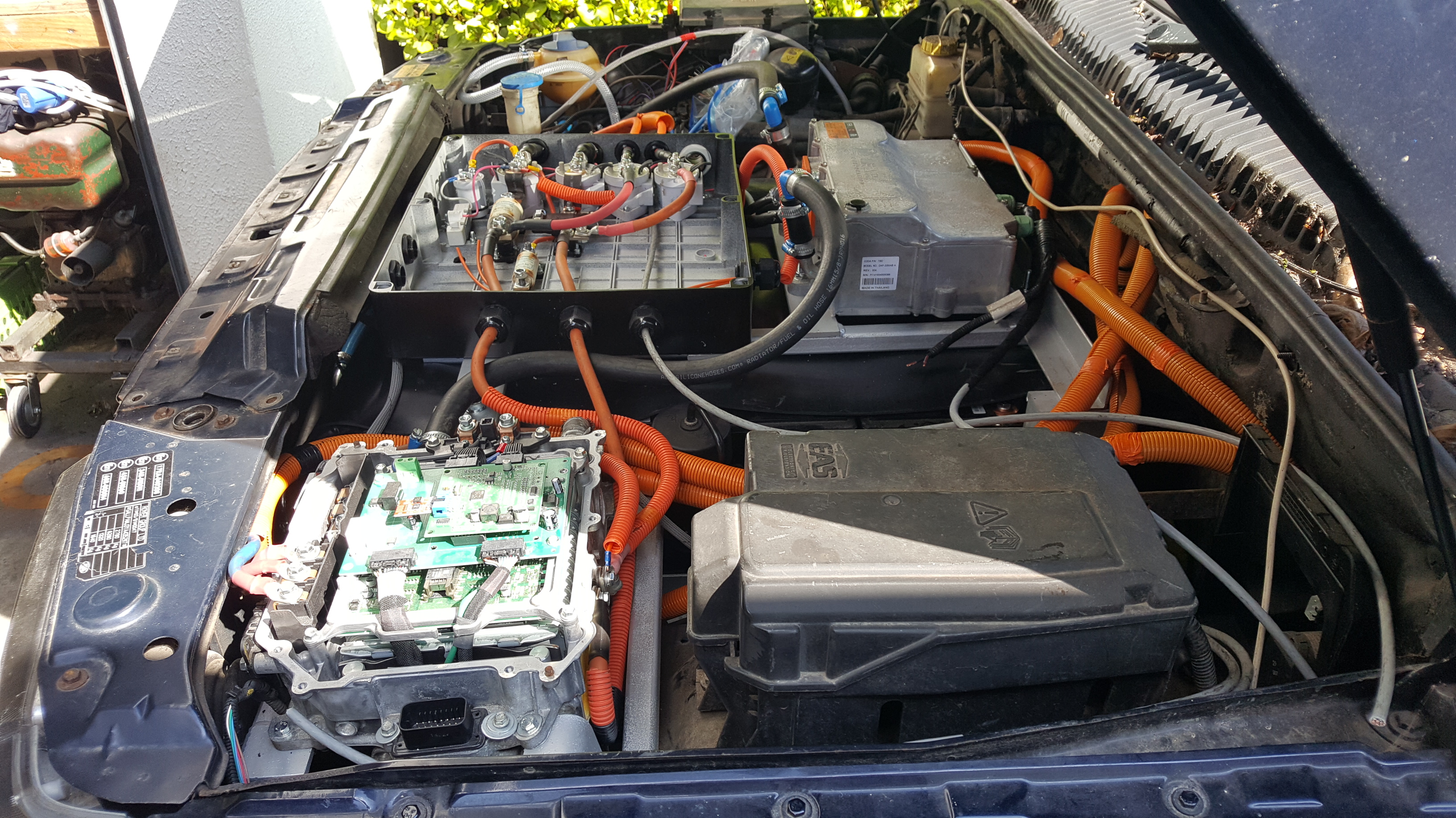

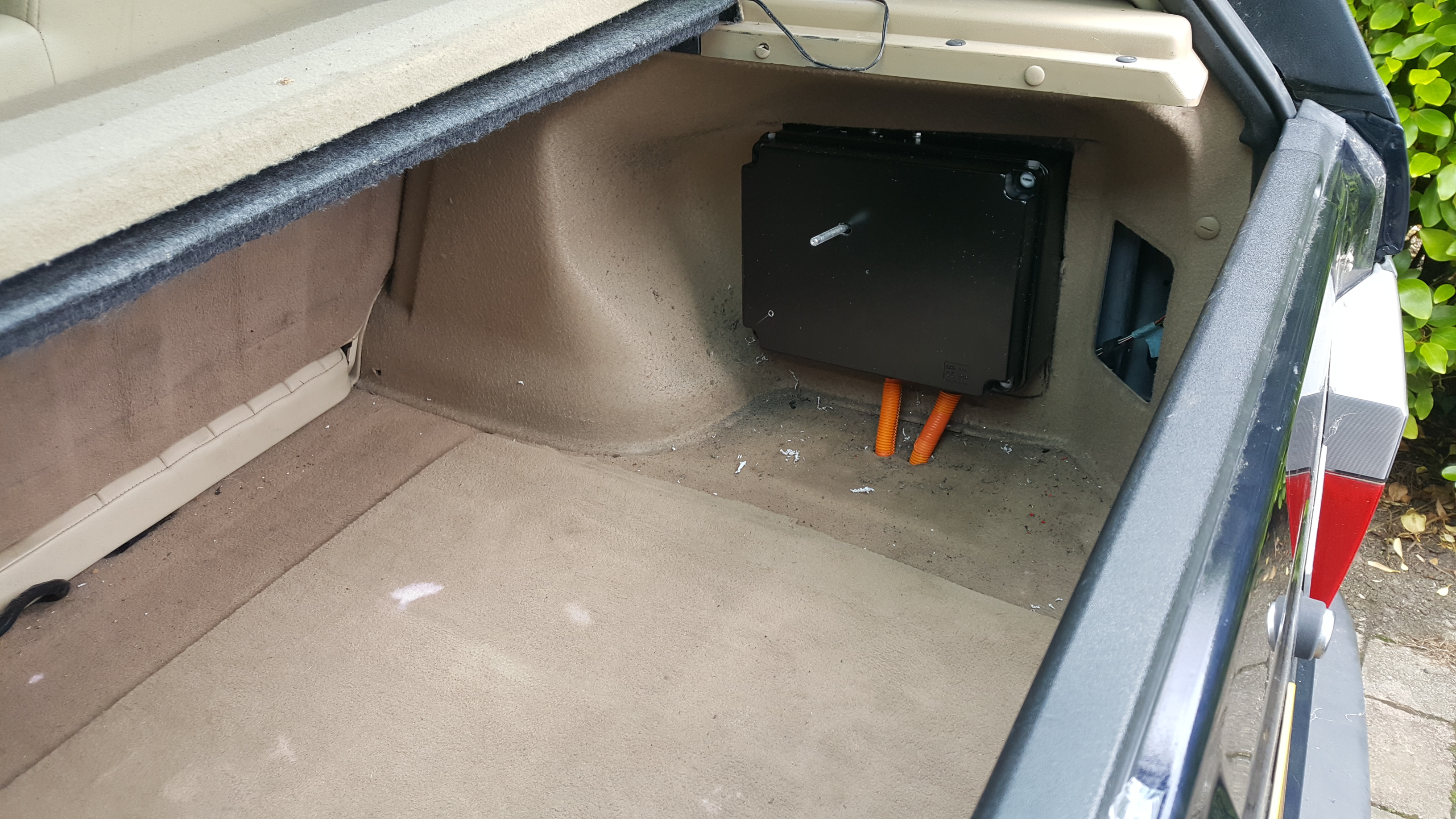

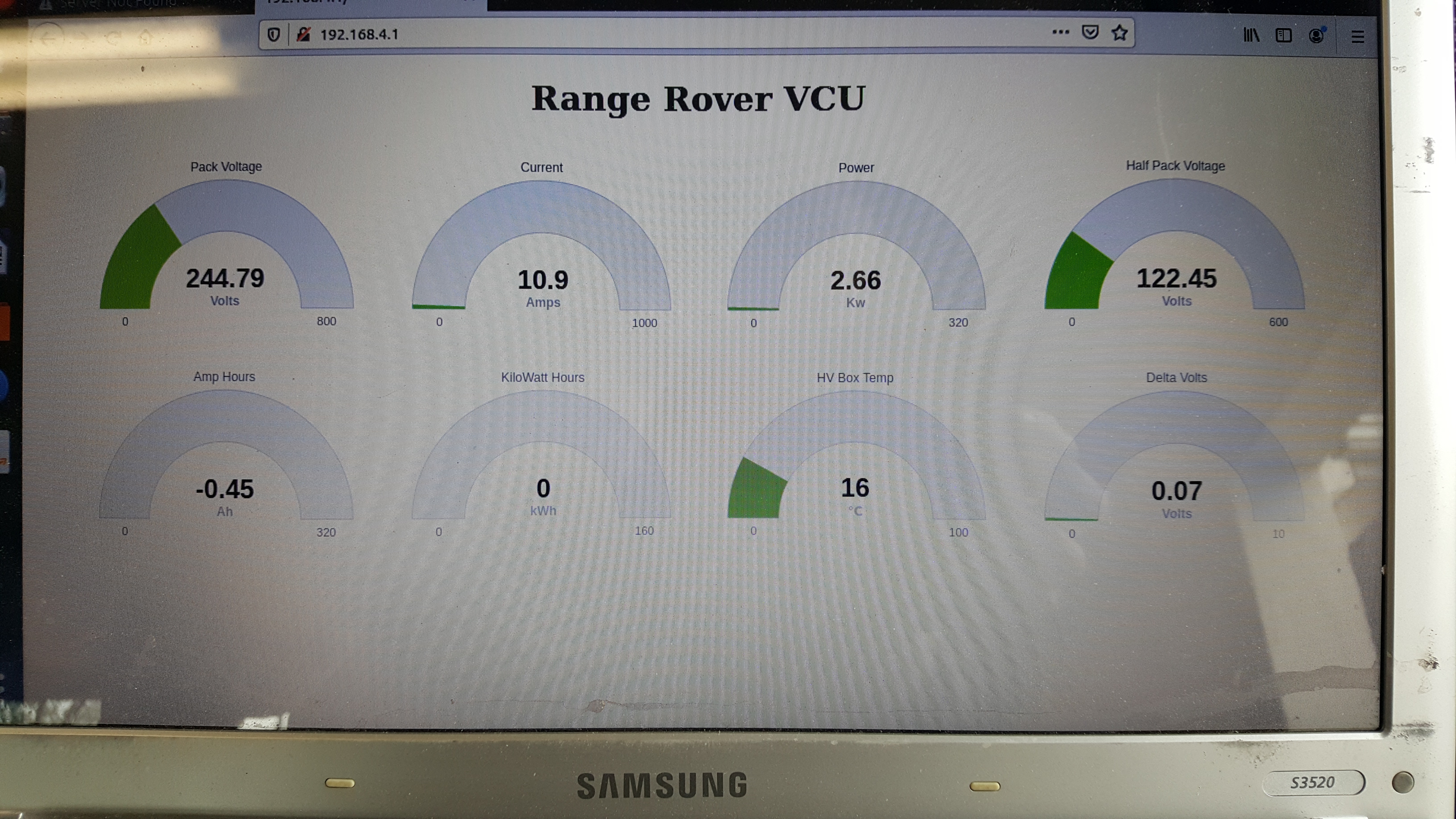

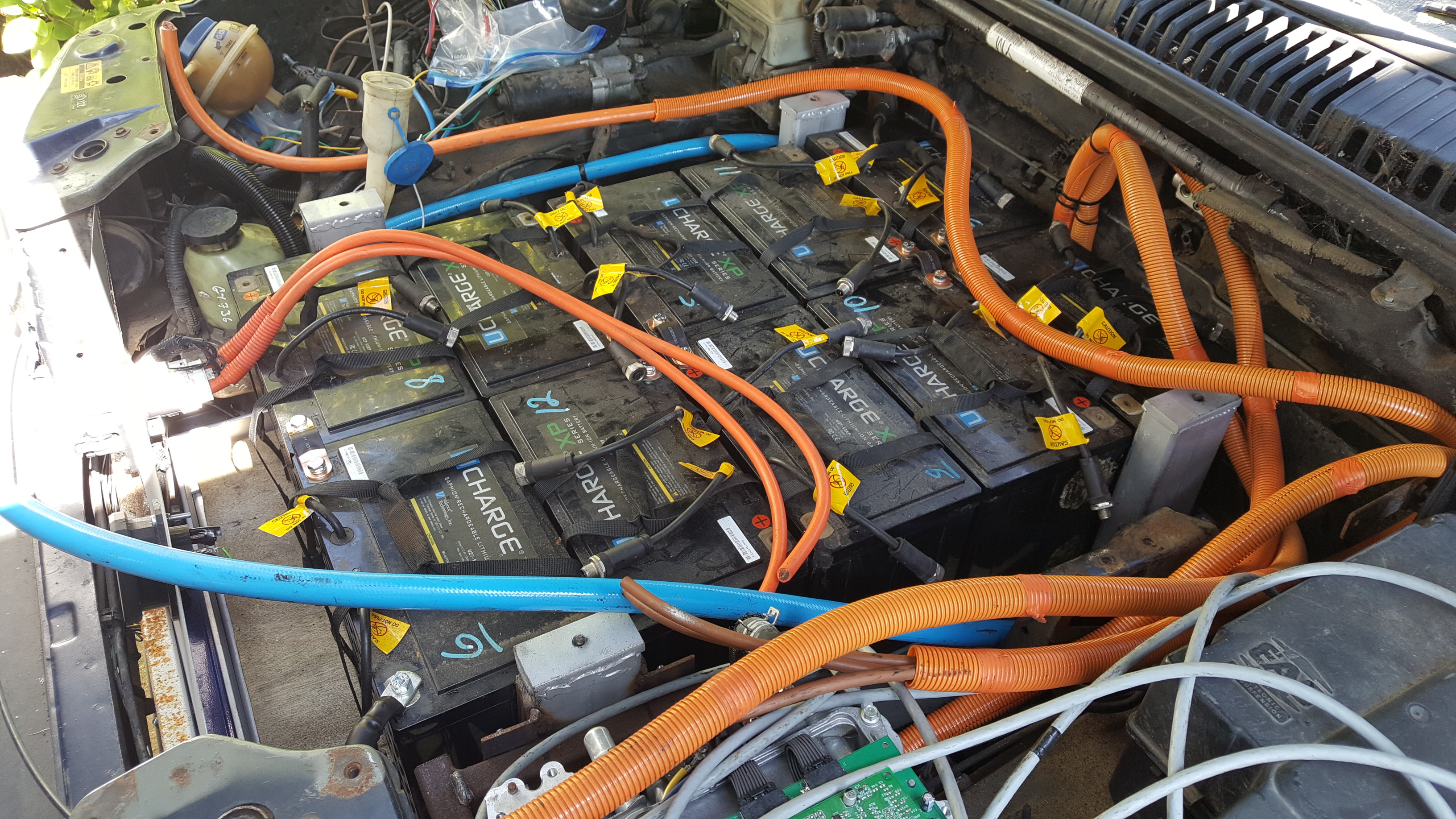

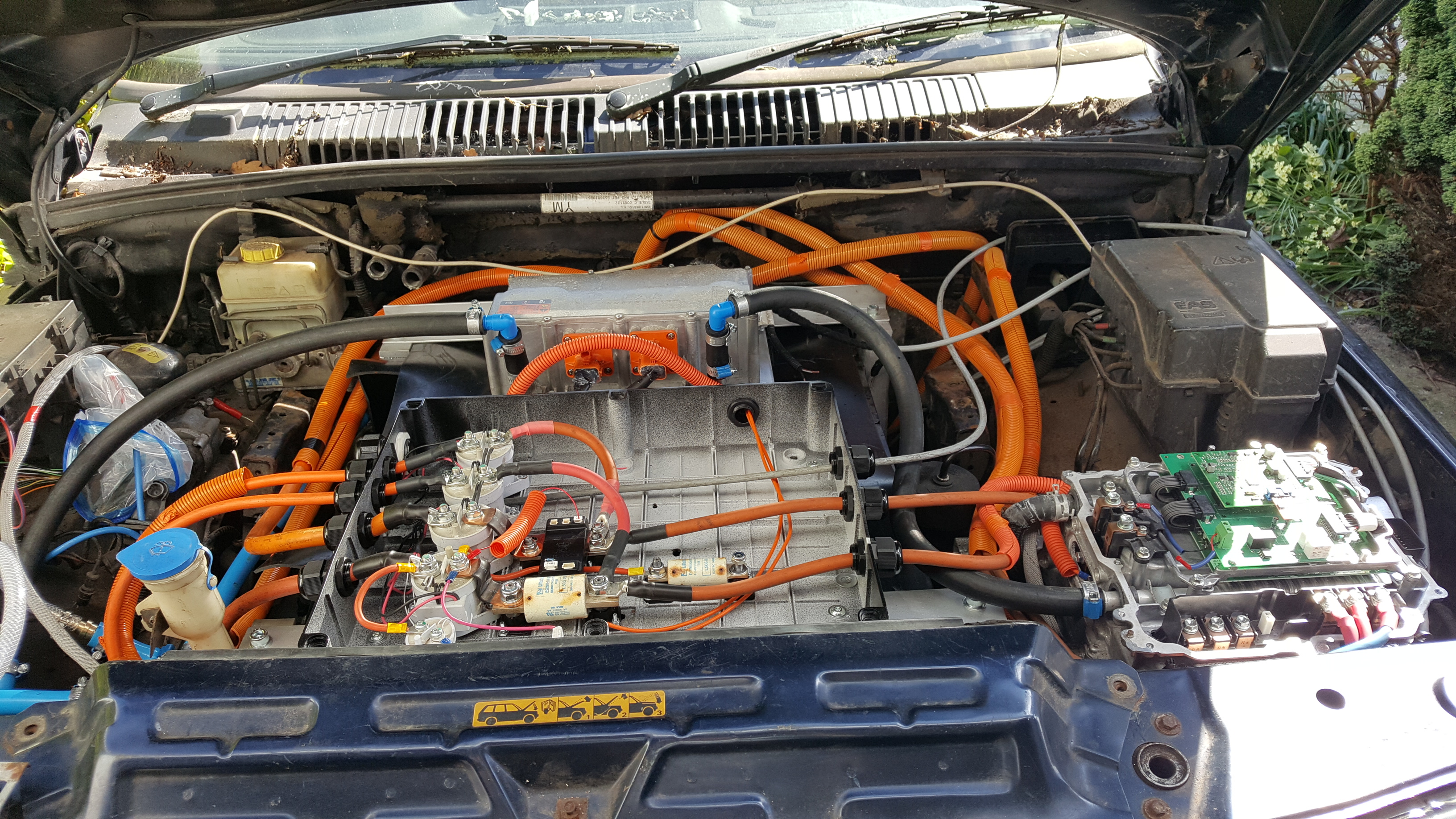

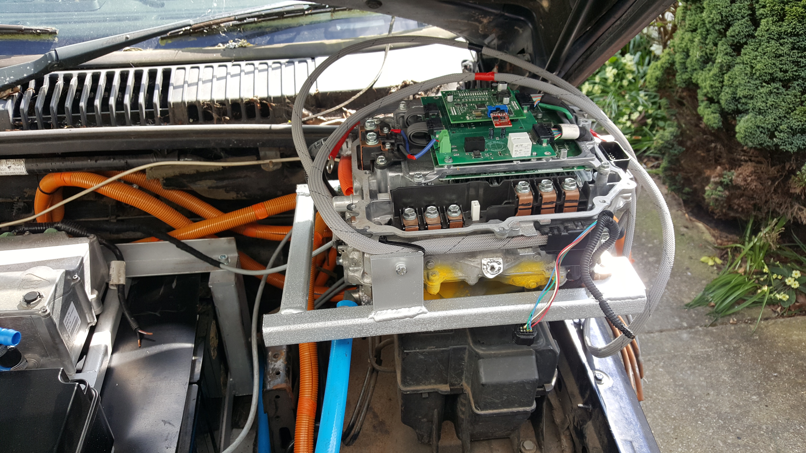

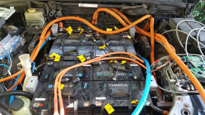

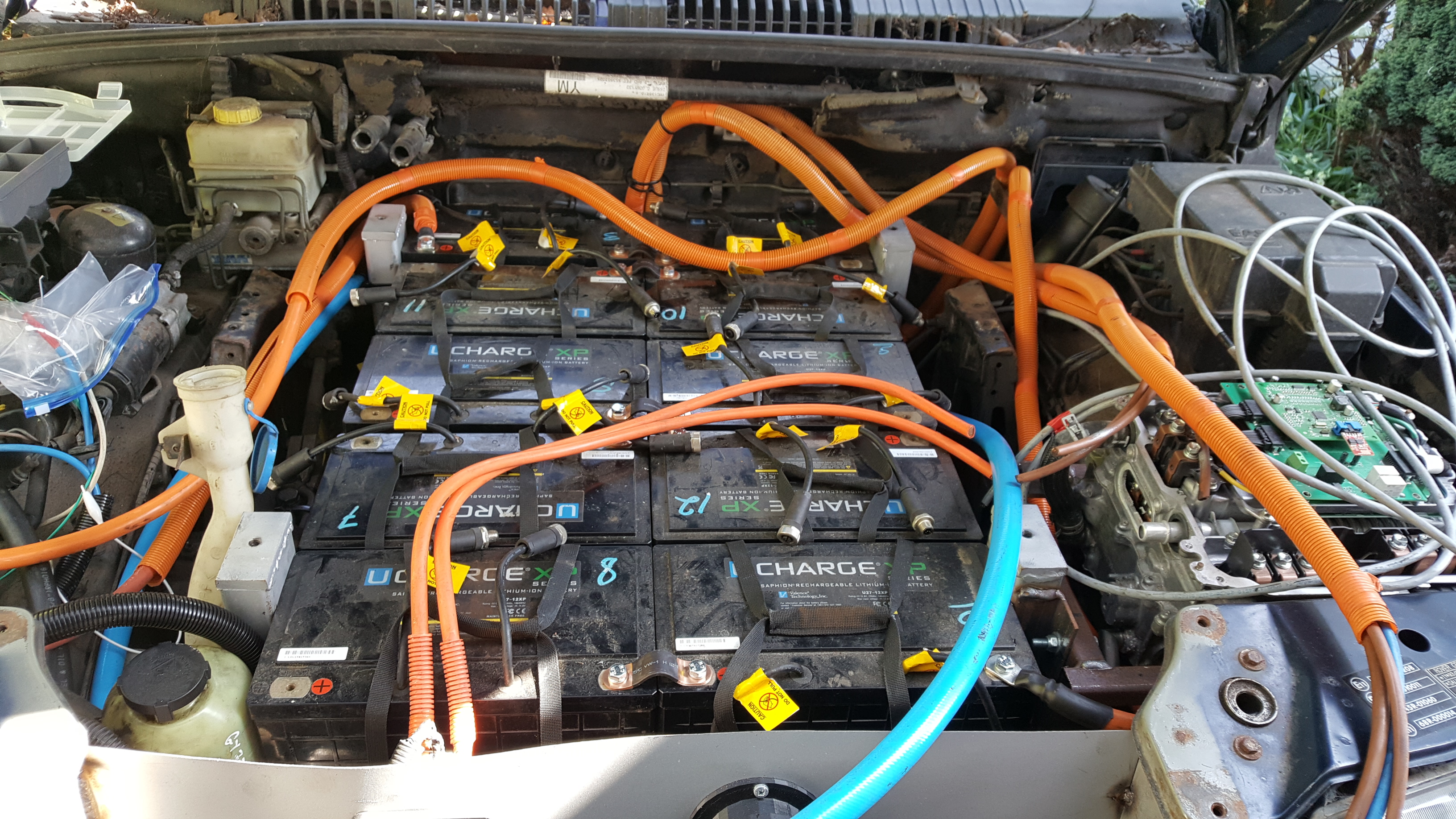

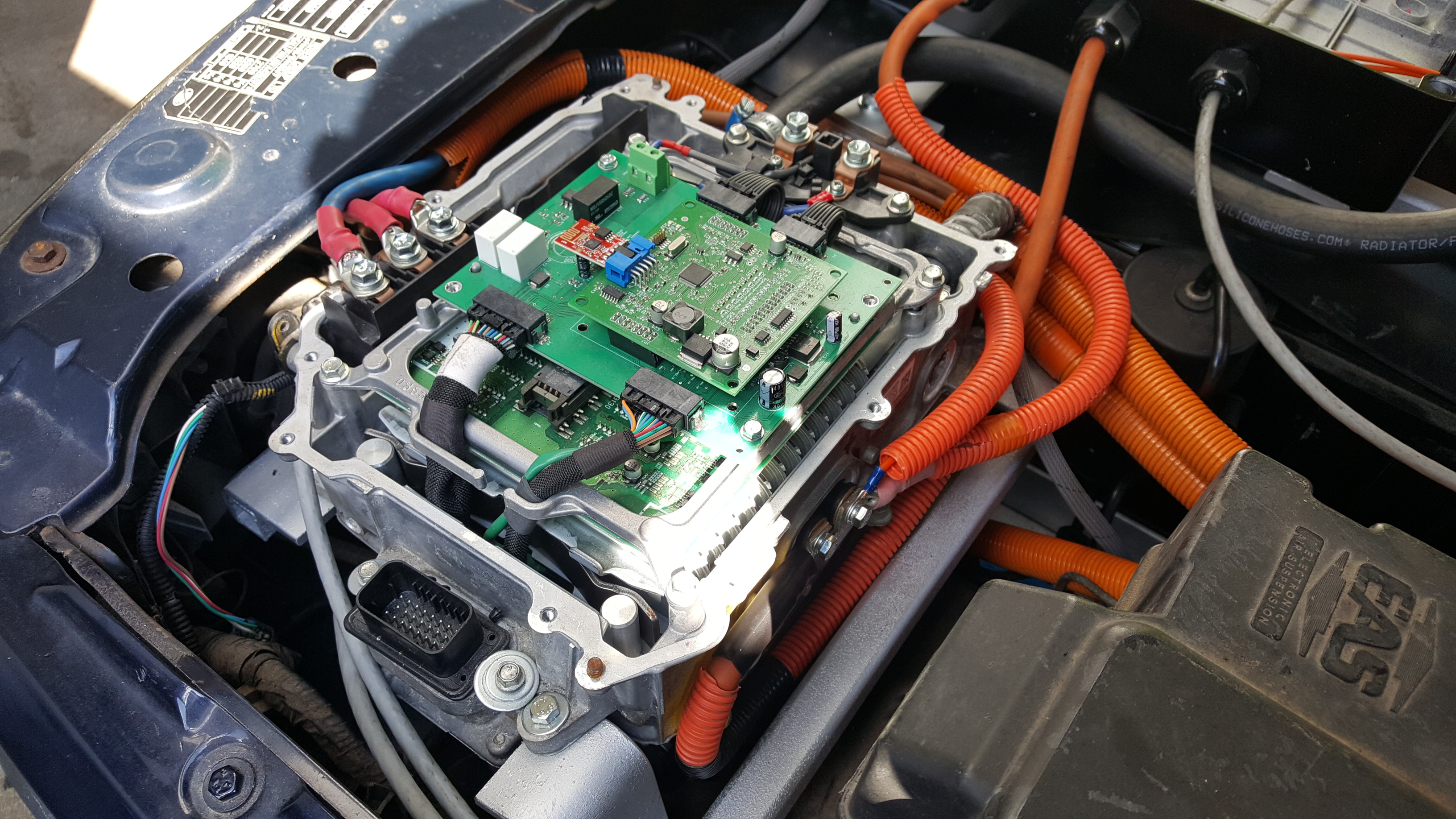

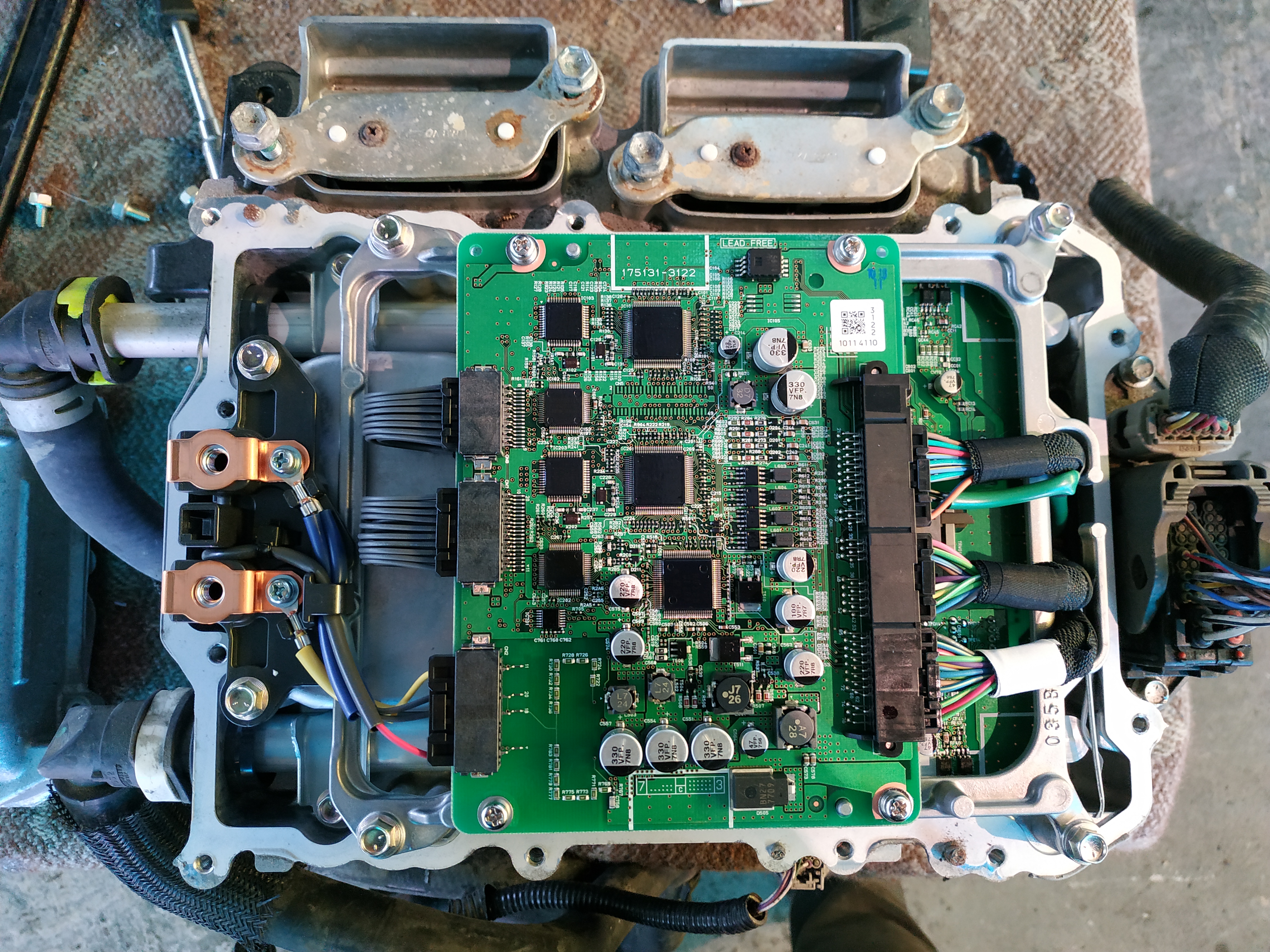

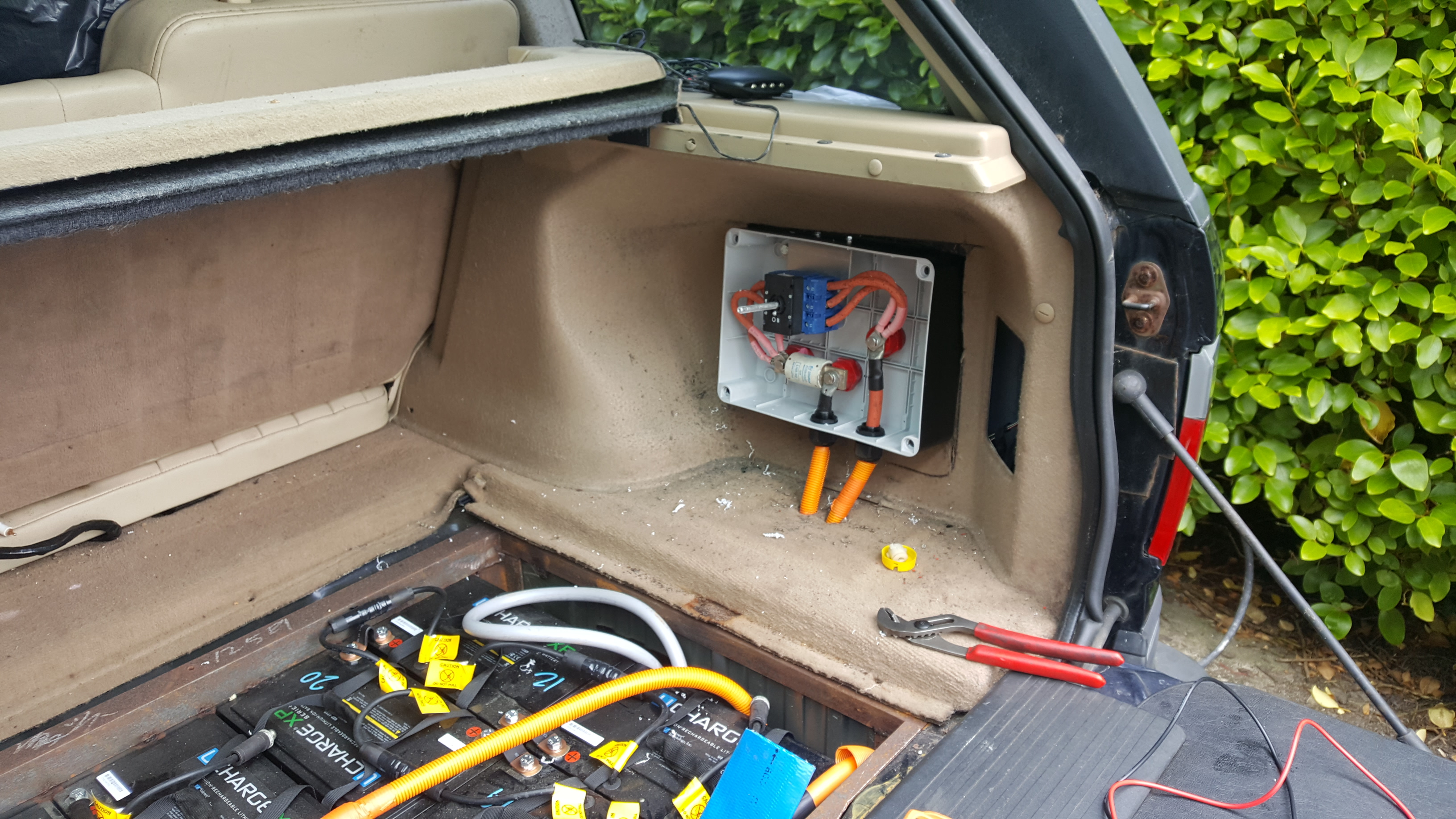

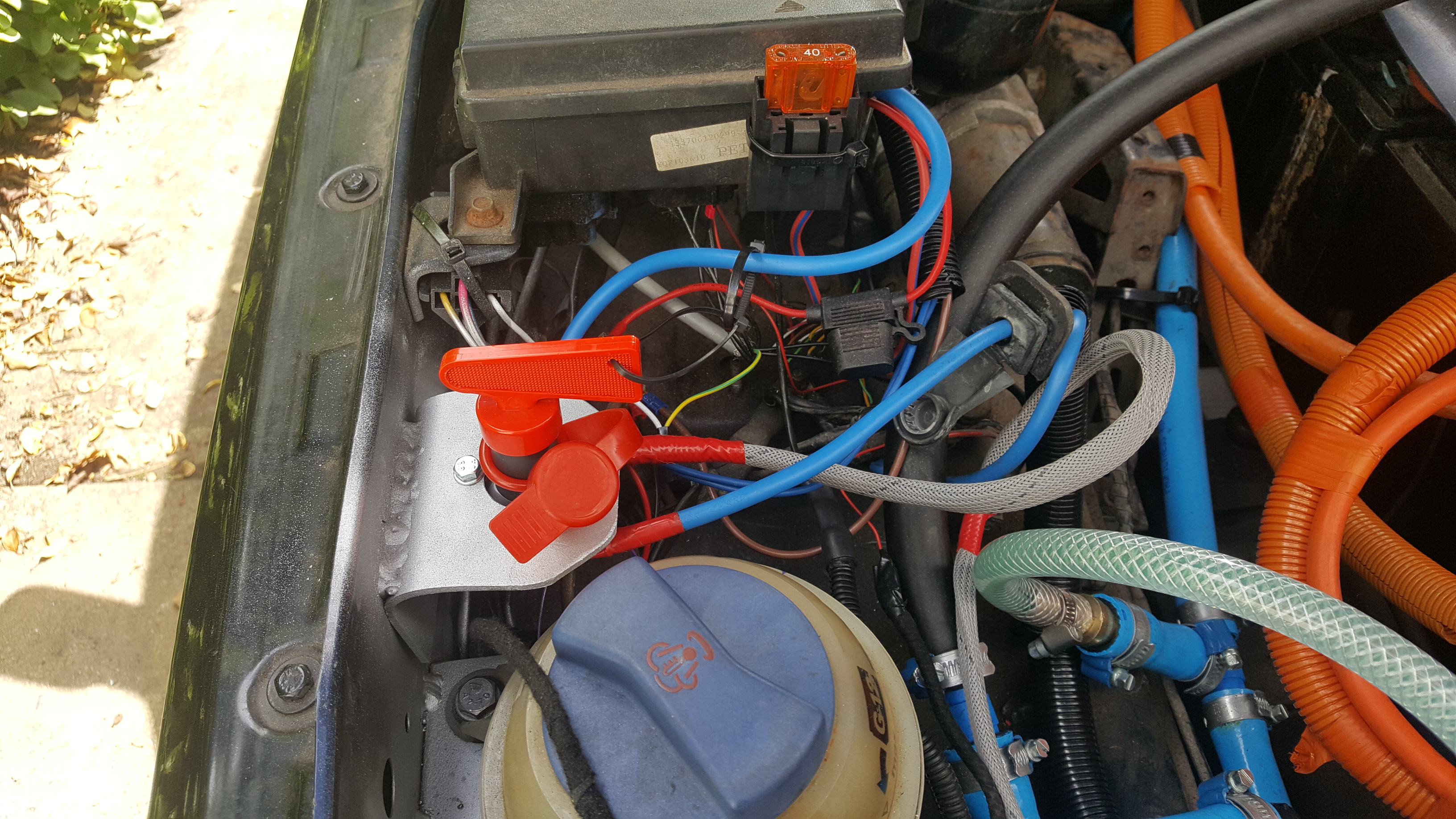

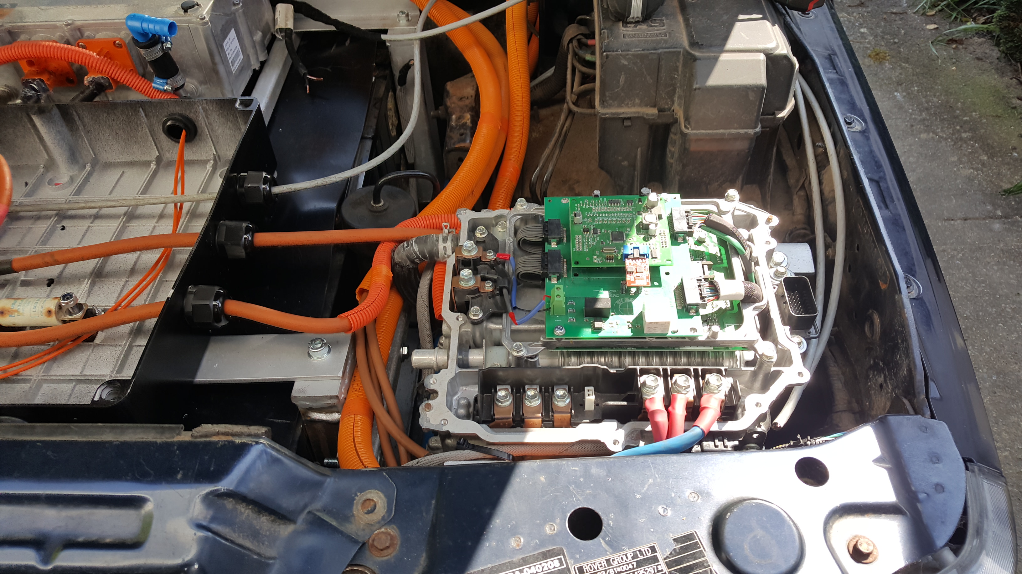

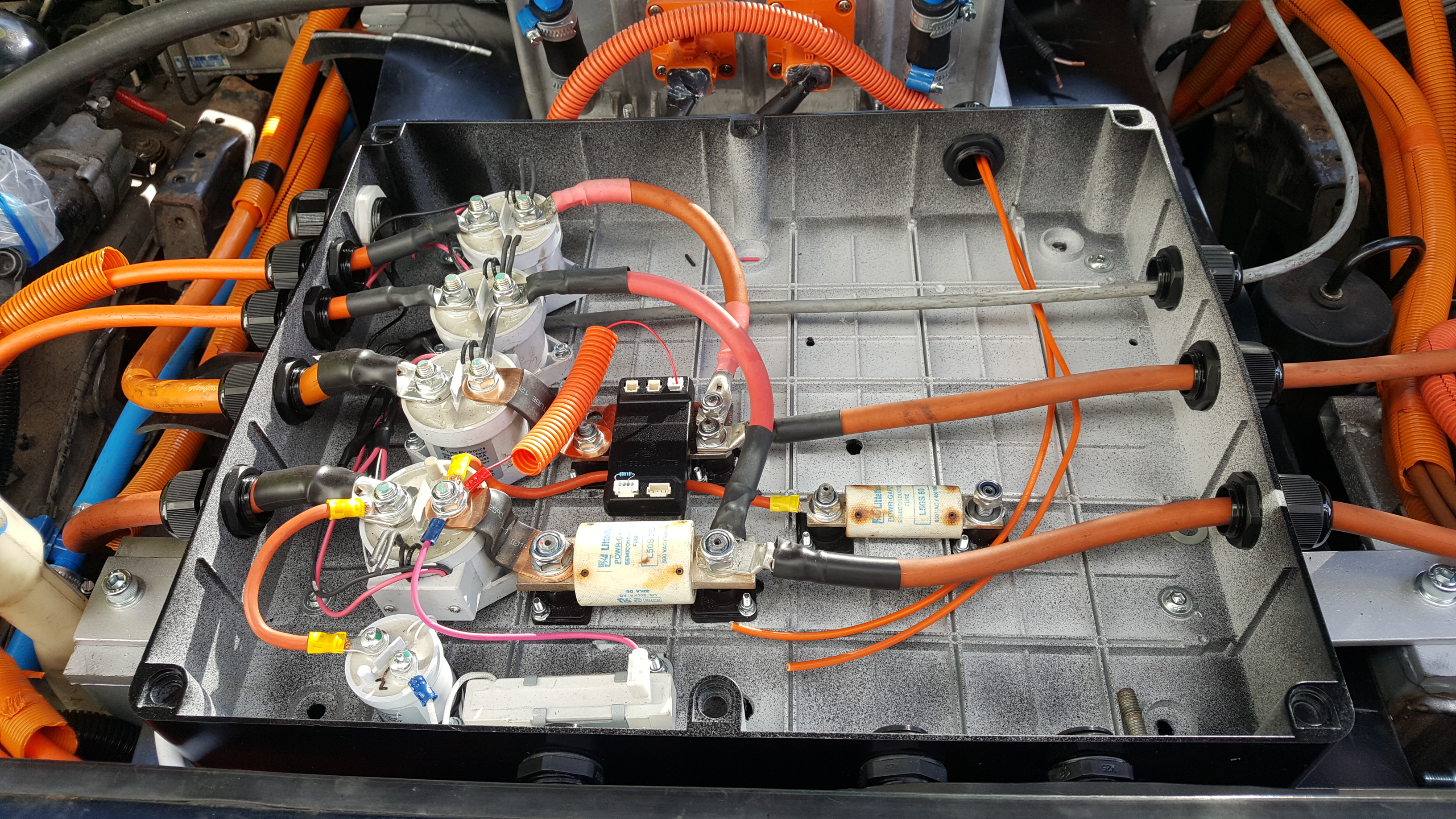

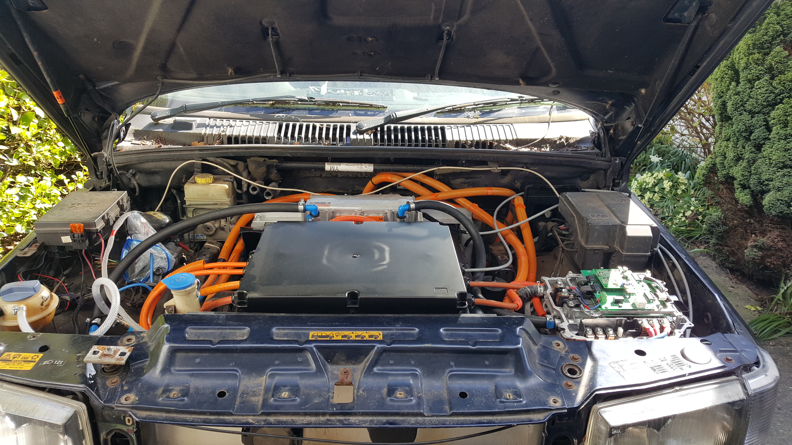

Another De-Ranged Rover image dump. HV system done. Cooling system done. Moving onto modifying a GS450h vcu for tieing it all together. IS300H inverter bench tested and ready to go.

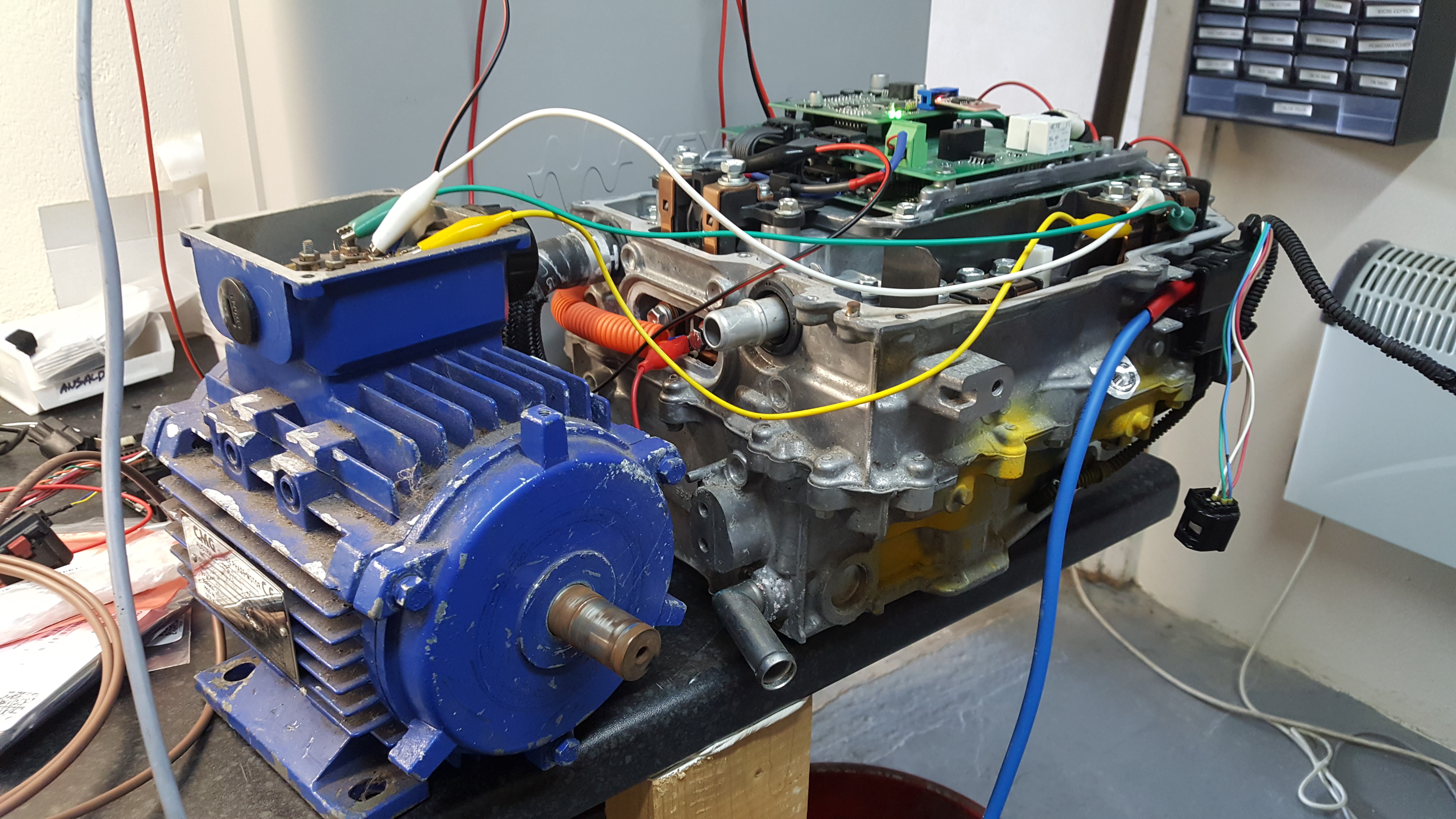

Did I missed something? How are you going to control both motors with Johu's board, if this not a secret, ofcourse.
Board only taking inputs from one motor? Does it just PWMing MG1 inverter in parralel with MG2 without feedback, orienting only by MG2 feedback?
How effective is this? I wondering, because my plan is to make dual motor AWD car with prius mk2 invertor, two MGRs and Johu's board.
- Posts: 4000
No secrets here:) The current board just runs one motor at a time. The next version will have two STM32s one for each motor.

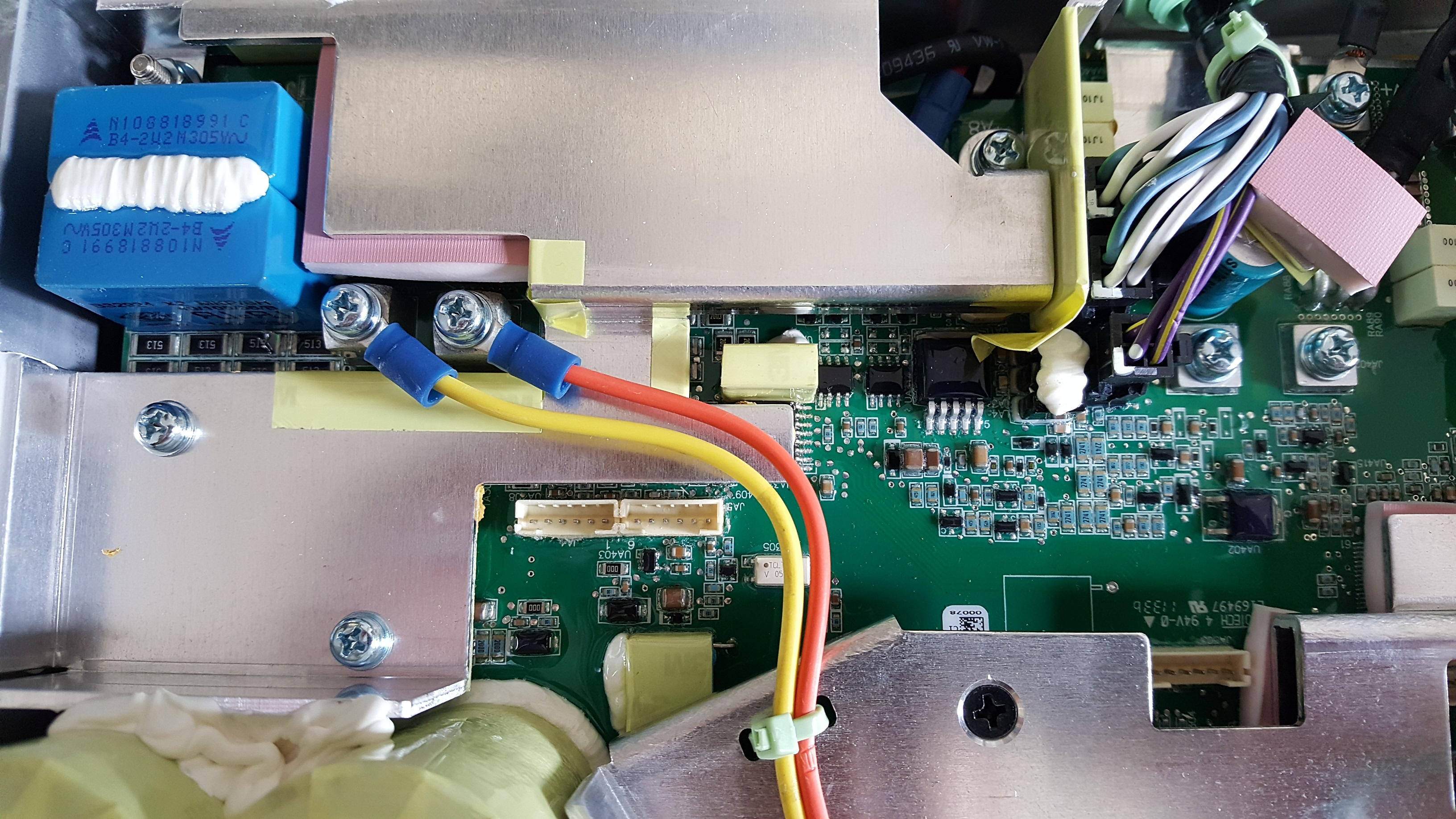

Hi Damien

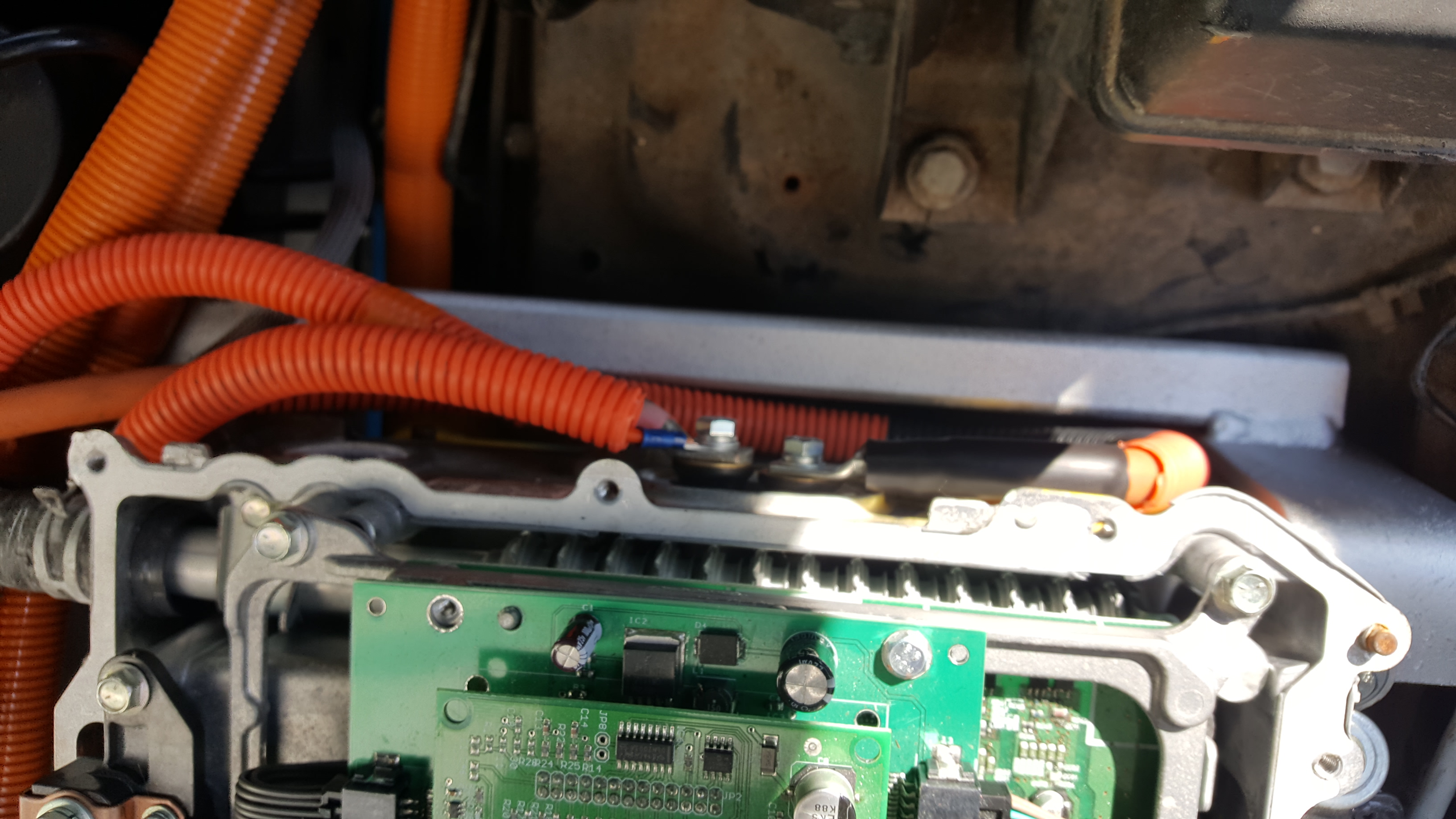

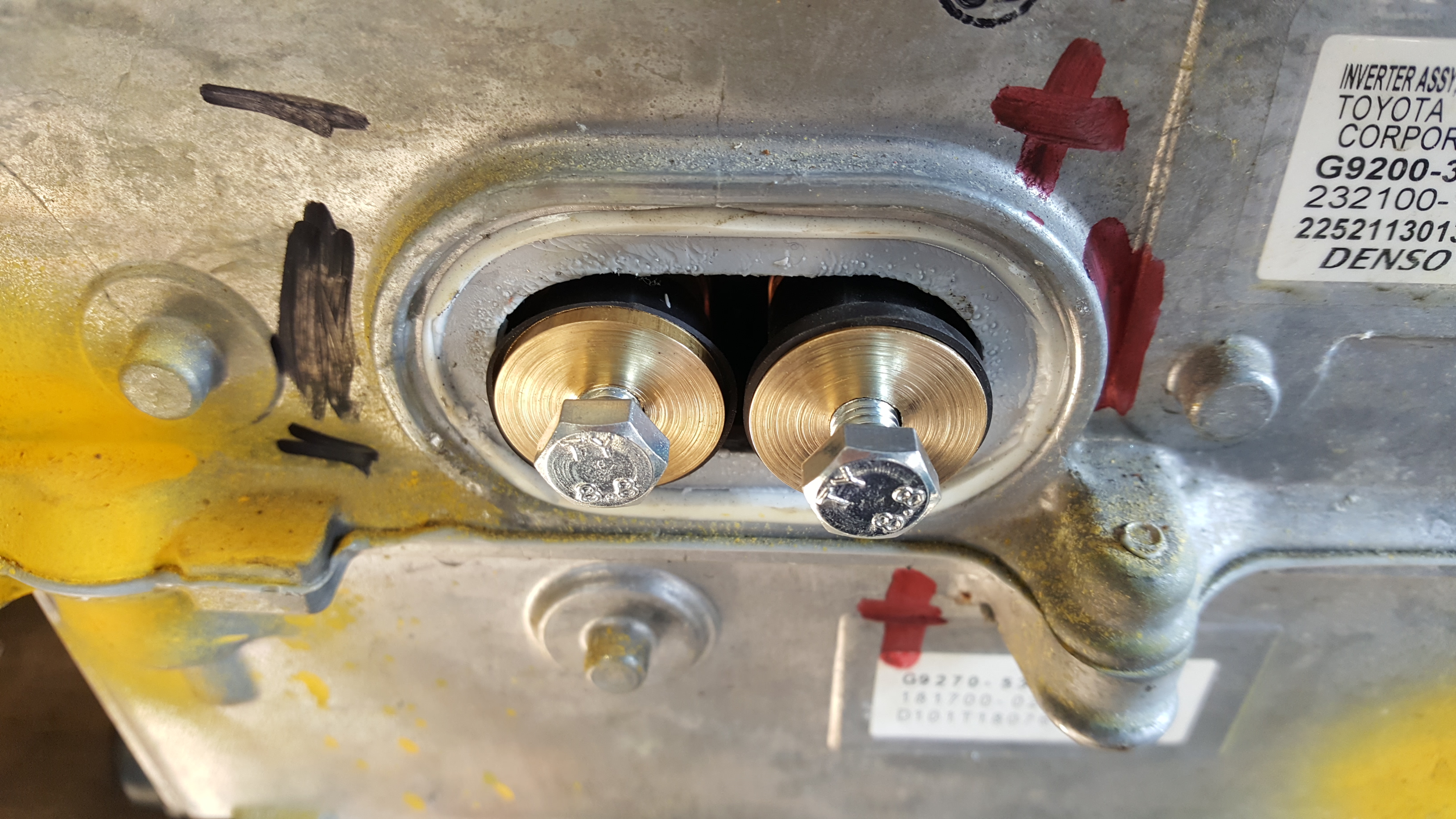

I noticed you bypassed the boost bridge in lexus inverter. Is there a reason? Do you think if you connected HV to original inverter input it would shut itself down due to overvoltage?
It is kinda important for me, since i am getting nowere with Gen3. Even though it can sense up to 420Vdc i cant fire buck from 600Vdc to 360Vdc!
A
A
- Posts: 4000
It's bypassed in order to get hv (240v dc) to the dcdc.

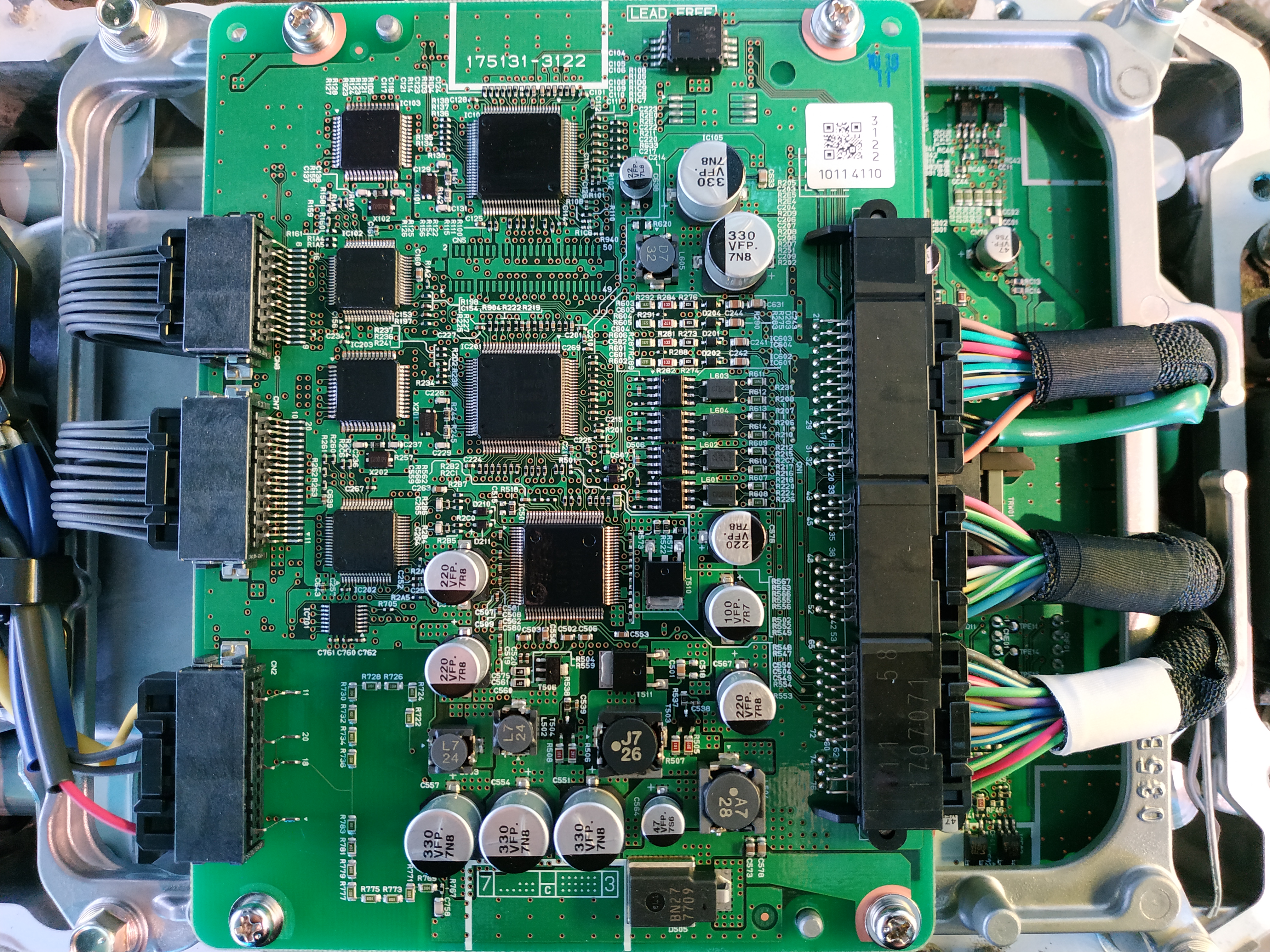

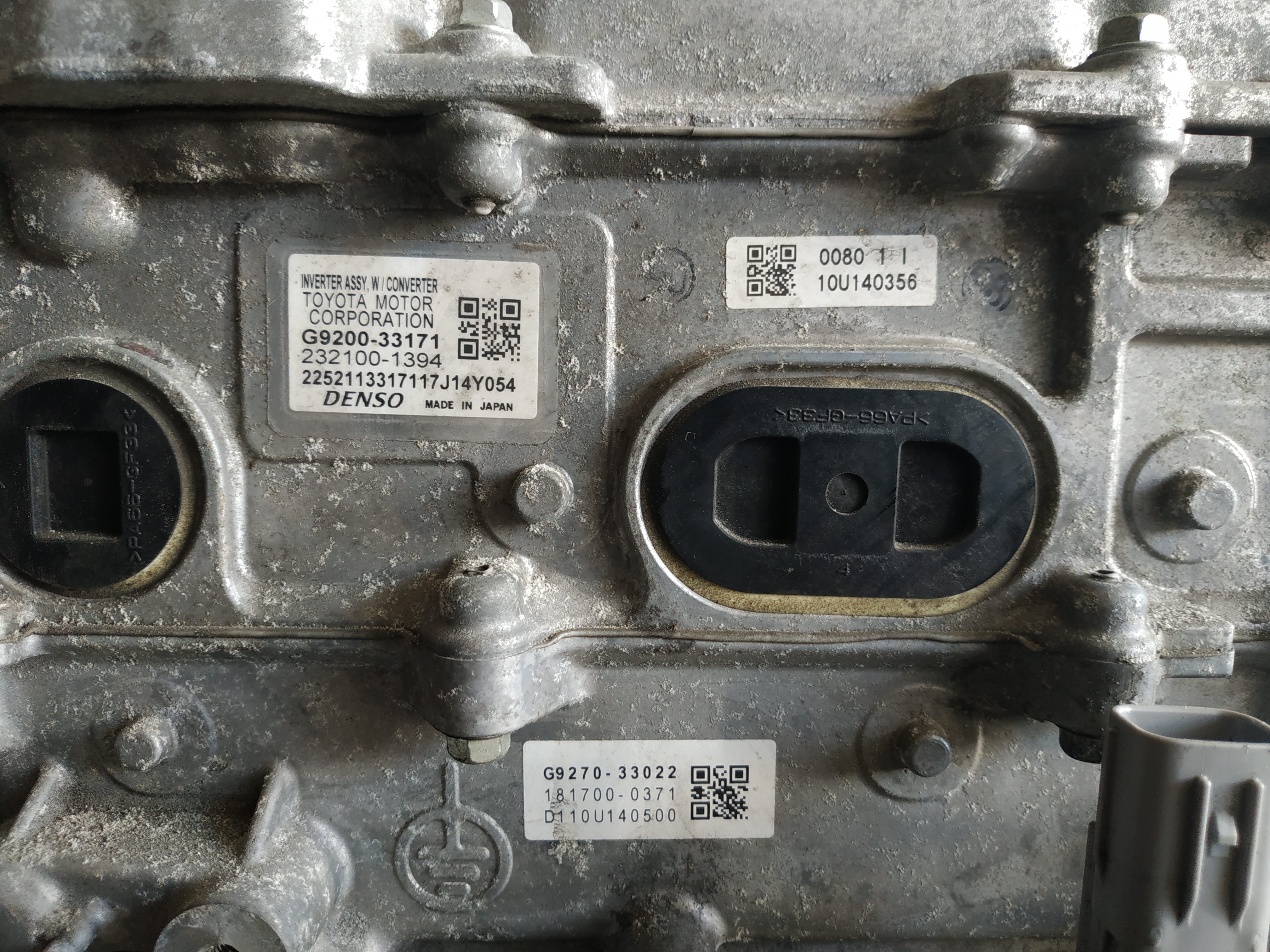

where are the files for the IS300H? im working on that mazada rx8 project, i need the control board for the inverter then im buying the main control board off the webshopJack Bauer wrote: ↑Sat Apr 11, 2020 1:28 pm Another De-Ranged Rover image dump. HV system done. Cooling system done. Moving onto modifying a GS450h vcu for tieing it all together. IS300H inverter bench tested and ready to go.
Isaac96
- Posts: 656
https://github.com/damienmaguire/Lexus-IS300H-Inverter
Should be all you need, it needs a Rev3 brain board.
