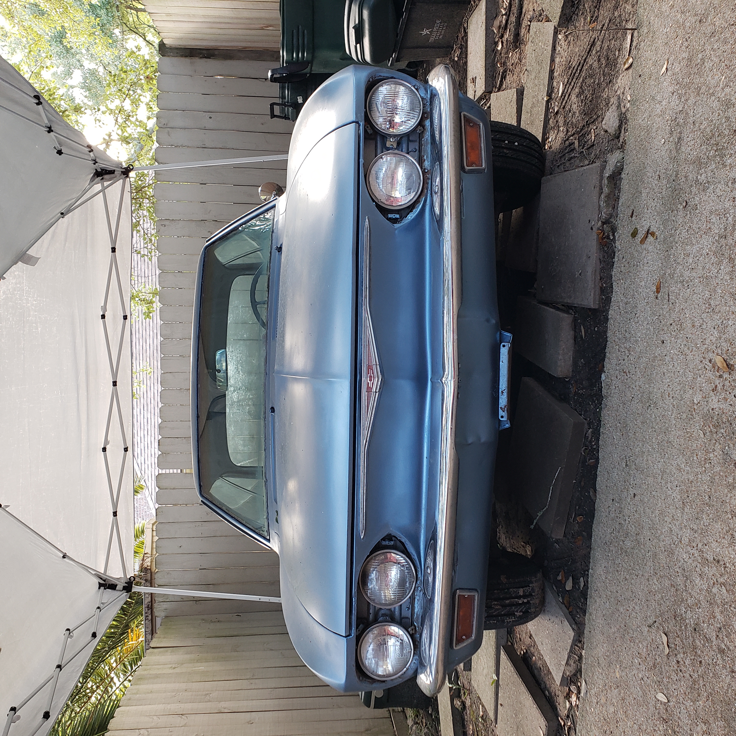

I'm still pretty new here (bare with me) and working on my first EV build using a 1965 Corvair Monza as a donor:
Originally, I was going to attempt a conversion similar to that of the Electrovair 3 done by High Voltage Hotrods:
https://www.youtube.com/embed/84xgjU1V0Ws
They accomplished this by mating the motor via adapter plate to the bell housing 86'ing the engine as seen in the following:
This would limit me to stock performance at 110hp, about 80kWh on a good day. The Powerglide transmission for this year is pretty solid from what I've gathered in Corvair forums and can take some tactical abuse. BUT even if I were to modify the governor, trick the vacuum modulator, and pray the hollow input shaft holds, I still would not be able to find out what a motor can handle.

Right, back to the 'vair. With what I've learned regarding the powertrain, I began looking around and around at different motors and others' setups.. DC or AC... AC or DC... while that was going down, I decided to get the 'vair up and running with the ICE so I could get a feel for how it was meant to drive.
I couldn't get her started initially, and looking at fuel off the fuel pump I noticed something foul afoot:
Bad gas... probably older than me! So, I changed the fuel filter, drained the old gas, and inspected the carbs... really, a bread tie holding a throttle rod on?

Re: The Corvair Chronicles
That's a good lookin' 60 year old car! I am so excited for this project; I've loved the Corvair since seeing a V8 mid-engine conversion at the local car show. Do you have any suspension upgrades planned for after the drive swap? Also, what batteries are you thinking about?
Thanks Fire! The frame seems to be straight by the way the doors, trunk, and "frunk" close, but I won't know until I remove the ICE systems and get further into it. The driver rear is lower than the rest of the car so that shock must be bad, but I'm going to upgrade the set anyway, possibly doubling up with new coils as well. I haven't done too much homework on upgrades because it's hard to tell what I'll need until I've got the final weight of the battery pack squared away. Let it drag, am I right? jk
