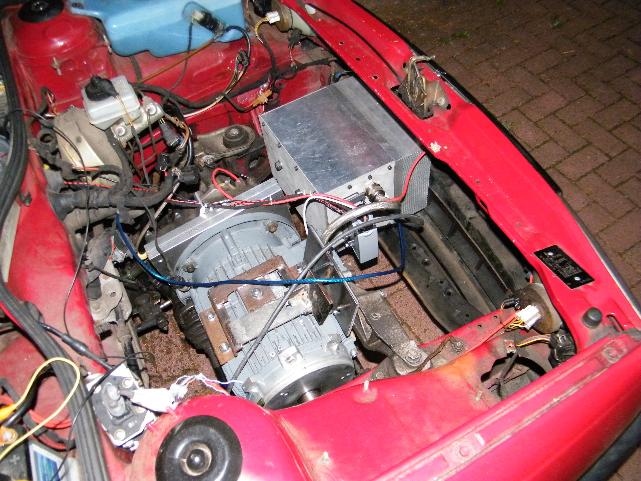

  • 18.5kW Industrial ACIM (Lenze MFEMAXX132-22C1C)
  • Homebrew AC controller (using 1200V, 400A IGBTs)

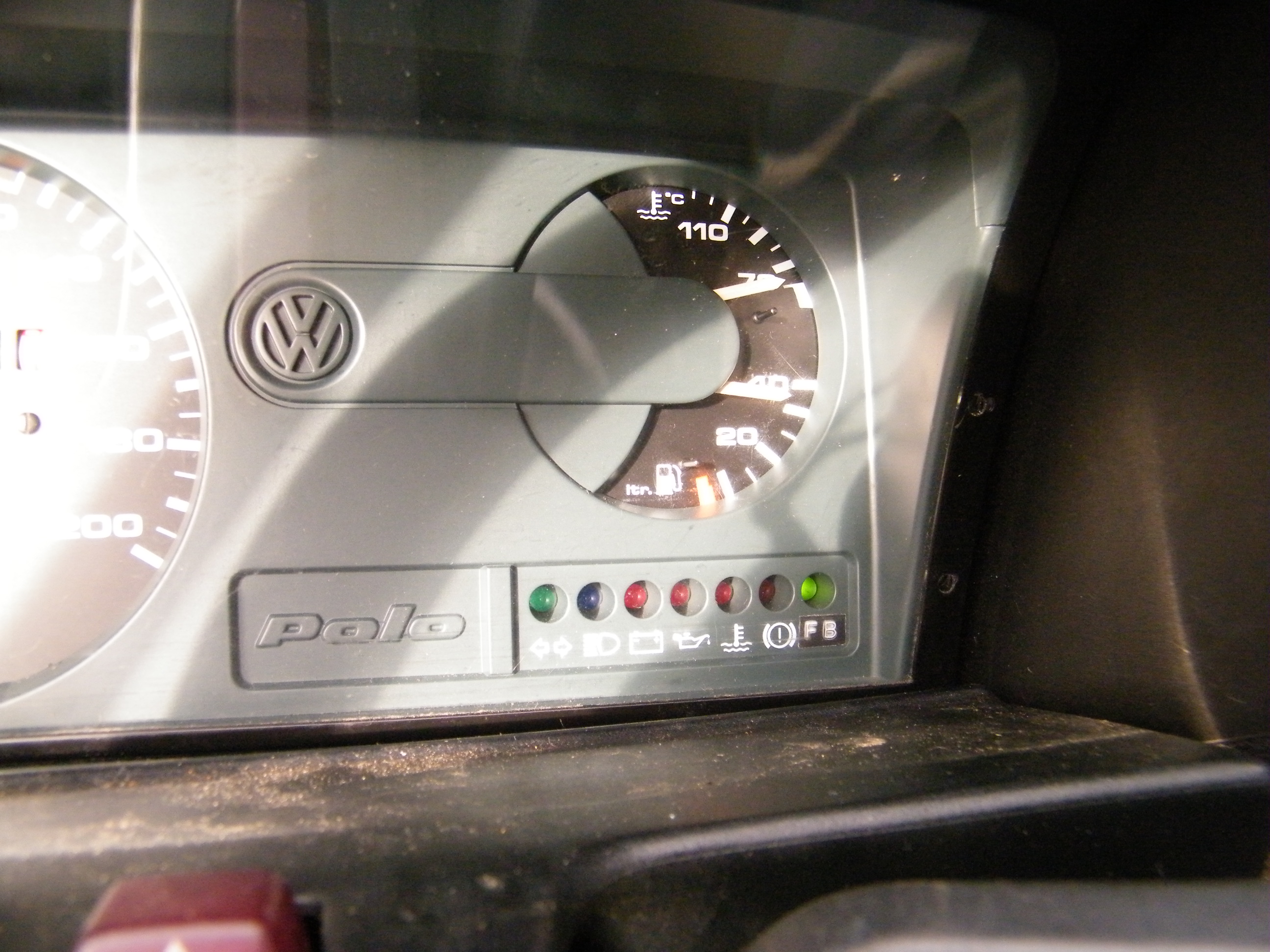

I use the existing temperature and fuel gauge as well as the warning lights. Reverse gear is selected with the transmission.
Kilometers driven to date: 25.000km
Temp gauge shows motor temp, fuel gauge shows SoC, batt light shows high/low voltage warning, oil light shows error, green light shows ready to go.

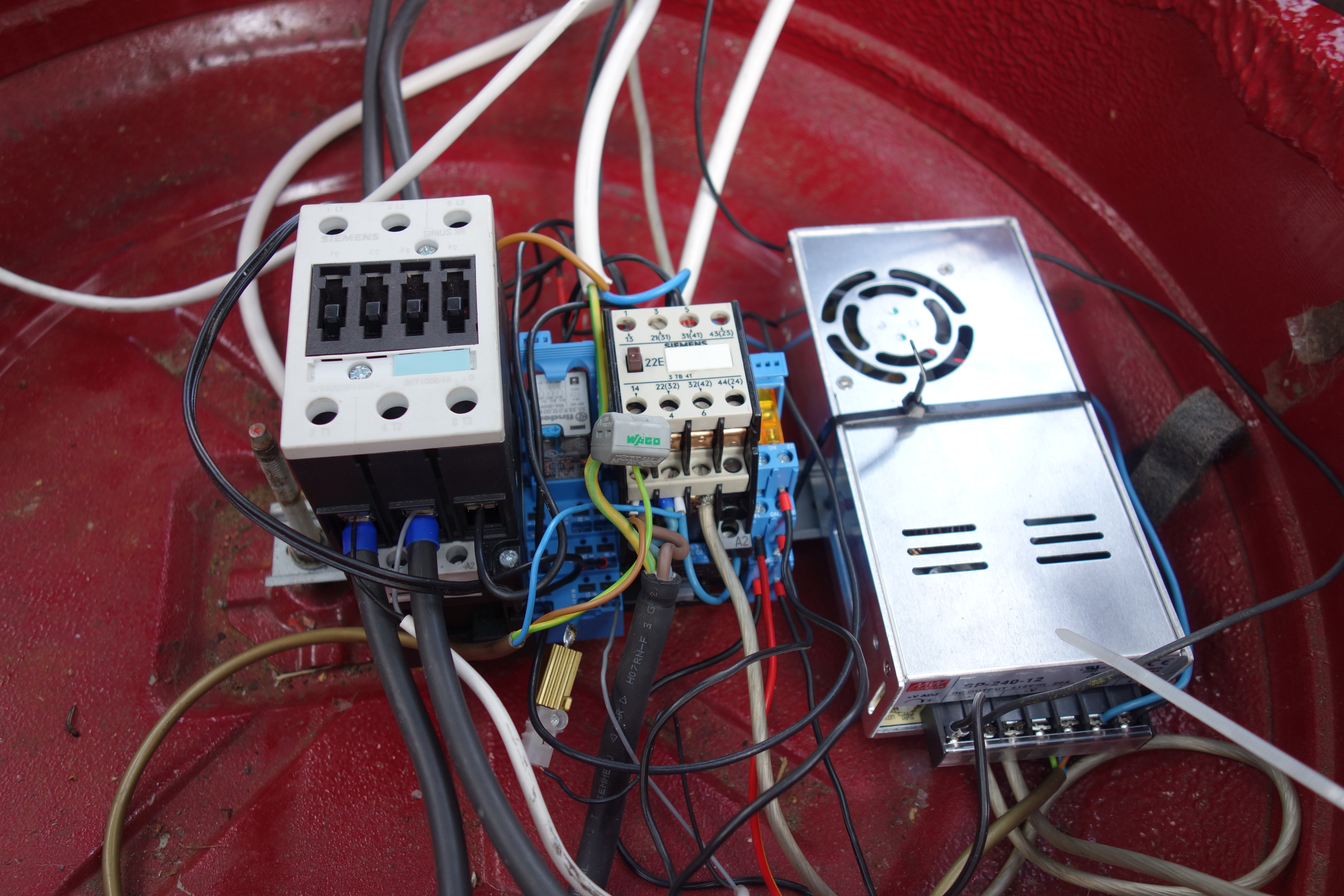

Left to right: Main DC switch, precharge, AC disconnect, AC present relay, 12V system charger (aka Meanwell PSU)

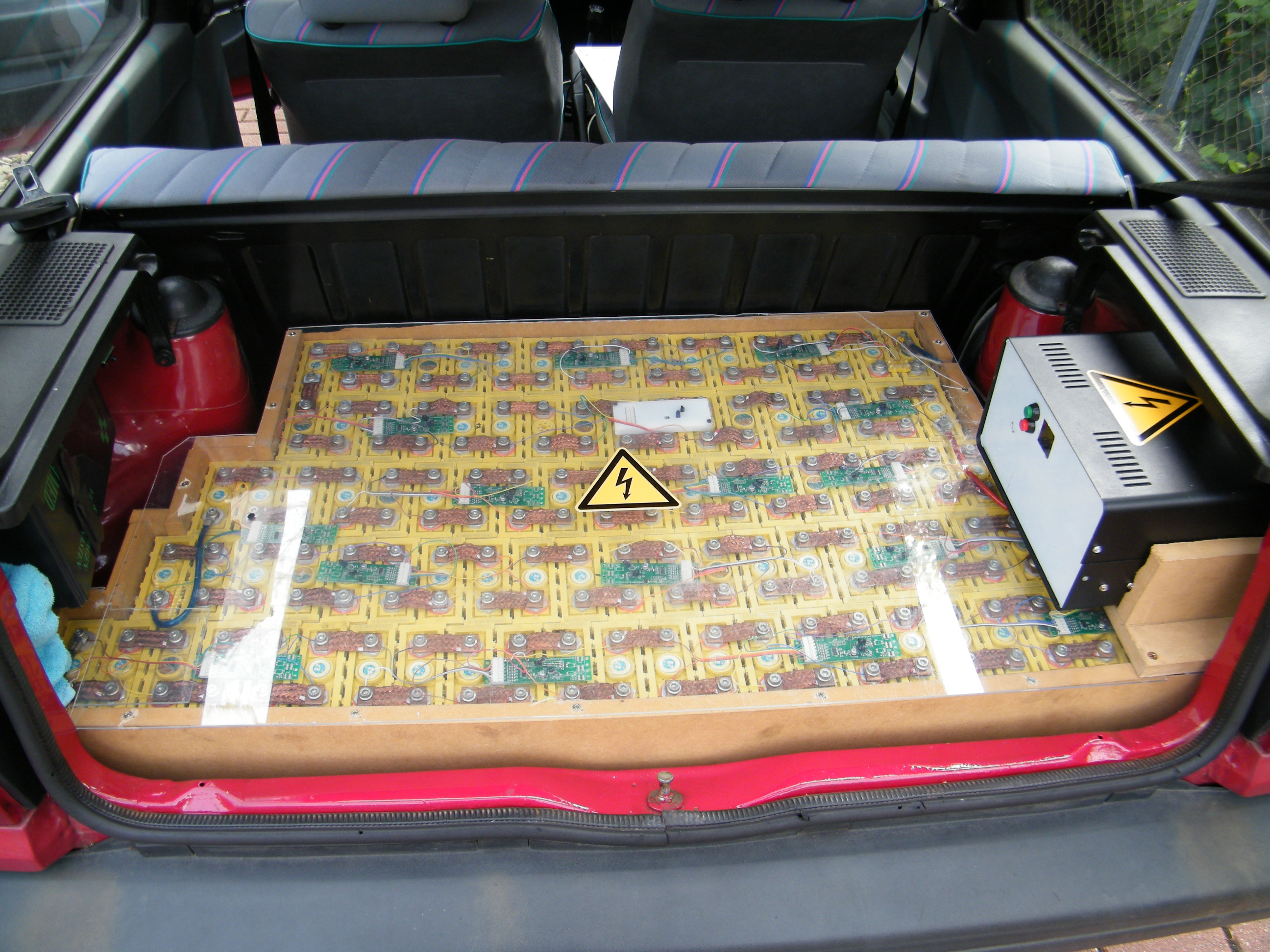

99 cells in the back

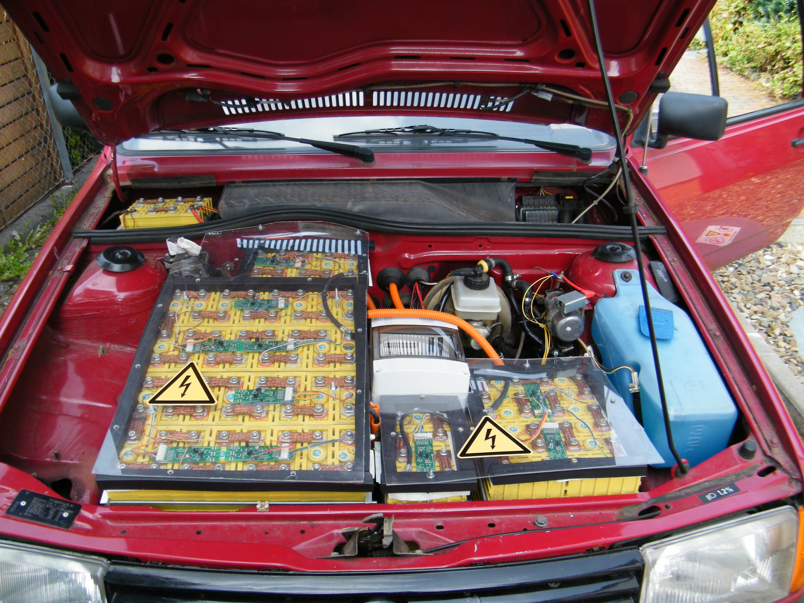

53 cells in the front
Inverter, motor and batteries are passively cooled

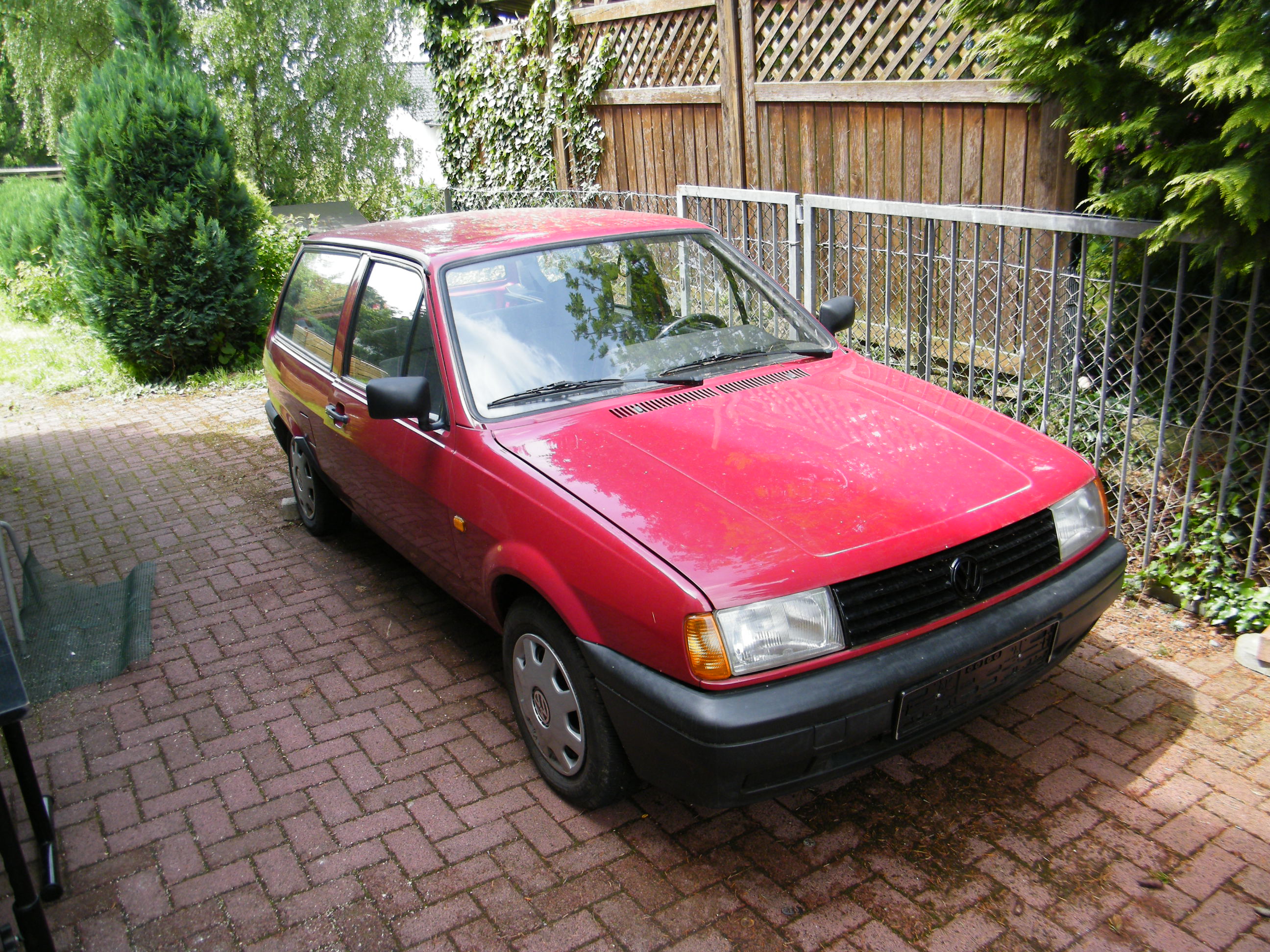

The donor - 1.0 petrol Polo
