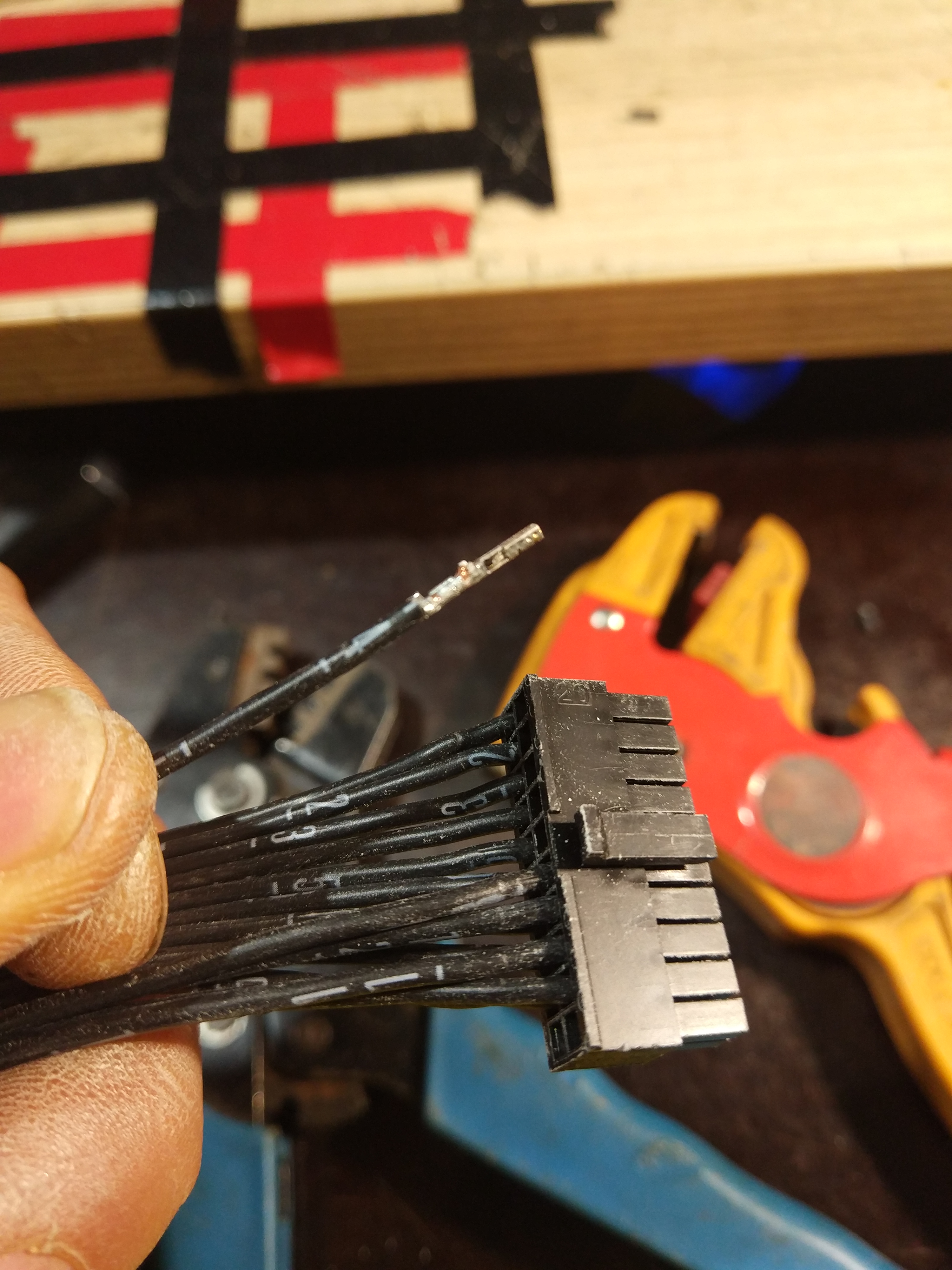

Maybe you can trace back the wiring for the other beeper? Then just put your own in.
-Isaac
-Isaac
- Posts: 3795
- Has thanked: 166 times
- Been thanked: 411 times
Re: Peugeot 406 coupe Pininfarina with Leaf motor and Ampera inverter
I already installed beeper in the drivers door. It chimes annoyingly if you open the door. This should do for now. Later on i will find one 12V contact supply wire that will work only when key is turned. I believe windows are powered only if you insert the key. I will steal one wire there.

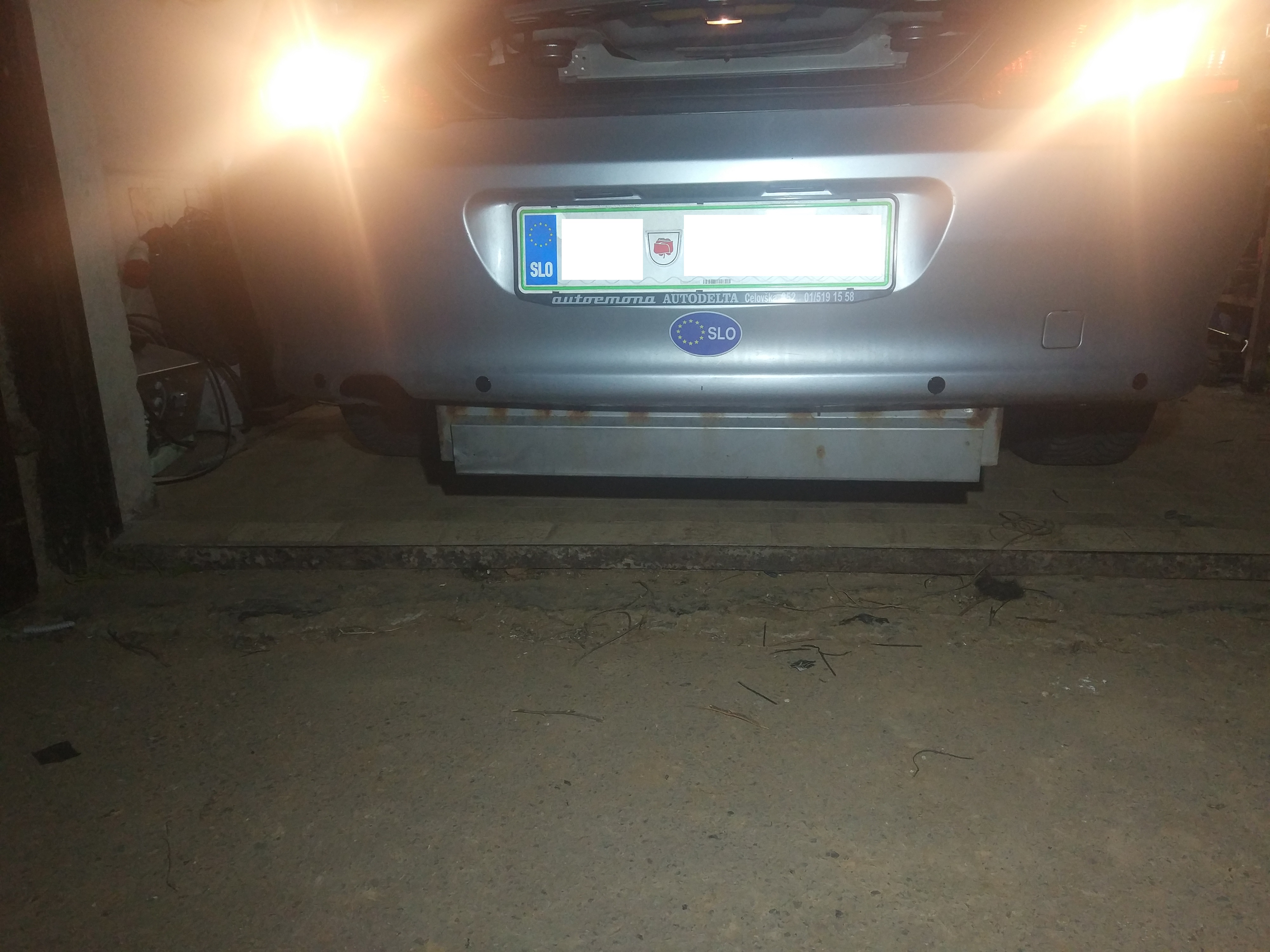

Further list of demands:
13. There is a demand to declare battery box content in battery cell configuration and in kW. I made stickers on the cover.
14. Maximal voltage is derived from that parameters. I surprised them when i declared lower maximal voltage they expected. I explained them i will not charge more than 4.05V per cell and that ammounts to 389Vdc. They expected 4.2V per cell.
15. Also they demand battery box has a vent on the lowest part to vent gas that may form inside box. I used 2x regular 8mm tire vents and simply bolted them from the inside out.
16. Also all removable battery box covers, battery boxes, DCDC, Charger, inverter and motor that is not welded in need to be connected to car chassis by 6mm2 discharge cable. I used braided copper cable shield from some cables that i took apart for signals. In any case you need good connection between motor - inverter- chassis because of signal immunity!
17. You need to weigh an empty car when conversion is complete. I did it at a scrap yard where they can also issue you some official receipt. Mine is now 1.450Kg whereas with old gas guzzler it was 1.650kg! Quite an improvement over all hydraulic ATX and large 3,0L V6 engine.
18. We derived max speed from motor max declared RPM divided by final drive ratio. I think it is 158km/h which is still respectable i think.

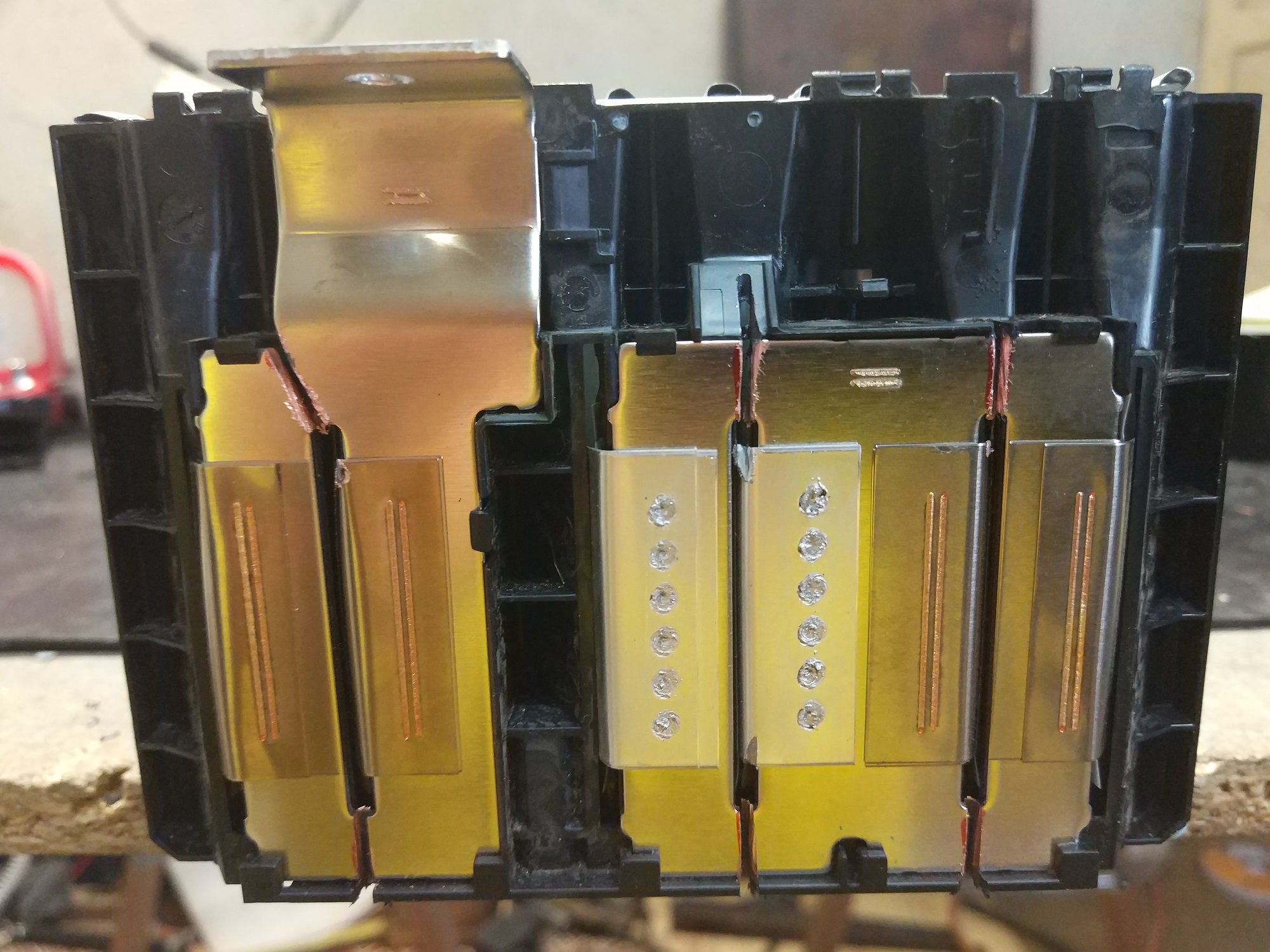

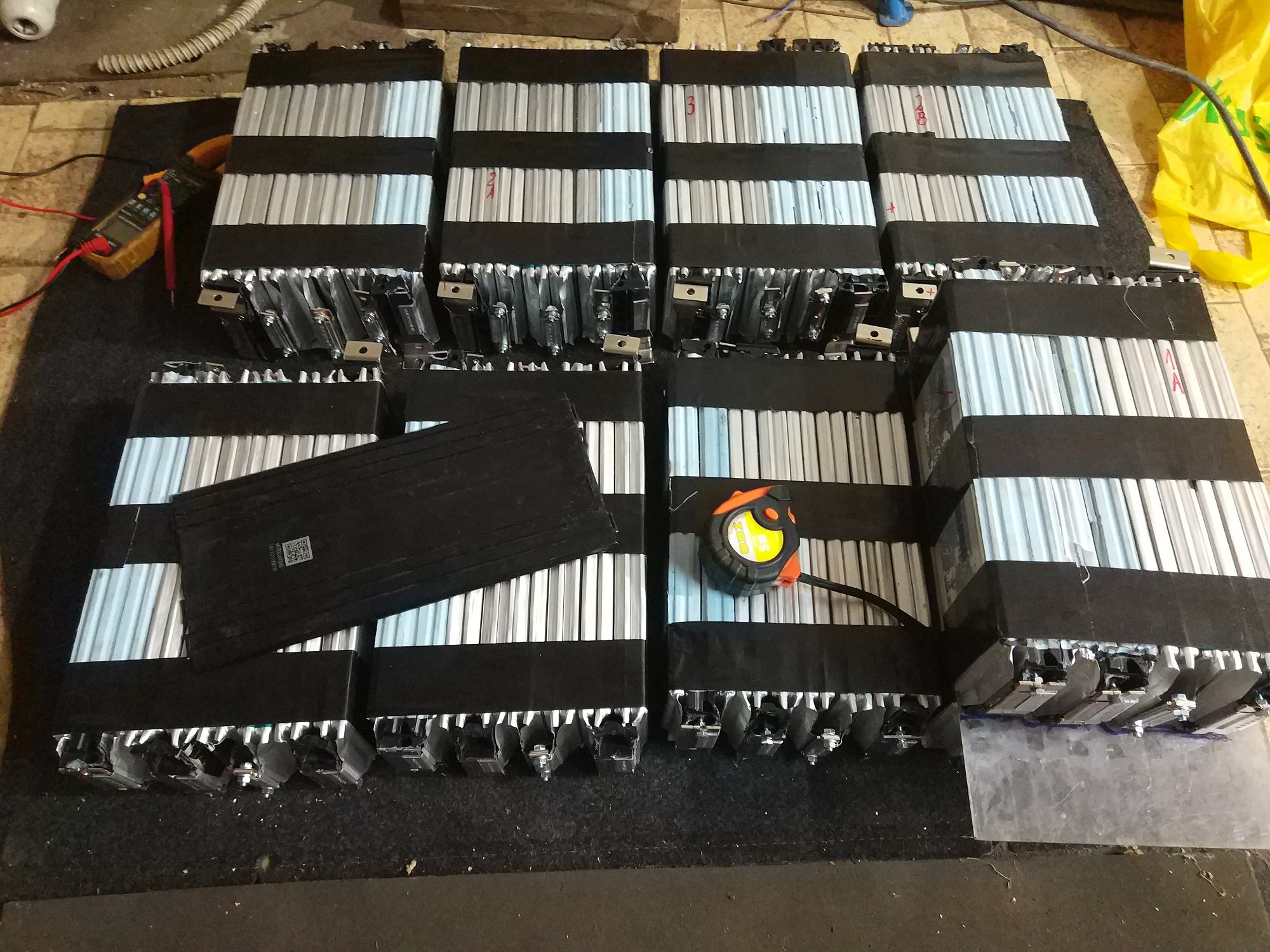

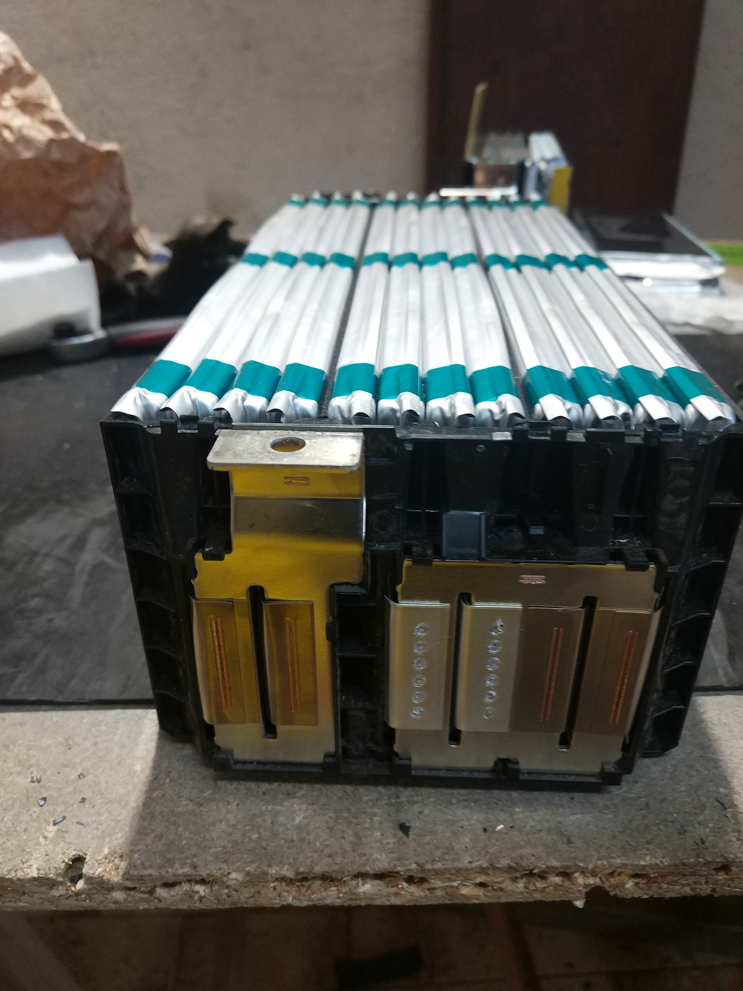

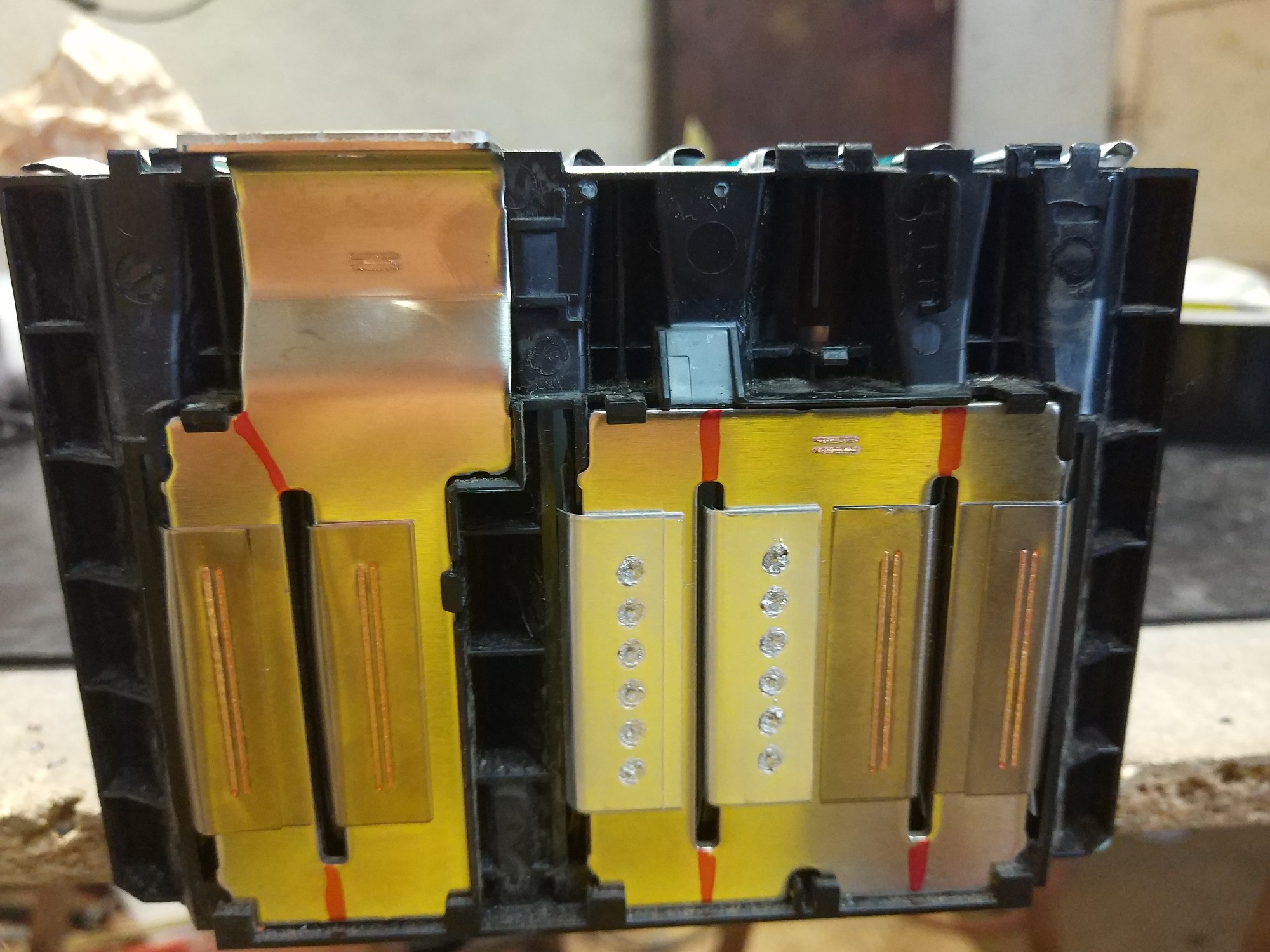

Shit! Shit! Shit! I managet to deform my Ampera cells. DOH!
I experimented with Lebowski inverter start settings and transition from sensored to sensorless. Also i expanded the acceleration limiter. I managed to get the car rolling directly from start to some 20km/h and then IT PULLED! BMS showed i pulled some 450A and i was grinning all the way. I repeated this session a couple of times. When i came back and inspected the battery i was apalled! On every module the endmost cell was a bit bulged and module surface was hot to touch. I let them cool down and then connected them to charge slowly at 8A. Well they went up to 4V per cell OK.
I guess i would have to have liquid cooling setup. System is certainly capable of more power still.
I am not sure if the deformation caused some damage or not. I will have to test at low end of SOC.

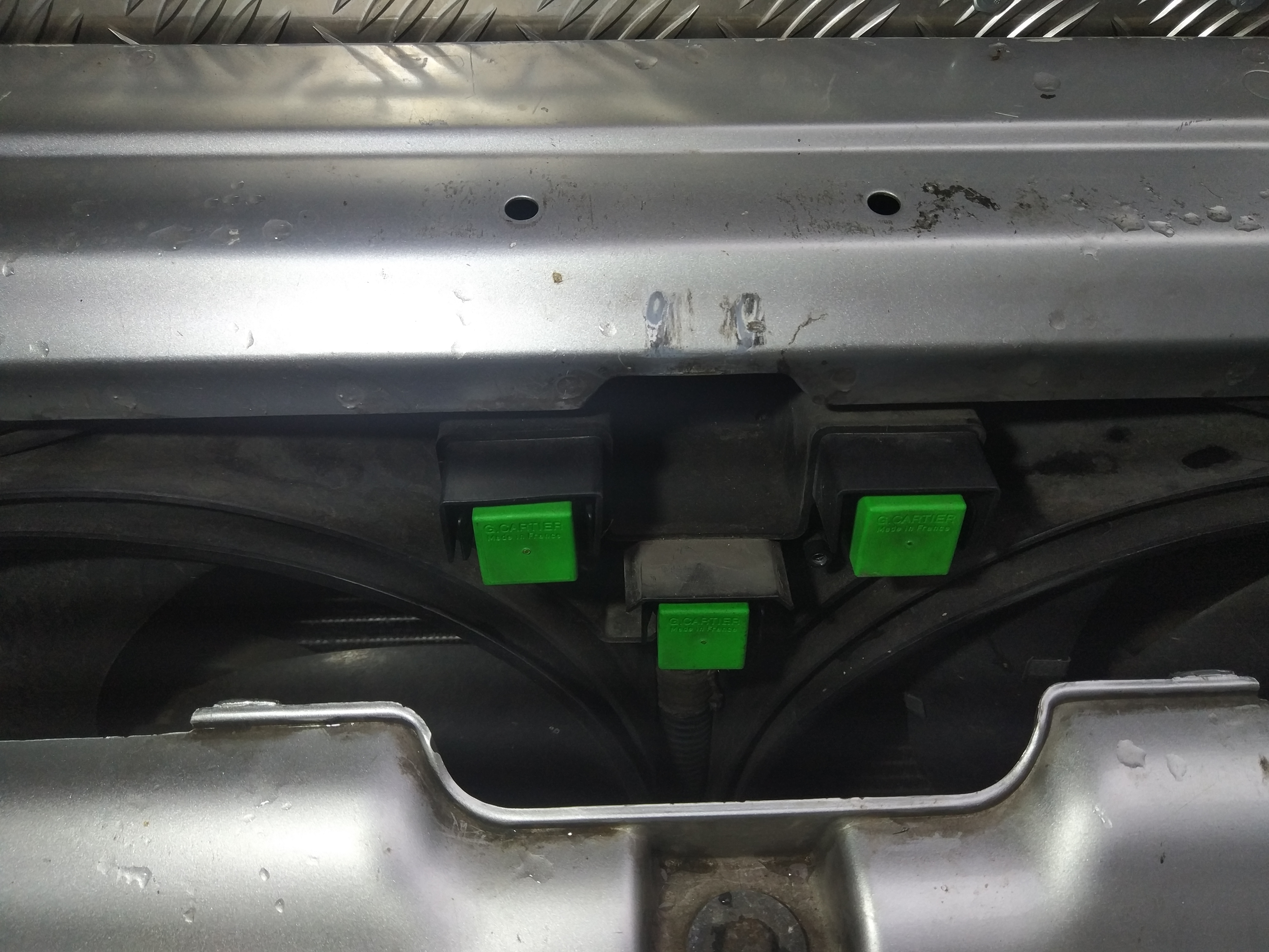

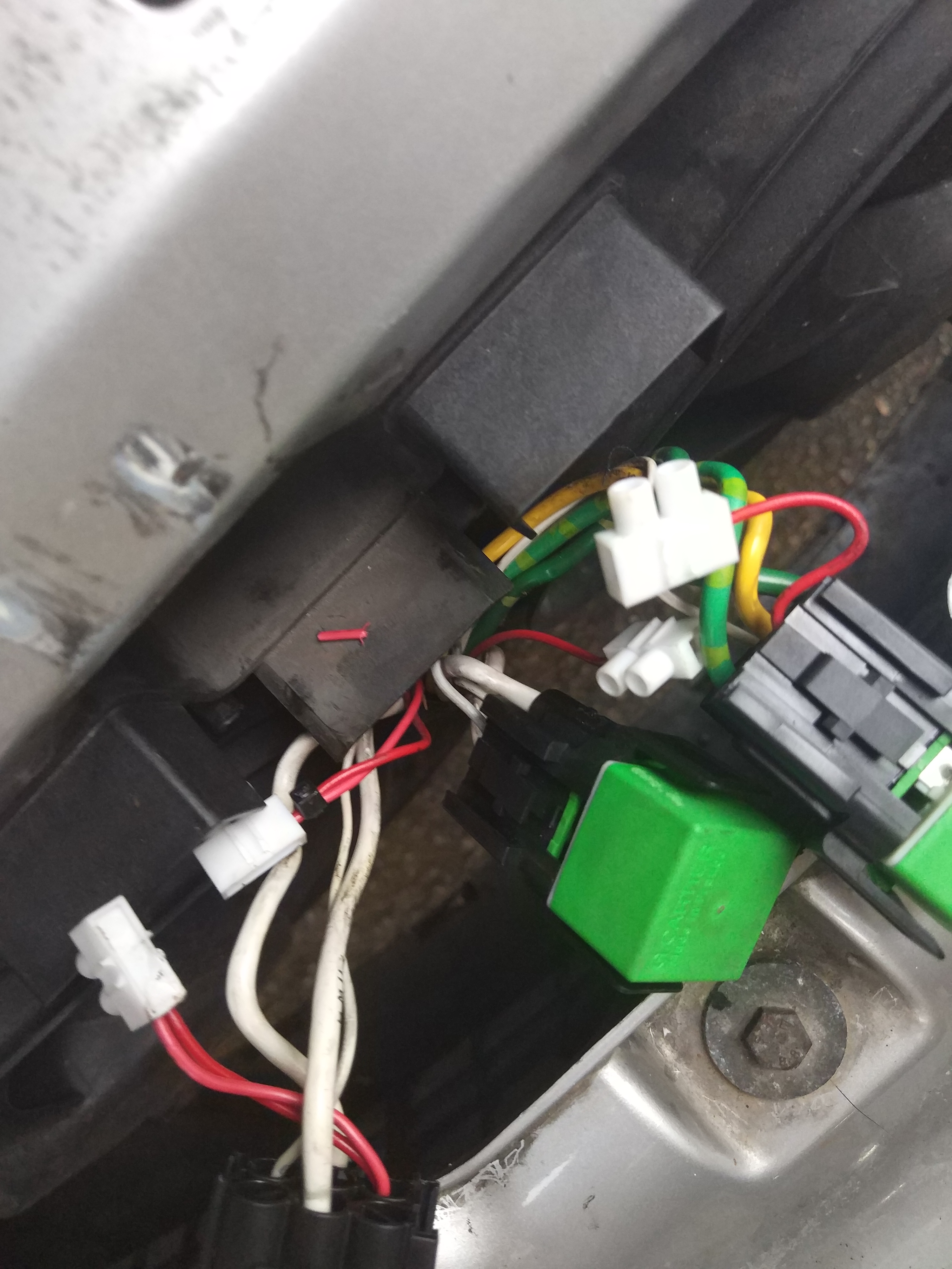

Again for some improvement!
Last time i went on the highway and drove some 40km to a friend and charged there. Remember i have my temp gauge wired with some parallel resistance to create higher temp. That way dry temp sensor alarm wouldnt get me at start. When i leaned over and touched the coolant hose leading to radiator i was shocked! It was hot. Luckily it was not hot enough to fault the inverter.

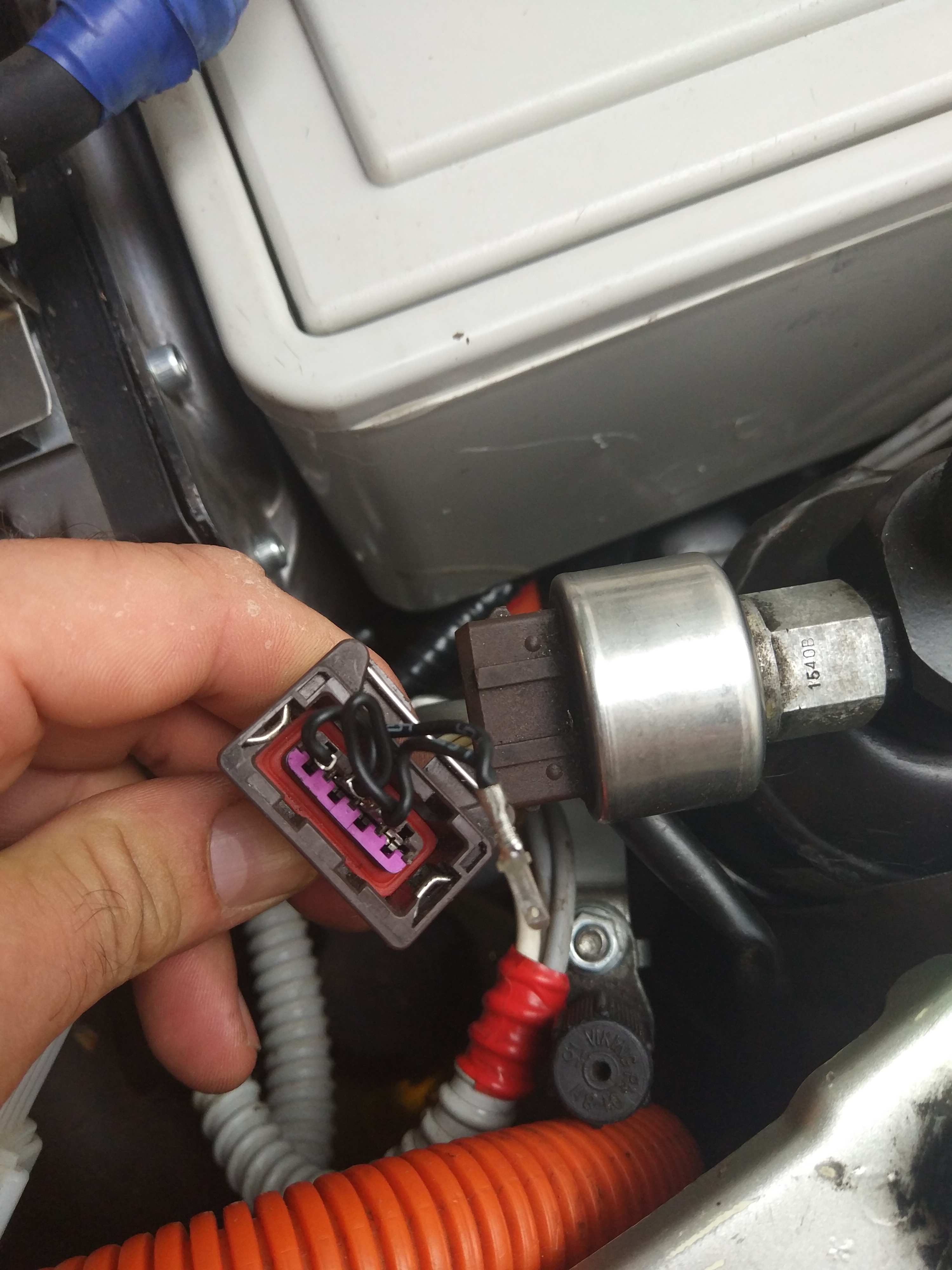

Now i am playing with cooling fans controls. I see the logic behind a two fan start. First they start slow and then relays click! Now fans start to run at full speed which is quite loud.
I also found out that i can trigger start behaviour with the 4th contact on pressostat. If i give it 12V it will start fans and if i pull it they will stop.
Now in practical terms i have 3x relays between fans. I experimented with taking them offline and figured which relay was for which function. In the end i cut positive control wires to two relays and now with a single pressostat wire i can start both fans at 1/2 speed. Though full speed is not available anymore i think i will be good with half rpm. It is much quieter and lower 12V consumption.
- Been thanked: 1913 times

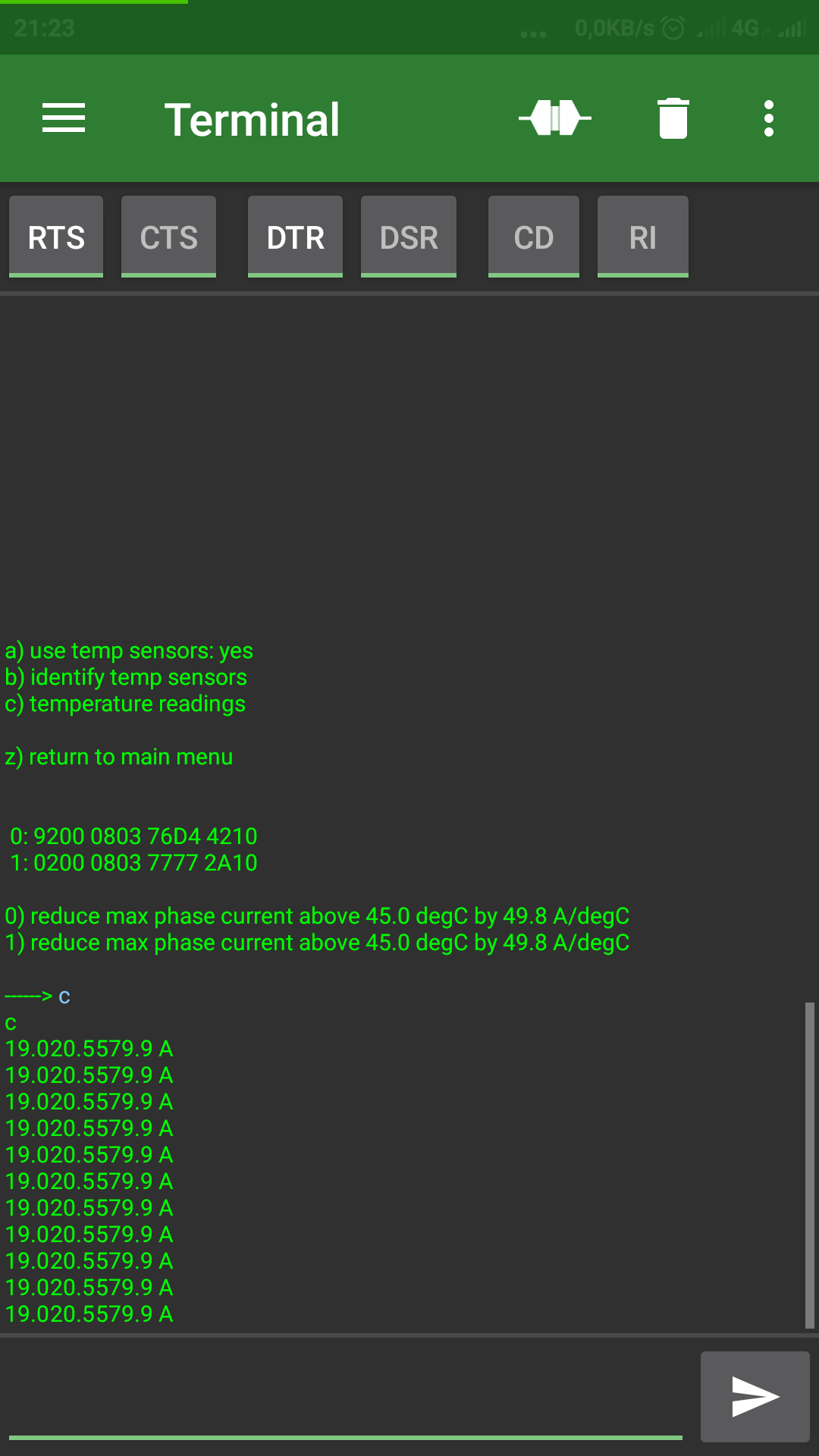

Can you see any temperature reading, inverter or motor?
Even on a day like yesterday (35°C peak) the motor only got warm. And remember I have just a tiny radiator, I drove Autobahn with steep inclines (Kasseler Berge) and sometimes I drove 150 km/h. Only then could I see the temperature rise to 70°C.
So if you get that much heat on a 40 km drive, maybe something is not parametrized right. Unless you drove 40km steep uphill

Yes exactly, I actually drove 30km on highway at 120kmh and then 10km at slower speed steep uphill. It seems like this was the factor with heat buildup. I am content now everything will work and I have positive control.
Like i said i had to adapt temp sensor with another 470R resistor in parallel so now it shows 75deg when i start "engine". Anything less and BSM would throw an error and assume temp sensor is dry. That also means system is calibrated to a different critical temperature than before. I think it is closer to actual 90deg while before it was 130deg which is fine for inverter and even better for motor magnets.

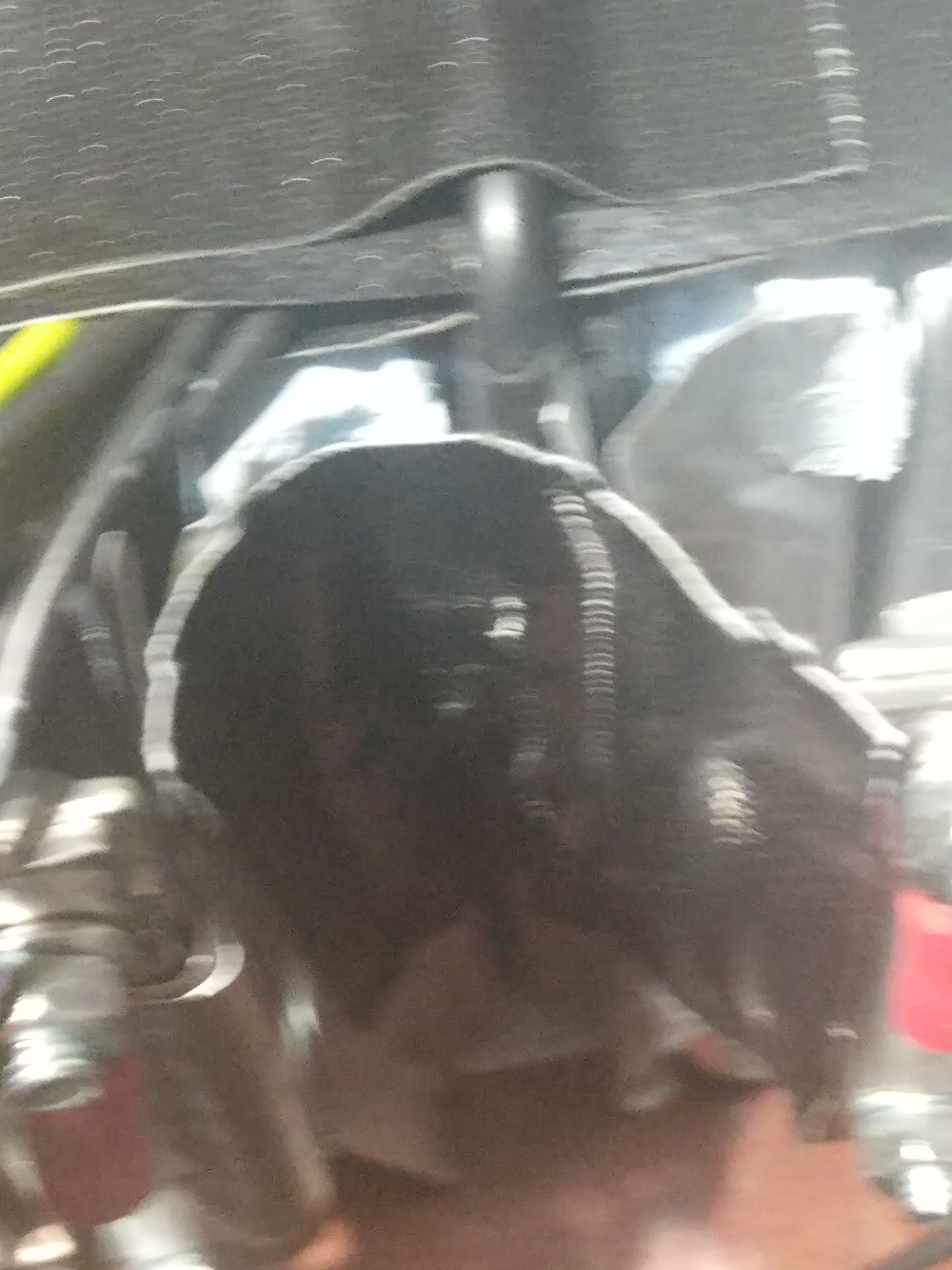

True, i went from 60 - 40 gas version to 50 - 50 with LiFePo and back to 60 - 40 with LiPos in my mazda and stability was not an issue per se. I needed to put some 20mm shims over rear coils to keep it in line... because of the front lights!!! Go figure.
Here with 406 it seems i have again 50 -50 distribution and nose is slightly going up. For now i dont see any stability issues. I really need battery weight up front because engine + ATX combo weighed more than 300kg together. Now Leaf gen 1 motor with gearbox and shafts weighs cca 100kg and i put about 150kg of batteries in the front box. I am waiting now on Jag battery... Ups... spoiler alert!
I am also thinking of attaching a front rubber curtain from front lip down to road level. This should block the air from entering underside. Ampera has this feature and i guess it improves its handling and Cd.
Also once i put all chargers in i will cover the underside with 2mm alu panels for smooth surface and protection for equipment underside.

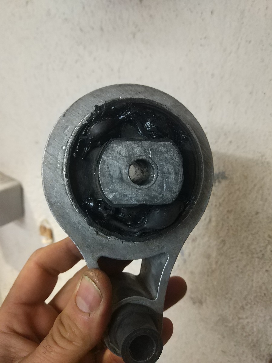

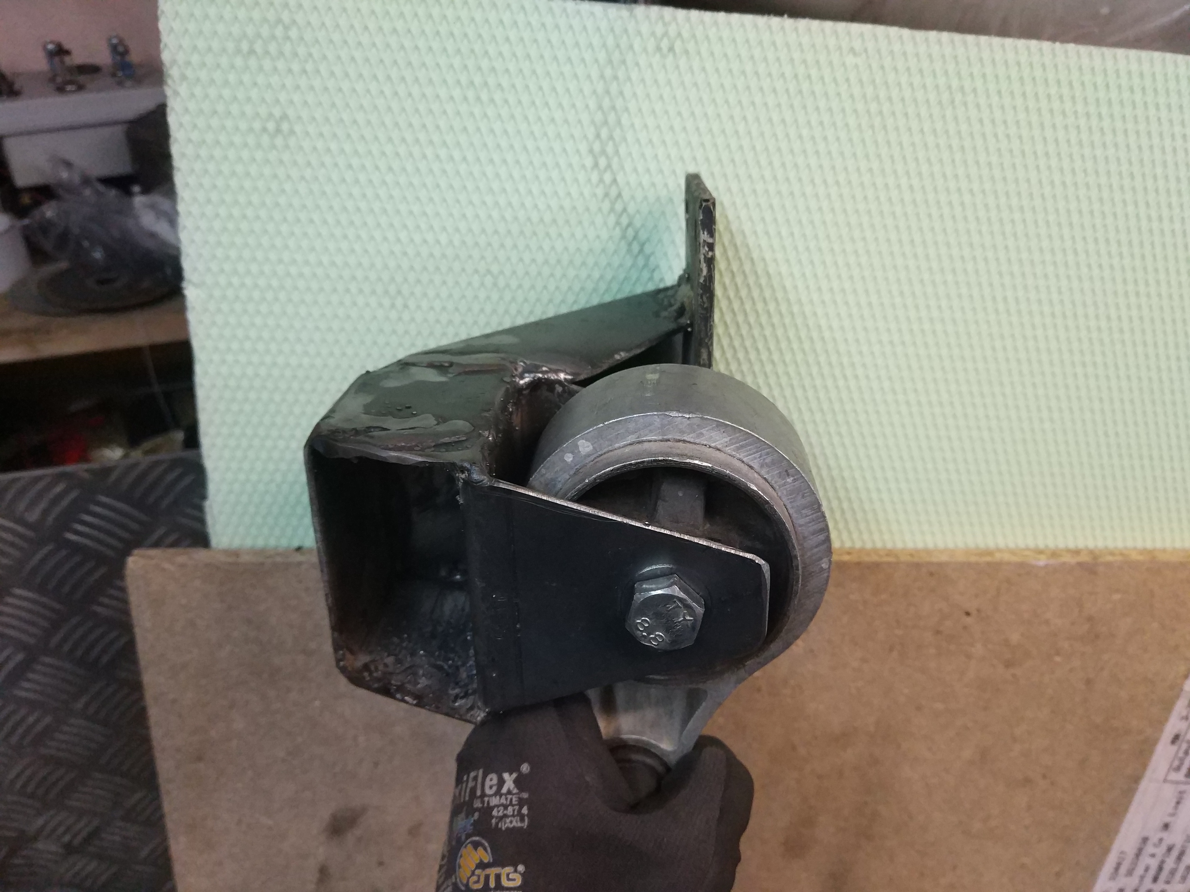

Damn! I will just let slip the dogs of mechanical engineering... Some engineer i am
My negligence caught up with me. If you remember from the motor mounting post i made a rather flimsy rear mount and convinced myself that torque will only pass through it in one direction. Well DOH! Torque passes through it from two sides...sometimes more than one reversals in a second! This really stressed the 12mm bolt which was fixed only from one side. And last weekend it broke just as i was trying to setup the motor parameters.
Of course motor was jumping at less than ideal settings and caused additional stress in the single mounting point. This sheared the bolt clean off.
I went back to the drawing board and this time i decided to make a propper fork mount with a box fixture. I welded the box on my first try and it seemed it would work.
But i noticed the rear edge of the box leans over to the HPAS body! That is unacceptable and prone to damage. So i decided to cut the box from the plate and reweld it at an angle, so that rear box part would clear the HPAS body behind the motor. There will be a lot of welding involved!!!

Finally i made enough of the BMS boards that i can comfortably go and slaughter those Jaguar modules.
I cut them down to 2P blocks for 120Ah.
First i remove the plastic cover and BMS connection. Then i mark cuts that will make the 2P blocks. Some of them can be used 2P2S since they were
meant to connect to the other side of the module. I then separated individual cells and drilled 5mm holes in their tabs. I connected cells in groups of 2P8S with a tab for + and - side. Today I have made enough cells to fit into the front box. Hurrah! And when i calculated their number i got 10 groupd of 8 cells which i will use in modules of 16 cells as BMS supports that. And behold, all 80 cells will fit the front box! I guess rear box will holt only 2P16S + 2P8S which is 86Vdc

I made more of the BMS cables for my Minifit connectors. I think they are great. Very compact and firm attachment to the board.
I crimped terminals and inserted the wires by their numbers so that there would be no doubt on how to assemble them on the battery side. After some more work on the battery packs i was looking at how to assemble and connect them in my pack. Orientation of the packs is vital to ease of assembly. I learned with Mazda that i need to put modules together so that assembly/disassembly is safe even using metal tools.

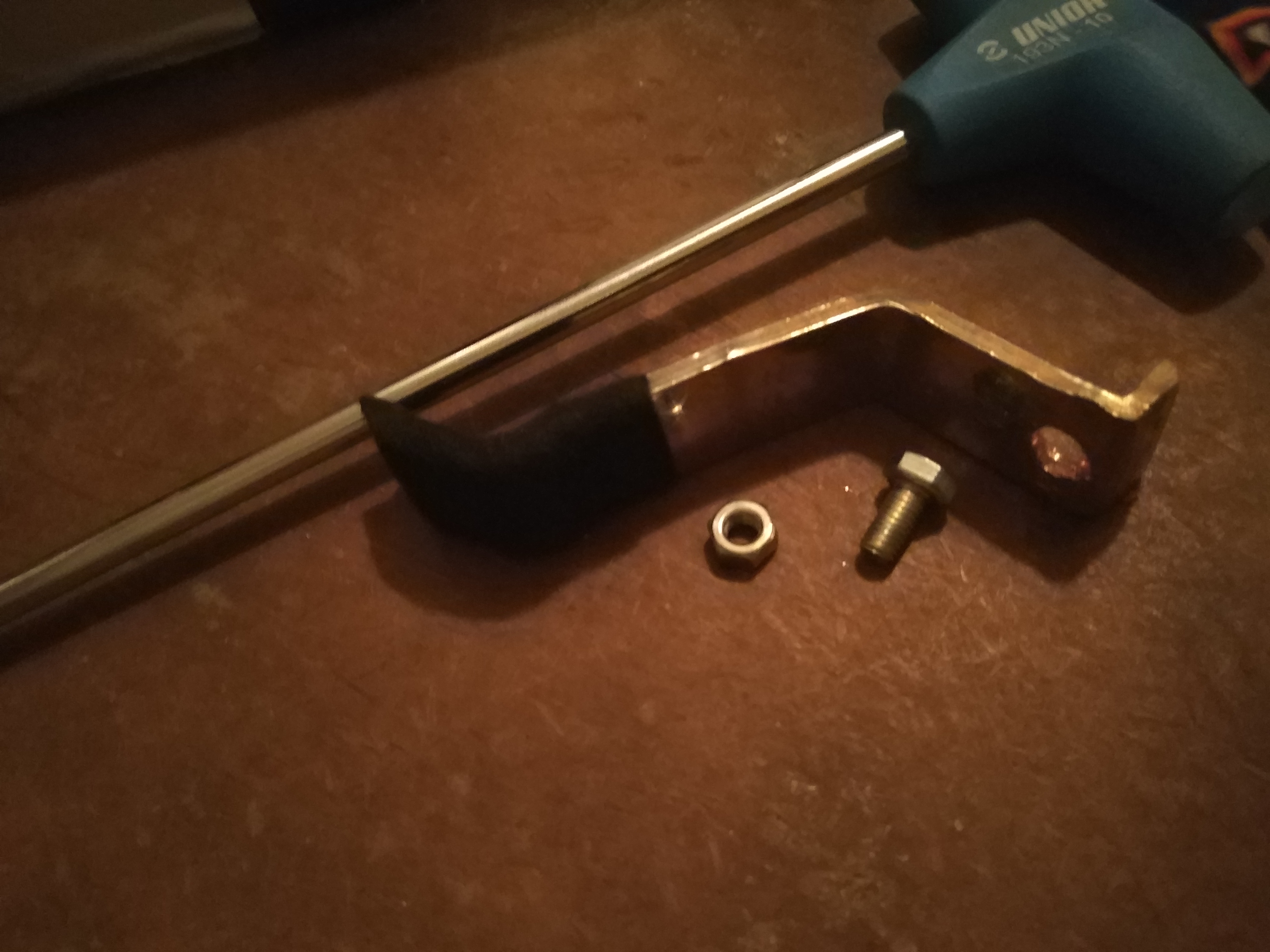

Question is how to bend 1mm thick end terminal by 90deg in a specific spot? Answer lies in a correct use of torque and support.
To achieve that i made a bending tool. It is made from 4mm copper contact, steel could do, but it is more difficult to form. I bent it at right angle and cut one end to size, so it will support the force of my torque directly on the spot where contact needs to bend. The other side i bent up and taped it up so it wouldnt hurt my hand. I also drilled a hole for the M6 bolt and after some thought i decided to solder a nut underneath it. This allows me to assemble the whole thing without having to look everywhere when that nut rolls away
With this tool bolted to the terminal i pushed into the terminal to keep it in position and pushed down on one end. Terminal twisted exactly on the spot i desired and the form of the tool allowed me to remove it sideways from the bend. Voila!
I now have all my end terminals bent so they accept rails from the side.

This weekend i went through the RLS RMF44U, commutation encoder manual here: https://www.rls.si/eng/fileuploader/dow ... utions.pdf
Because i just couldnt capture encoder 0° I decided i need to take apart the encoder and inspect magnet mounting and rest of assembly. Because i needed to do lots of steps quickly and by myself i wasnt able to take pictures.
What i found out...
1. I found my encoder mount had only 2 bolts fixing it to the motor case. What an error! It seems i was in a hurry and put only 2 bolts in to test the assembly and then forgot to close everything for sure.
2. I found that my magnet mount was rubbing on the encoder mount/plate on the inside. Probably because of the incorrect fitting.
I also discovered when i tightened the fittings that magnet mount protrudes just a tiny bit over encoder fitting. I couldnt torqued it more because it came to its stop on the motor shaft, So i took it off and put it in my lathe and shaved about 1mm off of the rear side. I deburred edges and tried to install it. I could set it in ok with a little play.
Sergio Fabris from RLS explained to me that magnet itself is not susceptible to high temperature and can withstand some 600°C before it looses its magnetic properties. But he also explained the optimal gap under the encoder plate is 0.5mm to 1mm. If encoder is too close or too far it would not capture correct sensor position.
Then i went on to calibrate hall sensors and i got good 0° capture with some 3° of deviation. I will need to work on that still.
But now i get really good driveoff in reverse. But i still got quite some jolt in the forward direction. That got me thinking my motor mount is to be blamed... It has large holes in its rubber to alleviate vibrations from diesel engine. Electric motor does not oscillate, but rather moves through the whole amplitude. This might move the sealant block center to its edge where it hit the metal edge... bang! Also that move is detrimental to motor position readback.
I took the mount down and filled the holes with some Sika window sealant that is elastic after drying and can withstand a lot of force. After drying off i put the mount back in the car and went for a test run.
That trembling just before stop is gone now. All I had to do is recalibrate sensors.
Vibration has lessened substantially but that mount rubber is still too soft for my liking. I think i will order replacement sealant block and push it in the mount later.
Also i had another problem. All the banging and motor jumping has caused my motor mount to break. It split on the weld seam and was causing terrible noise in my engine bay. I guess 3mm box and my welding skills were not enough to prevent that.
I took one 5mm metal plate and cut myself L shape out of it plus a triangular brace. It even looks better and more compact now. I welded old fork and new mount together and paint it with Zinc spray.
I finally gave it a coat of black paint and then put it in the car. Now there is no more banging and motor feels really firm.

This sounds familiar, you might remember: viewtopic.php?p=2142#p2142
My motor mounts are also too flexible and the whole drive train swings a lot. The left motor mount is not even solidly connected to the rubber, it just inserted into a rubber hole.
- Posts: 3795
True! Remember our conversation about Openinverter vs Lebowski shaking on start? Well i just brought that to minimum.johu wrote: ↑Sun Mar 14, 2021 1:17 pm This sounds familiar, you might remember: viewtopic.php?p=2142#p2142
I recommend you revisit your motor mounts because they actually contribute a lot to general resolver control stiffeness. Now that my 3rd rubber mount is allowed to only move a little under torque the counter shakes at driveoff from standstill die off really quick. I really need to replace that rubber shock block with one made from full rubber.
Any electric motor only needs rubber mounts so it doesnt transfer noise to the frame. It does not need mounts to dampen any amplitude vibrations. If you install some you will get undesired movement in your resolver control which you will have to dampen with software. It all creates undesirable delay in FOC feedback and means motor feels less springy.

Today i made some needed work to remove the small battery and use the "normal" 55Ah size one under the trunk. That cleaned right side in the trunk and left more space for parking sensors unit.
I installed the parking sensors to add some safety since i noticed i can lean onto the rear battery box when i park into a higher curb.
Some day i may also install rear camera for parking assist. I also installed 2x DS18S20 digital temp sensors in the front battery box. I taped them onto the top battery stack near the contacts. I may move them if i find that is not a good place. I also setup power reduction if my battery would go above 45degC. Ramp is set to 50Arms/degC reduction after 45degC. Those sensors work on single wire bus. Every sensor has unique digital code that Lebowski brain recognizes and they read 19.3deg C in my garage. Since this system can work with like 8 sensors on the same bus i would recommend Johannes to code those in Openinverter as an option for motor/controler/battery sensors. https://pdfserv.maximintegrated.com/en/ds/DS18S20.pdf
I see some code here: https://gist.github.com/bassdread/6050f ... 4d7c995783
Also i would like to point out i got some very similar sensors from ebay. When i connected them i got huge values. It seems genuine DS18S20 sensors are 9bit and shady ebay sensors are 12bit. But they carry the same name...
. I could use them and set every value x8... but why bother. Genuine sensors work very nicely.
