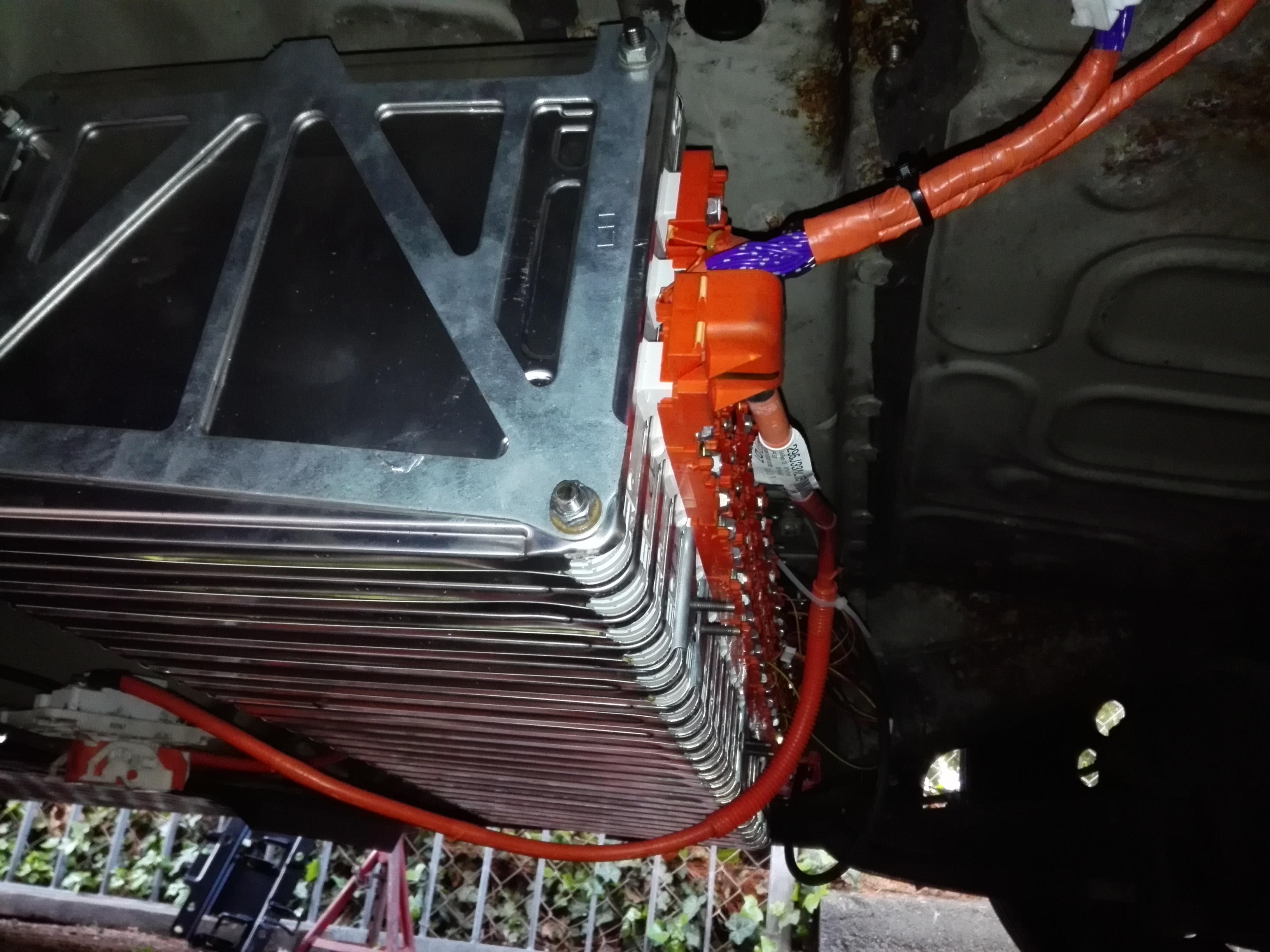

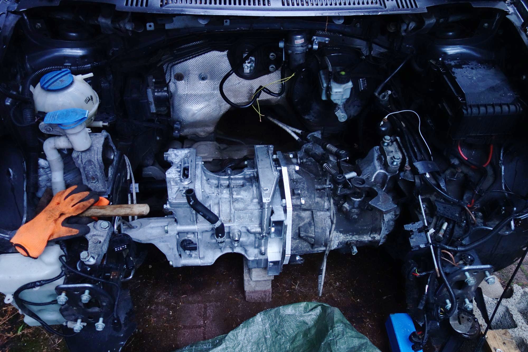

So this weekend was great. I had both Arber and his family and my father over to help me get back on track with the Touran conversion.
We test-mounted one battery brick (1/2 Leaf pack) under the car with no greater problems. The other half is residing in the boot right now. My dad could not stop working until we had this done at 23:00 :D
The adapter plates between motor and transmission are pretty much sorted. I use two 300x80x40x4 profiles to cover most of the distance. They are connected by U-profiles mainly for water proofing. Then comes the actual transmission plates which we made with the jigsaw :) It is only 15mm and we found out the hard way that it better be 25mm - the shaft coupler is about 5-8mm too long. So I went to a random steel working company today and found a 100x460x8 aluminum plate in the scrap. Will saw it in half and thereby add the extra distance.
Mechanically I just need to make a motor mount and the drive drain is in, yay :D

And transmission is in.
Now need to make a motor mount, connect up the drive shafts, make some temporary DC cables and off we go :D

You can cut that mount near the hole and make a hole higher up. As long as mount is flat under. Then buy one 6mm flat piece of steel cca 100mm x [whatever vertical] and get it bent under bottom. Fit one end in the mount and another down at the motor mount in such a way it will carry motor even if a bolt falls off.
Side mounts are only to stasbilize motor. Real bi*$#h it to fit the rear mount in. Does your rear mount come with transmission?
A
Been thanked: 1918 times
Well I believe I've sorta done just that, see below :) He who can't weld uses profiles and screws ;)
Yes the rear mount is attached to the transmission, easy peasy.

Mounted one battery in its final position and one temporary.
So now I could test at full voltage (380V). First thing I did was burning out the relay driver buried in the inverter :(

Wow! So you actually did a full test drive with 360Vdc! That is a great step.
So did you use a strong steel profile to mount the battery pack? This will be tested now that your car will move and buck under 360Vdc.
I am looking forward to testing your findings in action.
A
No I was too lazy to change the mounts ;) I drilled the middle one so that it now also fits. Also re-tapped the hole with the damaged tread.
