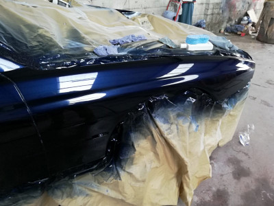

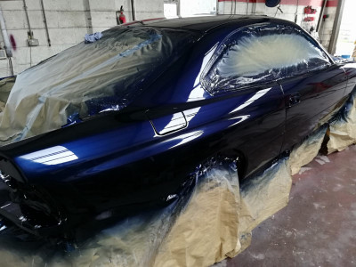

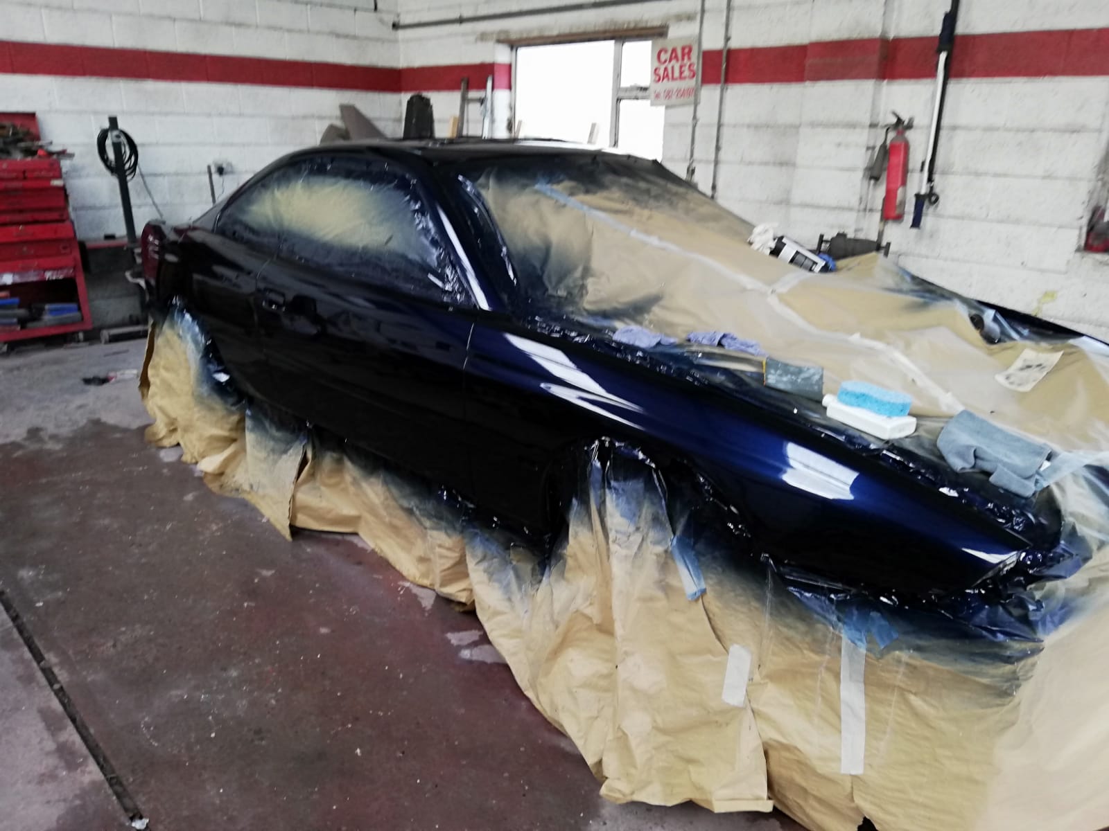

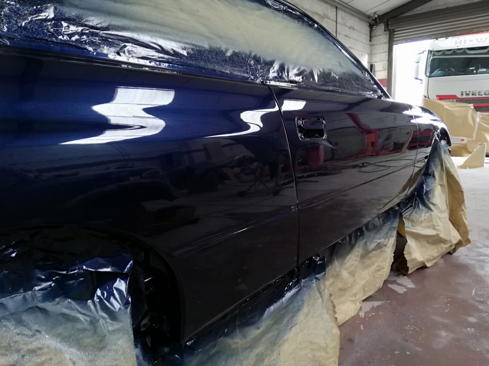

So then the car was sent to an Irish version of Chip Foose for a complete bodywork repair and respray which is nearly complete. Attached a few pics of the progress so far.

Re: Der Panzer Tesla Powered BMW E31
Post by sfk »
Love that colour! 8-)

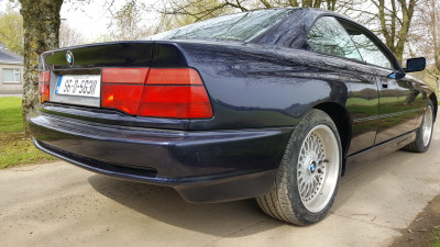

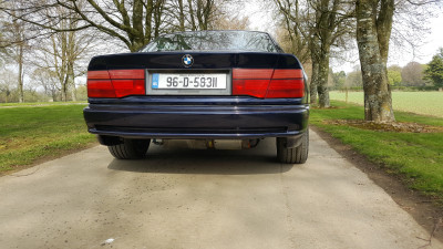

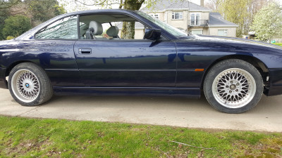

Der Panzer has returned :) :) :)
Posts: 4003
Been thanked: 1126 times

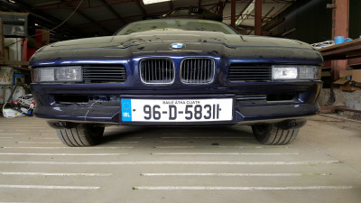

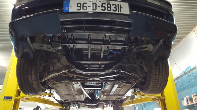

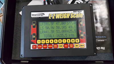

Front back together. Underside painted. And the question the whole internet has wanted to know: The Weight!

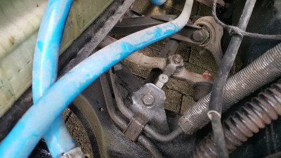

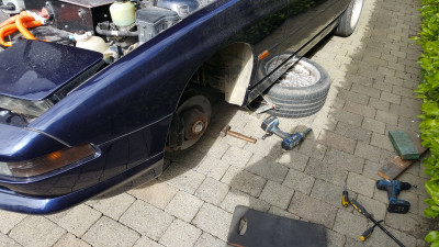

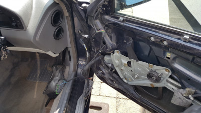

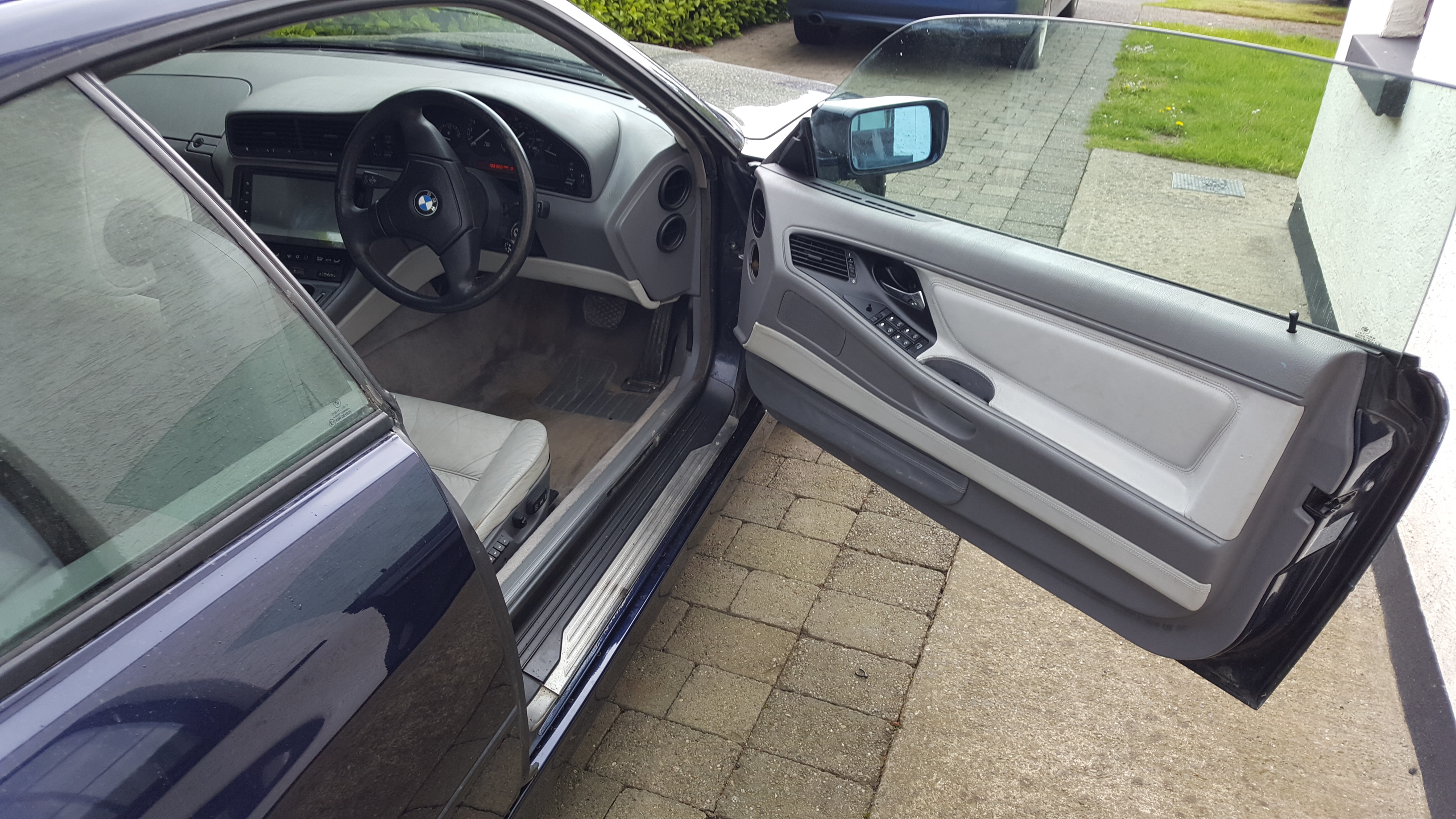

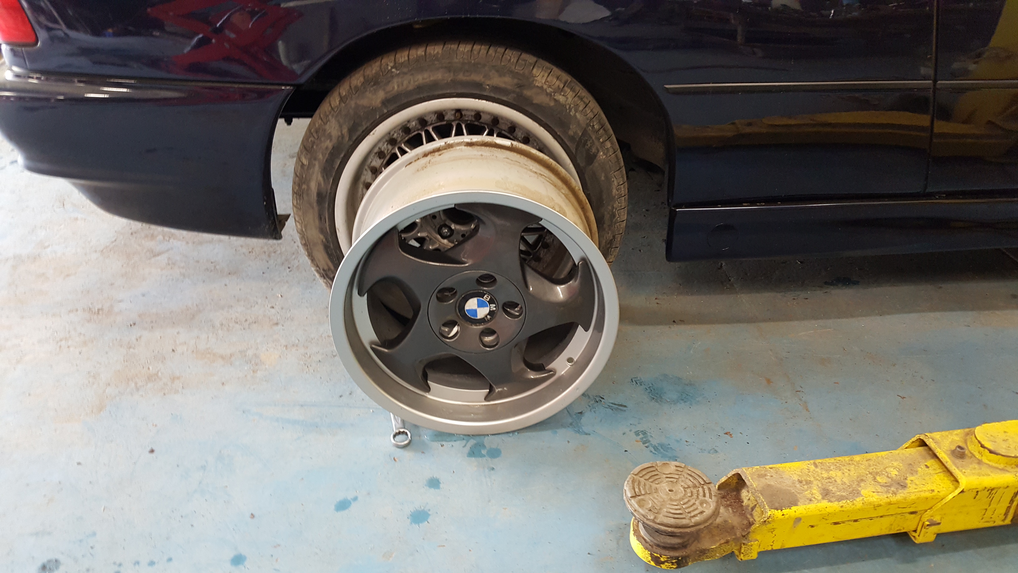

Panzer NCT repairs today. Steering idler arm was a tour de force as the ball joint taper was on there since 1996. Fitted a new door brake on the driver side and for the first time in nearly 5 years of ownership the door stays open on its own.

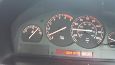

Thanks to the help of a forum member who kindly wrote the software we now have working speedometer and tachometer.

Posts: 3795
Been thanked: 411 times
JB can you tell us what signal you use to calculate RPM and speed from?
Posts: 4003
Sure. I mounted a proximity sensor on the Tesla drive unit pointing at the inboard driveshaft flange on the right side. It counts the 6 bolt heads on the flange for every wheel rotation. The arduino then translates this into 9 pulses to drive the speedometer and 20 pulses to drive the tacho at half the motor rpm. So 3k indicated on the tach is 6k motor speed. Reason for this is I don't have the ability as yet to create a new fascia for the tacho to go to 16k rpm:)

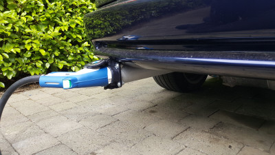

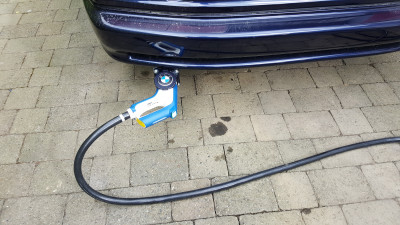

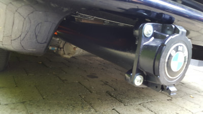

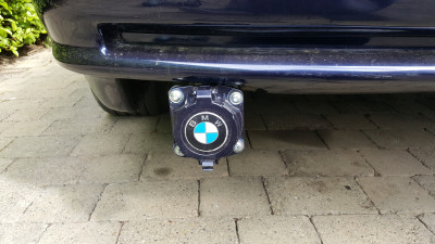

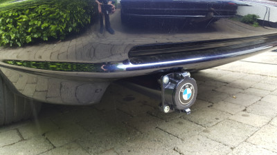

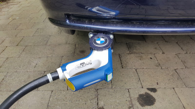

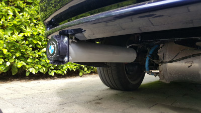

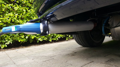

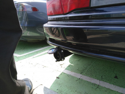

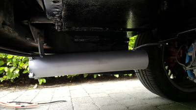

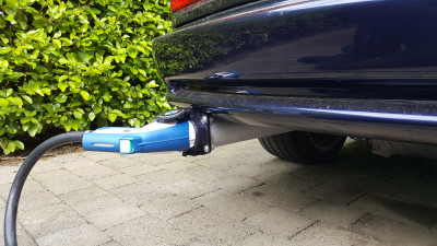

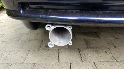

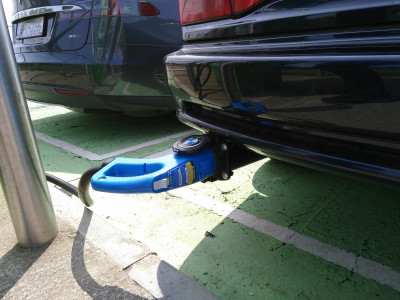

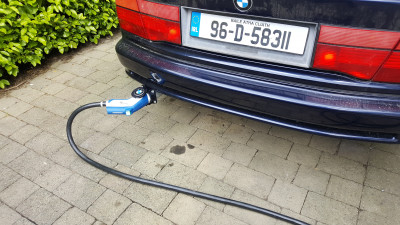

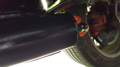

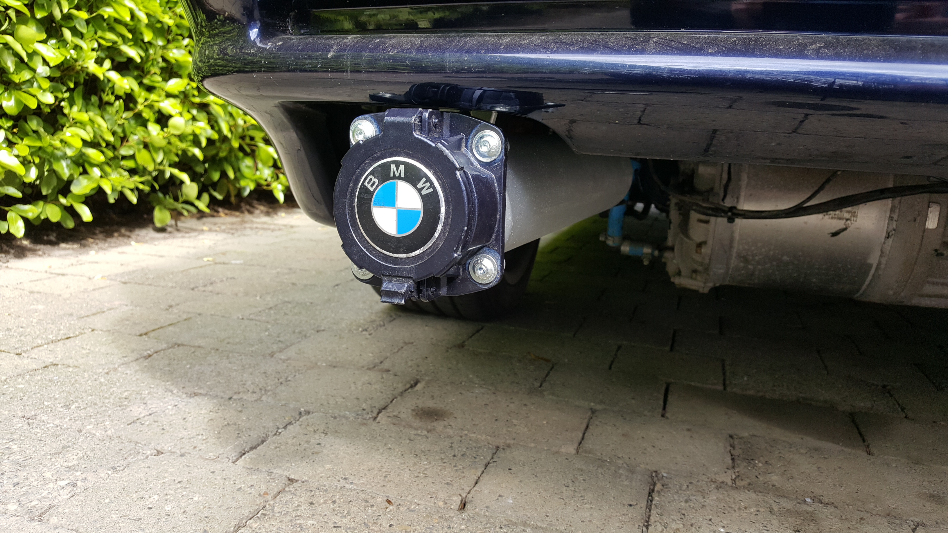

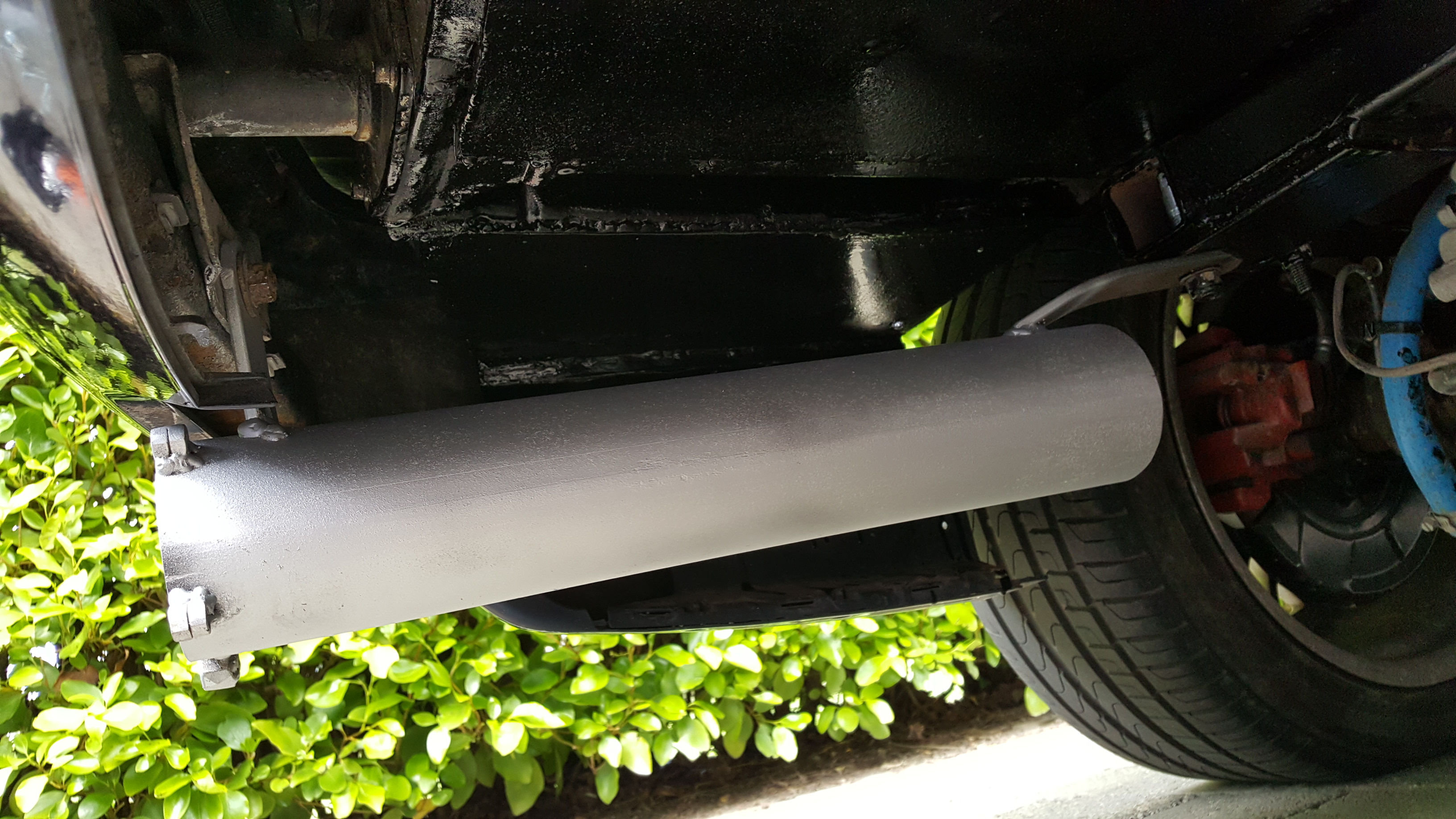

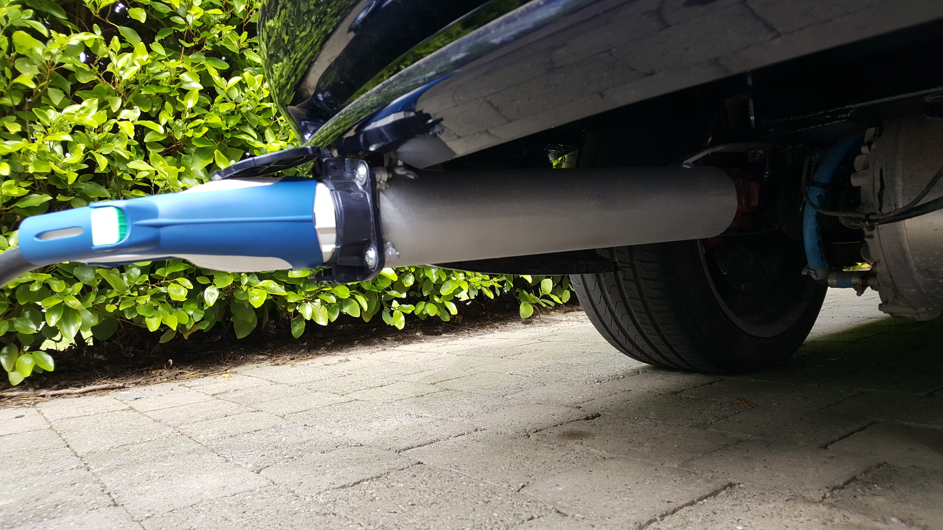

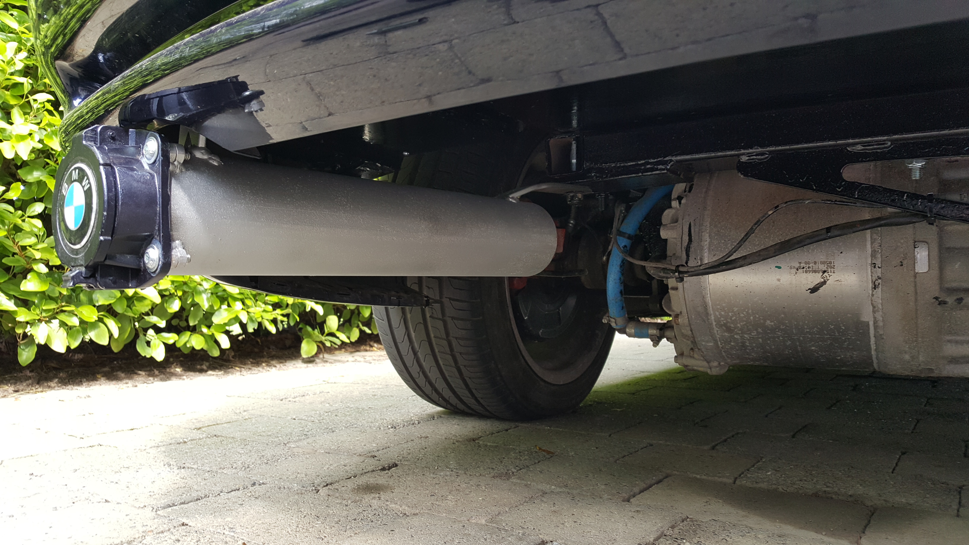

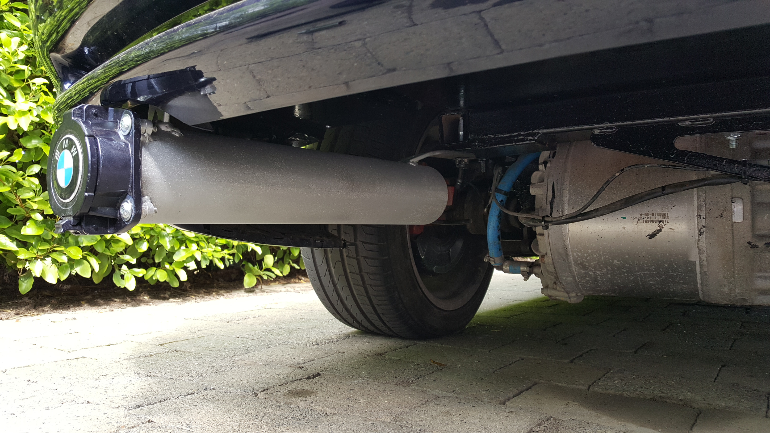

Panzer gets a tailpipe:)
doobedoobedo
Posts: 264
Location: UK
Post by doobedoobedo »
That's simultaneously hilarious and awesome.
Posts: 1884
Has thanked: 91 times
Been thanked: 517 times
Is it not a tad inconvenient to have to bend down and plug in?
This only occurred to me because I've pulled my back and I'd look a sorry sack trying to plug that in.
Looks cool though.

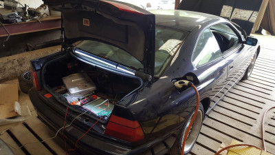

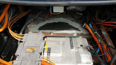

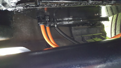

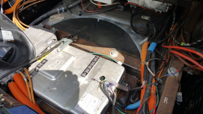

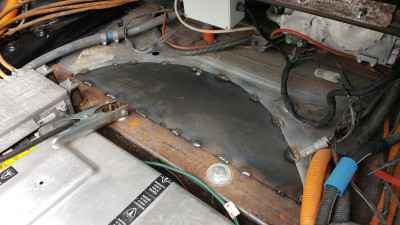

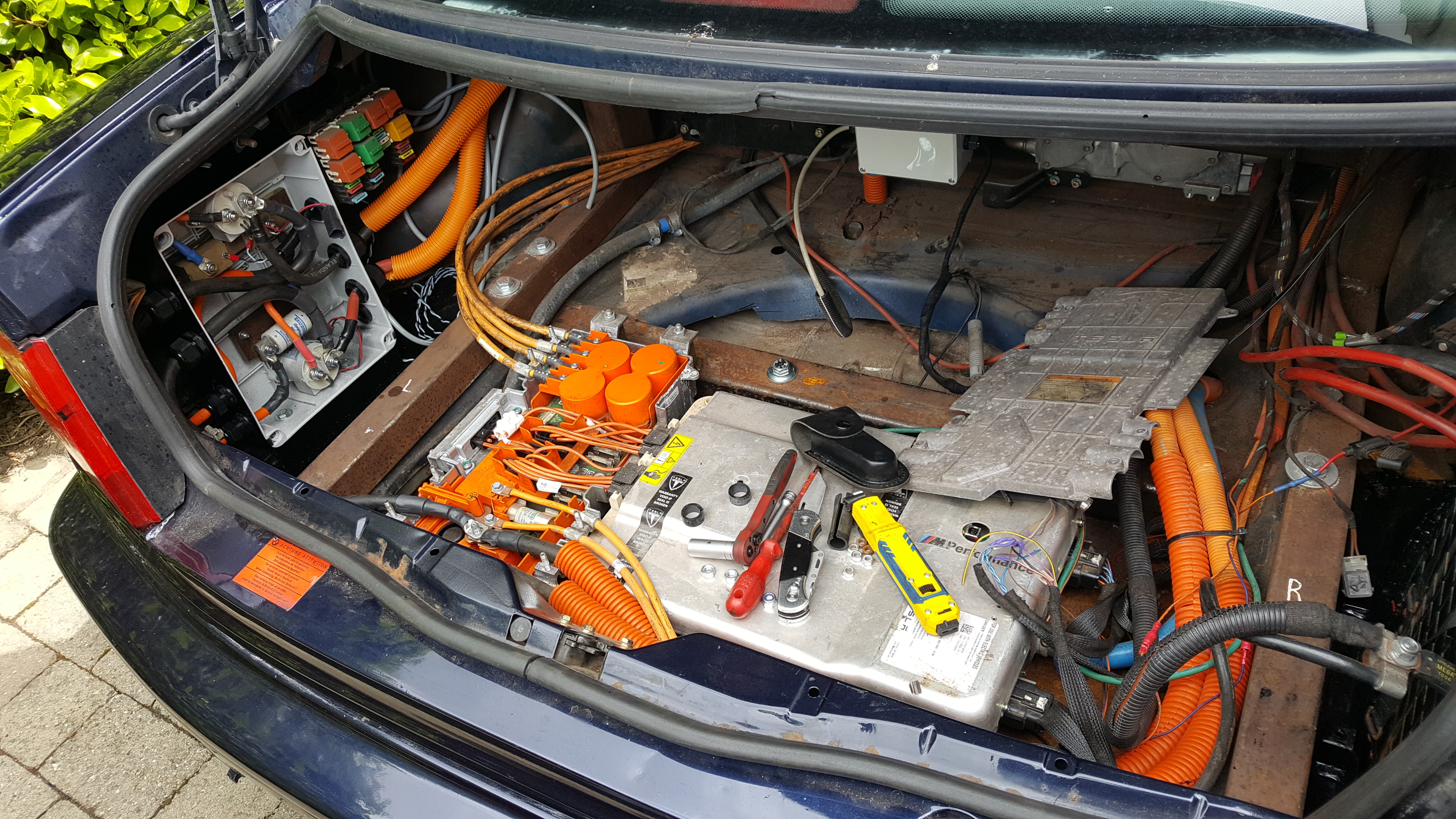

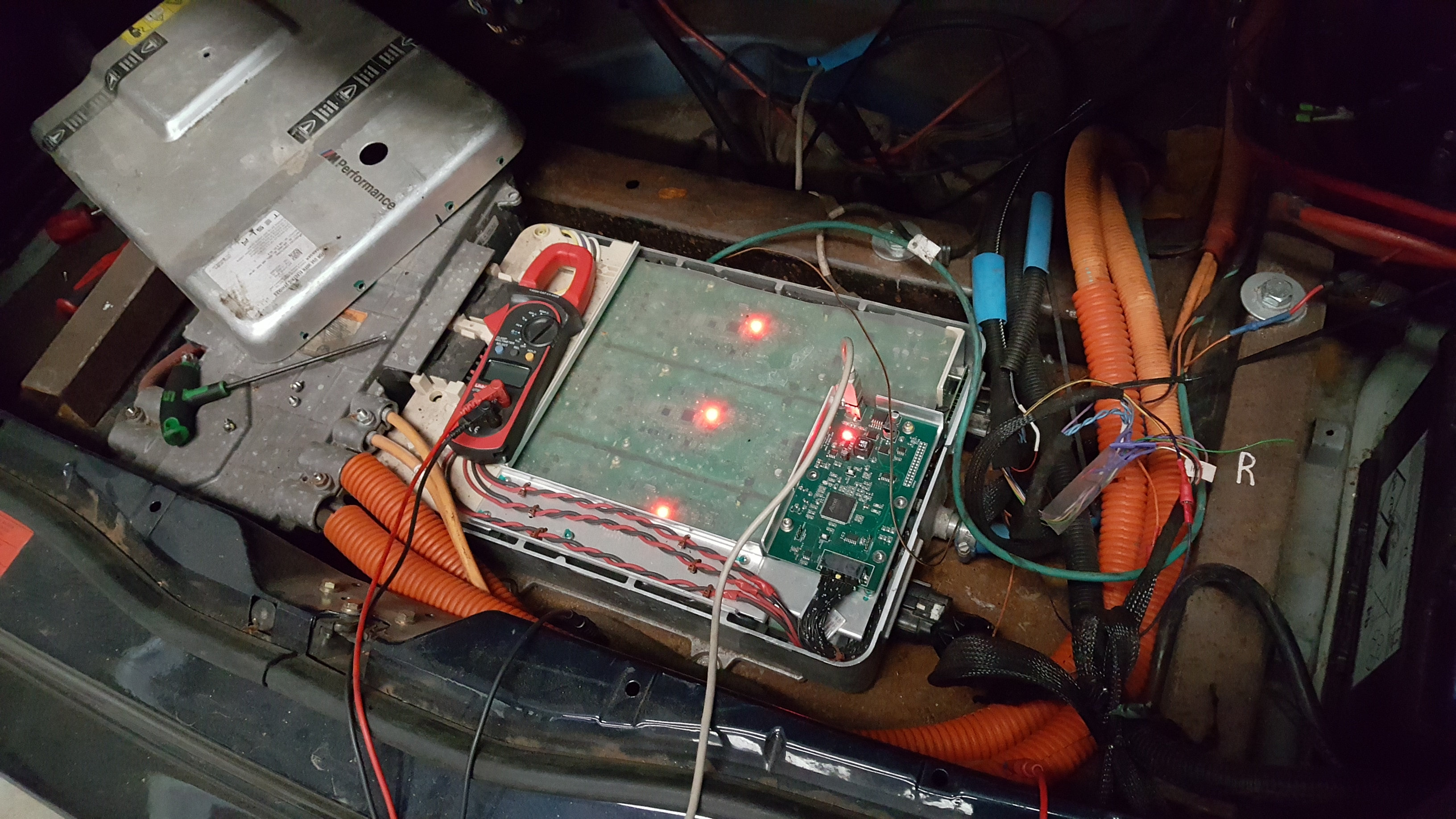

More Panzer progress. Chademo port and hv control box installation and final part of boot floor.
