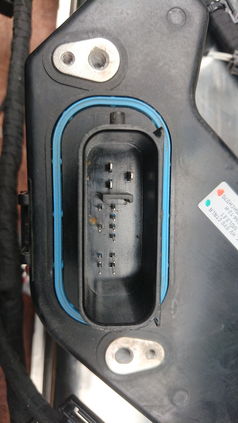

Just a check, did anyone already have the pin numbering for the pins in the HV controller connector?
collin80
Posts: 118
Been thanked: 15 times
Re: Model 3 High Voltage Controller
Post by collin80 »
nkiernan wrote: Thu May 20, 2021 7:25 pm Just a check, did anyone already have the pin numbering for the pins in the HV controller connector?
You mean like a list of which pin is which? I didn't/don't but I do have something kind of similar. I took a picture of the backside of the board and it is numbered. So, just rotate all those numbers back around to be the top of the board.

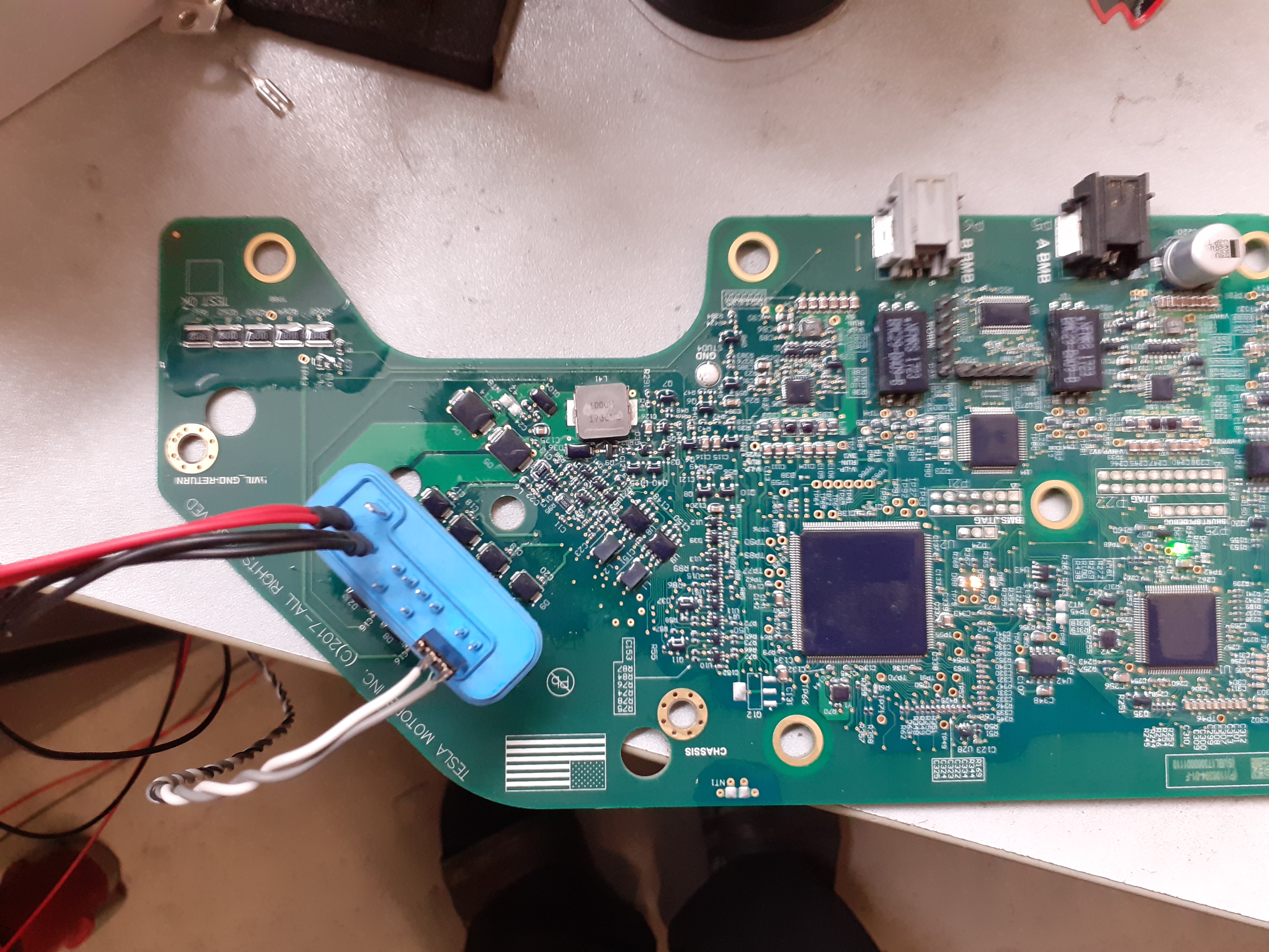

muehlpower
Posts: 807
Has thanked: 18 times
Been thanked: 186 times
Post by muehlpower »
[/quote]
does that help? The white is CAN L, grey CAN H. Already terminatet with 120 Ohm. The other big terminal is another 12V+, maybe kl30?.

muehlpower wrote: Fri May 21, 2021 8:48 am does that help? The white is CAN L, grey CAN H. Already terminatet with 120 Ohm. The other big terminal is another 12V+, maybe kl30?.
The other big terminal powers the shunt system on the far side of the board. It is not required to be powered to get the BMS to function and monitor the cell voltages.

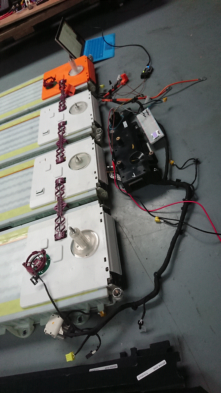

Connected up the four modules to redo the CAN capture as full pack. Attaching two captures, the basic CAN output and then injecting the 0x500 Collin mentioned above. I didn't see the extra 0x7D2 or 0x7F2 ID's but will check again.
For reference, module and pack voltages measured with multi-meter:
- Module 1 (pack -) = 75.0V
- Module 2 = 75.3V
- Module 3 = 72.2V
- Module 4 (pack +) = 72.0V
- Complete pack = 294.5V

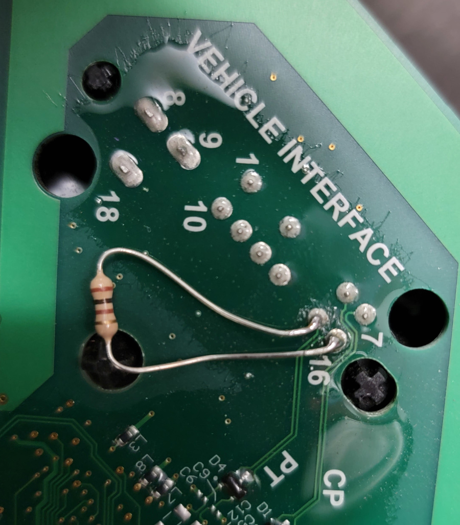

Its looking like I probably should have mentioned that you should send 0x500 on the vehicle bus and also find 0x332 on the vehicle bus. The CP bus is just for comm to the charge port controller and I have no idea which messages are sent there as well but it's not all of them. The debugging output goes to the vehicle bus where it could be picked up by the central computer / ICE.
It might also be worth mentioning that in my above picture you can see that I soldered a resistor between the two CAN pins for the PT / vehicle bus. I think it is otherwise not terminated. So, if you hook up a CAN capture tool to those pins you need to ensure you have some termination, either on the wiring or inside the CAN capture tool. Most of them are not terminated. I was lucky that I could just cheat as the board in my picture has been dremel'd out from the housing so I can get at the back. The rest of you probably don't want to be that destructive. ;)
