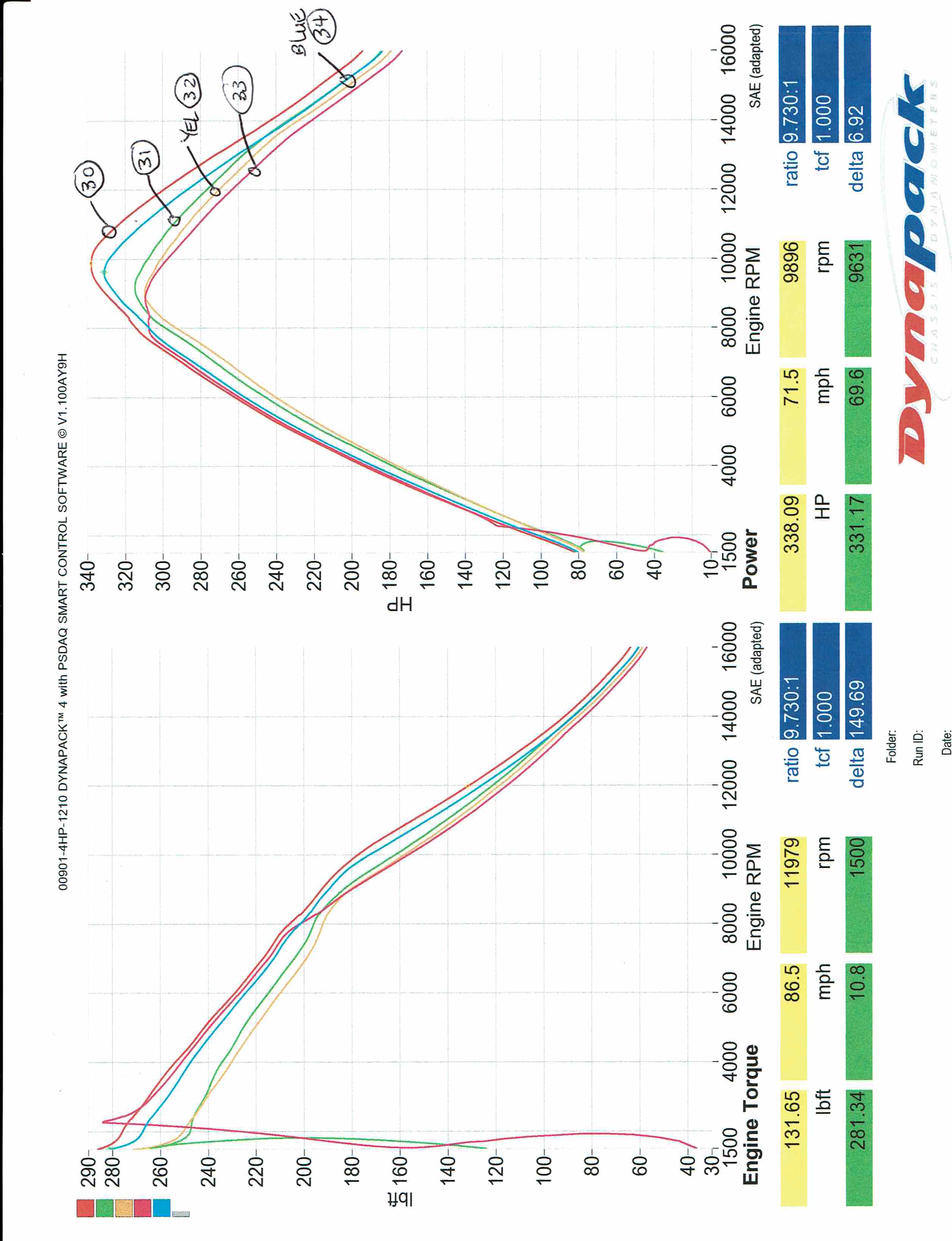

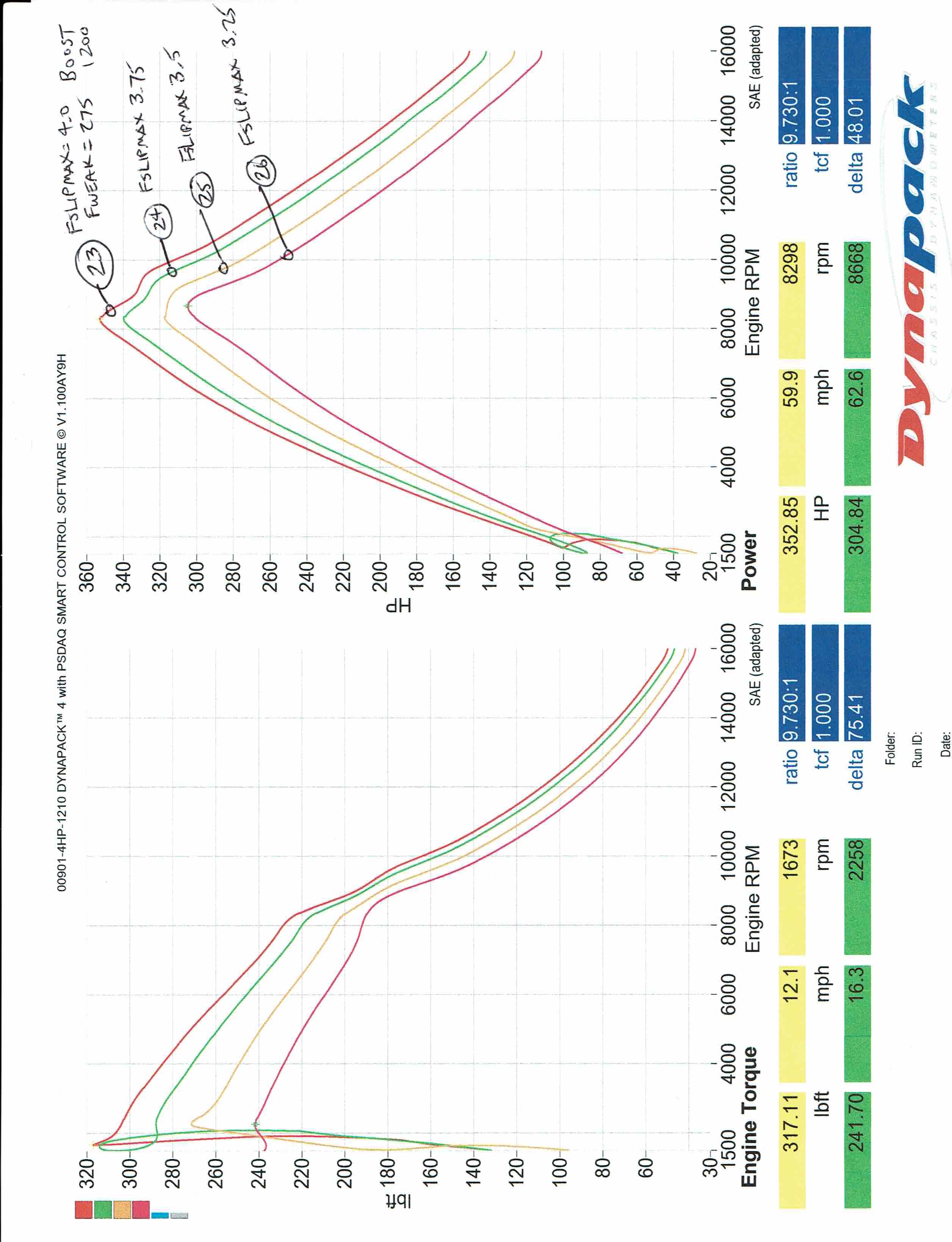

Good results at the dyno. Bottom Line: Max of 317 ft-lbs/353 HP - with low end torque limited by the dyno and conservative tune due to overcurrent errors.
Drive Unit: S85
Battery: 2/3 Chevrolet Bolt Pack 2P96S. Nominal 120Ah, 40kWh
Dyno: Dynapack Hub Dyno.
Things we learned:
- Max torque/power directly related to Fslipmax
- Fweak greatly affects peak power, not just point of max power. Looks like you would always want to be less than 300.
- Torque drops sharply after Fweak point. Fconst is very useful in boosting torque and power after fweak (thanks Jon Volk)
- With sufficient power at higher RPM stock LDU max RPM can be raised over stock Tesla. We managed to get to 17,250 RPM (fmax=575) but not 18,000 RPM
Effects of Varying FSlipMax (no use of Fconst):
Fslipmin=0, Fweak=275, Boost=1200, Fslipconstmax=Fslipmax, Fmax=550, Fconst=550, udcnom=0
Other pulls using Fconst
30- Jon Volk: Fweak=258, Fconst=450,fslipmin=0.87,fslipmax=3.06,fslipconst=450, fslipconstmax=9. Boost reduced from 1850 to 1500 to keep within dyno current limits.
31- Fweak=275, Fconst=450,fslipmin=1,fslipmax=3.25,fslipconst=450, fslipconstmax=6, Boost=1500
32 - Same as 32 but Boost = 1200
33 - Same as 32 but Fweak = 258
34 - Same as 31 but fslipconstmax=9

Even with ocurlim, iacmax, and idcmax set to be out of play we were still getting overcurrent errors.
With fweak at 350, boost = 1200, couldn't raise fslipmax above 4.5
with fweak at 300, boost = 1200, couldn't raise fslipmax above 4.0
with fweak at 275, boost=1200, couldn't raise fslipmax above 3.75
Any ideas why? I see that Damien is using fslipmax =5 and the EVShop Porsche = 6

I'm a bit surprised that torque drops off with speed below your fweak. Are you running version 4.55.R or higher?
Lowering fweak OR raising slip means increasing motor current. Thats why you have to compensate on with the other.
I'm not 100% if desat errors are reported reliably on Tesla hardware. So if you say comparator is taken out of the game you might be seing desat errors declared as over current

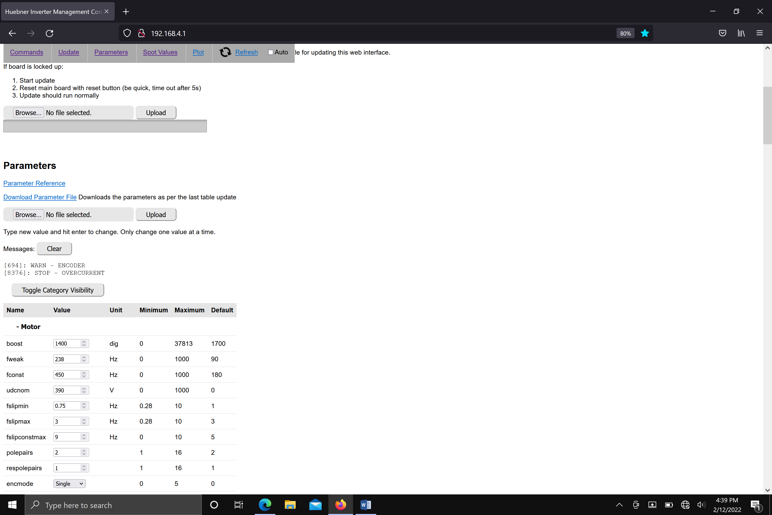

I am attaching a datalog file for run 23 (Fslipmax=4.0,Fweak=275). Pack volt/amps are measured at the battery by our Orion2 BMS, UDC/PotNom/Freq/IDC are logged via CAN from the open source controller. Pack Volts/UDC agree fairly well. There is a huge discrepancy between PackAmps and IDC. Either there is a reading error or huge inefficiencies.
Dyno Run 23
Fweak=275 Fslipmin=1.0 Fslipmax=4.0 Boost=1200

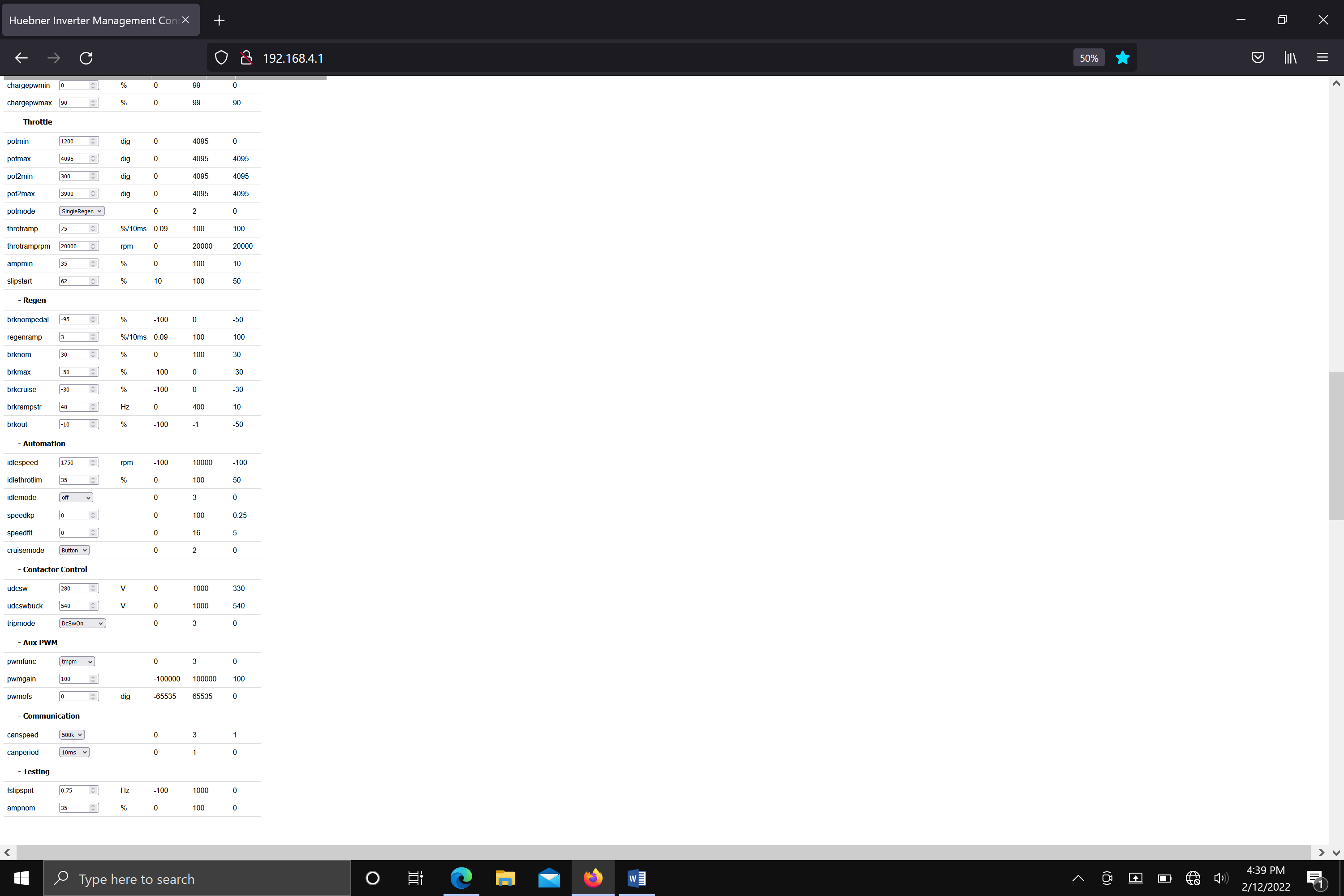

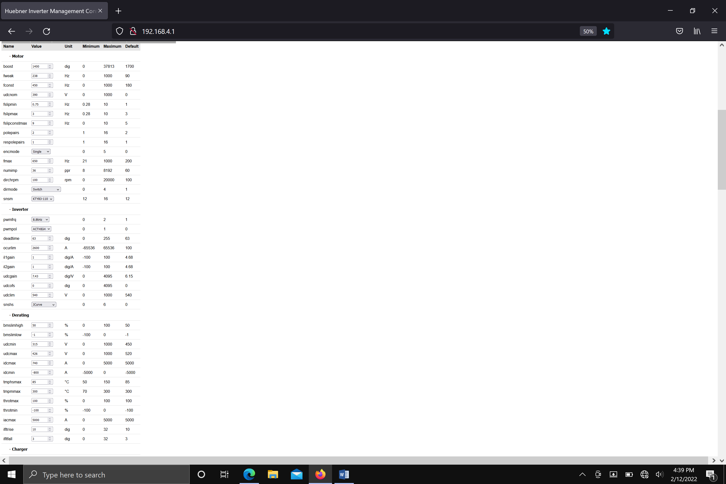

So I took the car out to make a few pulls, and tried several different settings. I continue to slam an overcurrent fault when launching hard. It feels like it is occurring right as the throttle ramp ends, i.e. when it should be delivering full power.
Oddly (to me at least), it also shows an encoder fault when it trips the overcurrent fault (see below screenshots below, yes this is from this event, I cleared the errors before the test).
The screen shots are from an attempt with idcmax of 740, but I tried as low as 700 with the same results.
Anyone see something glaringly wrong or do I just need to keep pulling back?

idcmax is a pretty slow limiter, probably won't prevent an OC event. It's more often used for reducing power long-term to protect batteries, and even then only works well with FOC (and thus PM motors).
Raising fweak might do the trick, as it will move power delivery further to the right on a torque curve.
Mr. Volk's modified software with the new parameters made significant driveability improvements to my SDU-powered vehicle (before the third inverter blew), it ought to improve your experience a lot.
