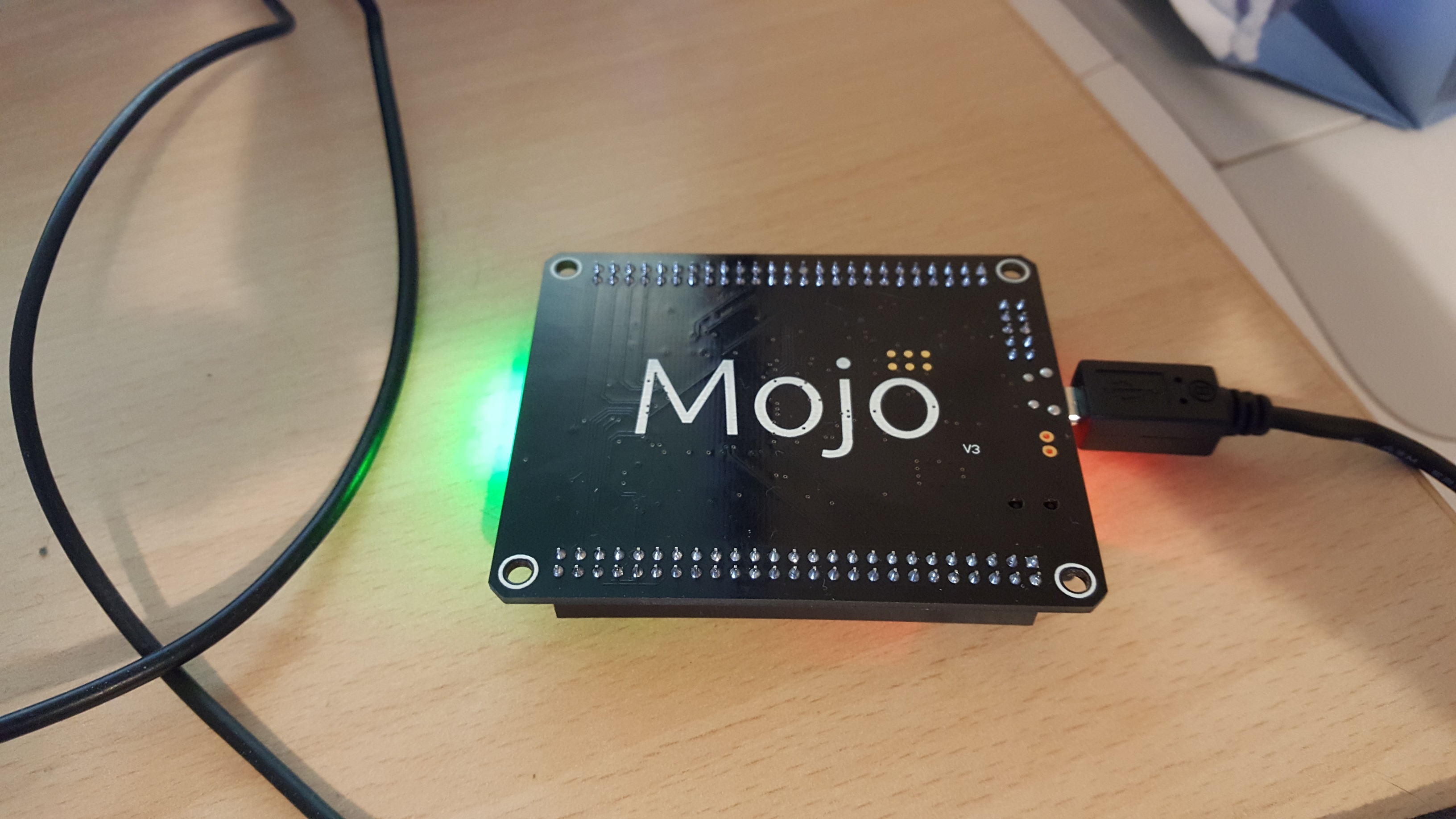

Who said I'd lost my Mojo:)
All the M3 stuff is giving me the final push to start doing some Verilog. Should have some nice knock on for further developments on other inverter boards.
