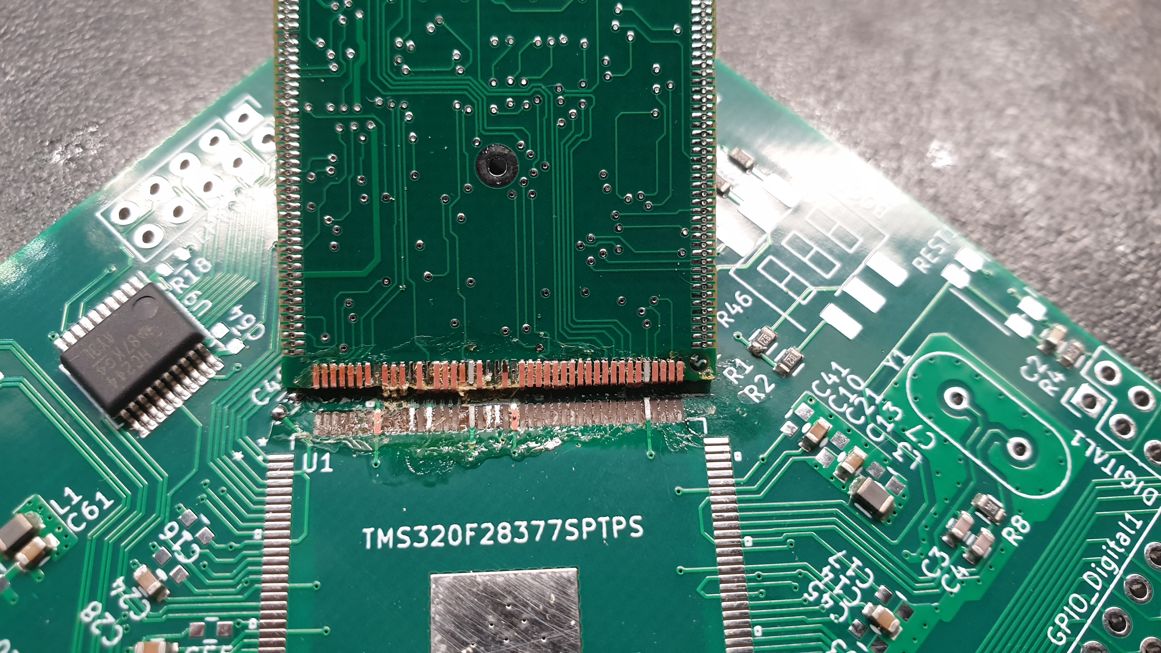

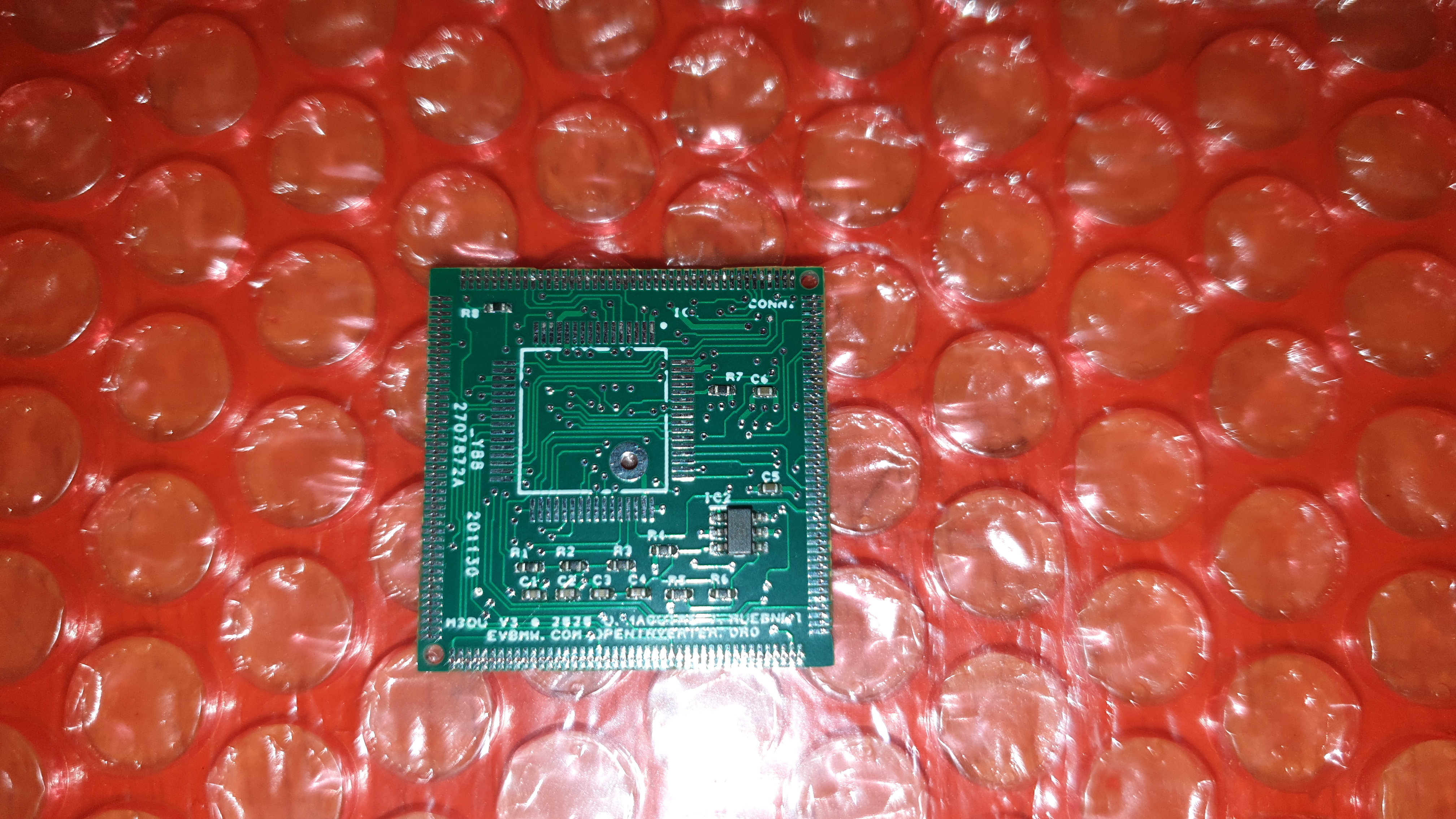

In other news began testing of the new modboard on a demo board with the 28377 footprint. Bad news first, its a little too small. I need to move out the pads about 1 to 1.5mm so the holes hit more of the "motherboard" pad surface. Good news : Once centered and drag soldered the joints are near perfect and rip the pads off when forced and don't bridge over. So we need some more refinement but the basic idea seems to be sound.
To do : increase spacing by about 1mm , increase pad drill to 0.25mm from 0.2mm to help solder flow, continue learning libopencm3 and codeblocks.
Other good news is I now have 2 SPI ports running on the STM32F103 along side the inverter firmware. Just spitting out test messages for now but will be using Colin's decodes soon once we have a board running in the inverter. Oh yeah, pro tip : The STM32 doesn't like you trying to use one DMA controller for two tasks. Who knew.....

Not too shabby
I wonder if you could fit some spring contact to the GND pad so that JLCPCB can fit that STM32 for you.
Yes DMA architecture isn't the most flexible on the STM32. DMA channels 1, 2, 3 and 6 are used. Whereas 6 is only used for single channel encoders, if that helps.

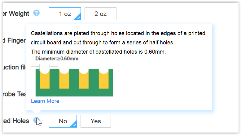

Would it be an idea to use castellated holes all around ? Might give a better view at what the solder paste is doing. Or is the pin spacing to small ?

Castellation is not possible on a 0.5mm pitch pad.

Of course I had a guy on instagram today laughing at me and calling me a moron for ripping the pads off a model 3 drive unit:) Exact same pictures as posted above .....

Sure it is, but you'd need to sand the edges of the board down yourself.
JLC PCB and the like aren't going to do it, people would complain the edges aren't perfect.
Of course then you end up having to assemble the boards yourself, which would make the process suck even more.
Yes you could do it, but it's stupid and not worth the headache.

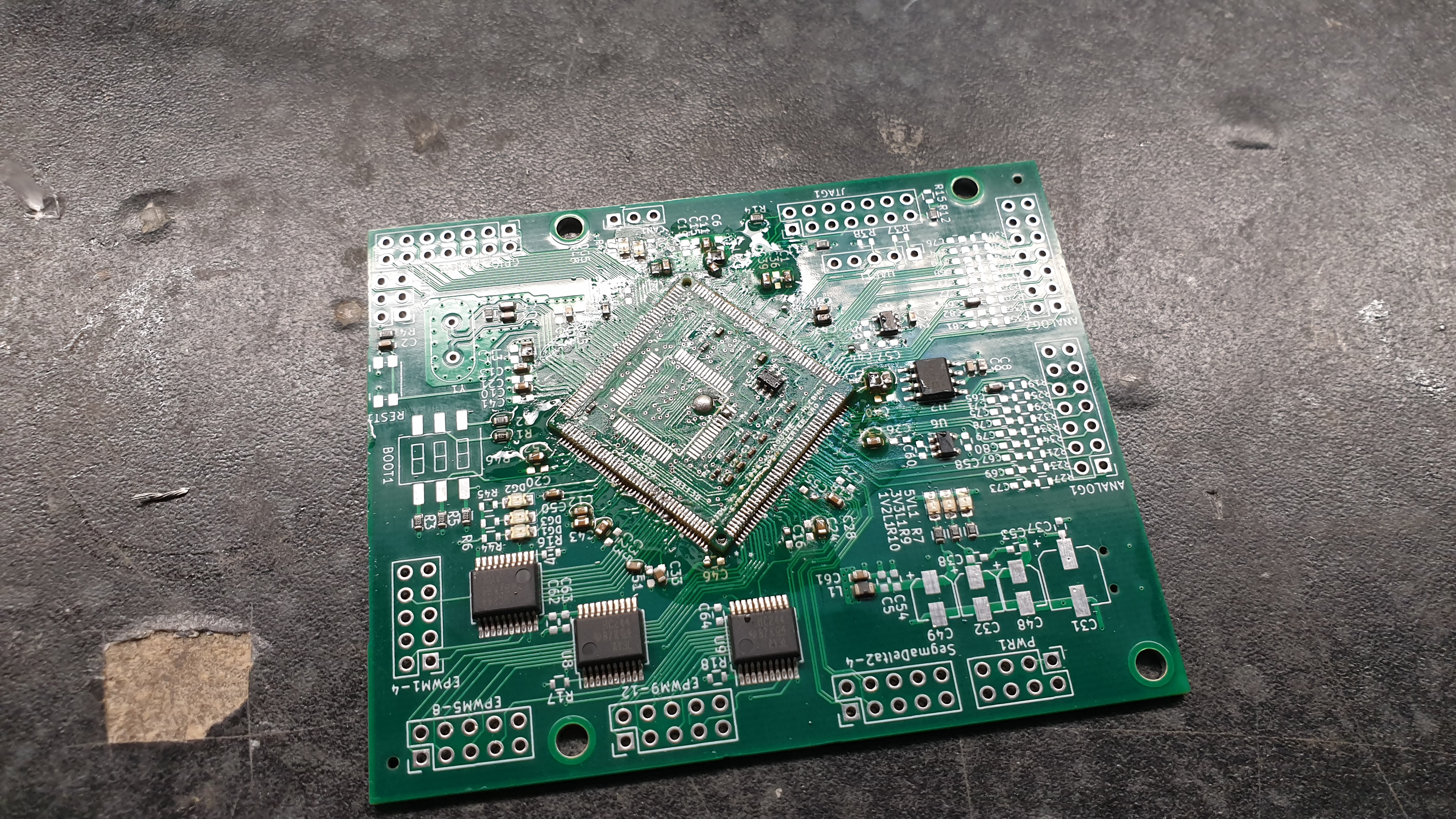

Spent the past two weeks persuading the C2000 library / examples to do useful things with my devboard.
Some 'interesting' omissions in the examples, and the string library has some funny ideas.
Some of their other examples use the "IQ" library functions, and these floating point multiplier values.
// 12 bit adc input, converted to voltage.
// 0-3.3V input range, but treat as milivolts for accuracy reasons
voltage = ( (ADC value / 4096 ) * 3300mV);
// of course the above doesn't work, the value is rounded down to zero
// So need to do this instead
// 1 / 4096 * 3300mV = 0.805664062
voltage = (ADC value * 0.805664062);

Thanks for your work on this:) I'd just love to be able to run openinverter on the C2000.

I would expect the result you got. ADCVal / 4096 is going to be an integer calculation. You have to promote the math to floating point when you know you need a fractional value. (ADCVal / 4096.0f) would have done it. Otherwise the compiler is smart enough to use the most efficient math possible. Integer division is way faster than floating point, especially since 4096 is a power of 2 so the division is almost certain to get optimized to a right shift instead. I would imagine the C2000 has a barrel shifter in the ALU so Value/4096 is going to be a single cycle operation. So, sometimes you do have to force the compiler not to optimize so well. Or, get the "do what I meant, not what I said" plugin.station240 wrote: ↑Tue Dec 29, 2020 11:33 pm Spent the past two weeks persuading the C2000 library / examples to do useful things with my devboard.
