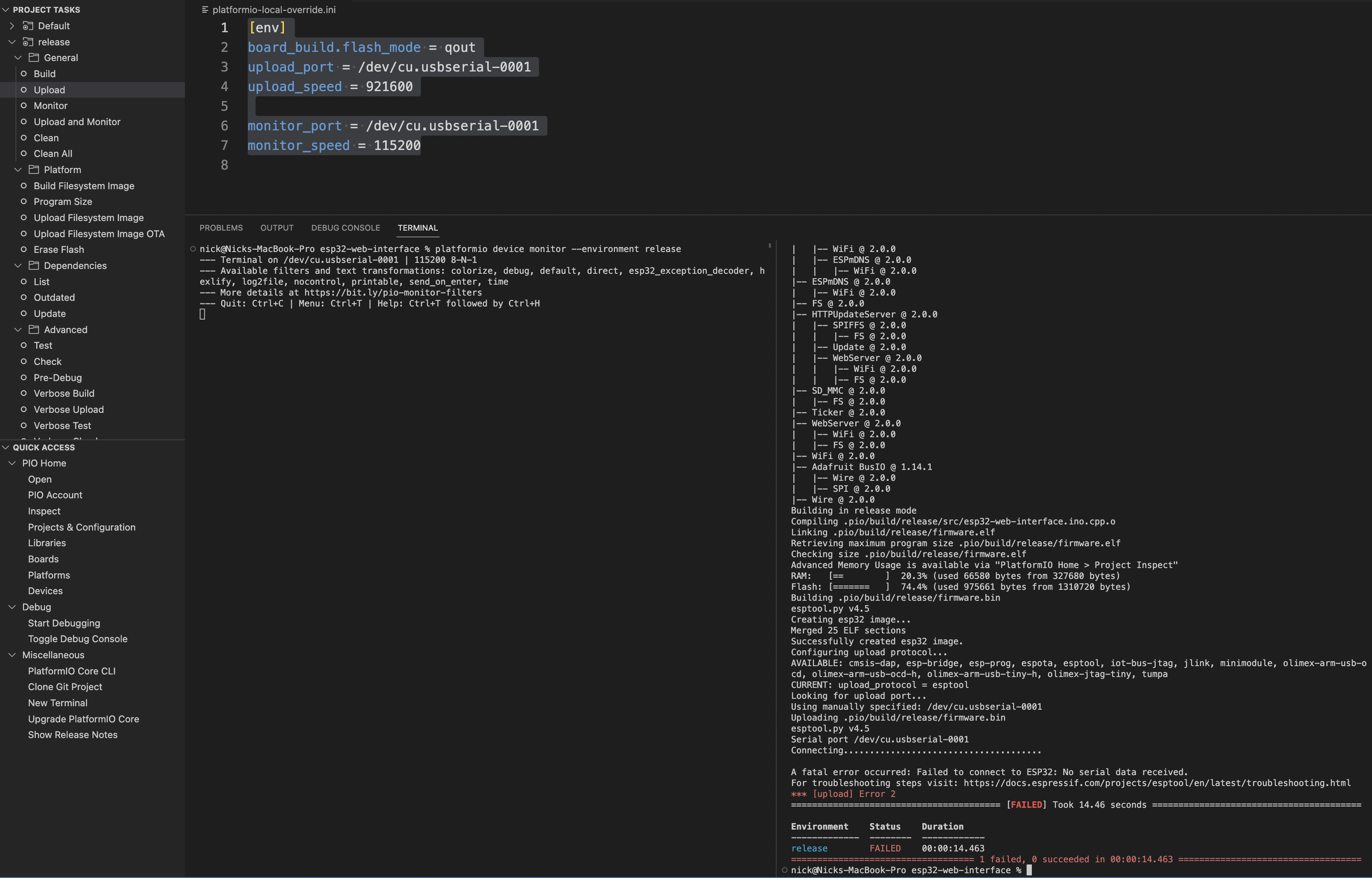

Ok, I had some time to try Pete's repo yesterday, but I keep getting the error: Failed to connect to ESP32: No serial data received when I try to run:
 pio run --target upload
I'm using a 6-pin header + jumper to bridge PROG and GND per @johu's comment and confirmed the voltage is 0v when running.
After cloning Pete's repo and installing the PlatformIO Core CLI, on both my Mac and PC I ran:
pio device list
and see:
Mac:
/dev/cu.usbserial-0001
Hardware ID: USB VID:PID=10C4:EA60 SER=0001 LOCATION=2-1.2.3
Description: CP2102 USB to UART Bridge Controller
/dev/cu.SLAB_USBtoUART
PC:
COM3
Hardware ID: USB VID:PID=10C4:EA60 SER=0001 LOCATION=1-2.2.3
Description: Silicon Labs CP210x USB to UART Bridge (COM3)
I created an platformio-local-override.ini in the project with:
[env]
board_build.flash_mode = qout
upload_port = /dev/cu.usbserial-0001
upload_speed = 921600
monitor_port = /dev/cu.usbserial-0001
monitor_speed = 115200
I tried all three ports but I just get the same error no matter if I'm on Mac or PC.
Reading thru various ESP32 forums and videos I'm finding a lot of folks suggesting to add a capacitor to the EN pin of the ESP32 to fix this error, but it looks like the board already has one (C60). I also installed the drivers for the USB TTL adapter but didn't seem to help.
Attached is a pic of how I am connecting the serial adapter.
Any ideas about what I might be missing/doing wrong?

Does this tell you if it's getting into programming mode or not? What does it actually say when it successfully enters programming mode? Do you think it's unable to connect because the module is not actually entering programming mode?

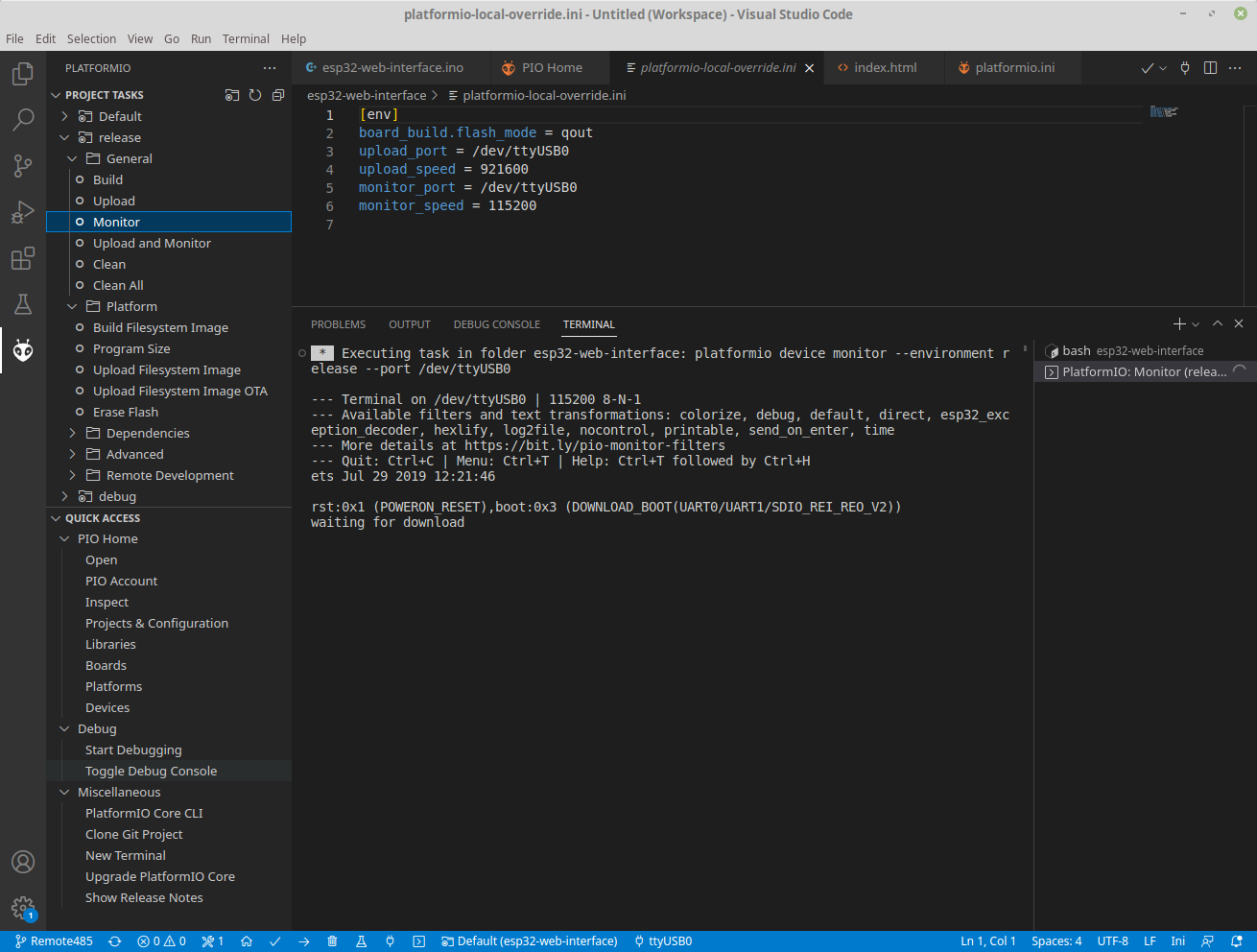

This is what I see in the monitor window when powering the ESP up in programming mode (the waiting for download being the important bit):

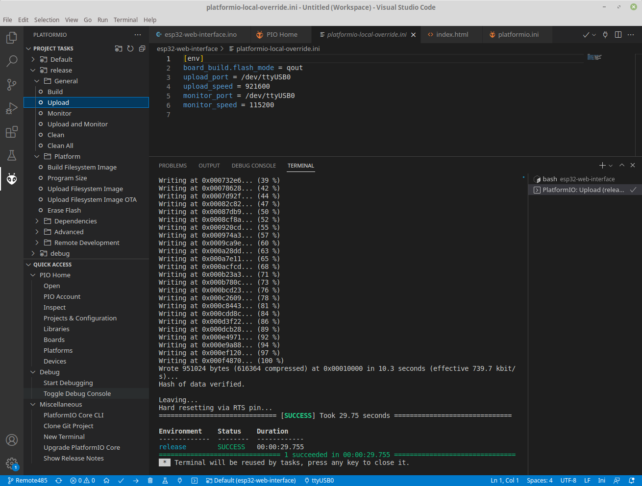

And then this is the end of the Upload sequence:

Yeah, I tried swapping the TX/RX lines, but I got the same exact error.
Here is what I see:
I noticed your monitor output indicates it is waiting for download, and mine does not. It feels like my issue is that it's just not going into programming mode.

Sure! With 12V power to PIN13 and the 5V wire removed from the dongle:
  • 3V3 PIN: 3.281
  • EN PIN: 3.280
  • IO0 PIN: 0.0
I still see the same monitor output and error when programming. No indication of waiting for download. I tried bridging the PROG jumper before and after powering the board, but I didn't see any serial monitor activity when I did so. I even tried two other boards (I got five from JLCPCB), and so far, three have the same behavior.

Some promising developments. I'm not sure what I did, but the monitor finally said, "waiting for download". I then tried to program it, but it failed with the same error as before. When I rechecked the monitor, it seemed to be back in normal mode again. This happened ~3 times in a row. Now I can't seem to get it back into programming mode at all again. :? Something is off. Perhaps a flaky connection or order of operations thing. I will chase it down.
You have reassured me that I'm not totally missing a step and am mostly doing everything right. Thanks again for all the help. Have a good night!

So I can't get it to go into programming mode via USB 5V at all. I tried unplugging the entire USB dongle and just the 5V pin to reset it, but it always boots back into normal mode for me. Maybe I'm doing something wrong.
However, if I power the board via 12V, disconnect the USB 5V pin, and then flip the Tx & Rx pins so that Tx->Tx and Rx->Rx, it boots into programming mode consistently now, and I see "waiting for download" in the serial monitor!
Unfortunately, I still get the same error when trying to upload! Progress, at least. I'll keep at it.

Re: How to program ESP32 Web Interface on V8 SDU board?  [SOLVED]
Oh, one thing I haven't mentioned: the STM32 mustn't be programmed, otherwise you get bus contention on the TX line! So either erase it or hold it in reset.
