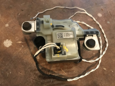

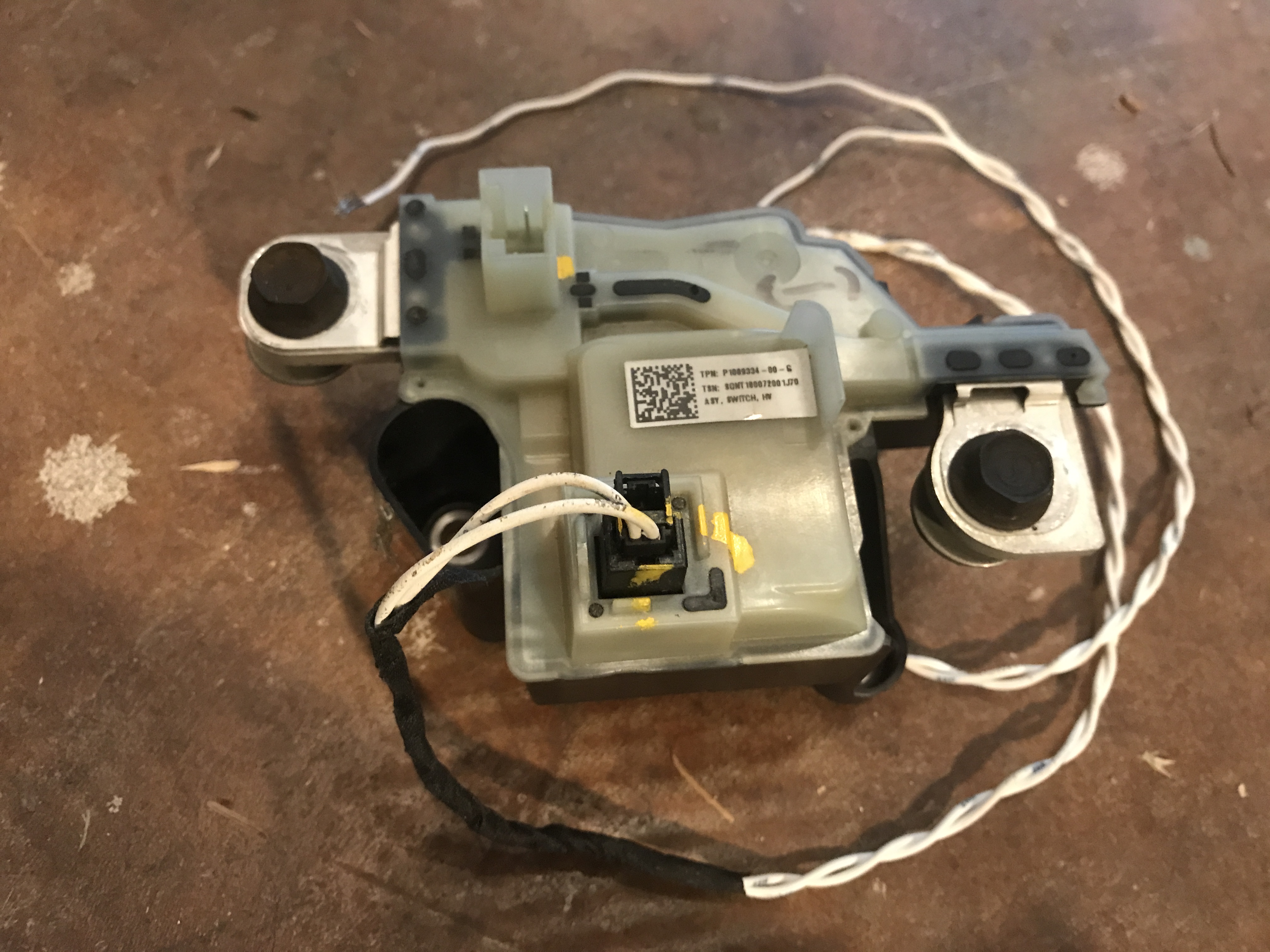

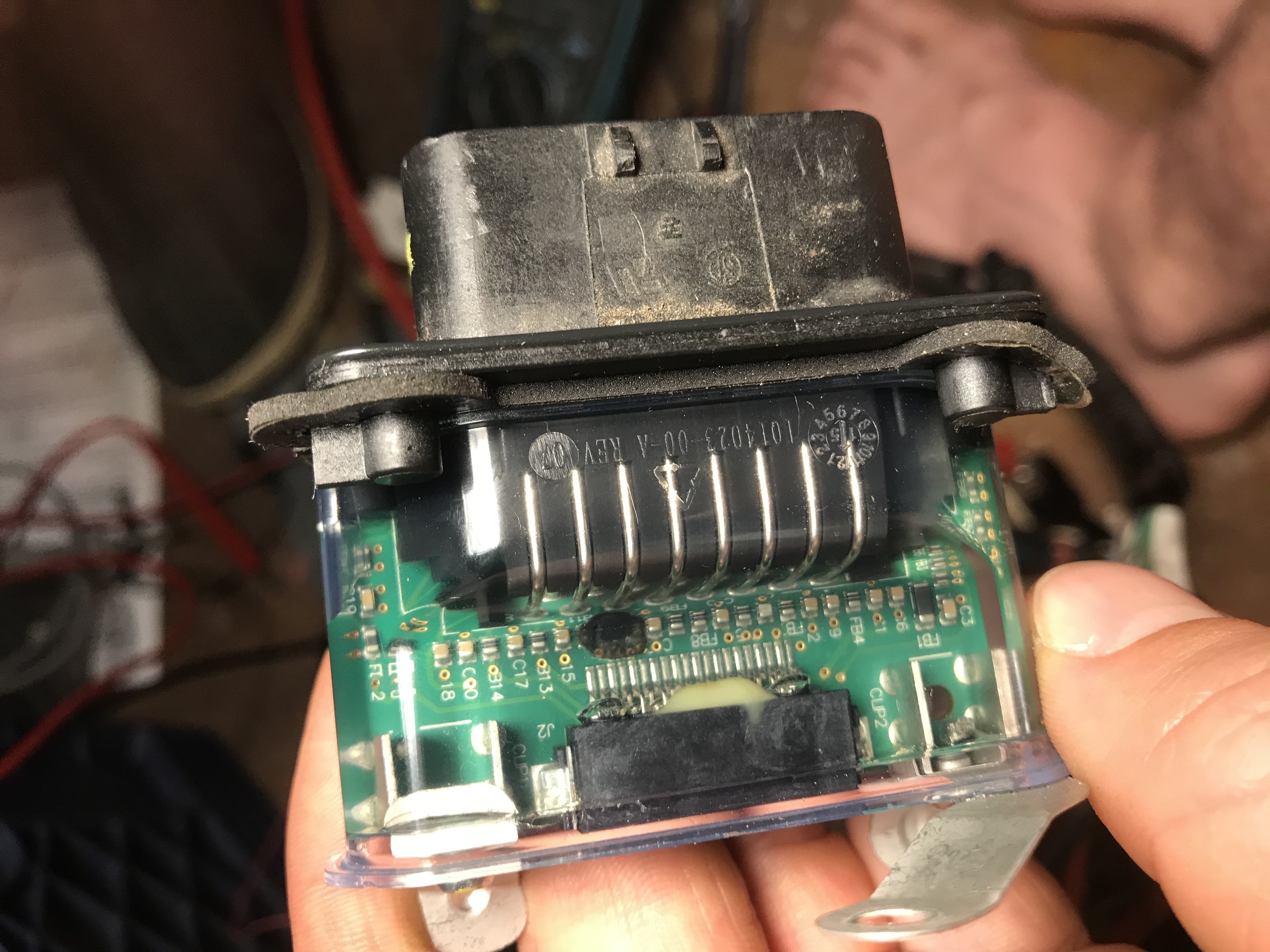

I think we found the problem, it’s the inverter side of the ampseal connector. See the fried black splotch on the circuit board (See pic) seems to correspond with pin 6.
The one time I got things to work properly and shut the main contactor, I was using a contactor from Model3 (pictured). I’ve since realized these contactors get extremely hot from 12v power when closed for extended periods of time...not sure why. So, what are your thoughts guys? Any theory for how/why this may have happened and importantly, how to avoid it happening in the future??

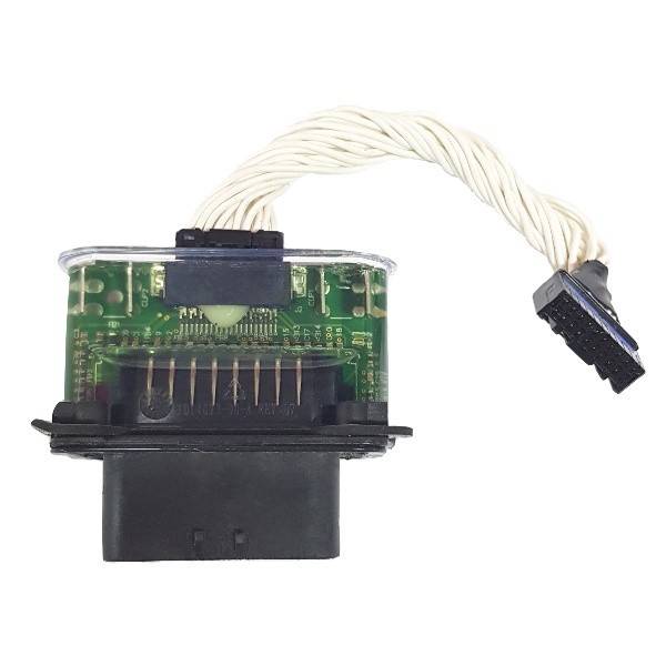

can anyone with a fried inverter send me this Component? Or have another idea for sourcing it? Doesn’t look like an easy repair as the thing is filled with gel and not clear how to disassemble to get to the problem area

Tesla contactors require economizer circuits... here's some background information;
https://www.gigavac.com/sites/default/f ... al-PWM.pdf
I recommend you use contactors with built in economizers.
Edit: I've updated the wiki;
https://openinverter.org/wiki/Tesla_Model_3_Contactors
I would also recommend you discard the Tesla contactors that got hot. A failure under load would probably destroy the LDU inverter.
