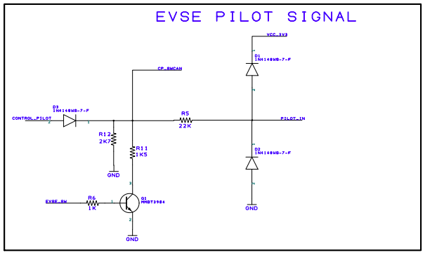

jon volk
Posts: 574
Location: Connecticut
Re: Gen 2 Charger V5 Software Development Thread
Post by jon volk »
It seems the pilot signal may need work. Generally everything seems to be working but both my evse and charger will get clicky spasms on occasion. It seems the evse will shut of briefly, then modules start clicking off/on, then evse clicks on....repeat 2 or 3 times, then were good for a while.
I dont fully understand (nor looked in depth yet) at the pilot signal requirements vs. what is being read.

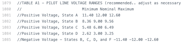

Kevin Sharpe
Posts: 1339
Location: Ireland and US
Been thanked: 10 times
Post by Kevin Sharpe »
jon volk wrote: Wed Apr 29, 2020 7:49 pm I dont fully understand (nor looked in depth yet) at the pilot signal requirements vs. what is being read.
I had a very quick look at the hardware/software and we may have an outstanding issue with the pilot State B (Ready) to State C (Charge) transition control circuit. This line is commented out in V2, V4, and V5 software;
//digitalWrite(EVSE_ACTIVATE, HIGH);//pull pilot low to indicate ready - NOT WORKING freezes PWM reading
I know some EVSE actively check the pilot signal and may get upset if they don't get the correct levels. I also note on V5 that R11 (1K5) in parallel with R12 (2K7) is a 964R load as opposed to the 882R required by the standard. I'll check the tolerances in the latest documents when I get a moment.

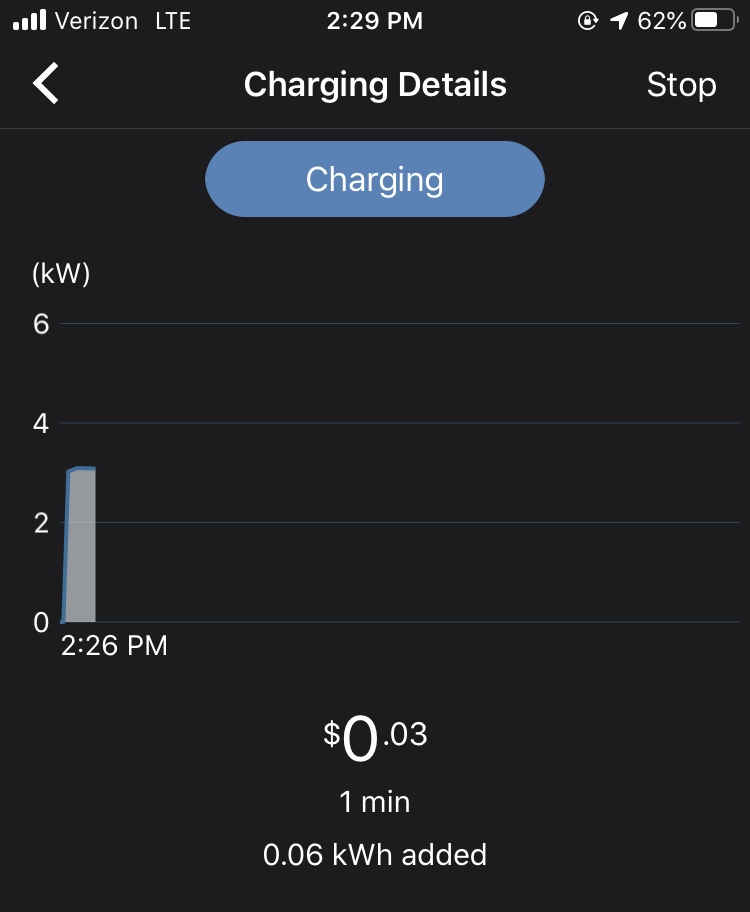

jon volk
Posts: 574
Post by jon volk »
So in an effort to bypass any pilot read, I swapped the following code in based on the high value read from my EVSE to give a steady state input to the controller. I am still getting intermittent performance from the charger. It will not give a steady output over time and it seems to only be operating on two phases of DC output despite all 3 LEDs being on and AC registering on each input. I attached a serial log but did not have a chance to try and get a CAN log as well.
 else
    //accurlim = (micros() - pilottimer) * 100 / duration * 600; //Calculate the duty cycle then multiply by 600 to get mA current limit
    accurlim = 52400;
Serial log.xlsx
(17.84 KiB) Downloaded 363 times
jon volk
Posts: 574
Post by jon volk »
I upped the static accurlim value to the max of 65535 and get a current reading at the evse of 32amps. Module 2 in the monitor still shows 0 DC output current.
jon volk

Kevin Sharpe
Posts: 1339
Kevin Sharpe wrote: Wed Apr 29, 2020 9:02 pm I know some EVSE actively check the pilot signal and may get upset if they don't get the correct levels. I also note on V5 that R11 (1K5) in parallel with R12 (2K7) is a 964R load as opposed to the 882R required by the standard. I'll check the tolerances in the latest documents when I get a moment.
I've checked the IEC61851-1 standard (see attached extract) and can confirm the resistors are defined as 2K74 and 1K3 with a +/- 3% tolerance.
Looking at the OpenEVSE source code (here) it can tolerate a pilot signal with a 250-600mV deviation from nominal (see attached source code snippet),
When I get access to the workshop I'll measure the pilot signal levels and confirm operation of Q1.
