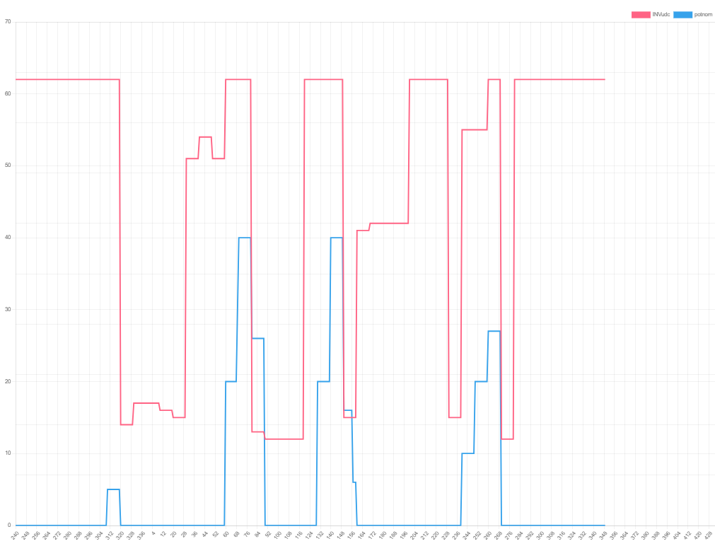

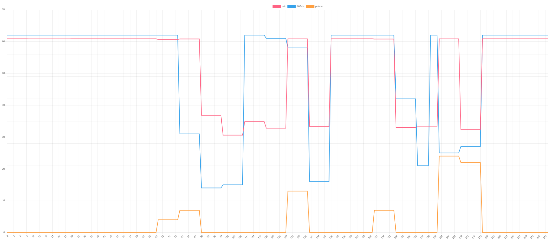

took three 12 V lead-acid batteries and connected them in series (36 V) as HV power source.
Basically same behaviour, the output shaft just rattles / shudders but does not spin.
I just realized that "idc" shows a negative value, is this correct or did I switch polarities?
here is a plot with idc ...

Re: Minimum configuration to get L210 running on the bench / how to initialise ISA shunt?
set MotActive to MG2
set regenmax to 0
Show all your spot values with the Zombie in RUN mode. Just save the webpage as pdf via print.
MotActive set to MG2
regenmax set to 0
Spot values with the above new parameters:
Huebner Inverter Management Console.pdf
same behaviour:
Screenshot 2025 ...
OK, partial success. Found a broken wire / loose contact between Zombieverter and Inverter.
Now the Inverter is up, yet when I press the throttle the motor(s) is only shuddering and doesn't spin.
Could this be due to wrong settings or is my Power supply too weak (5 A at 60 V)?
