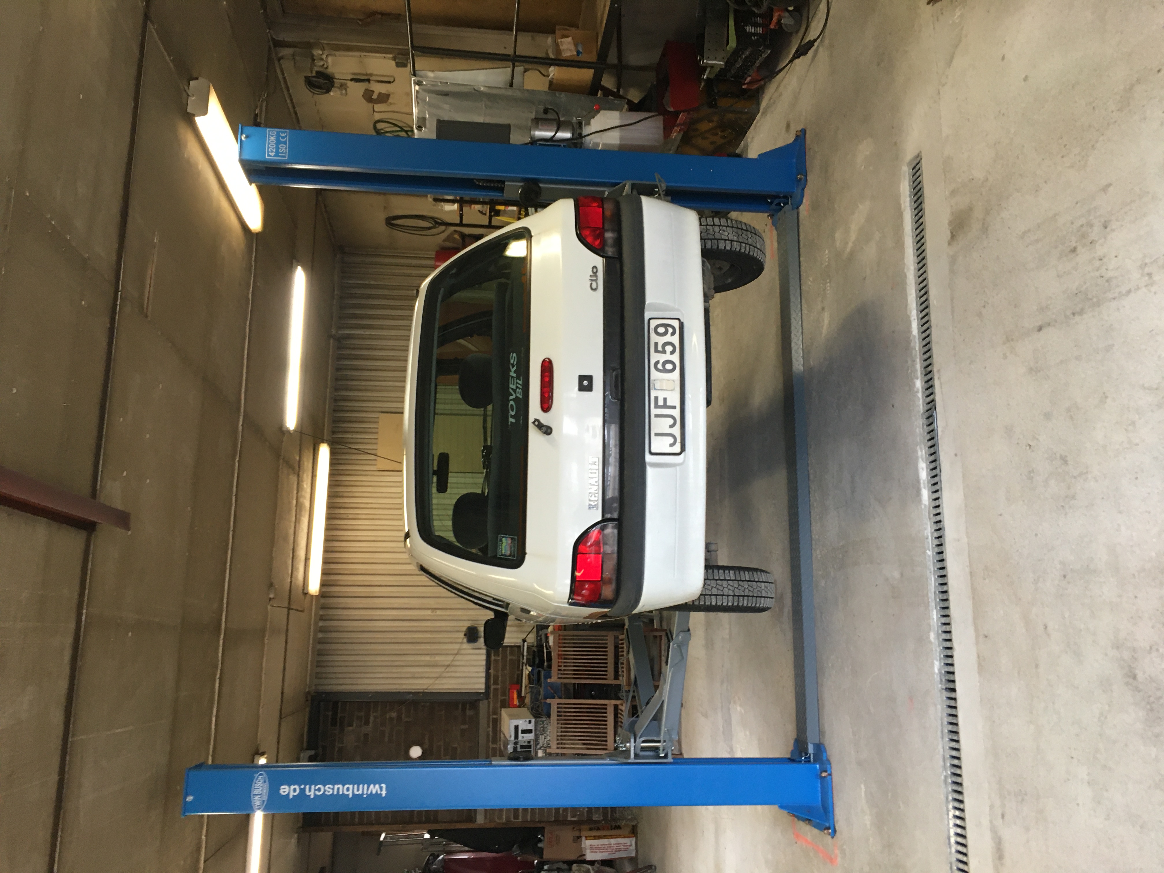

- Mon May 25, 2020 6:35 am
- Forum: Projects
- Topic: Citroen C8 with Tesla stuff
- Replies: 19
Re: Citroen C8 with Tesla stuff
Ok one major milestone is now passed.
The lift is in operation!!!!
I now have a working lift in my garage.
Now I just have to plan some more on how to spend more time with my parts abd get them to work as they should.
Regards
/Per
Regards
/Per
