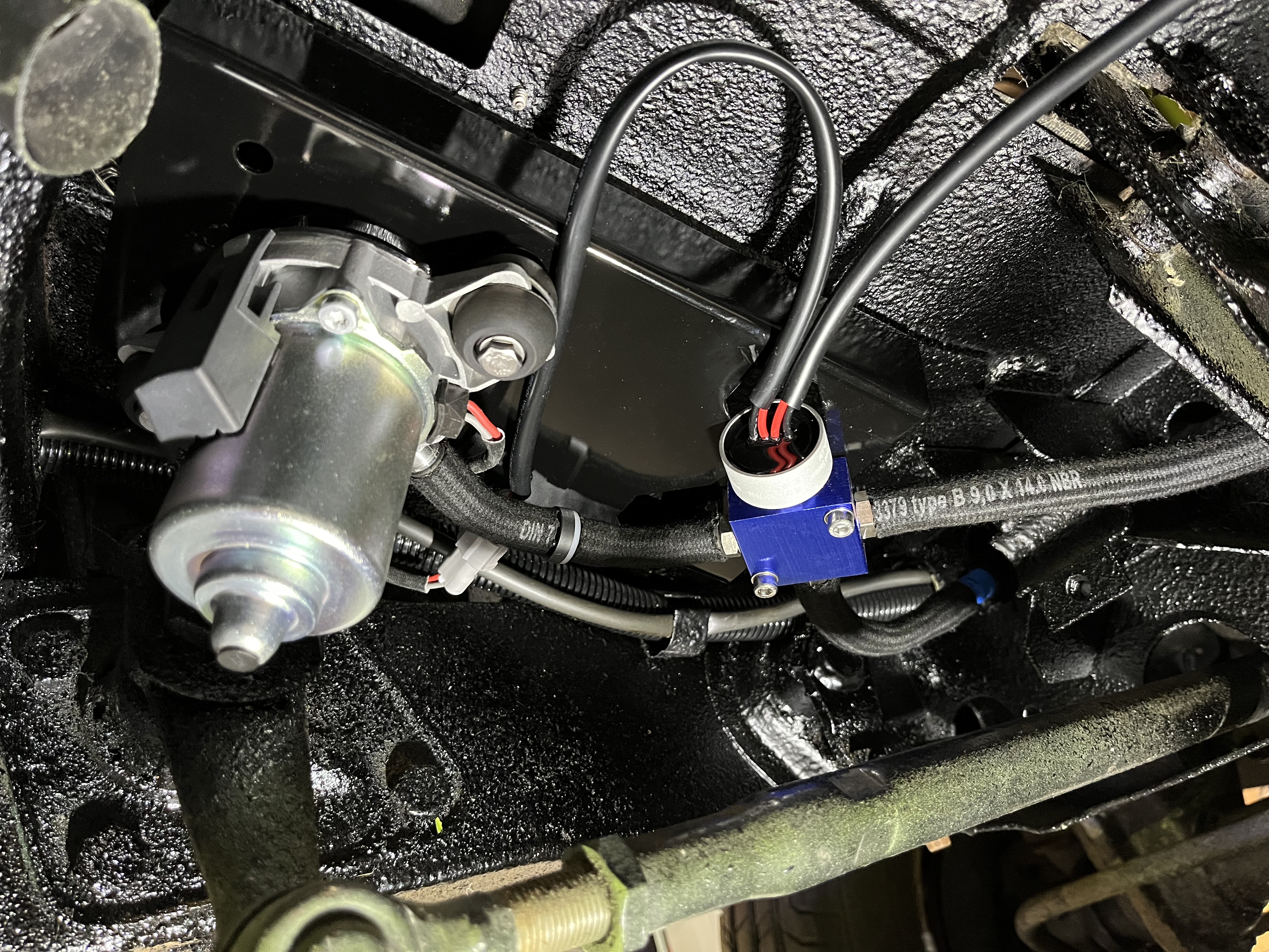

Re: [DRIVING] 1978 VW T2 Camper
New vacuum sensor from Citini (attached to the blue manifold). Works a treat - I am now getting about 7 seconds pump run time every 24 seconds, which may indicate a slight vacuum leak but it will do for now.

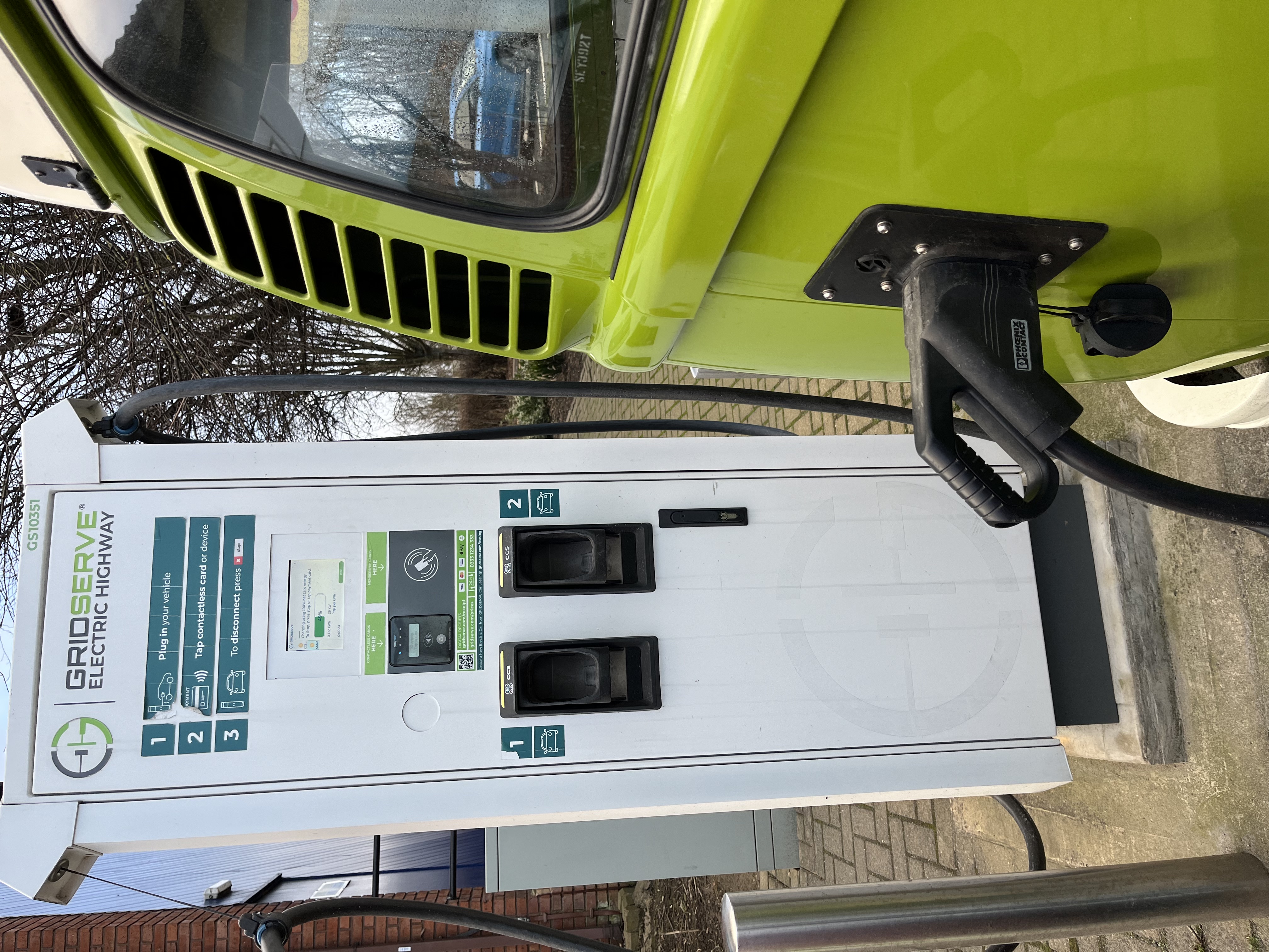

CCS controller and inlet is in. Kit at eDubs posted a video before I picked her up.
Next I need to improve the brake pump with the vacuum sensor I got from Citini, then it will be time for an interior.
I've fitted a vacuum pump for the brakes. This photo is before connecting the hose to the servo. It works but I'm not happy about the lack of hysteresis in the switch (i.e. the pump runs for a very short time every few seconds and every time you apply the brakes). I got another make of switch but it ...

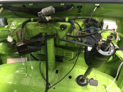

Re: 1978 VW T2 Camper
Wiring is all done now and wheels turning. This is the under-dash loom before I put the dash back in. Not long before road test time.

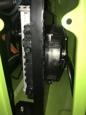

Can't get any better pictures than this with the battery in place. Hope this gives you some idea.

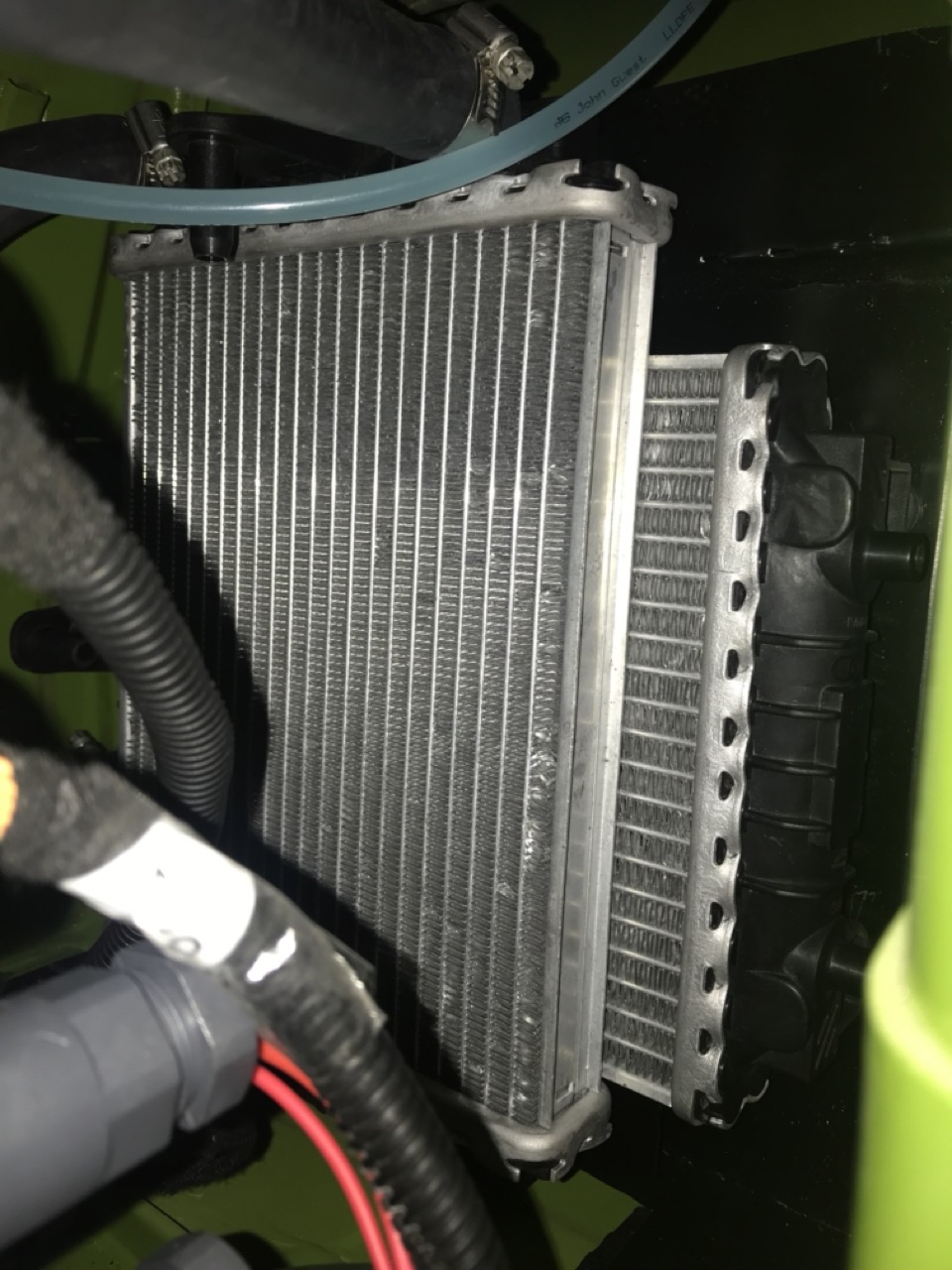

I don’t know what radiators and fan they are, but they are small and mounted back to back. I need to put the 12V battery somewhere else, as it wouldn’t be possible to get it in or out with the main battery box in place.
