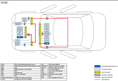

Re: Hyundai Kona won't start just turns on but will not go on drive.
I think this topology is for a LHD as my IGPM is on the right, not left as shown
Can't remember where temp comes from but the battery percentage is from the BMS.
My car is RHD, if yours is LHD wiring layout is a bit different.
While working on getting access to the ETM I suggest you unplug the connectors between the wiring under the dash and the loom on the floor on BOTH the RH ...
You're on the right track with the VPN.
Yes A piller as per your picture.
The following photos show the wiring harnesses. You can just make out the block of connectors down by the door. The loom runs along beside the door and also branches across the car under the seats.
The following is based on my experience with a 2021 kona, so may not be exactly the same on the 2024.
At the base of the front A pillar on both sides are large connector blocks with several connectors.
This is the point where the engine loom, main harness, and floor harness all connect together.
I'd ...
I'd ...
Hi Fuss,
You say the car has "damaged doors" can you provide more detail?
The P-CAN bus goes around the engine bay and inside the dash area but all so goes into the floor harness and down to the back of the car.
So depending on where the damage is it may be damaged further down the car.
