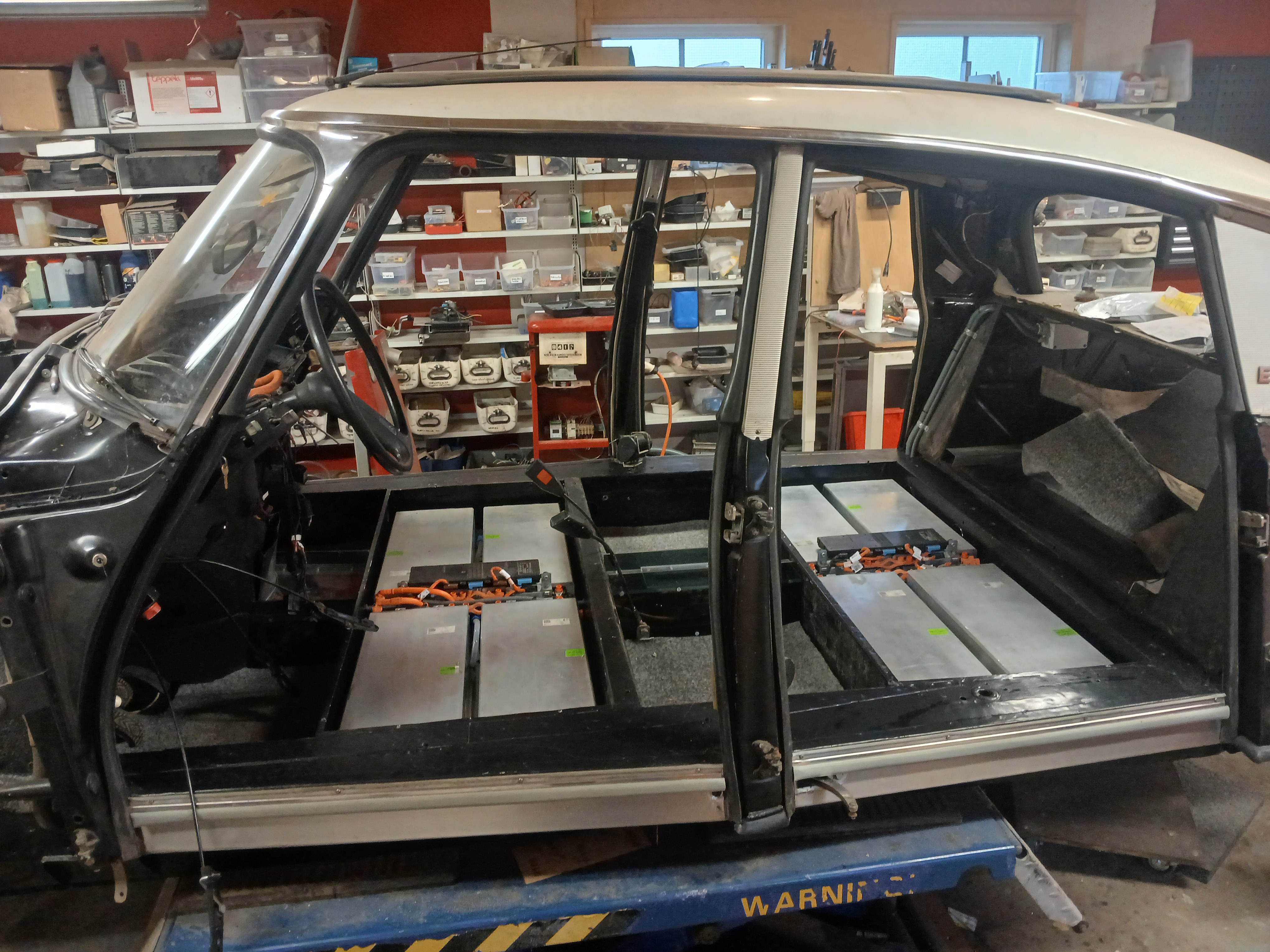

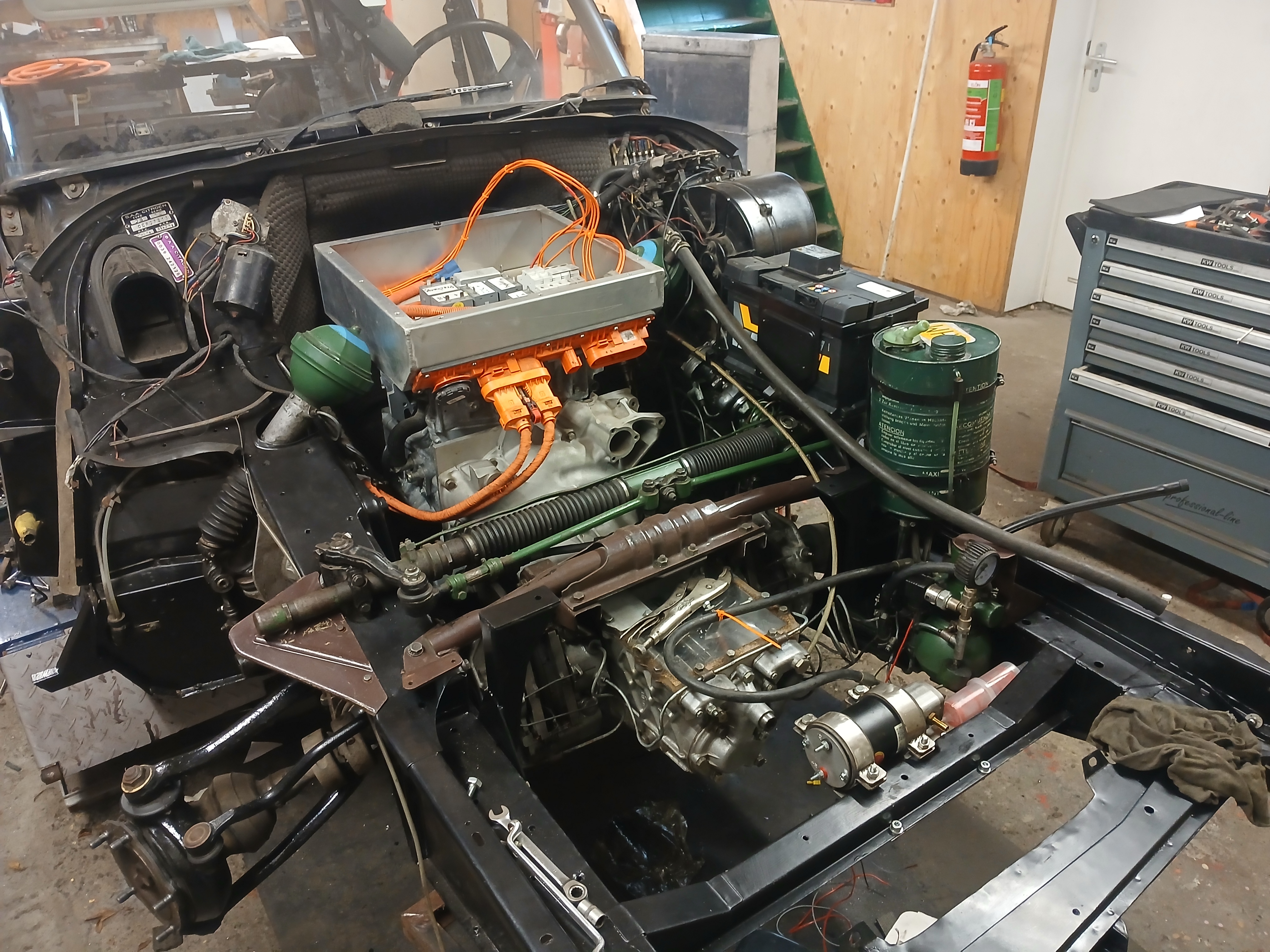

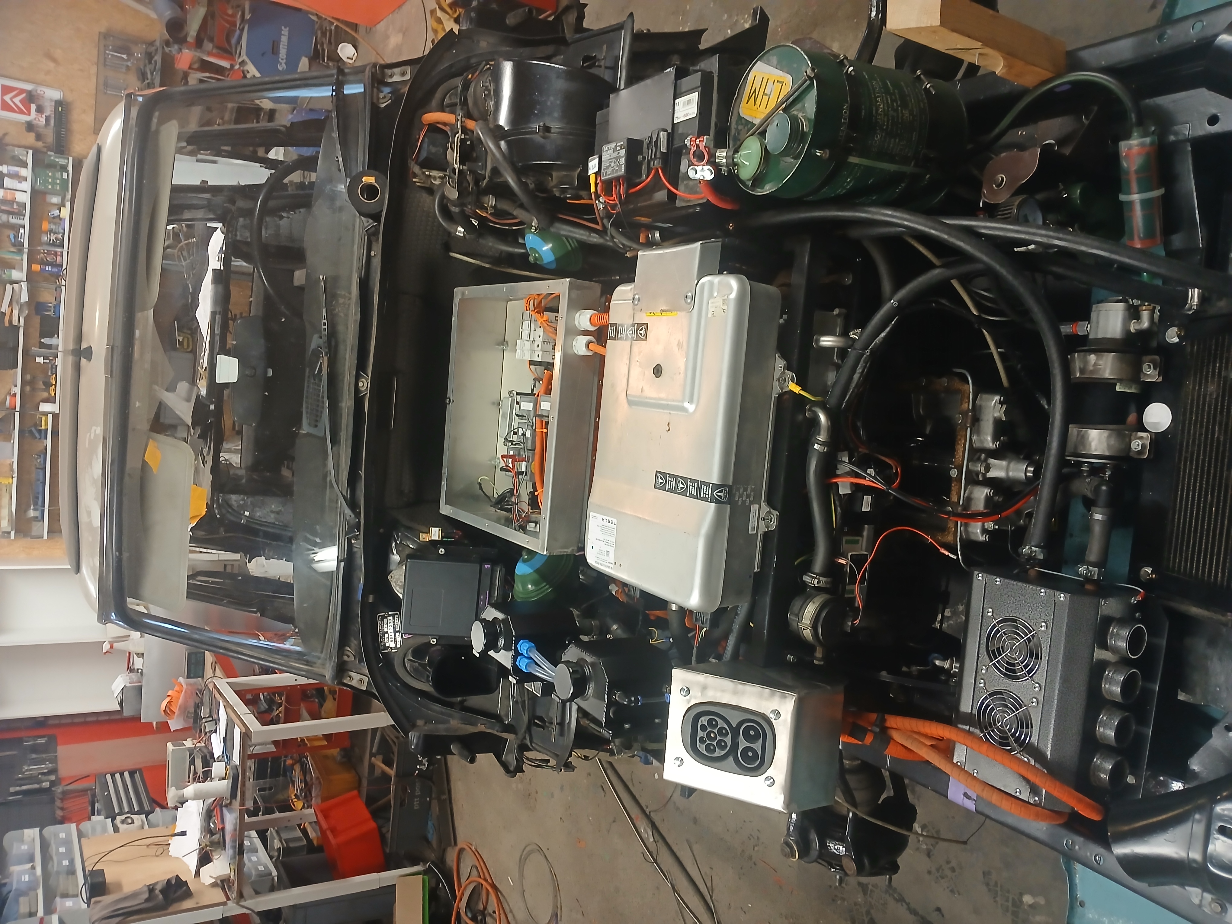

It's been a while since I posted anything. In the meantime, I've restored the chassis and installed the test setup in the car.
Here are some pictures of the conversion
It looks like everything is working including the hydraulics.

Last year I started preparing to upgrade my DS. Since we bought a house in Roosendaal this project was on hold for a while. But I am working on it again. At the moment I have the testset running with 8 MEB batteries equipped with a SimpBMS with display, tesla DC/DC charger, Tesla Charger Gen2,

Last weekend I finised connecting the gearbox to the Leafmotor.
I rebuild the gearbox with only the second gear working. The ratio from the second gear is about 1:8.5.
