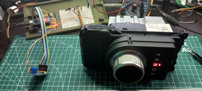

I'm going crazy!!! :x Bought a new GSM JLR EH22-7E453-AB. Uploaded Gen2 sketch to Arduino nano. Knob does not leave when sending 's'.
Connection: PC - USB - Arduino Nano - MCP2515 - CAN GSM. Connection GSM:
1 - 12V,
2 - 12V (IGN),
5 - CAN H,
6 - CAN L,
10 -12V,
12 -Ground
What's wrong? Please ...

I decided to go the other way. Turned on the CAN bus and began to analyze ID 0x312.
0x312 from selector
Byte
0. 00 at all times
1. 20 when locked, 10 when unlocked
2. 8F in park, 8E in R, 8D in N, 8C in D, 88 in S
3. Cycling depending on gear state.
4. 00 at all times
5. FF at all times
6. 00 at ...

I downloaded the arduino code Gen 1 from here
https://github.com/Tom-evnut/Land-Rover-Gearknob
You are talking about code Gen 1 JLR GSM. Maybe it's 2 different codes?

There are alot of checksums involved so you need to have an active controller doing it. Static messages do not work, this is why I made the Arduino code public.
Unfortunately it takes quite a bit of effort to make things like this work, if you are not comfortable with CAN bus this is not ...
