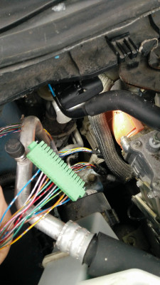

I did a runthrough of the pins while I was there - crap recording as it was more for my own records than general dissemination, however in case it's useful, it's available here: https://photos.app.goo.gl/hQRUhUv4tmceGEPi9 .
For the record, I did check the charge port previously and it came up rosy ...
