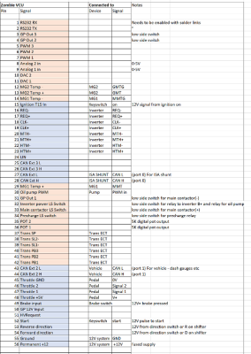

Re: Zombie gives no power to Inverter pin
tom91 wrote: Sun May 05, 2024 12:49 pm It is a LS (low side) or a pull to ground pin.
So you need to wire it as such, 12V to the relay other side to the pin.
Thank you. That made a big difference :)
It works now. Just need to get an accelerator pedal to run it now :)
Hi and please help
I'm trying to set up the GS450H to test it. I have updated to version 2.15.A and I do get the Zombie in to Run mode but I don't get any power on pin 32 (Inverter Power LS switch).
I understand that pin is to connect to a relay for power Inverter and the relay for the oil pump.
Any ...

In the list of pins on Zombie VCU on pin:
(12) (MG2 Temp-) (MG2) (GMTG)
(13) (MG2 Temp+) (MG2) (GMT)
(14) (MG1 Temp-) (MG1) (MMTG)
(29) (MG1 Temp+) (MG1) (MMT)
Is this correct? Should it not be MMTG on MG2 and GMTG on MG1, and MMT on MG2 ang GMT on MG1?
