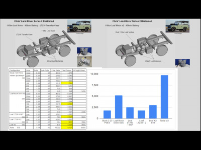

Re: Nissan Leaf Motorvarianten
I’m thinking about using the Leaf for the conversation on my 1960 Series 2 Land Rover. I live in the mountains so torque is very important to me. Here are a couple of options/comparisons that I’ve come up with…
