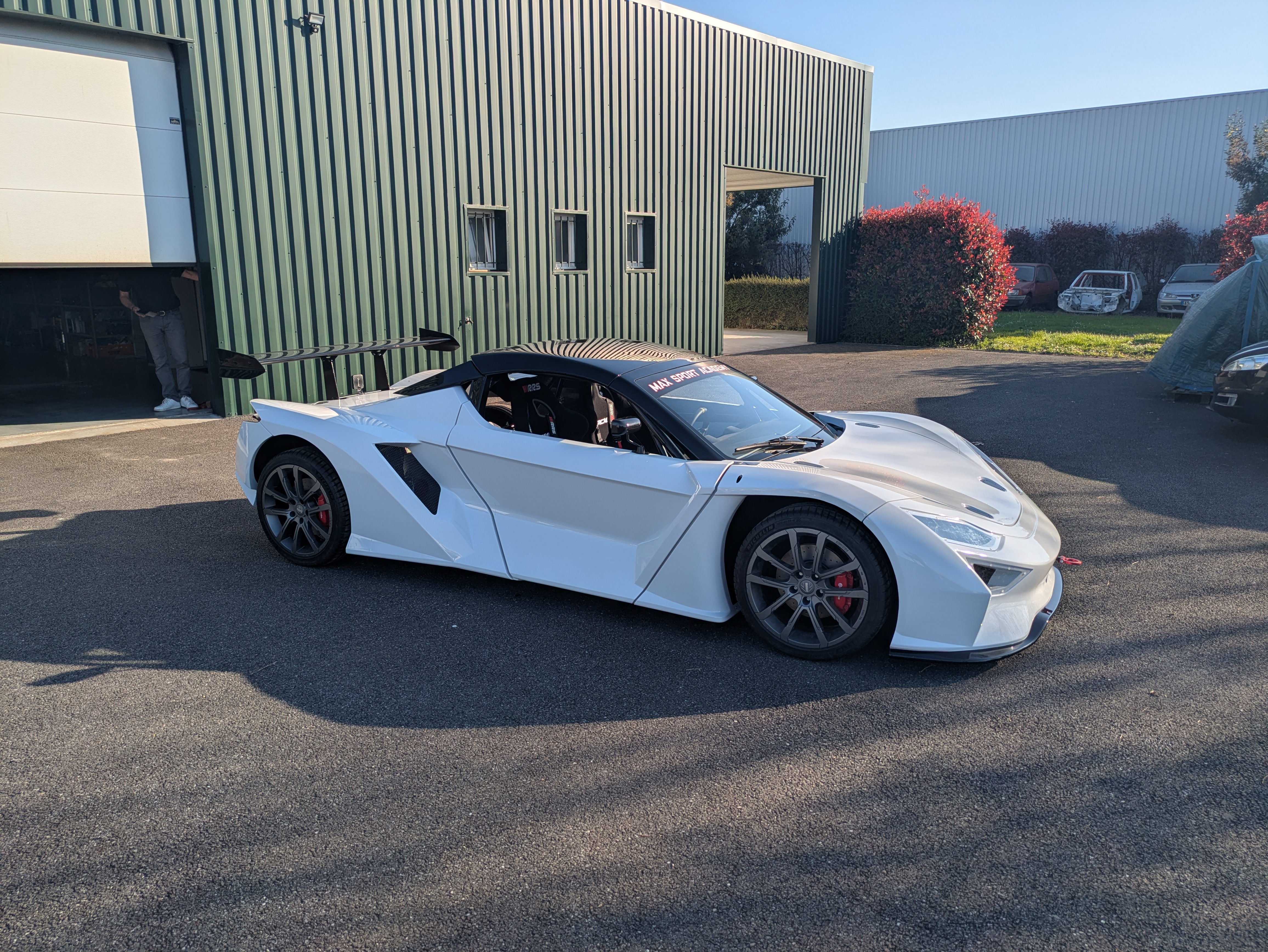

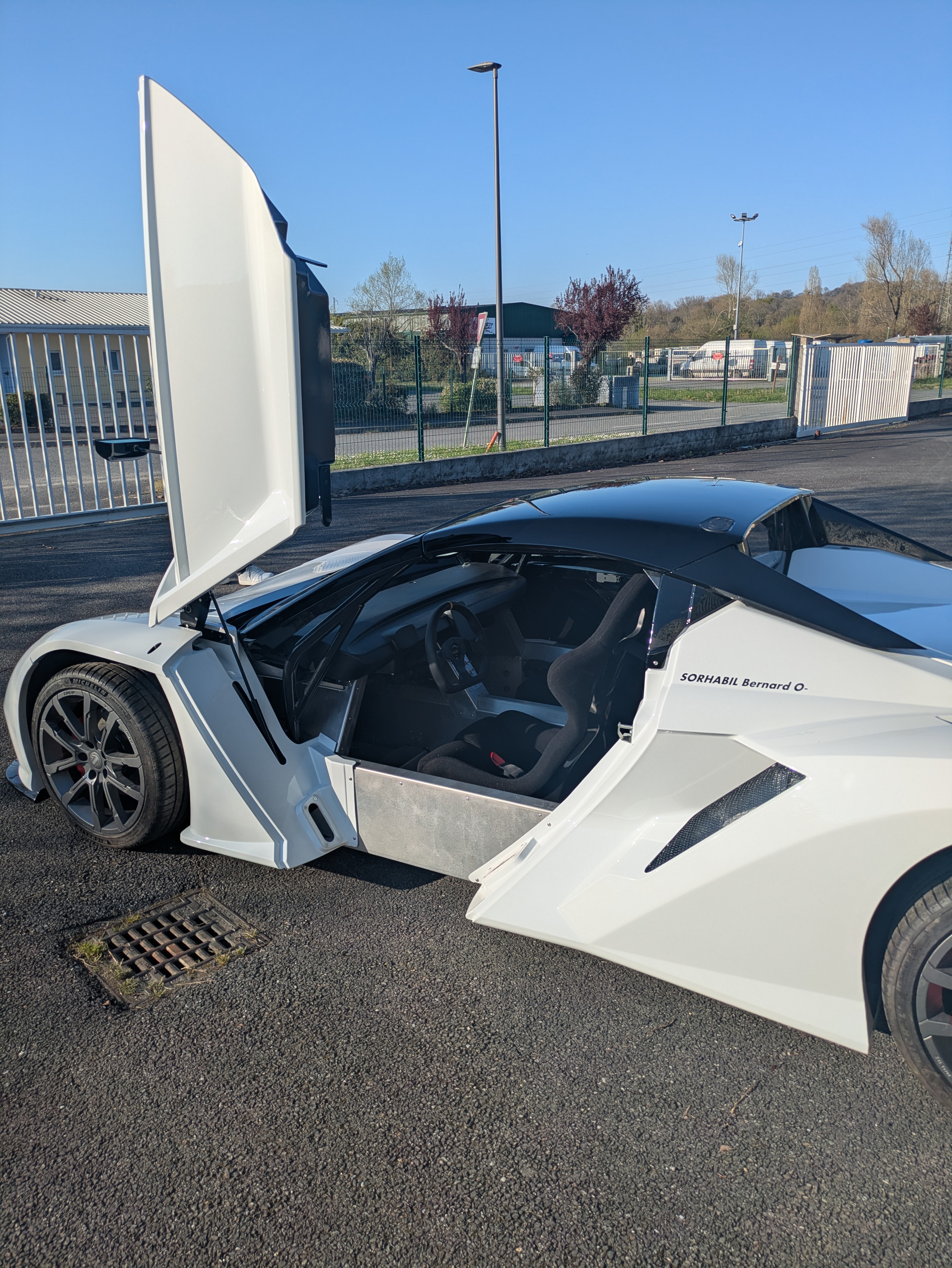

Chassis is completely assembled now. Waiting to meet FFSA, the French Motorsport Association to confirm HV regulations.
Then I will start to build the 2 battery boxes and HV loom.

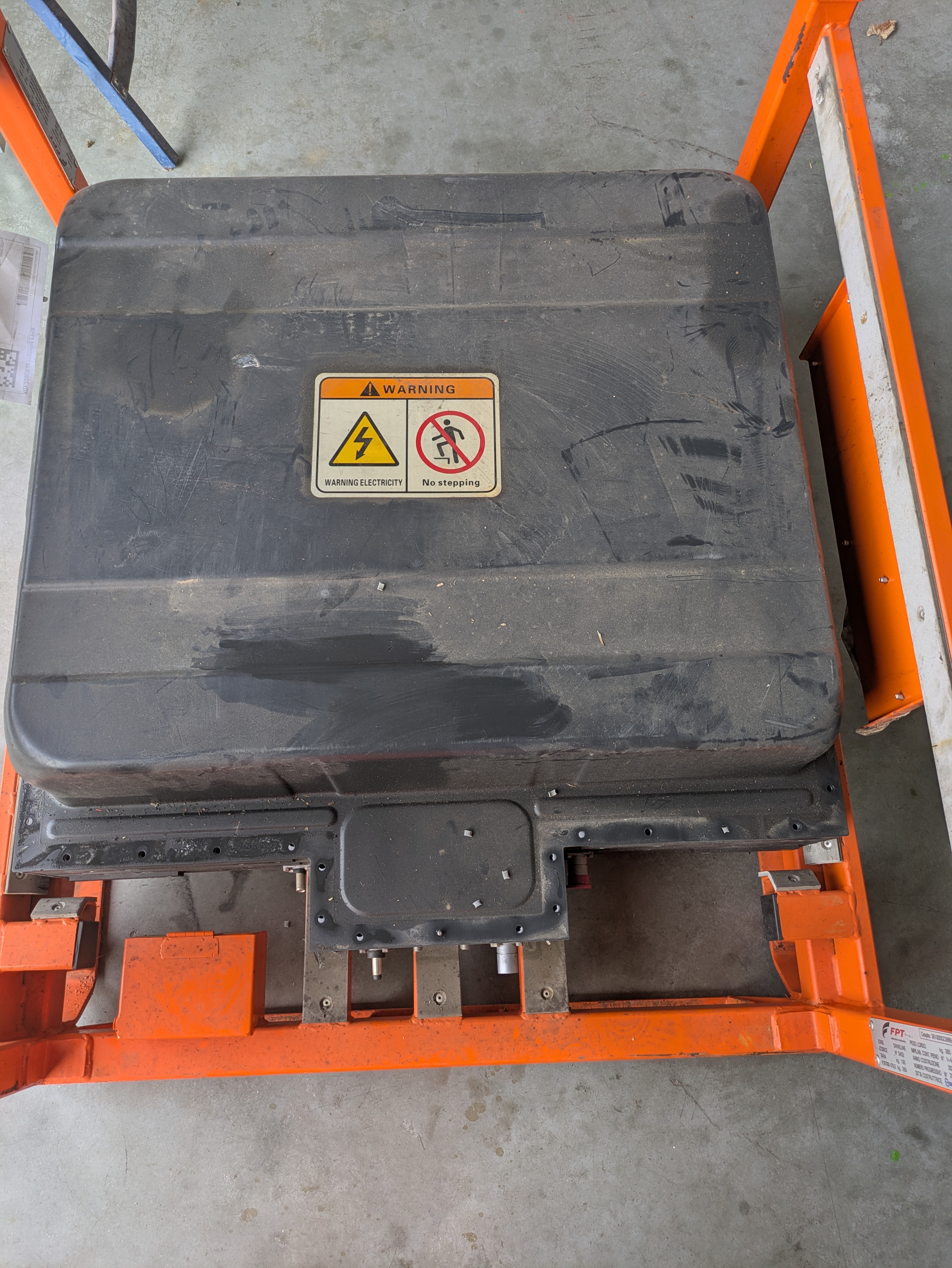

Just received a full battery pack from a 1000km eDaily.
I have disassembled it to reuse the 16 modules (total 96S), the BMS and cooling plates.
I will now need to make 2 battery boxes to fit them into the car.

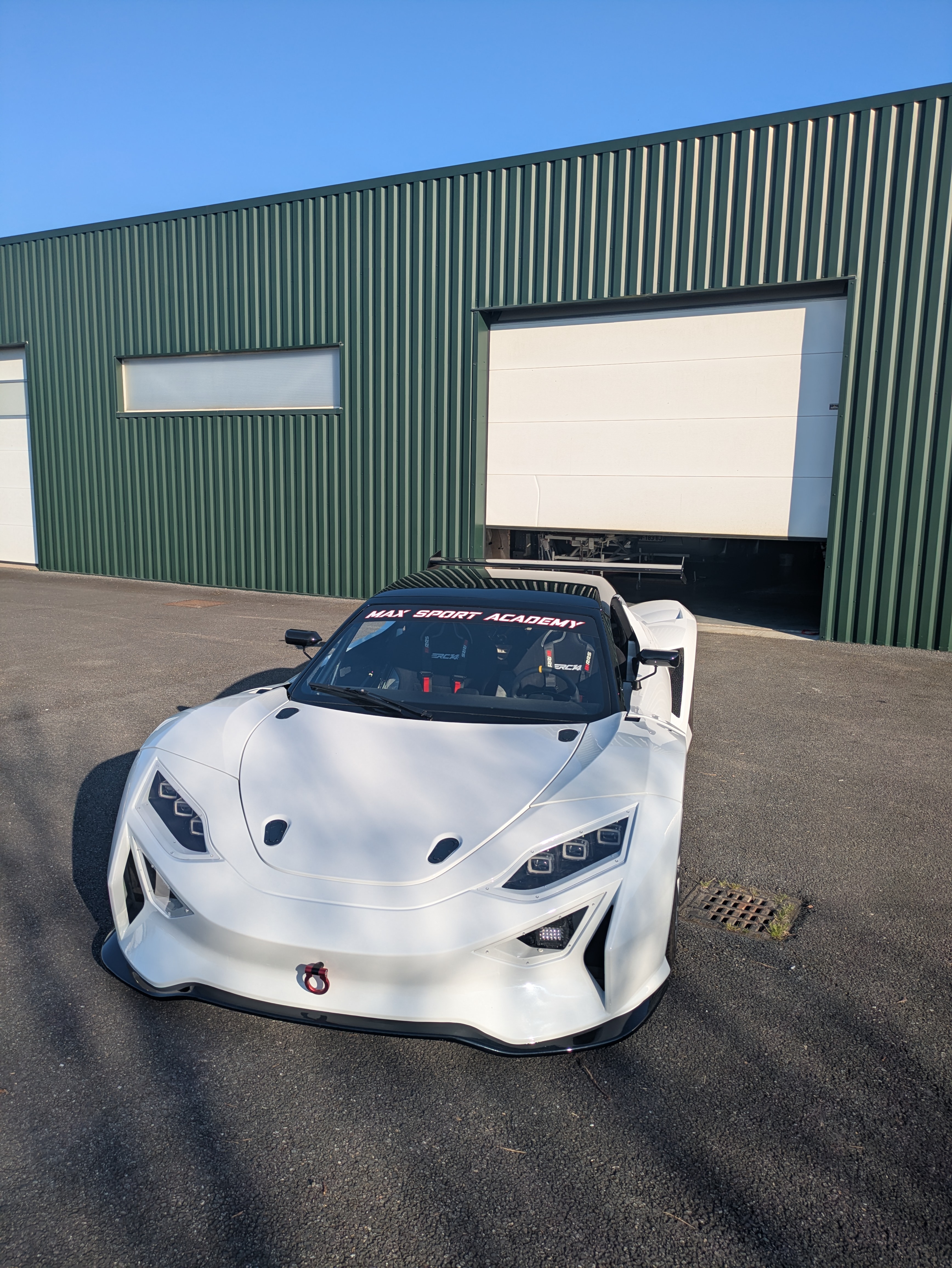

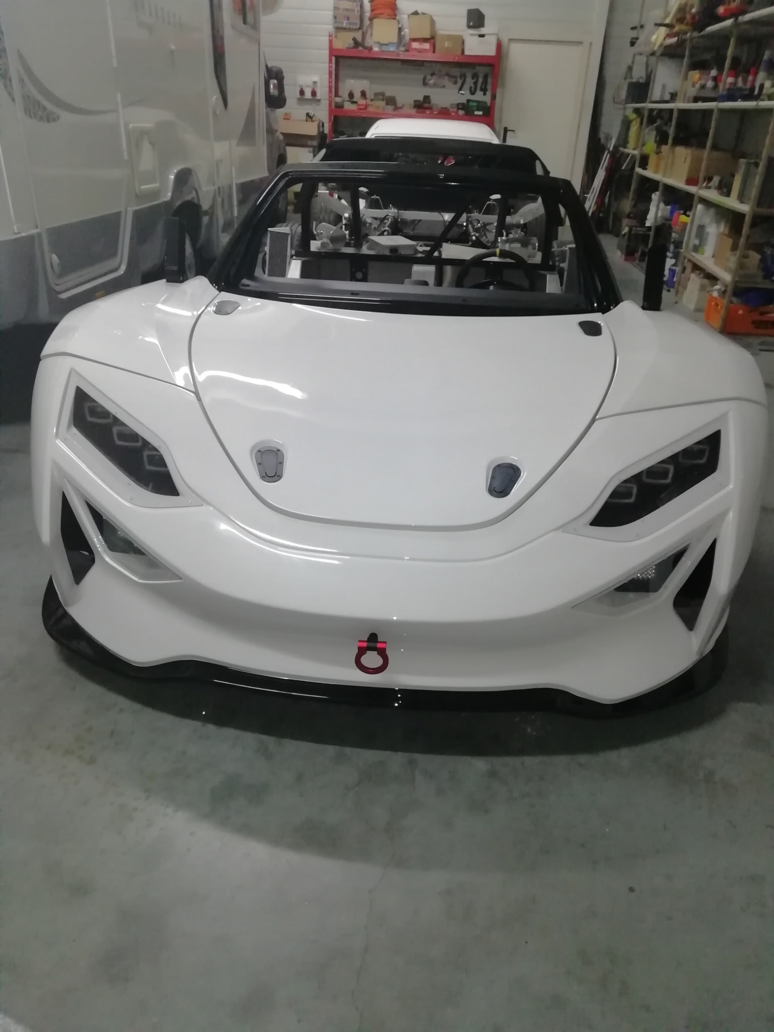

The body is now painted. Front end assembly in progress.
We are in the same time purchasing all parts to do the battery pack and HV wiring. We will finally go with Taycan modules instead of Stellantis ones.
