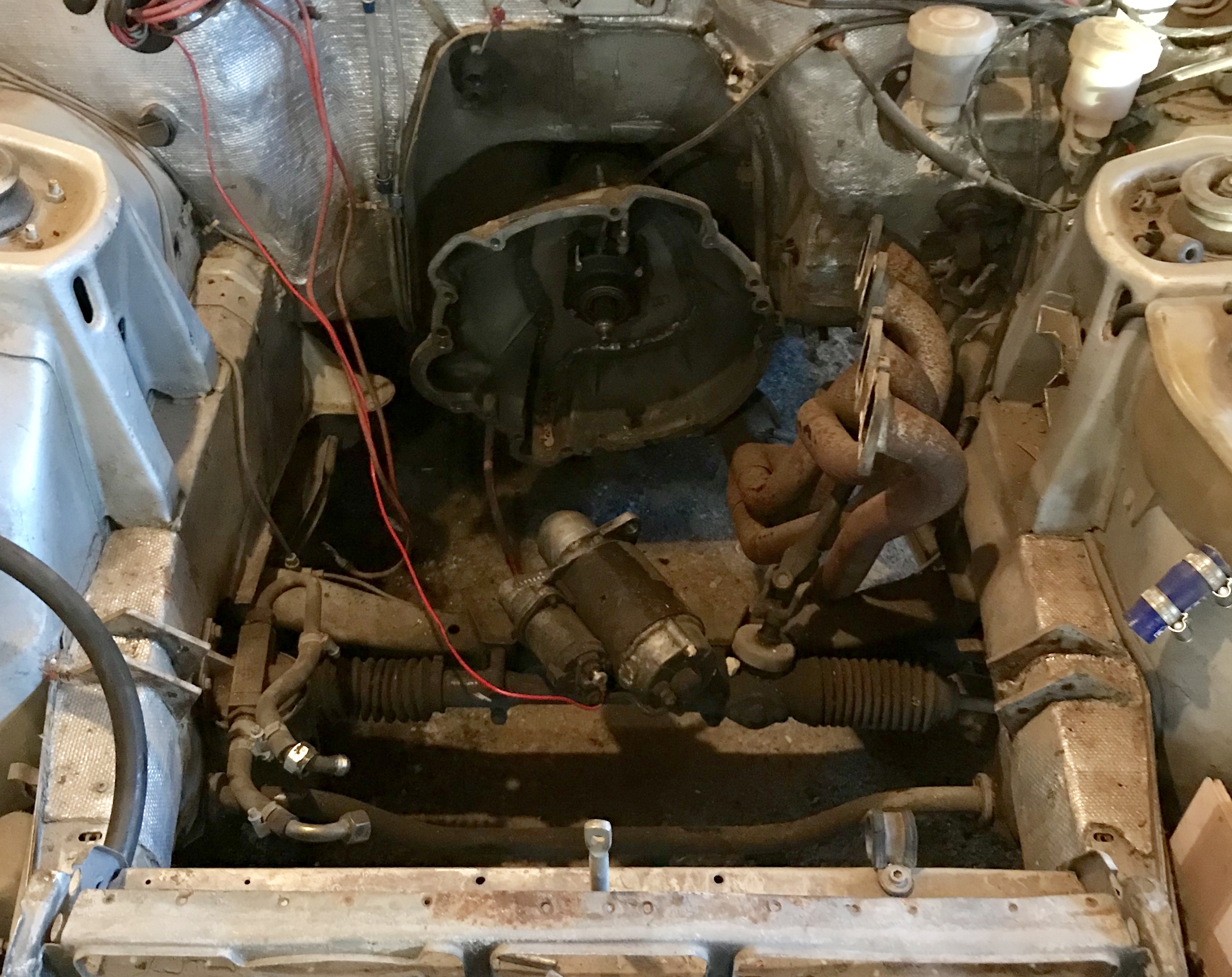

Re: Porsche spice
Rover V8 removed, a long time since the engine bay has been empty. Yes when I built the headers one side went around the steering shaft. At the time it seemed trivial.
