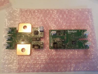

Yeah I was struggling to get them myself. I had Mountain Pass Performance/Motec Canada order them for me.
Of note they don't come with any connectors so you have to order them seperately. I really think sendyne works exclusively with larger parties.

hi qckslvrslash,
nice project! I look forward to seeing it progress, may I ask where you got the sim100? I have reached out to sendyne but had no reply..
Of note they don't come with any ...

Two pretty cool things turned up in the mail today.
Sendyne Sfp200 and Sim100 responsible for my current monitoring as well as detecting any hv leakage to chasis.
