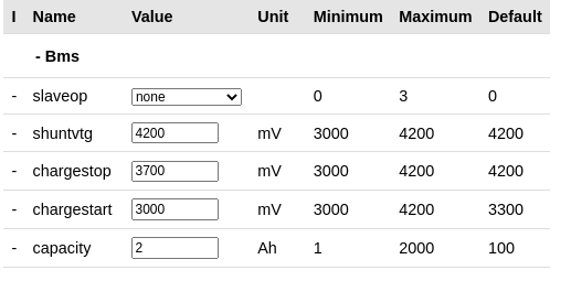

when i set shuntvtg to 3400 it light up 2 diodes , as far as i can see, for second and fourth cells

Here is my setup
when i connect batteries slaves blink 4-1 slow
when i connect power to the main board they stop blinking and after 1-3 sec first slave starts blinking 4-1 really fast
second module does not blink
in the interface it shows only first module
