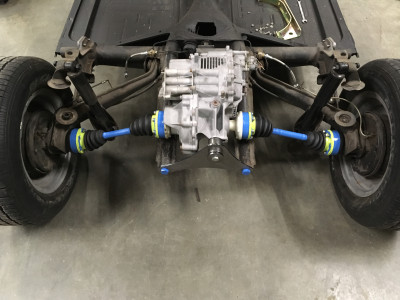

Hello again all! Finally have some time to revisit this. I have the motor spinning reasonably well but there is some jumping on startup only in forward direction. I decided to try to make my own power stage, so I have made a gate driver and voltage sense board the plugs directly into the version 3 ...

Wonder if I could get some assistance with a couple dimensions for the RS axle stub shaft? (The long one) I’m just finishing up my adapters but I didnt have a stock right side to measure. Primarily looking for the diameters of the steps after the spline. First one should be 27mm dia. Also need the ...

Pic for reference...
