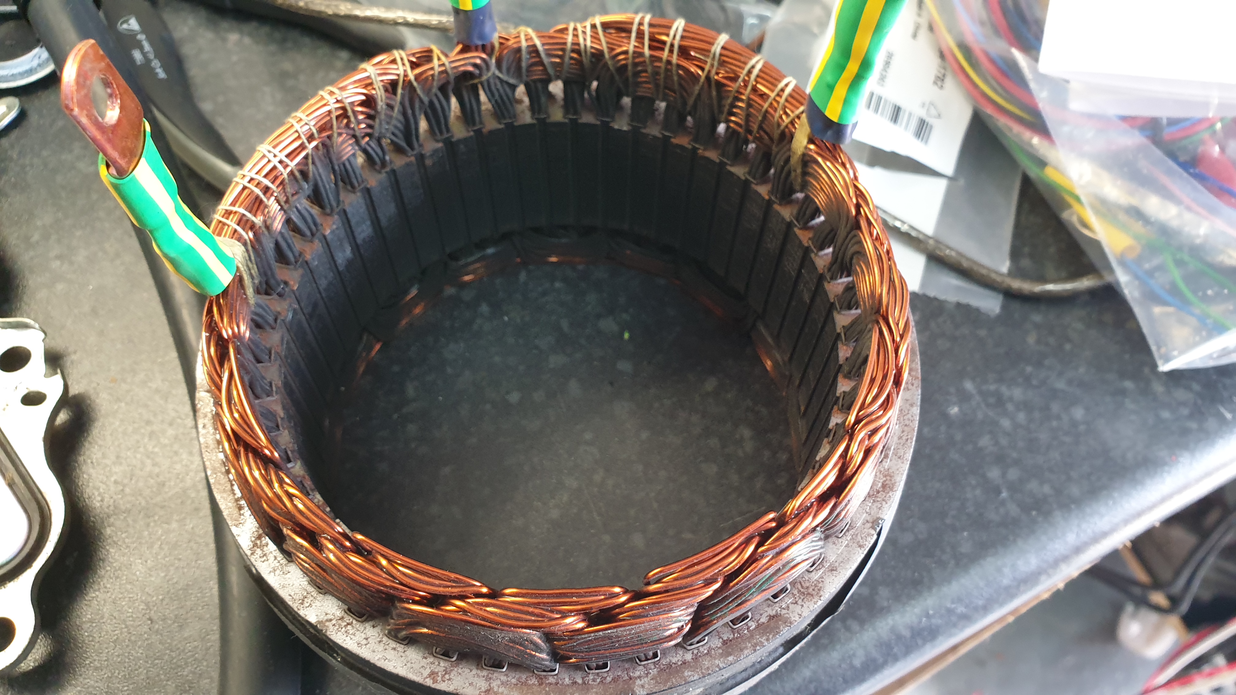

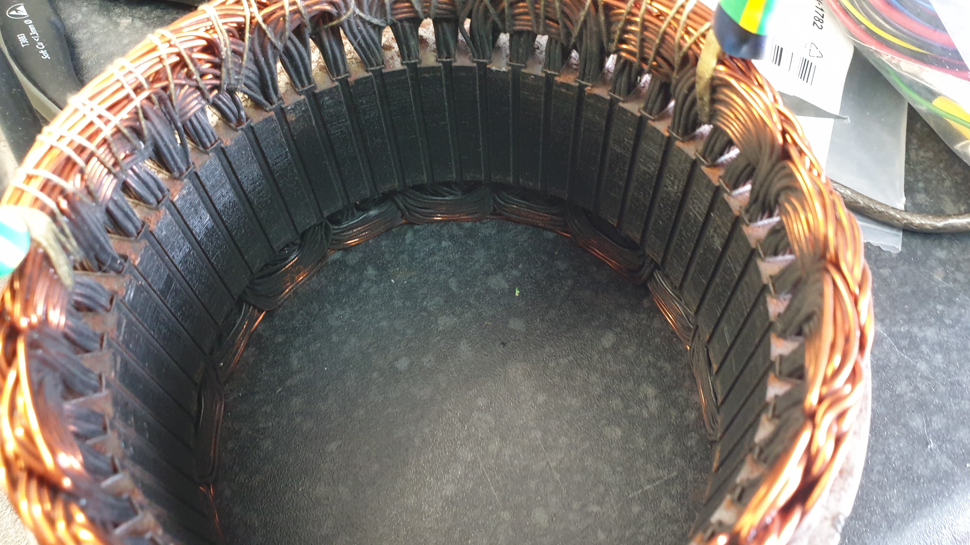

Playing a bit more with the alternator today.
Seems to be 6 phase, Wye connection. I'll separate the phases to give me 12 wires which I can play around with externally, but will probably end up connecting in delta. Funky asymmetrical fan too, weird. I guess this is something to do with balancing, but won't mess with it too much.
Something else to look out for if doing alternator conversions - this one, and many recent models I suspect, has an overrunning pulley. This of course either means no drive, or no regen! It looks like I could get a solid pulley for this one, but it may be more cost effective to get a complete alternator with solid pulley (perhaps from a referb company) for when I convert the bike. Or, just creatively break the clutch so it's fixed, but that may turn into one of those 'permanently temporary' bodges...

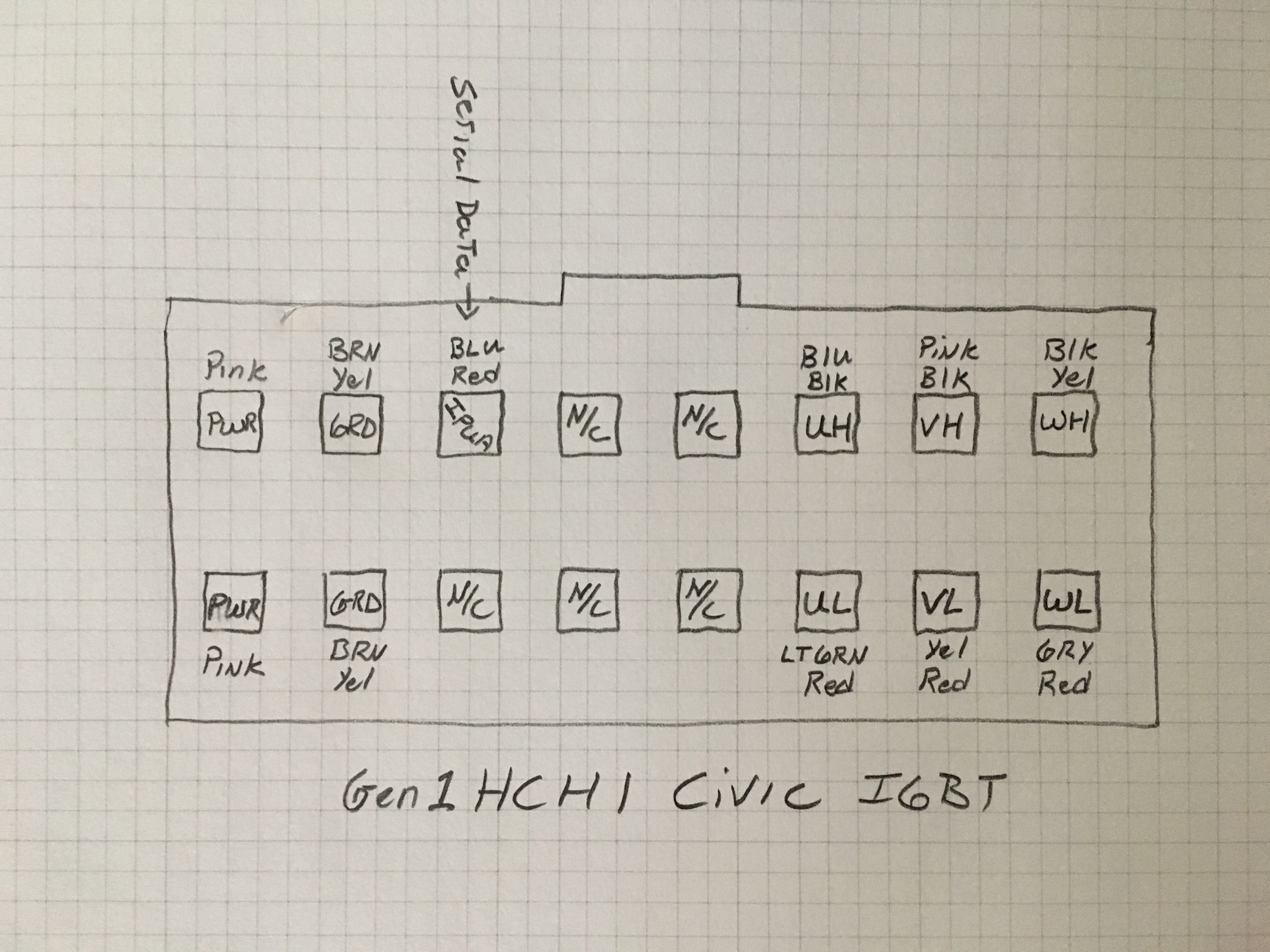

First things first, powered up the openinverter board, which of course works perfectly :)
Next, powering up the inverter. Two ground lines and two power, which are tied together inside the inverter. I suspected it required 12V, but couldn't confirm this on the schematic, so connected to an adjustable CV regulator, and slowly increased the voltage. At ~4.5V it woke up, and started making encouraging noises, but checking voltages on the switch mode 15V supply inside (for the IGBTs) showed they were low. Increasing the voltage changed the tone of the switch mode whine, and by 12V had gone ultrasonic and voltages were a healthy 15V in the right places.
Aside from the power connections, the inverter unit has 7 other wires on its plug. 6 of them are U, V, W high and low, but the 7th is a bit of a mystery. There's no real point having an 'enable' line when you can just stop pwming the UVW lines, so I assume it may be an 'error' output. The schematic labelled the U_high line as blue with a black stripe, and I found the matching wire. Connecting it to 3V had no effect (I was checking the IGBT pins for any changes, and hoping for a nice +15V somewhere), so I tried 5V, and then 12V. Nothing. I spent a good few hours trying to find out why it wasn't working, only to realise that Mr Honda had decided that it'd be a good idea to have two wires of the same colour in one harness... Gah! Now using the correct wire, inputting 3V resulted in a good +15V on one of the IGBT pins. Huzzah! This means the main board can drive this inverter directly without any other requirements.
Current sensors were easy (there's one on each phase, and also one on DC in) although I still need to calibrate them.
I was still curious about that 7th wire. The multimeter said ~2.5V, so I plugged in a logic analyser. It's a serial line! I still need to decode it, but I suspect it'll at least give HV voltage, hopefully temperature(s) too, and maybe error signals. If I can read those, and the DC current sensor, with a small 'duino or similar, I should be able to spit the data over CAN for the openinverter board to use. Or perhaps, as I'll now have a few inputs spare, I can play with the code and read directly - I intend to make a few changes at some point anyway to suit the motorcycle layout and hardware.

I've been looking at the serial output from the Honda inverter unit.
Using the logic analyser, I've narrowed it down to 10400 baud, 8 bytes, equal parity, 1 stop bit. There are 5 packets being sent out in a loop, each made up of a ID byte (either 0xE1, E6, F8, D2 or D5), four bytes of data and a checksum byte. The first data byte (after the ID) of each 'word' is the same, and changes with HV voltage.
HV voltage correlates pretty well with 2*byte1+10, so I can read this with a 'duino and send it out over CAN to the openinverter board. Apart from this, everything else seems fairly static, aside from small changes over time on the 0xD2 word - the 2nd, 3rd and 4th data bytes seem to increase slowly from powerup, and appear to correlate reasonably well with temperature. I need to check with a heat gun and thermometer (difficult to read the temp of an aluminium heatsink with an IR thermometer), but I might have heatsink and board temperatures (in half degrees Celius), plus the 4th byte which I can't work out yet. I assume there's gonna be error bits in there too, but without the rest of the Honda electronics etc I'm unlikely to be able to decode them. Never mind, voltage and temps are the most useful.
Also confirmed that the openinverter board can happily drive the Honda inverter/IGBTs, I get a nice output from the IGBTs (with ~1us of deadtime?). I tried spinning the motor but was unsuccessful. At one point I had the inverter trying to get it going, but there was no movement and just a quiet clunking from the motor. All attempts after that just had the inverter shut down within half a second reporting 'overcurrent' so I need to track down the cause of that. Problems could be down to any number of things - wrong field current, crappy psu, crappy 12V, insufficient deadtime(?), and of course the motor itself... I'll attempt with some bulbs next time.

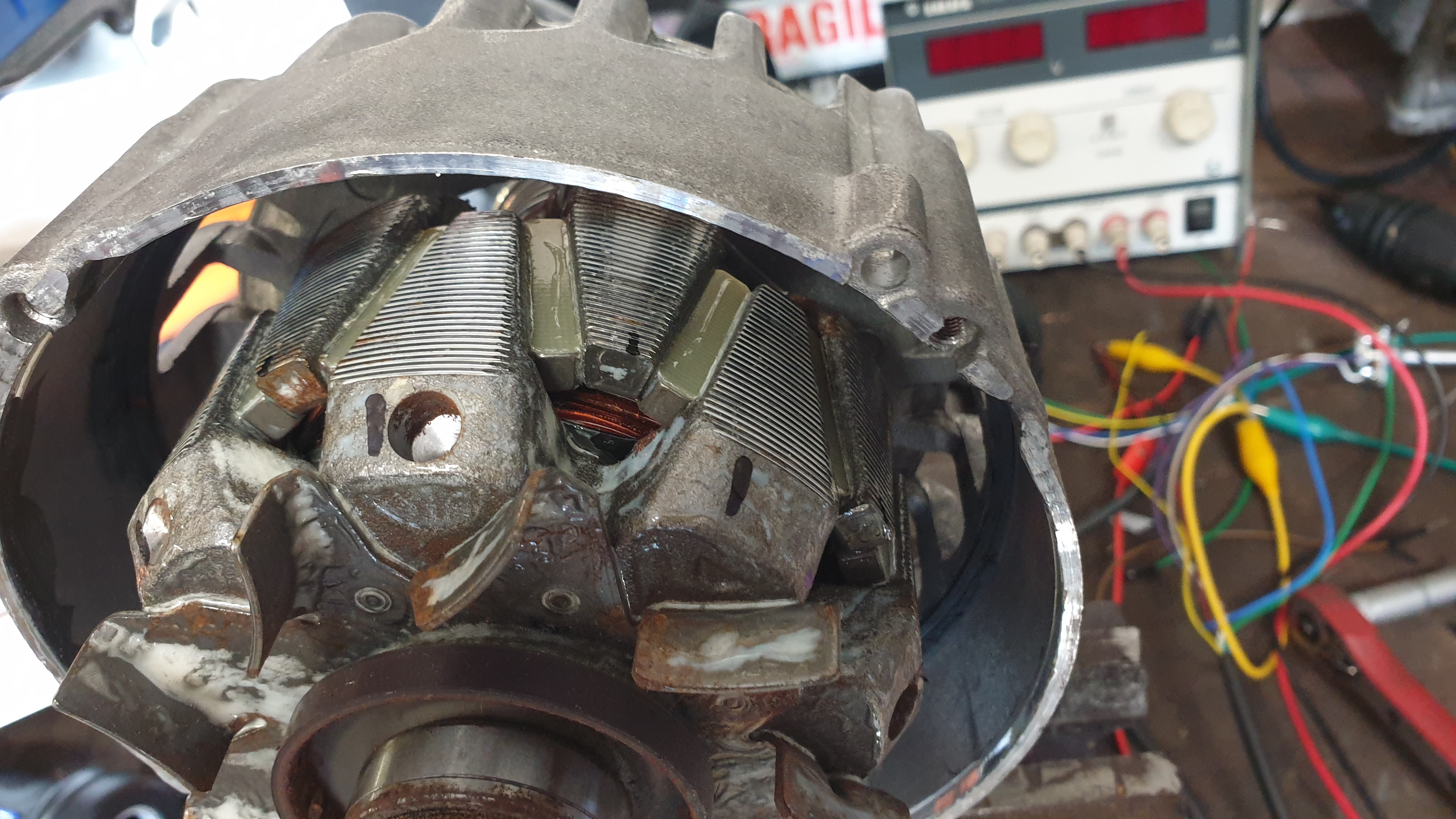

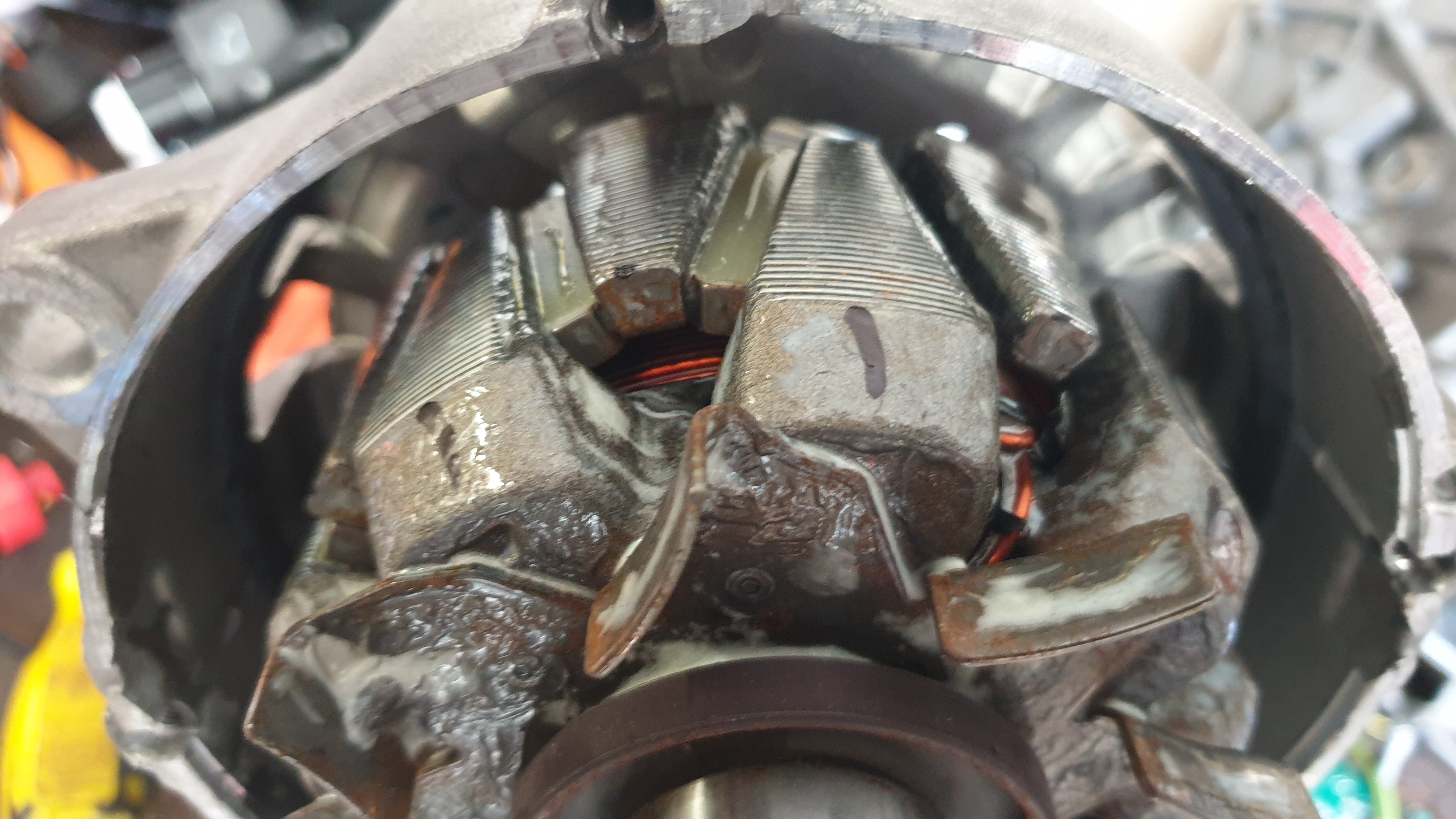

During the week, I got hold of another alternator - this one's a 100A Bosch unit from a Corsa (many Vauxhall/Opel cars seem to take similar alternators) with a solid pulley (no one-way clutch), and three phases on the stator windings - these are accessible from the rear of the alternator just by removing the diode pack as 6 connections, so it'd be possible to connect in delta or wye. The regulator can be butchered slightly to get to the brush connections.
I wrote some basic software for an Arduino to read the serial line from the inverter and send udc and temperatures over CAN to the mainboard. I'll need to get it reading the dc bus current sensor too at some point (the mainboard firmware calculates idc, but I think it'd be nicer to measure it directly). Getting the mainboard to read udc from CAN needed some small edits to the firmware, as will idc and temperatures. But udc at least is now working nicely.
I connected the HV bus to a 12V car battery (through a 100A fuse), and connected the alternator to U,V,W in delta, and a CC power supply to the brushes set at 0.5A. Started the inverter in 'manual mode' at 10Hz, and it spins! I also discovered that it'll spin (and start up) with the brushes disconnected, although noticeably less torque as expected. This could be helpful when getting into field weakening speeds - with no field current, tripping a contactor may not be catastrophic... On the other hand, this may this be indicating that the rotor has been magnetised, I can check by spinning the rotor by hand and checking voltage across the phases.
Next steps are to get a magnet fixed to the shaft and the sin/cos encoder wired up and mounted, and get the FOC firmware running. Also need to get some switches and potentiometers set up as bench test controls, and then I can start working out kV and kI for the motor/alternator at various field currents, which will let me work out what sort of gearing and pack voltage I'll need. And start replacing the cheap crocodile clips and thin melty cables with something a bit thicker... :)

Power cables now replaced by some (still temporary/test) 6mm² cabling - should be ok for bench testing at this stage. At least they have decent crimped ring terminals instead of cheap crocodile clips...
The magnet went onto the shaft far too easily. I cut a small hole from the top of the brush/shaft guard to access the shaft and provide clearance for the magnet. The shaft, however, had a 6.2mm hole ~3mm deep already formed into the end! This fitted a 6mm diametrically magnetised magnet perfectly, with a little gap for epoxy. I soldered up an MLX91204 sin/cos chip to a soic8 breakout board with the required capacitors, and this sat nicely over the cut hole and has been (temporarily) secured with hot glue...
Unfortunately, the MLX91204 requires a 5V VCC, and won't operate at 3.3V, meaning the 'zero point' is 2.5V instead of 1.65V required by the mainboard. A resistor divider should have corrected this, unfortunately tolerances were far enough off that my 'zero point' was ~1.45V and the angle reading wasn't great. A quick mod to the code to adjust the ADC offset though, and the encoder is now working nicely.
