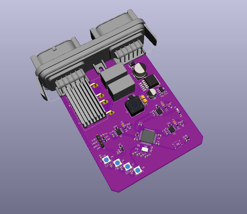

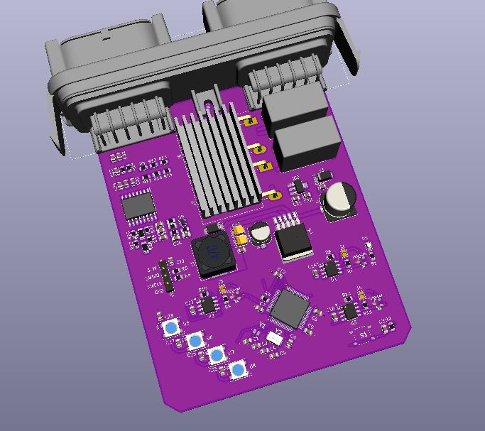

Update for anyone following along. Been spending some time getting the dual Volt BMS portion implemented and I think I've got that all squared away. Need to do some more charge/discharge cycles to verify the balancing is working correctly.
I also need to do Rev2 of the board. I undersized the 5v LDO and the output current is OK at 12v, but nose dives when input voltage goes up to 14.5 with the dcdc on. That sends it into this spiraling doom of thermal protection.
Another thing Im going to try doing is getting rid of the HV board connection and getting that input off an ISA shunt over CAN. Ill then take that signal and PWM off the 5v voltage bus to output the correct voltage scaling to the LIM. This limits the amount of HV wiring and should give the LIM everything it needs.
I also upgraded to two to-247 package 15ohm resistors for the LIM contactor circuit. The smaller smt were warm but OK with the heat sink, the larger package and direct application of a heat sink should be a more robust solution.
Will upload the revised design and what I have for dual Volt BMS code. I started porting Damiens VCU LIM code over to ST HAL compatible C. Its not yet functional as I need to deal with the fixed point stuff and port the CAN RX handling..but it does compile which is a first step.
New layout. Open to feedback if my PWM voltage to the LIM is a stupid idea as well.

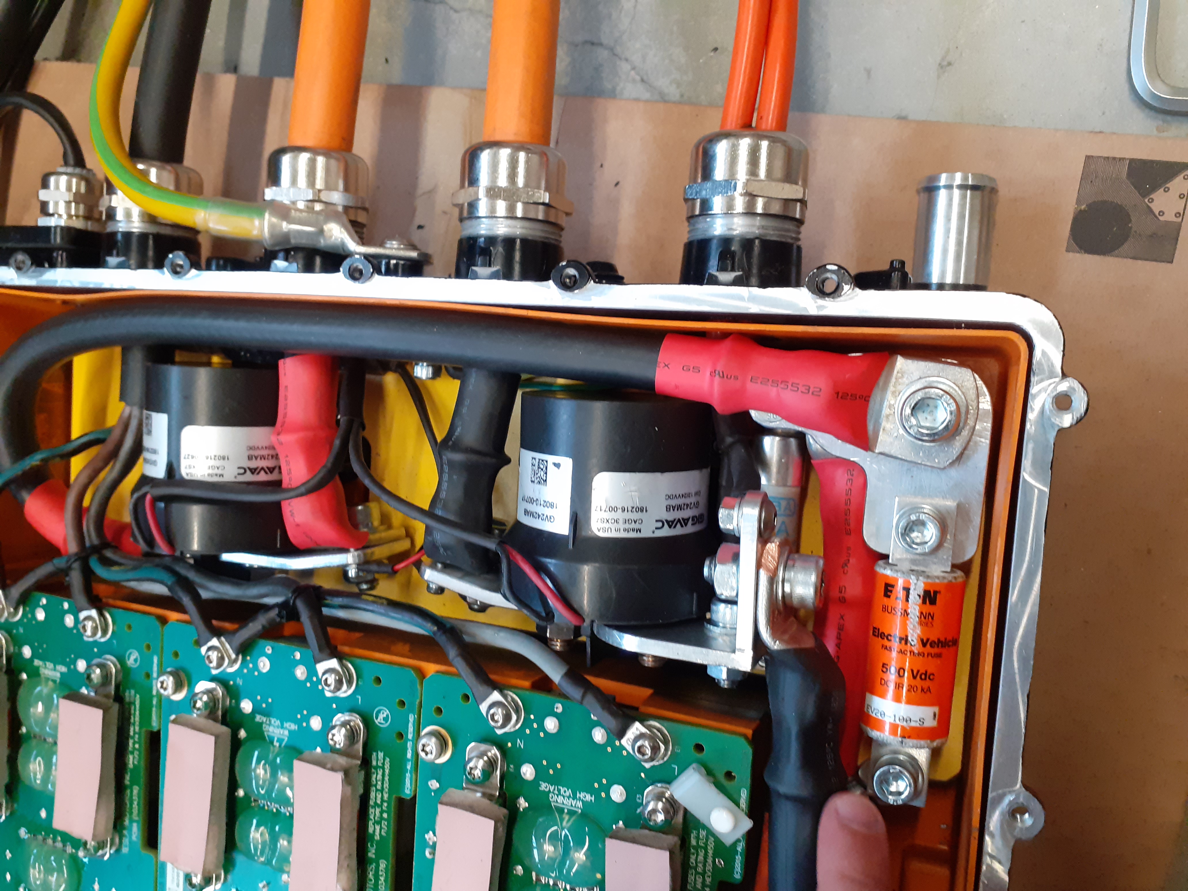

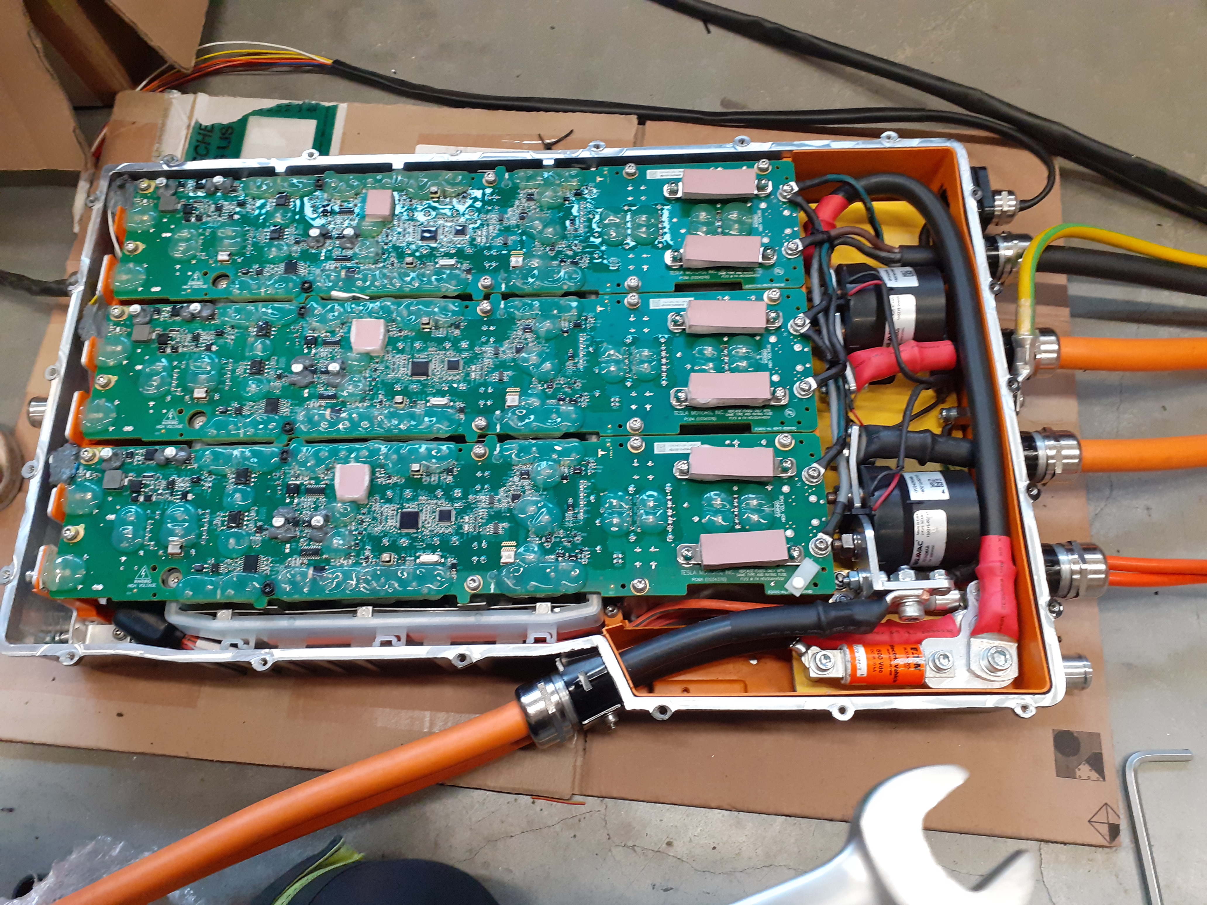

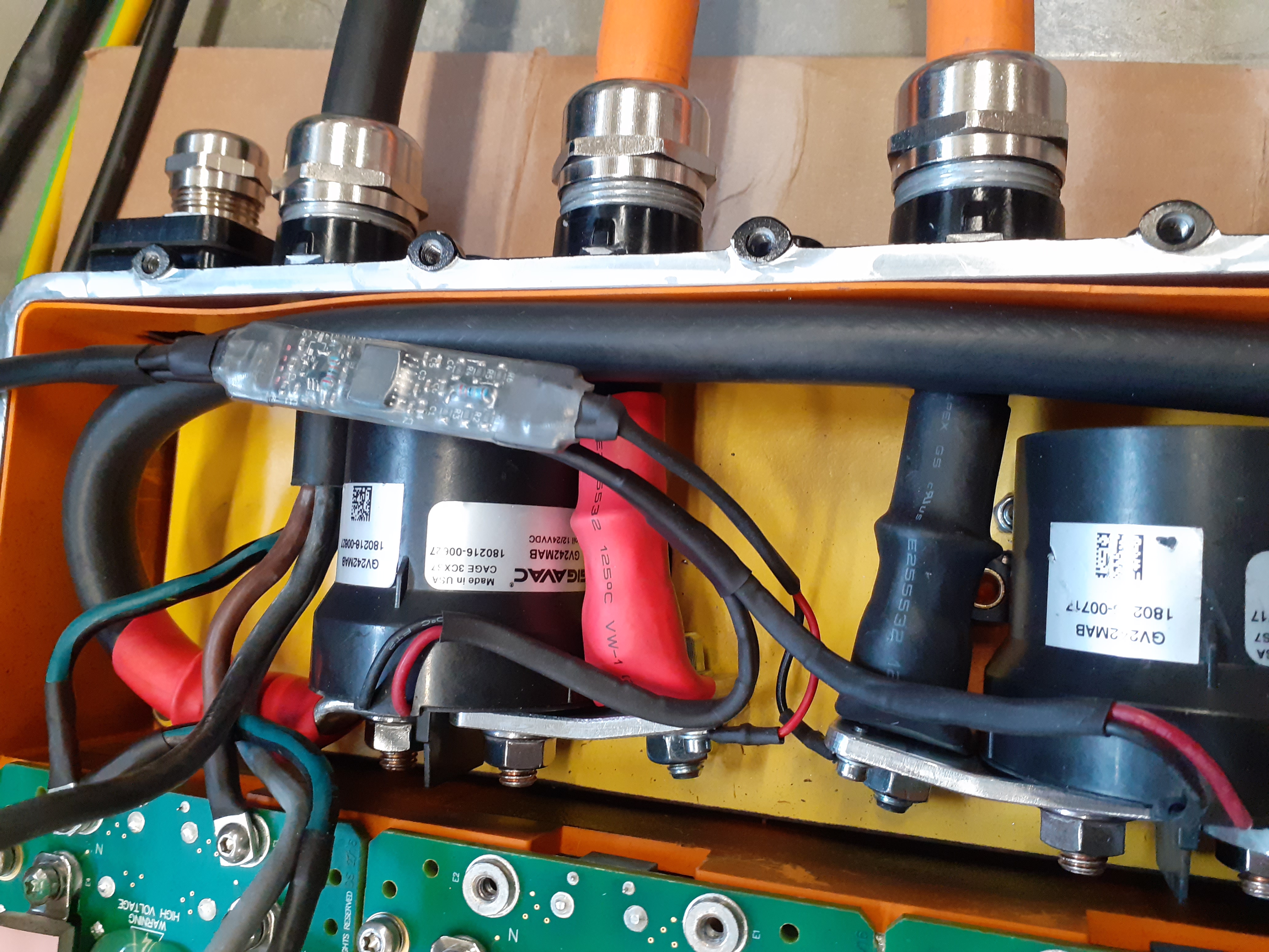

You then need an extra ISA shunt, which must also be connected to the HV line. So it needs as much HV cabling as my solution. I put everything in the charger, so I don't need any external HV lines.
The two thick cables on the right go to the charge port, the two on the lower edge to the battery. The two little orange ones supply DC/DC, A/C compressor, battery and cabin heater.
