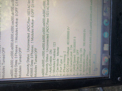

Hi, hoping I can get some help with setting up my V5 board. Somehow I must have fat fingered and hit 8 and now to can settings are not matching what I'm seeing others post. Typing 8500 doesn't seem to restore them. Also trying to change the current by typing 75 doesn't work.
Settings Menu
1 - Auto Enable : ON
2 - Modules Enabled : 123
3 - Can Mode : Master
4 - Port Type : 1
5 - Phase Wiring : 1
6 - DC Charge Voltage : 400.000000 0V
7 - AC Current Limit : 13A
8 - CAN0 Speed : 500.000031 0
a - Can Debug : OFF
b - EVSE Debug : ON
t - termination voltage : 0.000000 0V
q - To Quit Menu

Always a good idea to photo them before changing. Check your termination V too.
4 - Port Type : 1
a - Can Debug : OFF
b - EVSE Debug : ON
t - termination voltage : 400.000000 0V
q - To Quit Menu

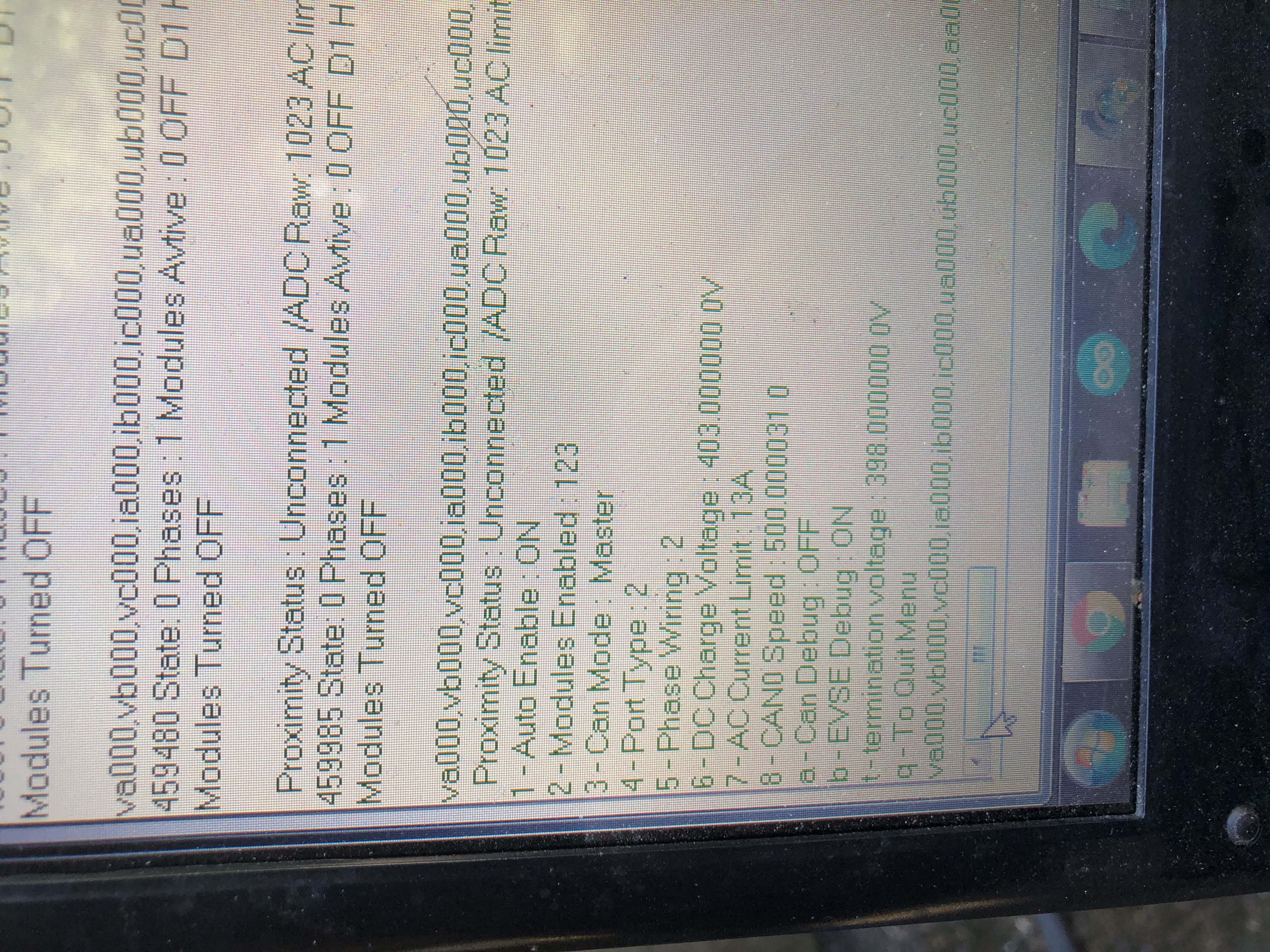

So termination voltage and CAN0 match. When I type 41 it changes 1 Auto Enable to off. I'm sure I'm dense and there is some kind of semantics I'm missing when typing this in even though I've gone through the manual several times.

Typing 75 into notepad copying and right clicking in the putty terminal is working. I type q to exit and save. Unplugging the usb cable to power off and plugging it back in and reconnecting over serial, 13A for AC current greets me again! Step by step...
4 - Port Type : 1
7 - AC Current Limit : 5A
a - Can Debug : OFF
b - EVSE Debug : ON
q - To Quit Menu

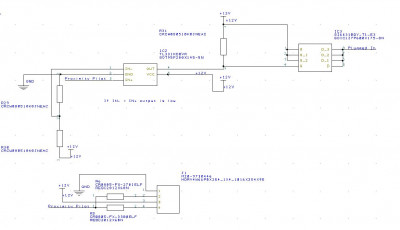

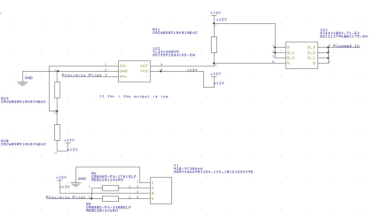

The workaround I used for this was to use a switch that closes when the charge door (petrol flap) is open, that supplies 12V to the charger.Roadstercycle wrote: ↑Tue Sep 08, 2020 3:41 pmSo now we are at full loop again. Is it Ok to turn the 12 volt power on at the same time as the 220 volt EVSE is plugged in so you don't get battery drain. There may not be an answer without testing?
Someone posted a clever circuit way back in this thread that detects the PP line and fires the charger up first, if you prefer something a bit fancier.

If someone wants to design a circuit for powering up via the proximity signal and post here I'll be happy to include it in the next rev build.

This is the way I done it for the SimpCharge, use some pull up and pull down resistors to create the Proximity window.
then a simple comparator to set the point at which to activate. and a Pmos of your choice to switch 12V.
You know you could just buy a SimpCharge and just hook up the Proximity line
to create your 12V when a plug is inserted.
