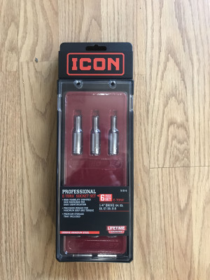

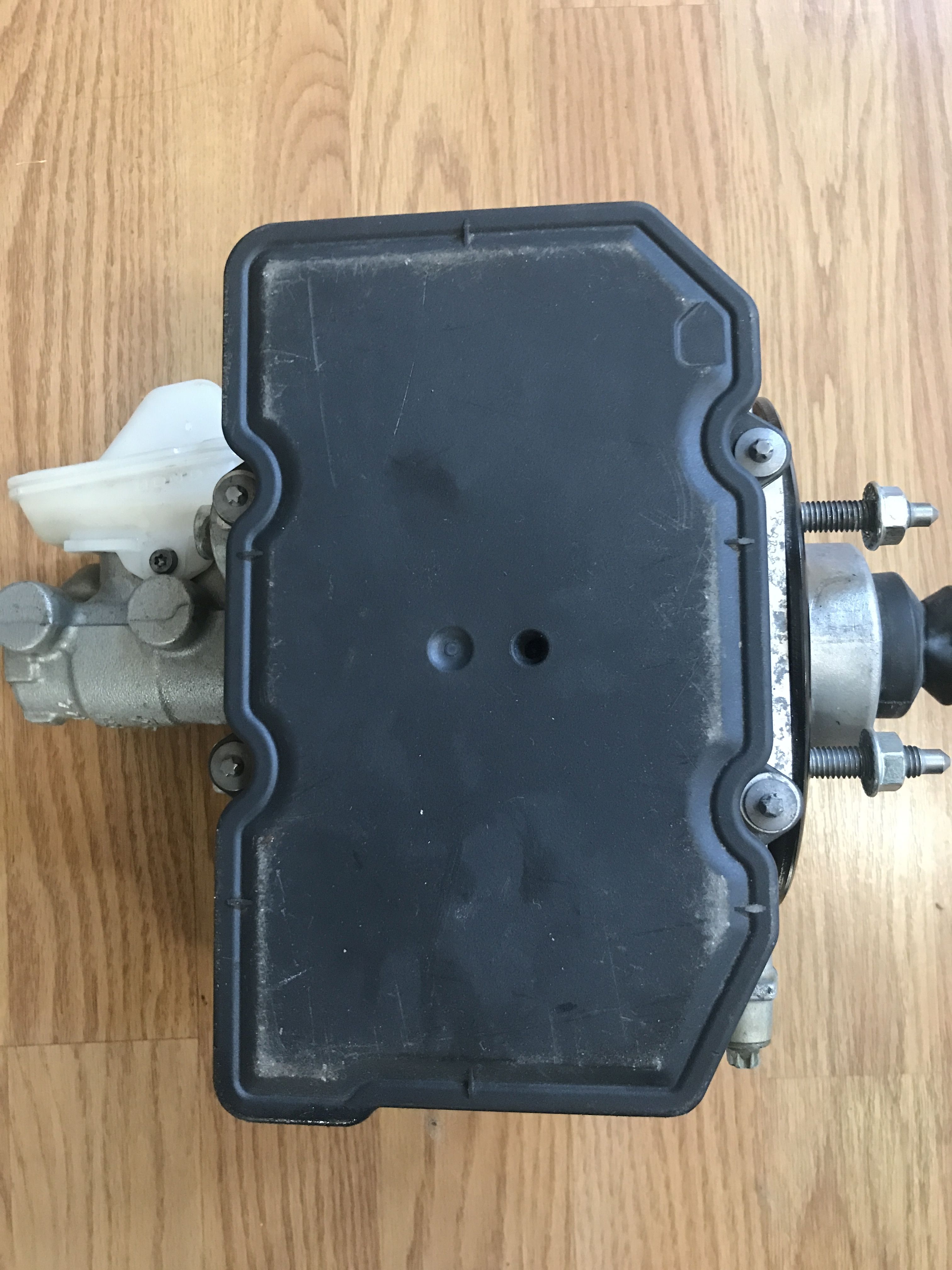

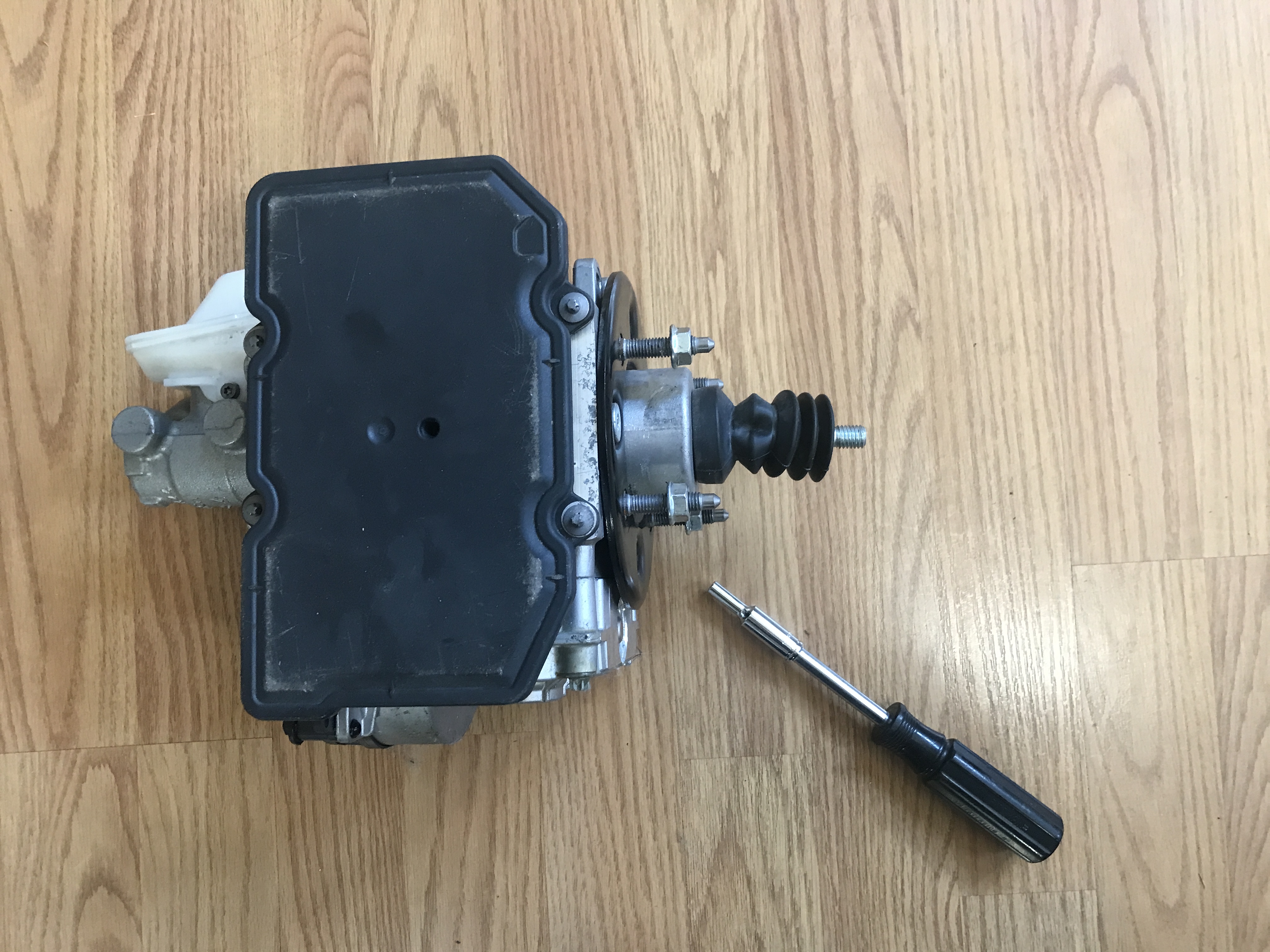

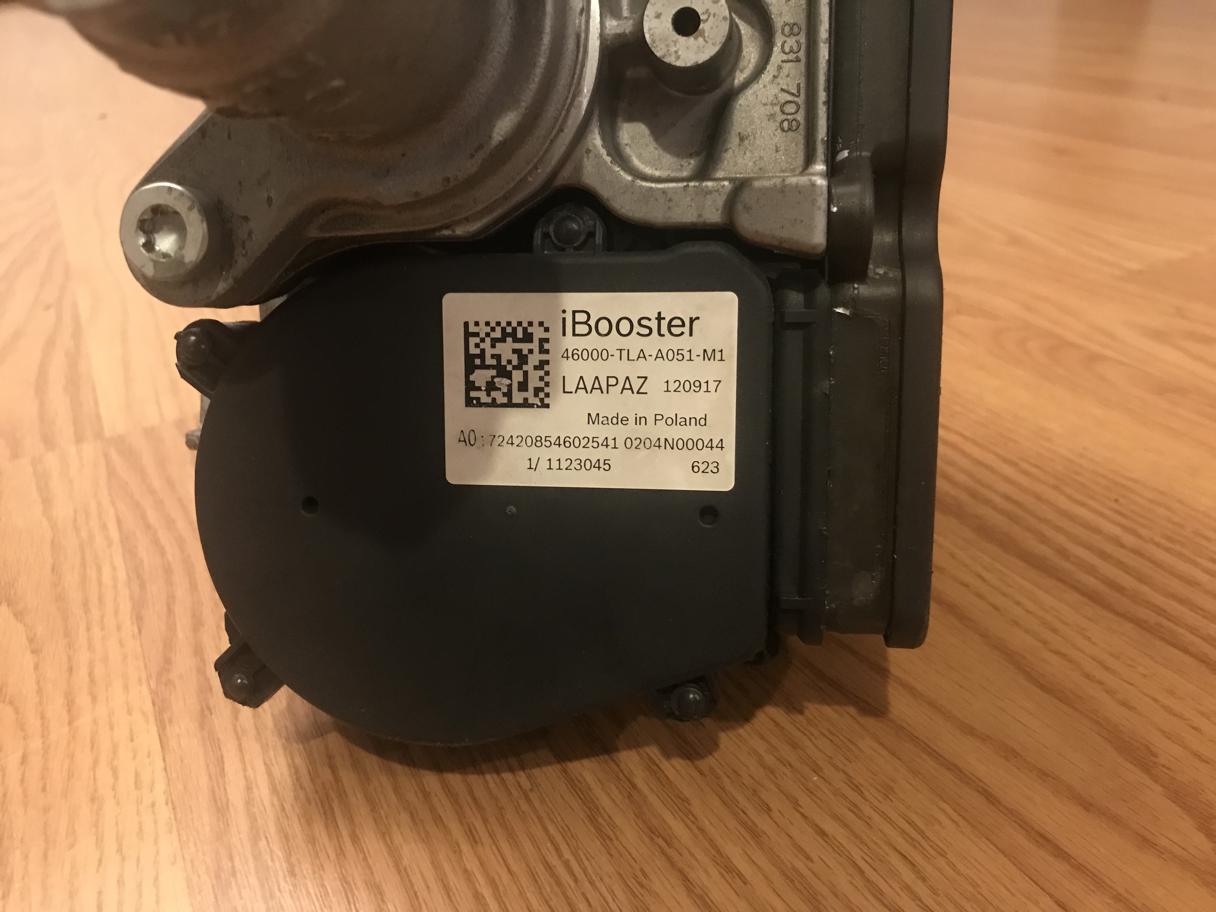

I love buying single purpose specialty tools, so I went out and bought some more, cause owning hex and torx bits aint enough, now we need torx sockets

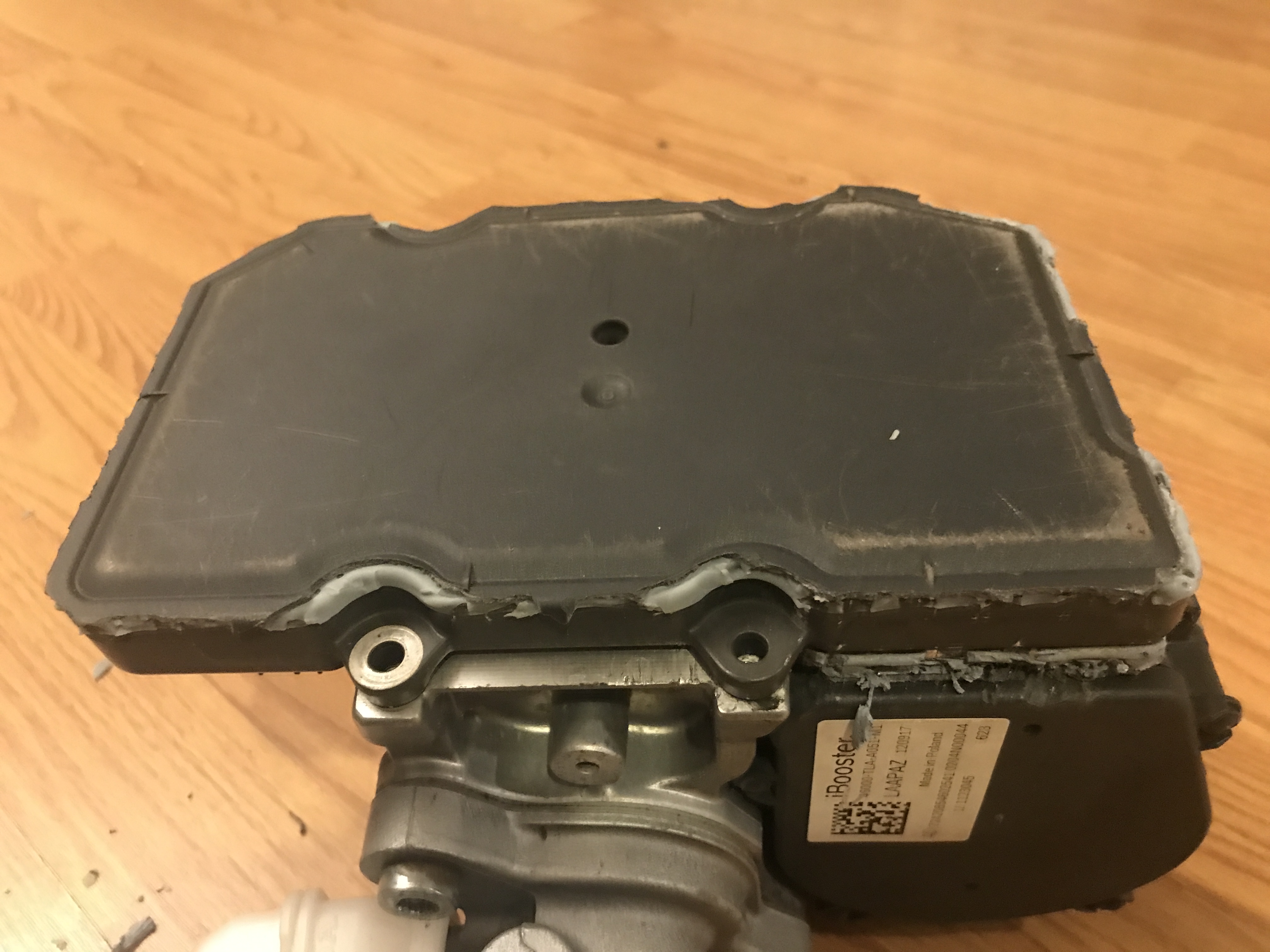

well and then even undoin' the four bolts that hold the platypus black plastic box section down, I still could not remove it
Why am I doing all this? cause judging by the condition I found the piston in the mastery cylinder in I recon this iBooster may have come from a flooded vehicle, salvaged by the insurance company, sold at an auction, and then parted out on eBay

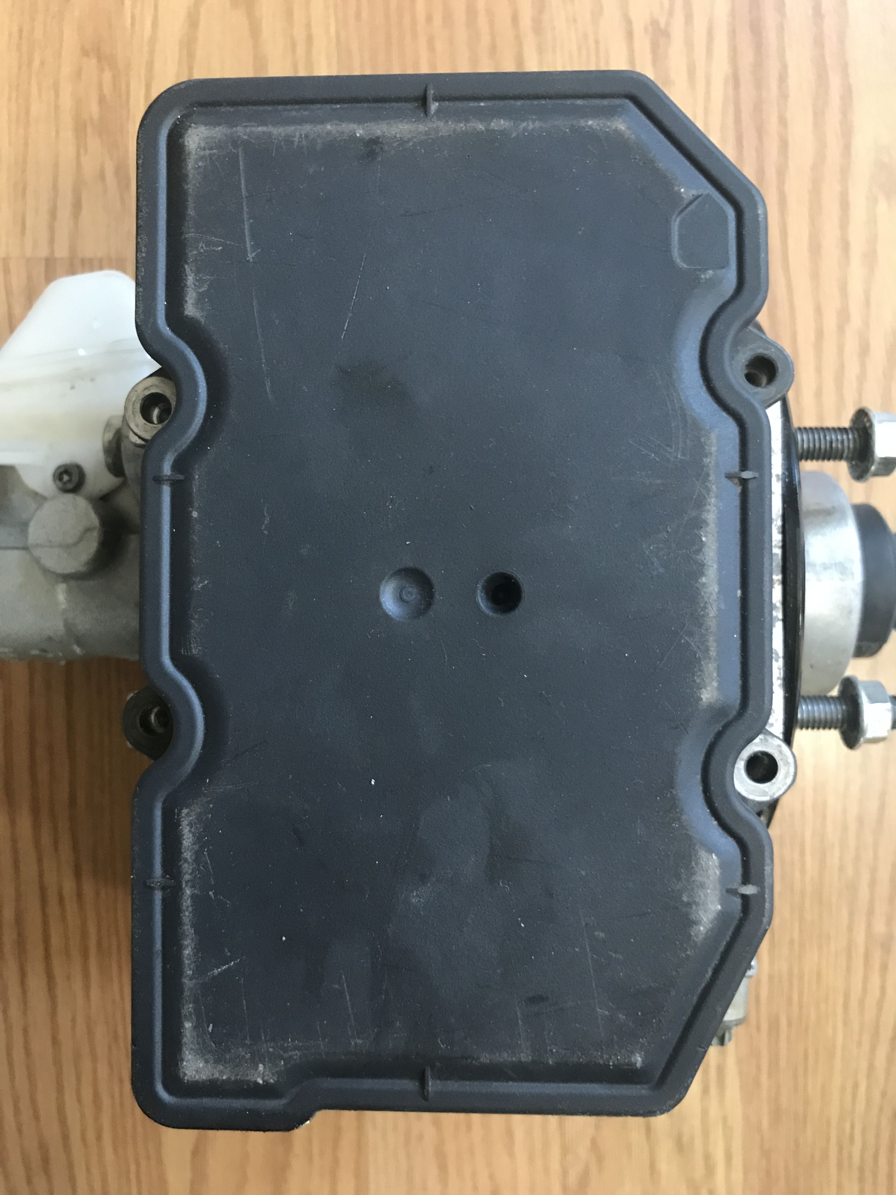

Re: I bought a Honda CR-V iBooster Gen 1 - Now what?

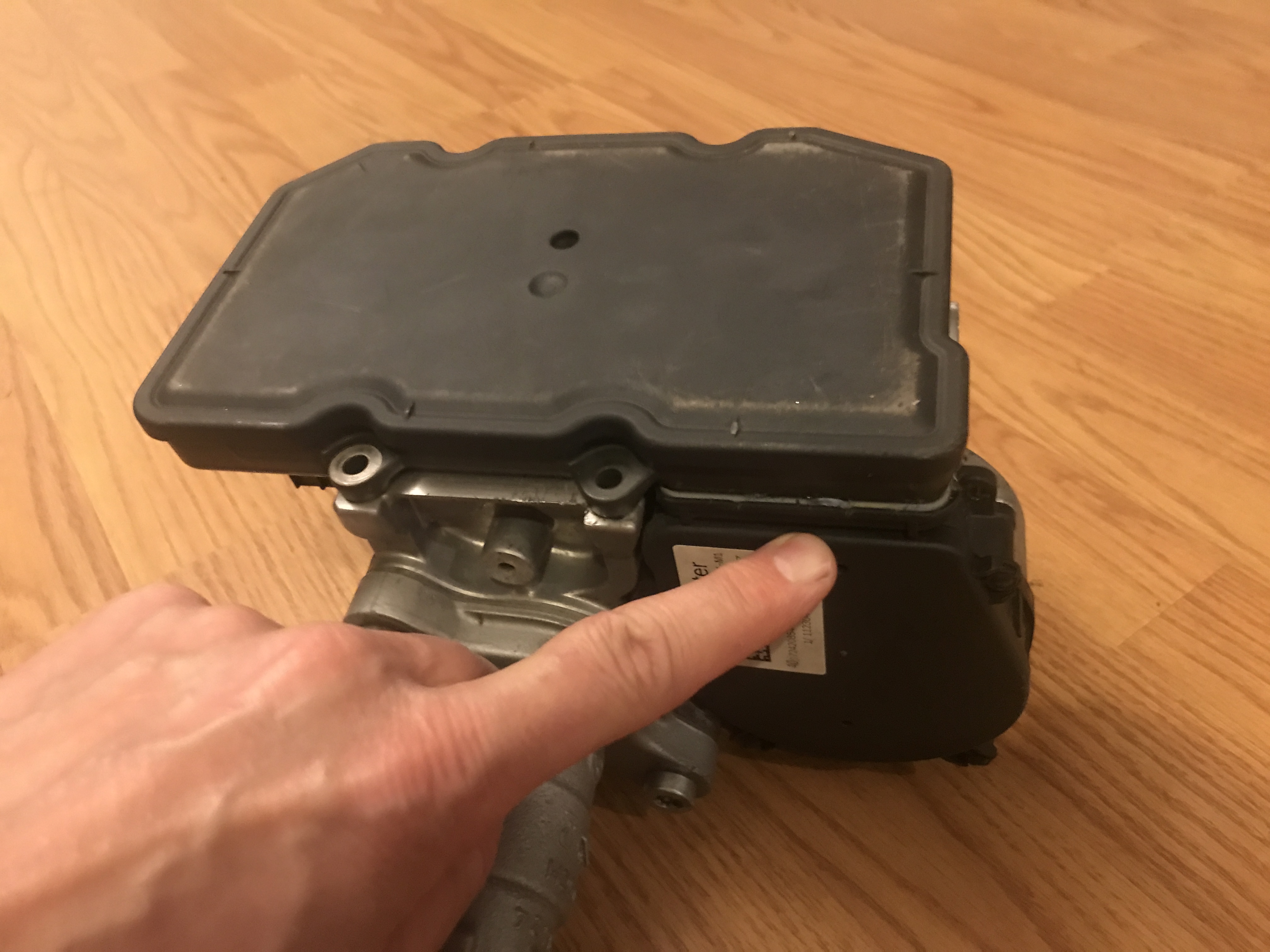

here I point out where the two black plastic pieces come together in holy matrimony
below, note how the four screws come in from the other side [pronounced: "impossible to git to"]

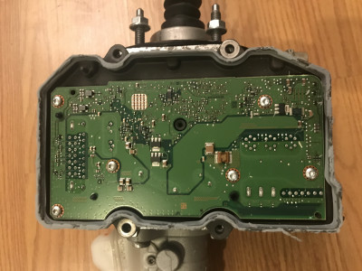

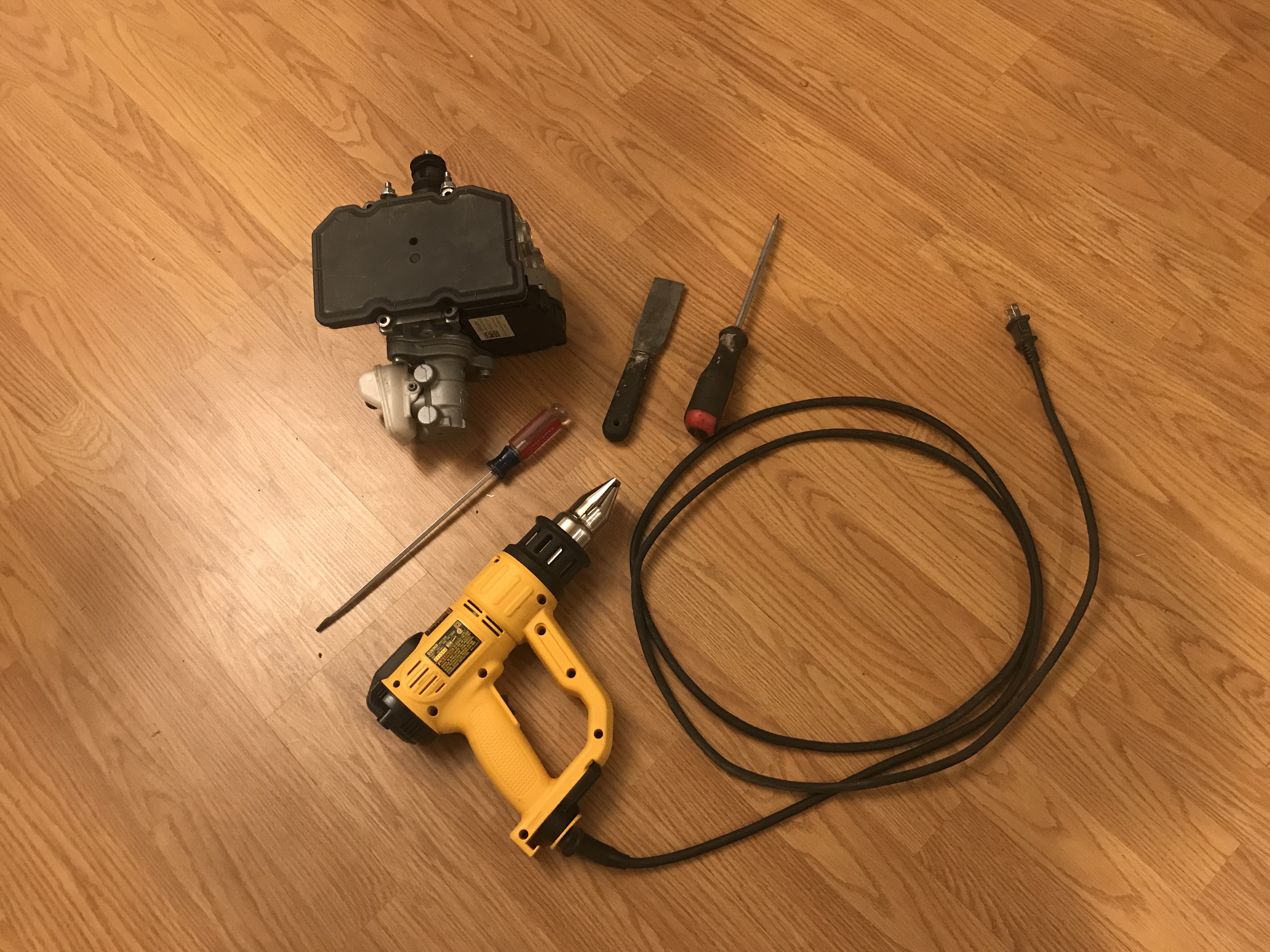

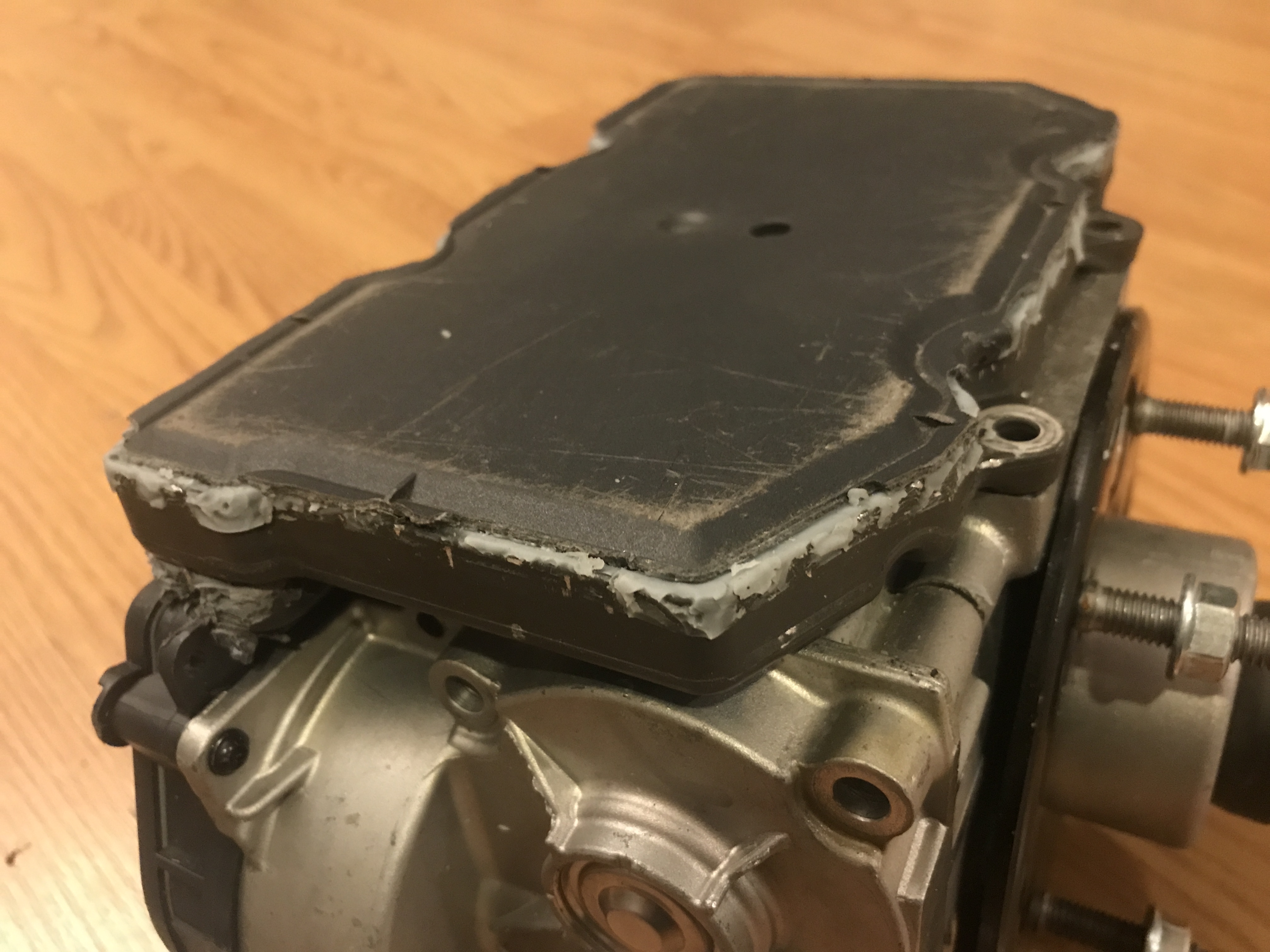

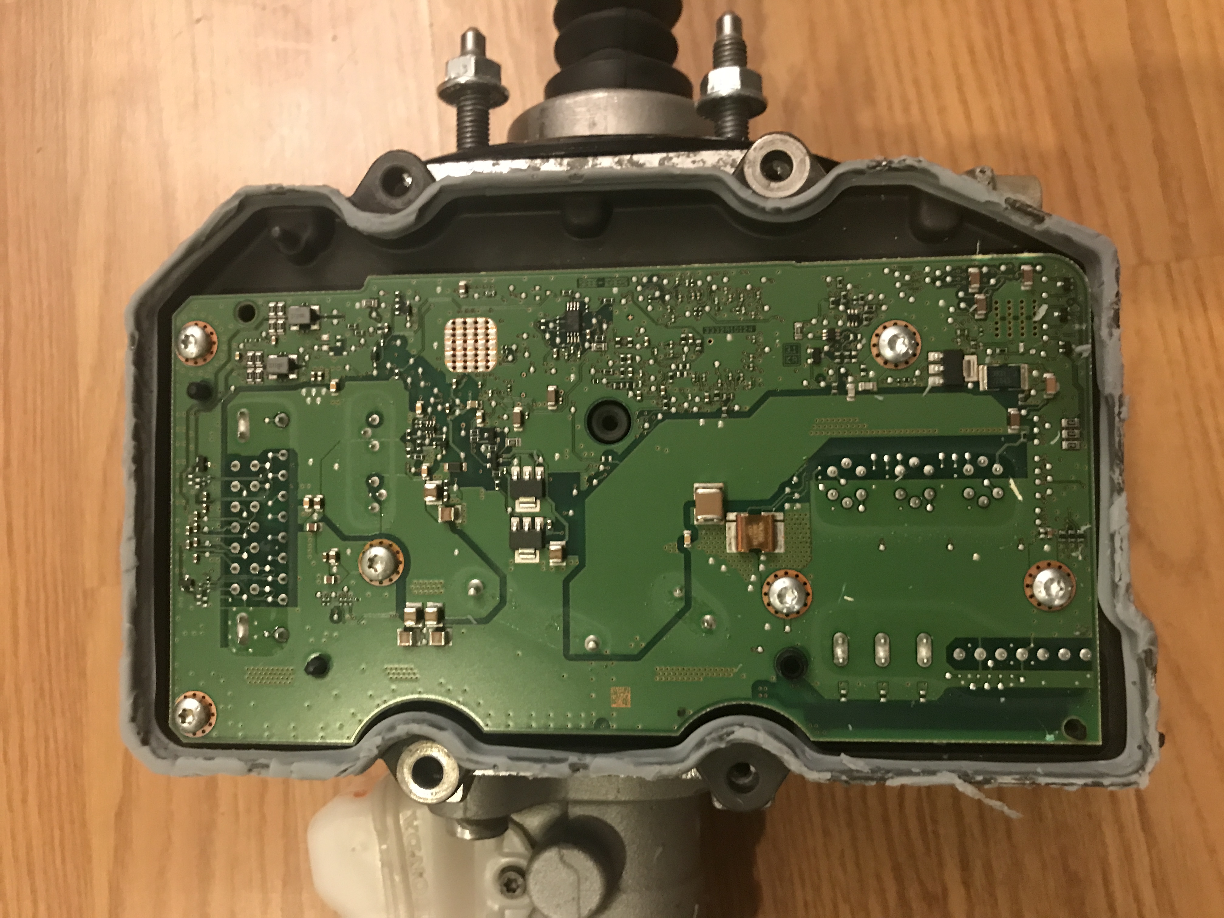

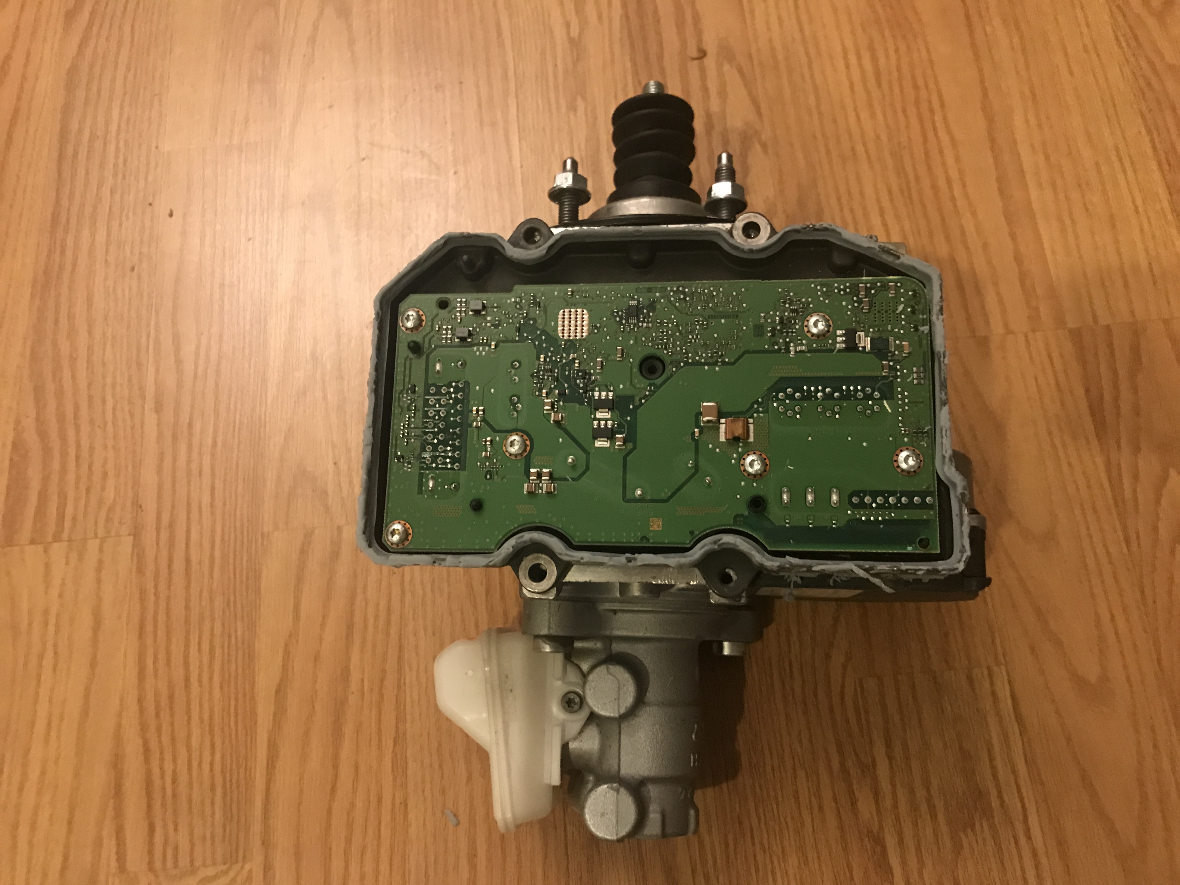

this next section aint for the faint of heart

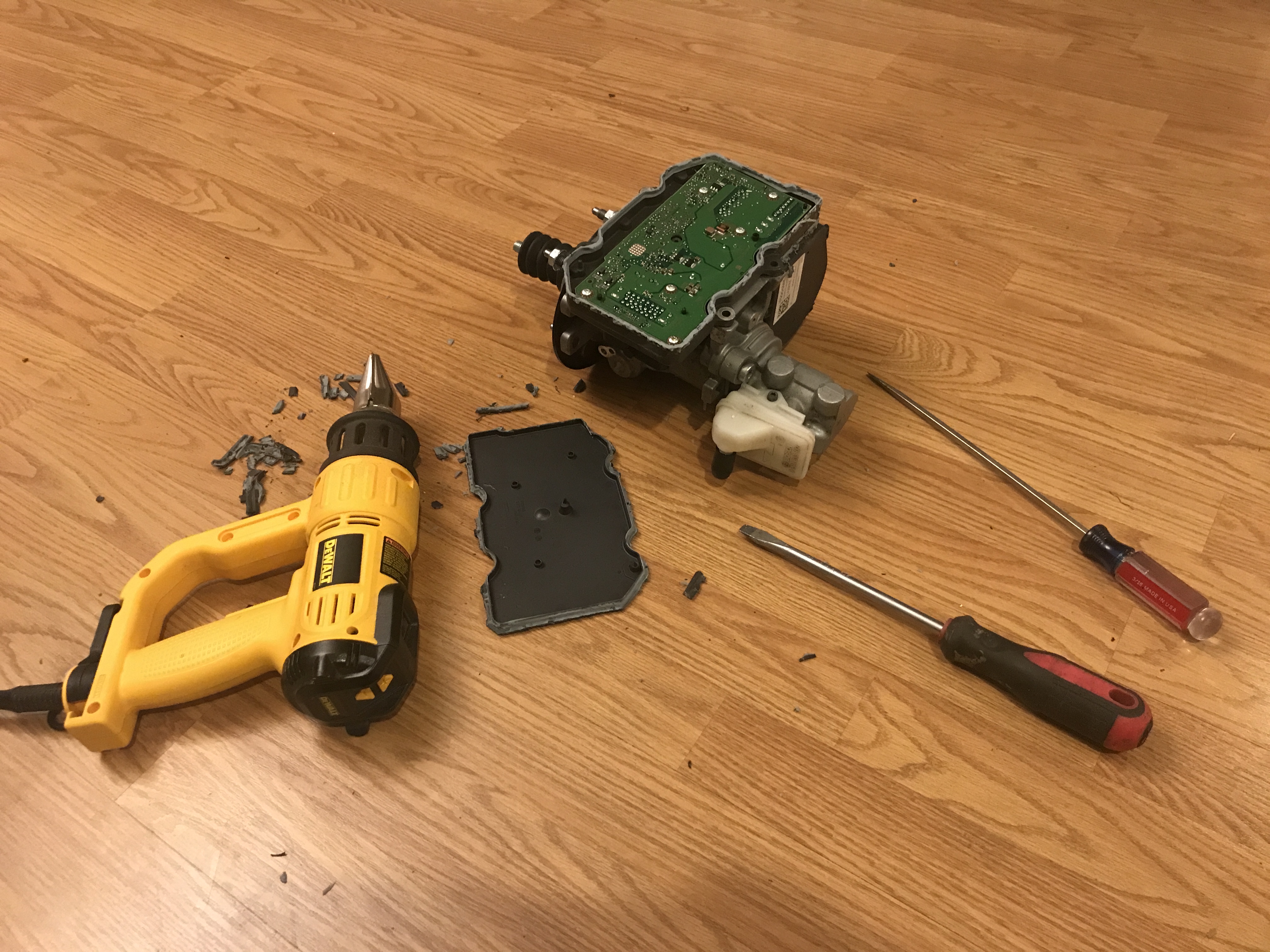

I bought a heat gun and I aint afraid to use it!
having gently peeled the lip off this lid I was beginning to think that when the Germans said this aint no serviceable part, they may have meant it
- Gregski
- Posts: 2873
- Has thanked: 530 times
- Been thanked: 1190 times

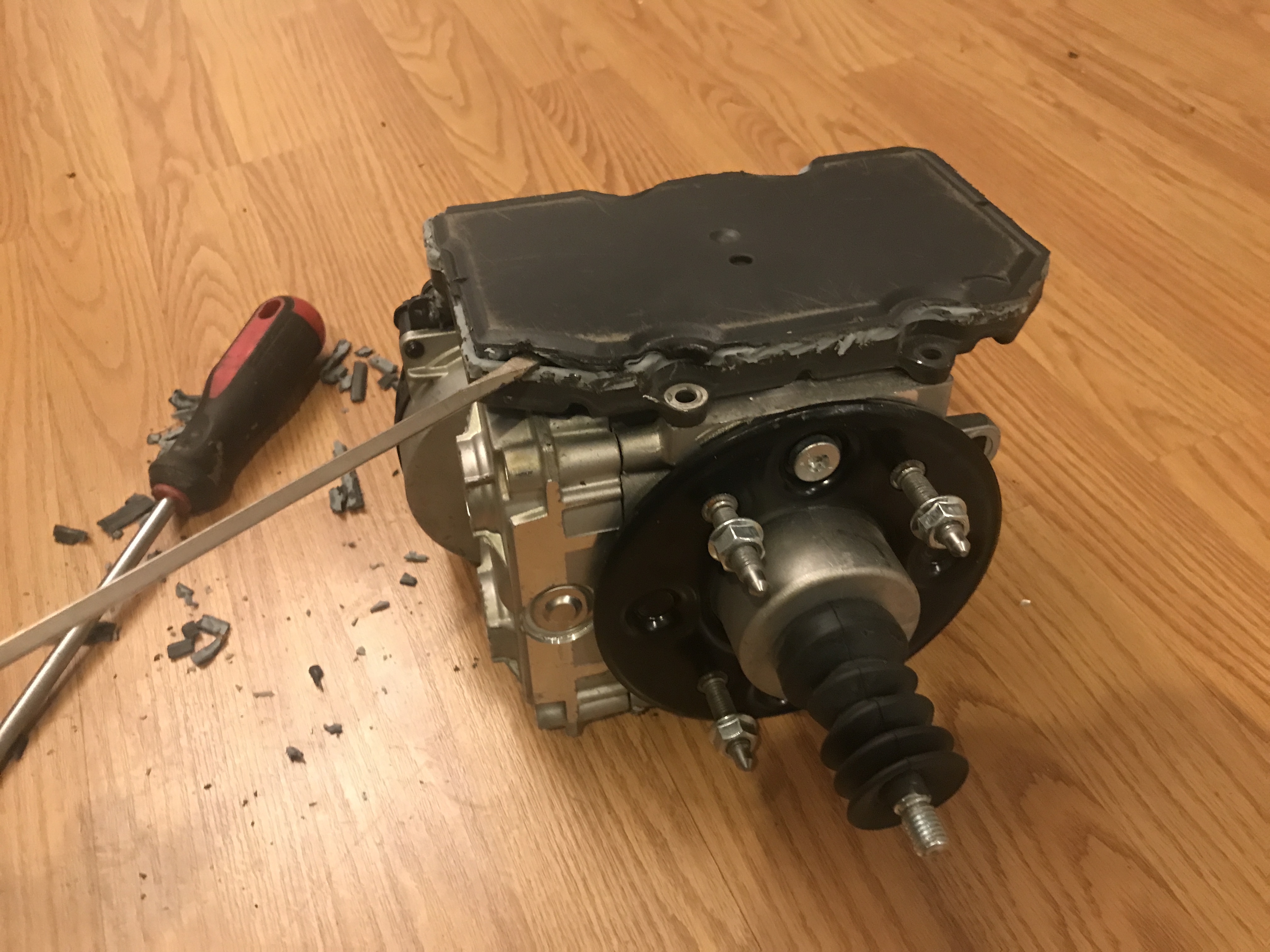

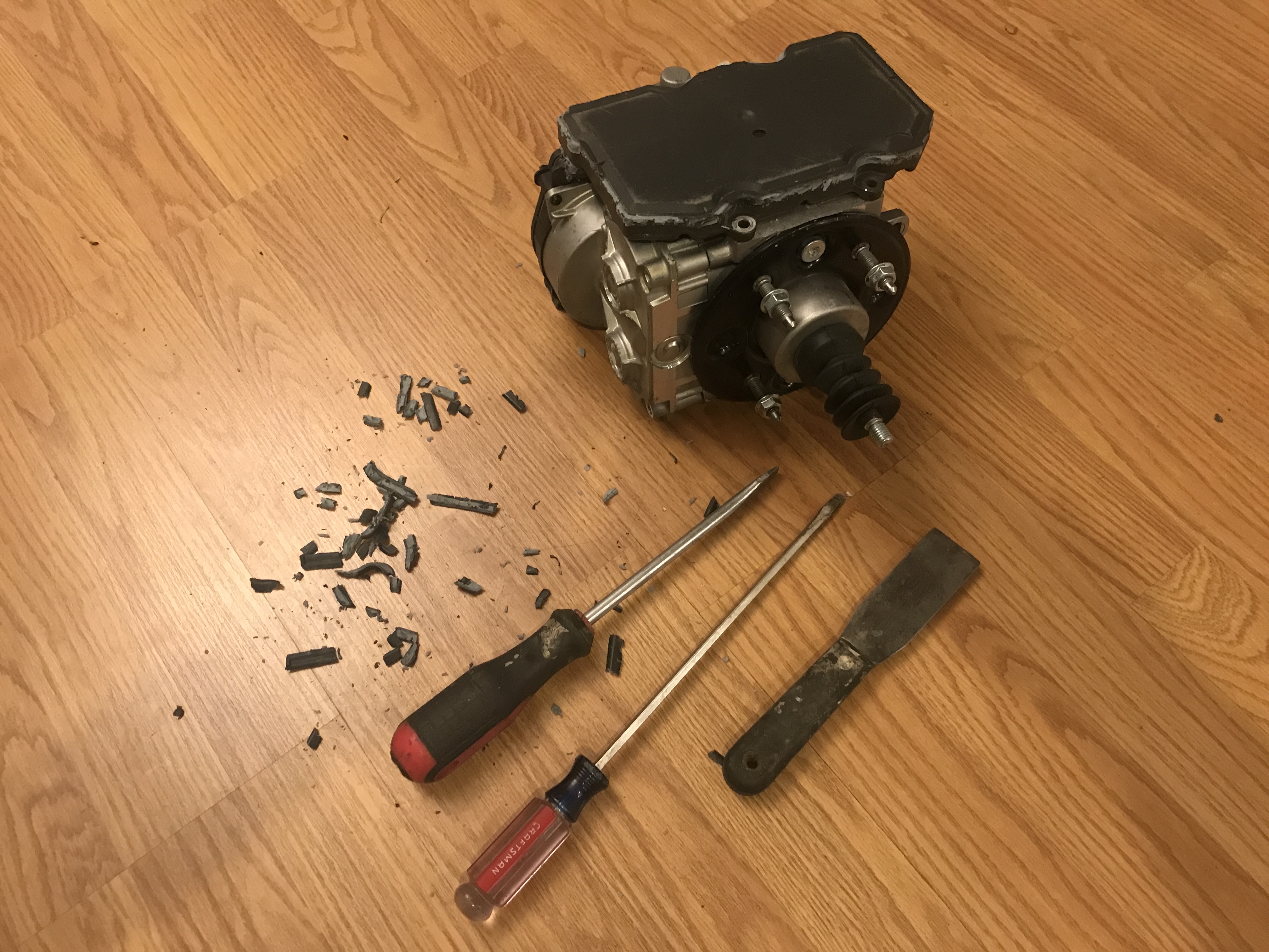

then I used the Damien Technique to persuade the (remainder of) the lid off
- Posts: 1040
- Has thanked: 427 times
- Been thanked: 267 times
Hmm, very persuasive.
Did it concede that your argument was superior?

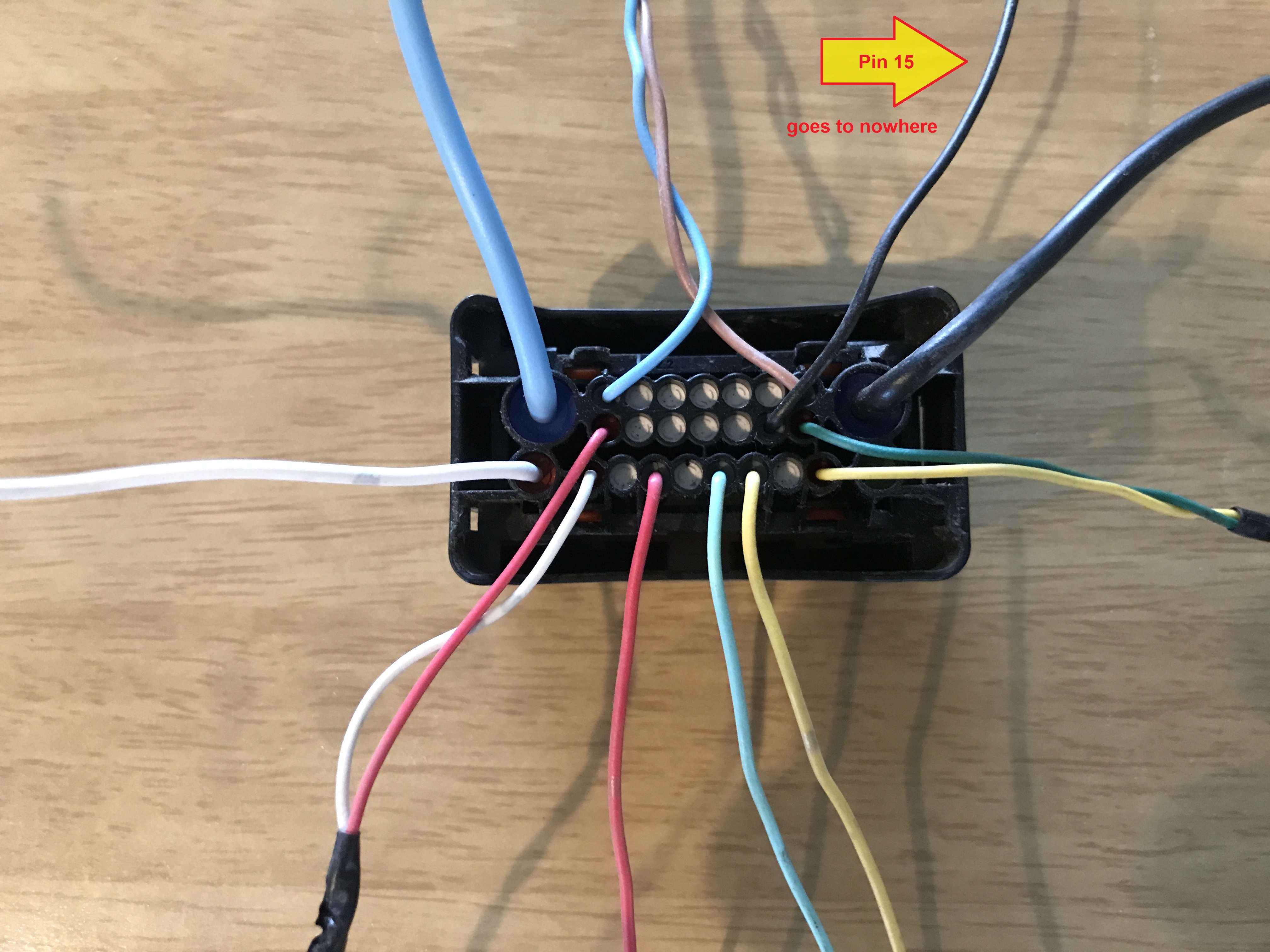

Nice work! I'm doing this same conversion but on a Miata NB (MX5 in UK). I was wondering, in your pics of the main connector wiring, there was a thin black wire on pin 15 - any idea where that went? Is it another ground connection? I don't see it listed in any of the pinout diagrams I've seen...
Chris
Chris
- Gregski
- Posts: 2873
Hi Chris, I sent you a PM, as far as that black wire on Pin #15 it goes to nowhereitiuk wrote: ↑Tue Jan 16, 2024 12:44 pm Nice work! I'm doing this same conversion but on a Miata NB (MX5 in UK). I was wondering, in your pics of the main connector wiring, there was a thin black wire on pin 15 - any idea where that went? Is it another ground connection? I don't see it listed in any of the pinout diagrams I've seen...

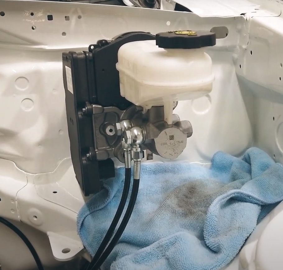

OEMs use them to and sometimes from the abs.
They are ok even if they flex. They're used in racing at each wheel but should be replaced every few years when they flex.
Just make sure they're meant for brake systems & pressure.
You'll probably have to "bleed" the banjo bolts, air will likely get trapped up there. Might be really hard to eliminate, there's a pocket in the banjo that air will sit up top of
