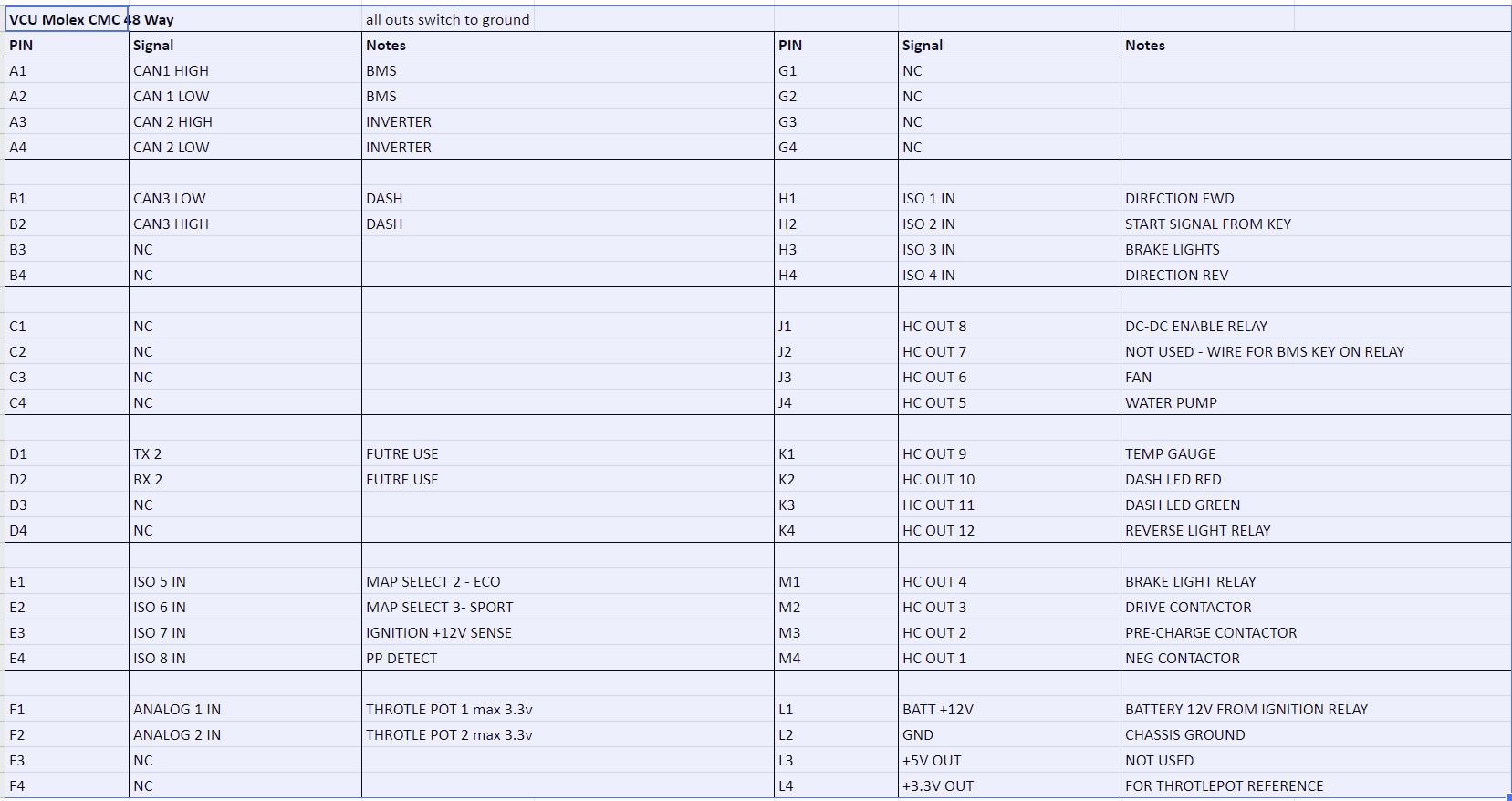

I prepared the pinout in the mini-e VCU board described here
viewtopic.php?t=2167
maybe it will be useful to someone, I'm just asking someone who has experience with this board to check if I made a mistake.

Looks right, here is mine for comparison:
