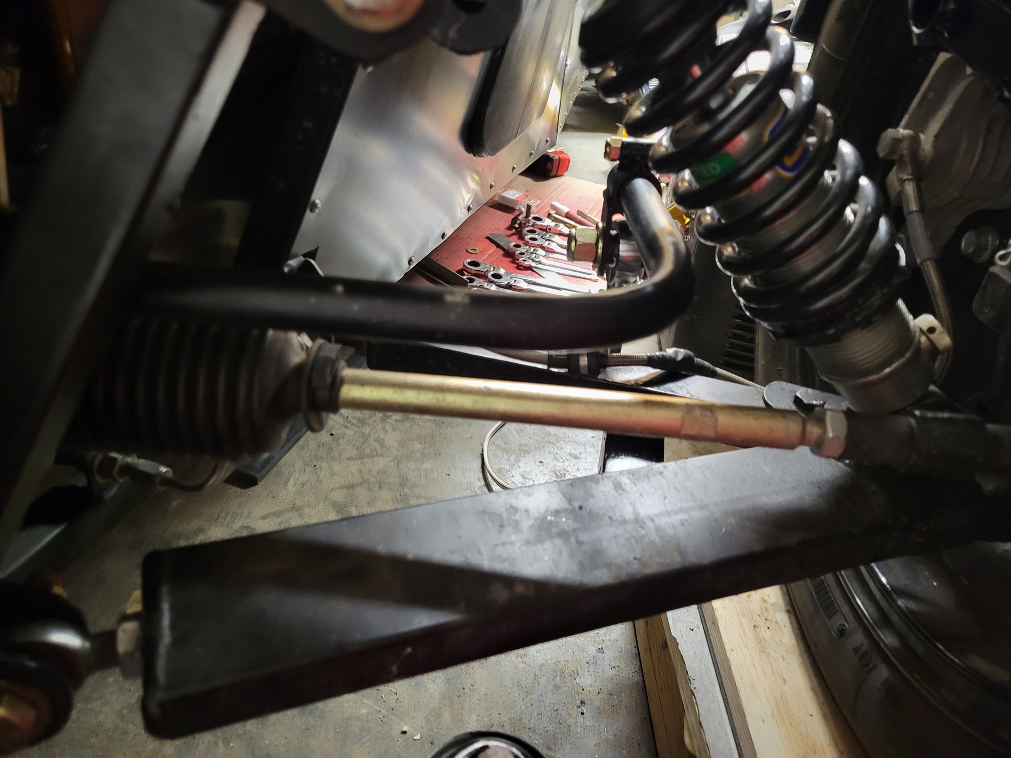

Yeah I made a spreadsheet somewhere but the other problems I discovered is availability and the limita of my crappy ram-type pipe bender. The 1/2" ram did ok bending a scrap of 3/4x.120 but when I tried .065 it just kinked. Grabbed myself a piece of 3/4 sch80 that I can bend and then cut out the inside of the bend to sit as a spacer in the die and better support the tube I'm bending. I have a random 8ft length of solid 3/4 that I can try, and I just bought a length of the same .120 size DOM I've been experimenting with.
Clamping the bar would be ideal but I don't think I have enough room. I have a 1/2" male heim joint screwed into a female one and that's about as long as my endlinks can be. Planning to just swap the bolts on the shock mounts with longer ones and attach the endlinks there. This also lets me attach it on either side of the shock body for more adjustment possibilities. I tried flattening the ends of my scrap tube with a 10ton press and it worked, but looked like ass. Will try once more with some makeshift dies, then plan B is to weld some flat bar to the bar, I guess? Seen some like that on google.
The other idea I had was to maybe use a heim with a 3/4" bore and slide the bar through it, holding it in place with some locking collars. Any thoughts on that? It would also mean getting a 3/4" female heim and making some kind of stupid threaded bushing so I could still screw the 1/2" heim into it. Or, I guess, use 3/4 heims top and bottom, with a bushing through the bottom link's bore so it would fit the 1/2" shock bolt...

I'm not sure how it will do if you try to skip the hardening process / material. Maybe this is light enough to not be a big deal but I'd expect it to go soft over time. Maybe in 5 turns, maybe 10,000. Not sure you were thinking this way.
The 3/4 bore heim sounds good but it will be sensitive to coating thickness, nicks, etc. May not slide well or will be tough to get to a good finished OD I think. Maybe zinc coating the adjustment ends could work if it's really smooth..
You could also go with a splined bar with splined arms and bend the arms to fit if needed.
If theres somewhere else to attach to it may help the link situation. It's tough with very little room to adjust and the unbolt it to adjust it is a pain. You can also adjust at the swaybar bushings if you leave yourself room with their brackets.

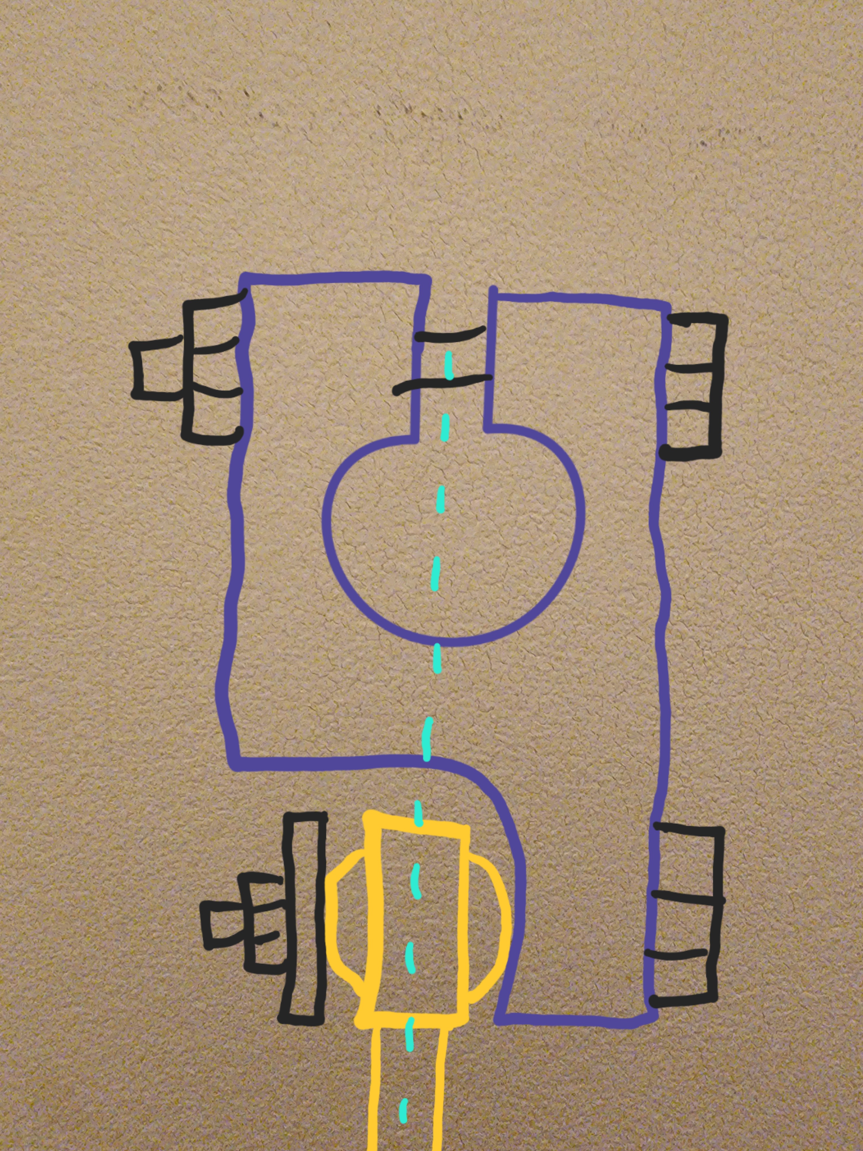

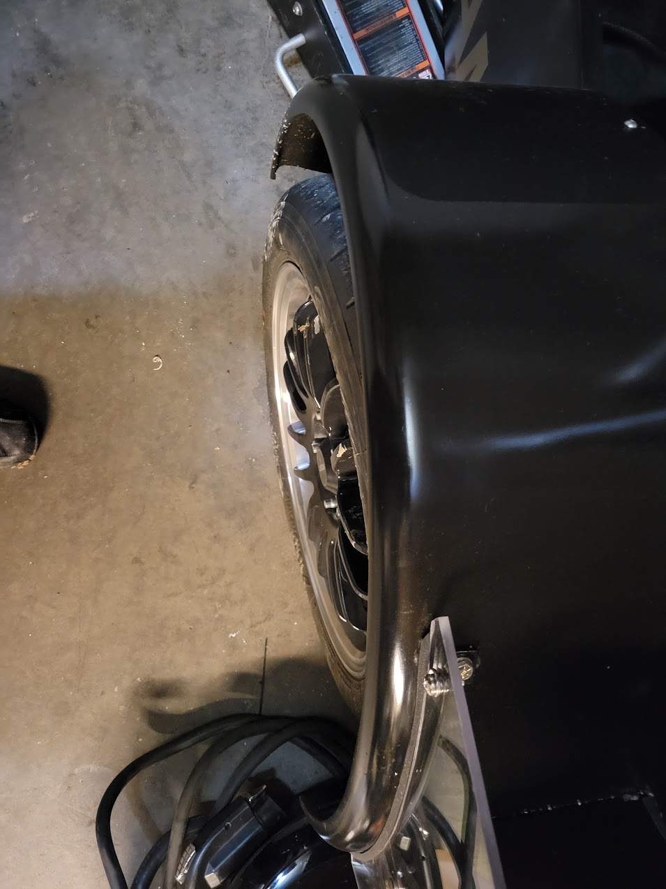

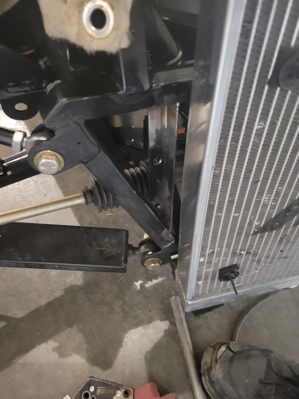

Re: [Driving] Homebuilt Locost 7 - from Motorcycle engine to Leaf power!
Well I've seen some kits with just 1026 DOM tube, which is what I bought. It's also recommended on some Locost forums so hopefully it holds up. I did run a quick calculation of shear stress at max deflection and it seemed ok. I guess welding close to the twisting part of the bar is still not ideal though, so I will avoid that. Splined would be cool but the only kit I found in my size range was NOT in my price range. I guess I could just mill a couple flats onto the tube and have the ends laser cut or something? The formula-style rotating blade swaybar ends would be amazing, but I can't find those easily either, and I know they are expensive.
Thought about mounting to the upper A-arm instead but I don't think I can do it. Both links are adjustable so it would have to attach to the ball joint cup, which is inside the rim and the cycle fender frame already gets close when turned to full lock.
Easier to make a short video than try and annotate photos, this is my attempt to explain my current plan.
The video helps a bunch. Some thoughts after watching it:
Can you mount the bar inside the frame? Limits arm length though if that's already an issue.
The upper ball joint looks ideal to use for the link point if you can mount to it / if the upper ball joint can deal with added force in the vertical direction. The fender mount may work well too. One thing to watch for is jacking at the swaybar from steering inputs. You can use this to your advantage if it goes the right way.
The longer the swaybar link the better the angularity / the more linear it travels as the suspension moves up and down.
Mounting the swaybar higher and using a longer link down to the lower shock mount may work out best because of how things are configured. Should avoid jacking from steering and should allow longer links with jackscrews / turnbuckles. It also looks like there's the most room for this in the video but I'm not sure what's going on radiator wise and other stuff up there.
If the mild steel goes soft over time, you can copy it in a hardenable steel. And if you search out individual pieces splined swaybars can be had under $200 or so in common lengths, especially second hand.

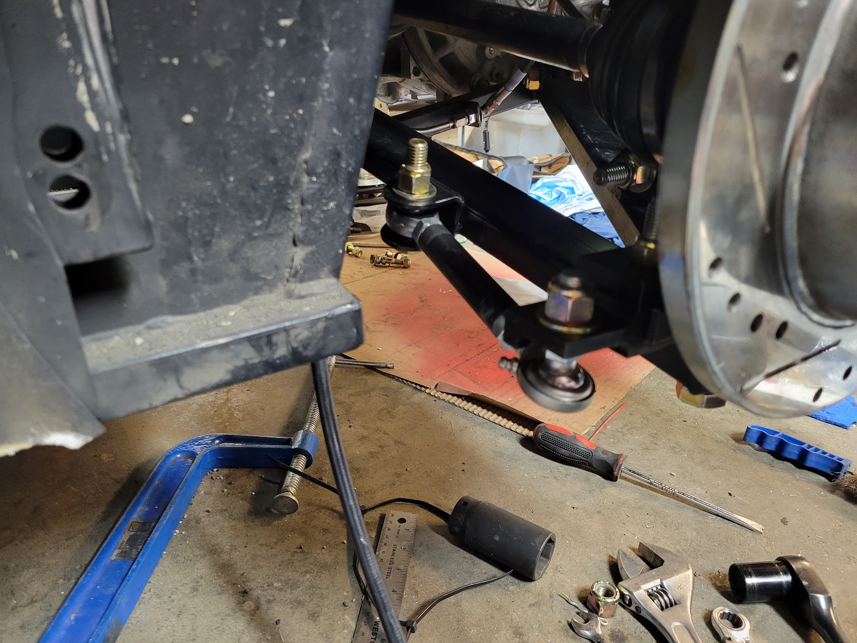

Okay, good point about mounting it on the inside of the frame. I thought that would have it too close to the pivot point but on a second look, it's actually better. Thanks for that (and all the advice and input). I cut the bottom part off one of the cycle wing brackets and it is going to need to be reinforced, but I was able to extend the heim joints basically right to their minimum engagement. There's only 2" of travel in each direction so hopefully the links are long enough like that.
There's just enough room to fit the 3/8 bolt in the hole. Debating just welding a stud in there, but I think the bolt will be ok. And I don't have to move the rad fan! The one on there is a cheapie from ebay and I don't know if it's actually reversible. Not having to touch it is nice. I guess the other nice thing about it being on the front is that if I don't go stiff enough, I'm really no worse off. Anything will help a little bit. And if some how it's way too stiff the car will understeer but shouldn't be dangerous or anything. The other good news is these bushings are cheap and have a common bolt pattern.

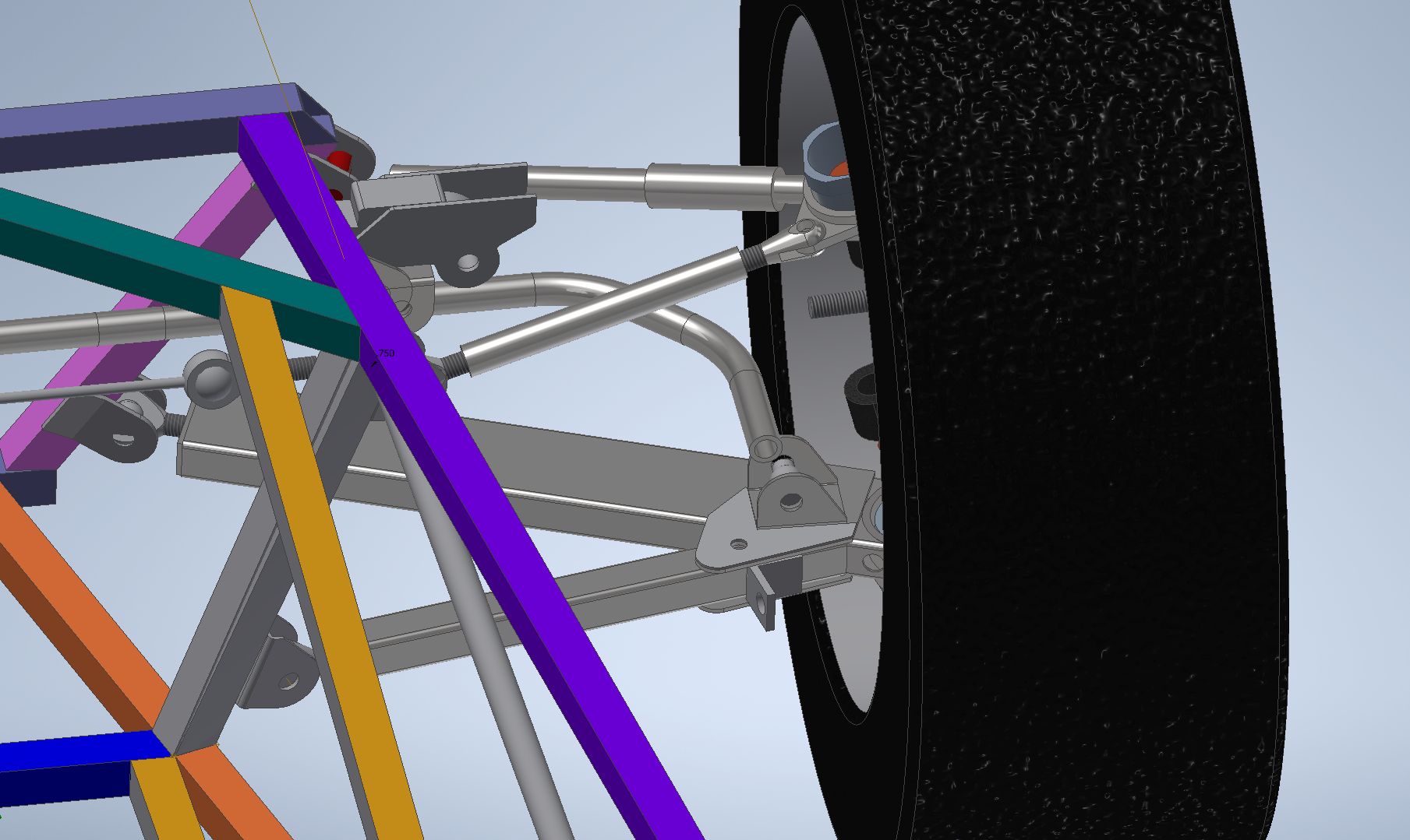

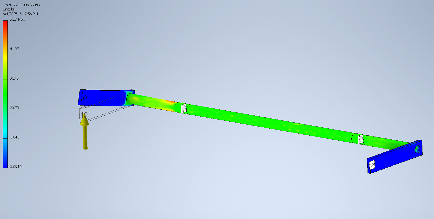

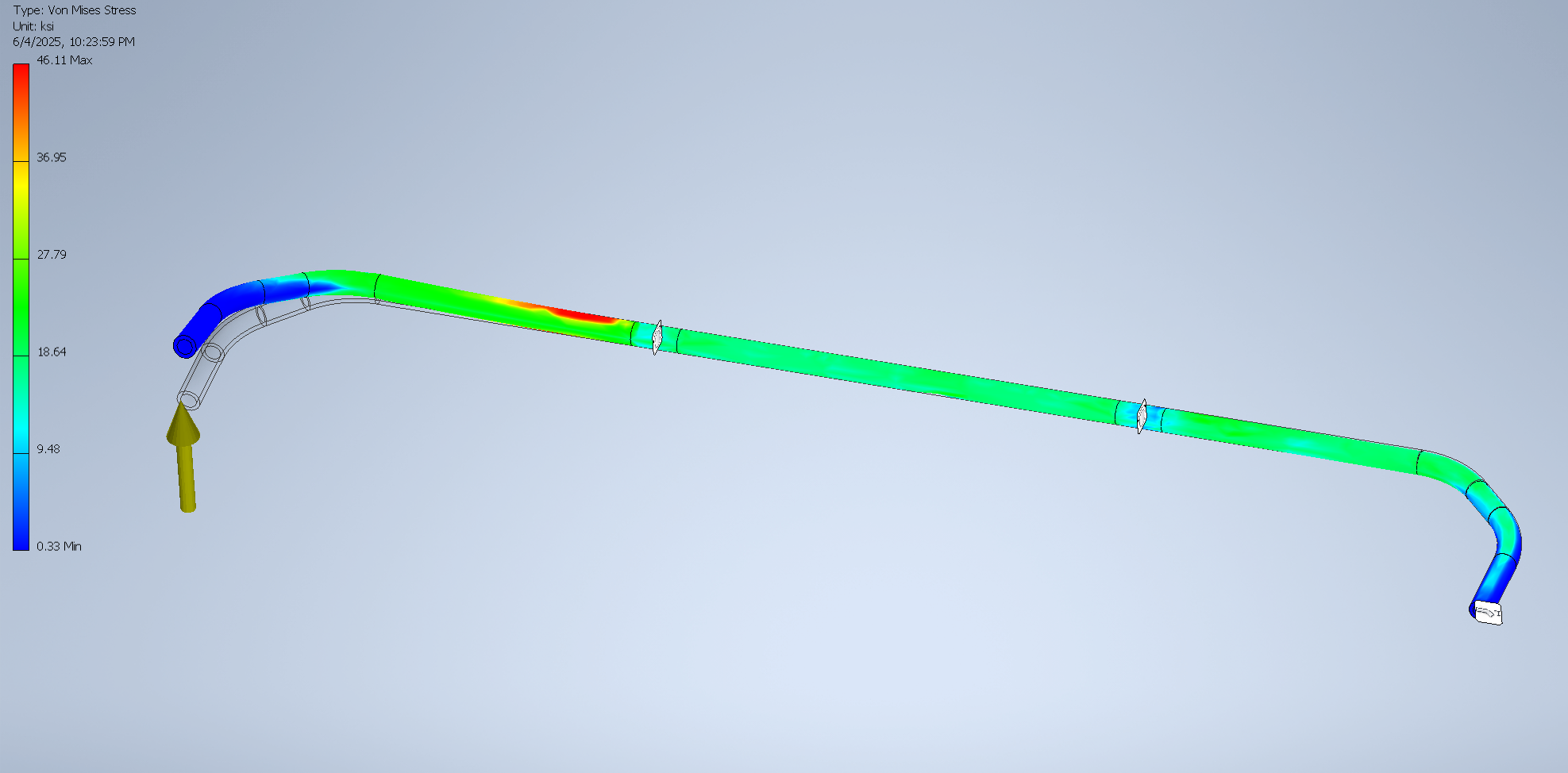

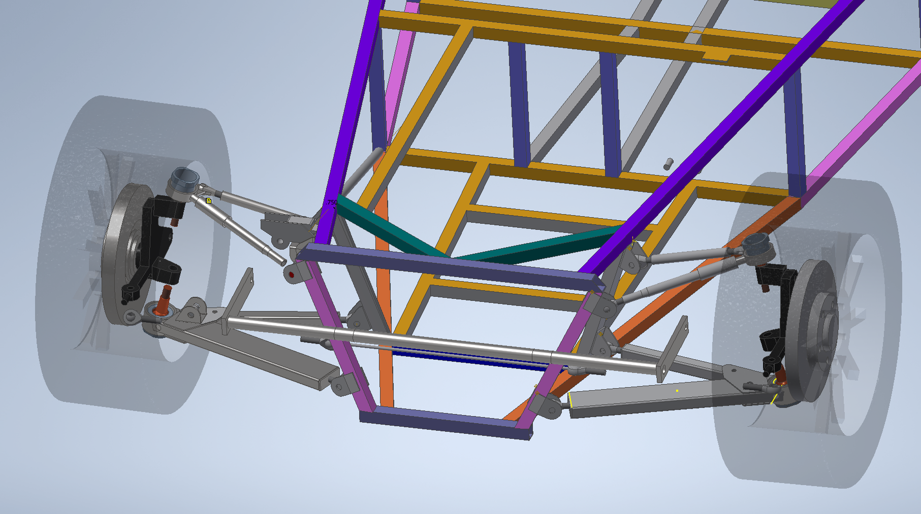

Hmm, I started modeling the bar in CAD and I'm not so sure about the result. I got a good rule of thumb that the bar should have a spring rate of about half the wheel rate, so I'm experimenting with different concepts. Found some torsion tubes that look promising but I think the biggest challenge right now is that the bushings can't be as close to the ends of the bar as I want. This causes stress concentration as the bar tries to bend up or down while it twists - see the red zone here:
Of course I also would have expected to see the same bending issue on the right hand (fixed) side, but I don't. Need to figure out what the hell. I built the simulation by adding bearing constraints where the bushings are, fixed the hole in the right hand side and added an upward force to the link on the left. Then I adjust parameters until I get about 1" of deflection for a given force applied, so I know the lbs/in rate (which changes depending on where the swaybar connects to the control arm). I think that's a valid way of doing it but it seems then that any swaybar is going to have trouble if the bushings aren't out really close to the plane of the end links. Also, this is only one inch of deflection, each side has some 4" of total travel so there would be more possible deflection in the hardest corners.
For the above bar, I moved it to the front of the frame so the arms could be longer, and shortened the arms to match a common splined torsion tube size, but IRL it would hit the shocks or the steering tie rods.
The bearing constraints look to be fixed for whatever reason. I'd focus on those. Maybe draw a concentric ring, set as polyurethane then fix the poly? Or fix the od of the poly?
The bushings look reasonably spaced but will be worse with the arms bent out.
I think you need to bend the arms out. If you match their angle to max steering angle / parallel you should be able to not worry about high link angularity and steering interference.
Edit
The 1" deflection is a common measurement method for swaybars, that's good. My performance bars look to be from .3 to 1 ratio to the springs so not a bad starting point at .5
Yes, bushings should be as far out as practical.
The swaybar resists bending by linking the 2 springs together. So your full suspension travel will be resisted by the swaybar. You don't look at it from the 4' deflection (suspension travel) possibility but the total spring resistance bar + spring) or the vehicles front end roll resistance / force. From the roll resistance you can get the roll angle. That will give you the bar travel. And with an infinitely still bar you can only ever have 2x your spring rate unless it's on bumpstops. Then those go infinite and the bar kind of is taken out of the equation.
Edit
Hm, good point, the bushings will have some give. I might be able to model that directly, have to look into it a bit more. Else I will just model up the bushings and do as you suggested. I also like the idea of the pipes that have the swaybar run through them and then bushings at each end, makes it easy to get the support further out, and yeah, as you say, bend the arms.
Also tried going back to the tubular bar but changed the bends a bit and maybe if I redo it with slightly compliant bushings, it will look better. I also thought of another way to mount my endlinks, little piece of angle welded to the back of the wishbone. Then I could even play with mounting the heims on the inside or the outside, for some extra adjustment.
edit: Ok just tried the default silicone rubber material and wow, there's 1/2" more deflection for the same force, and the highest stress is centered on the bushing. I guess the hardness of the mounts can play a pretty big role too. Never knew it would be that much! Haha, so that might mean I need to shorten the arms a bit to get the rate back to where it needs to be. Angle bracket on the back of the wishbone might not work afterall. Oh well.

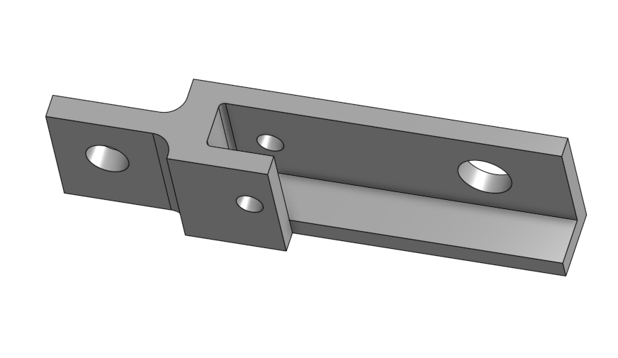

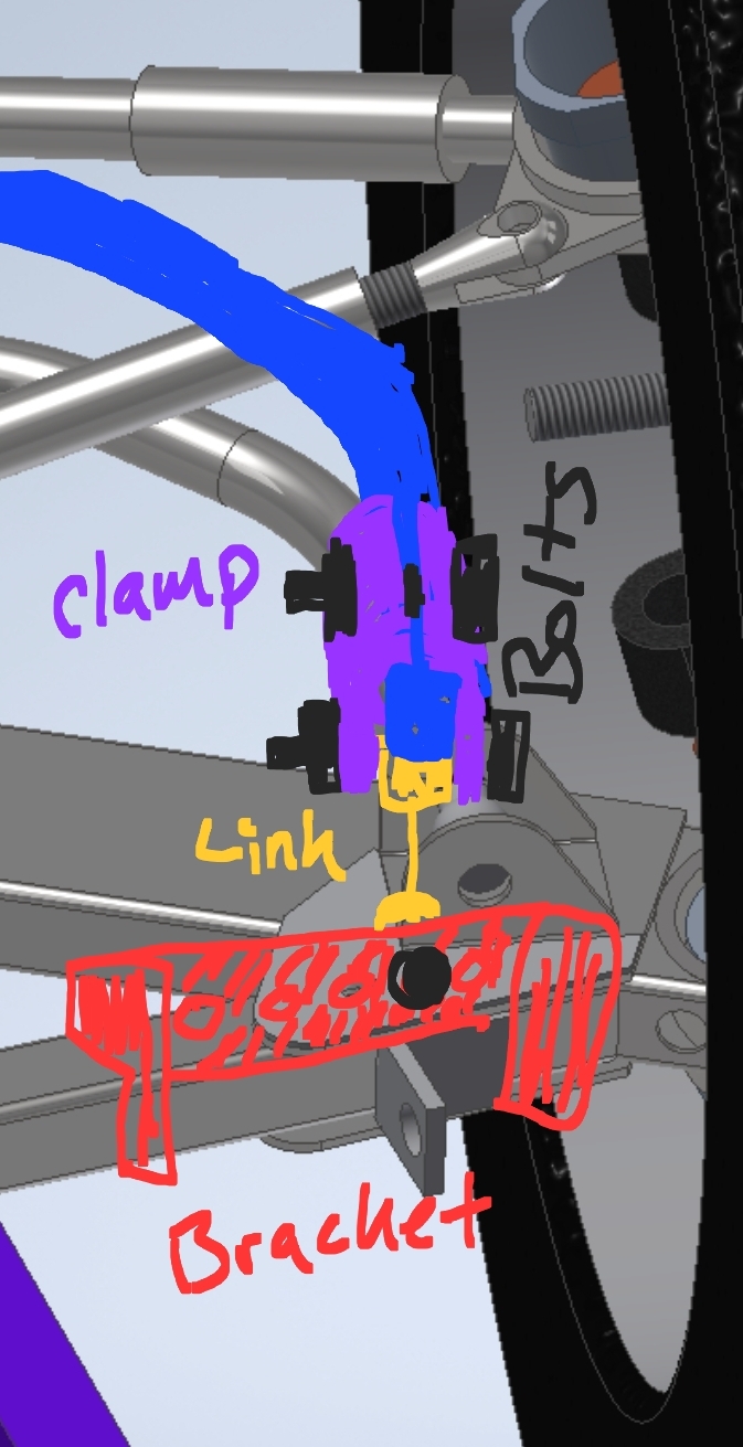

This is what I was thinking. Getting the bar as far away as comfortable for longest link length gives you better angularity on the link (orange). I drew over the upper control arm upper rear rod which makes it confusing looking. My intent was under the upper control arm
The bar clamp that gives you infinite adjustment is purple. Put the force inline with the bar to help avoid twisting forces. You may be able to make the link bolt boss single sheer if you watch the thickness and inner radius. The red link bracket has a few adjustments for different motion ratios. But this also adds angle to the link so the bar clamp and the adjustments on the red bracket can give you the best adjustment with minimal angle. You can stagger the holes, 2 rows offset between each other if you have the link adjustment length.
The bushings will deflect but it should be minimal (a few %) as long as they aren't positioned too narrow to each other. The idea was if the constraints were limiting it could be a workaround.
And if course you can mix and match the ideas to work with what you have room for.
Oh that bracket is a great idea, thanks! I had been spending all my time thinking about the bar, hadn't thought about the links too much beyond 'I don't look forward to flattening this tube'. I think I should be able to mill those out of aluminum without too much trouble.

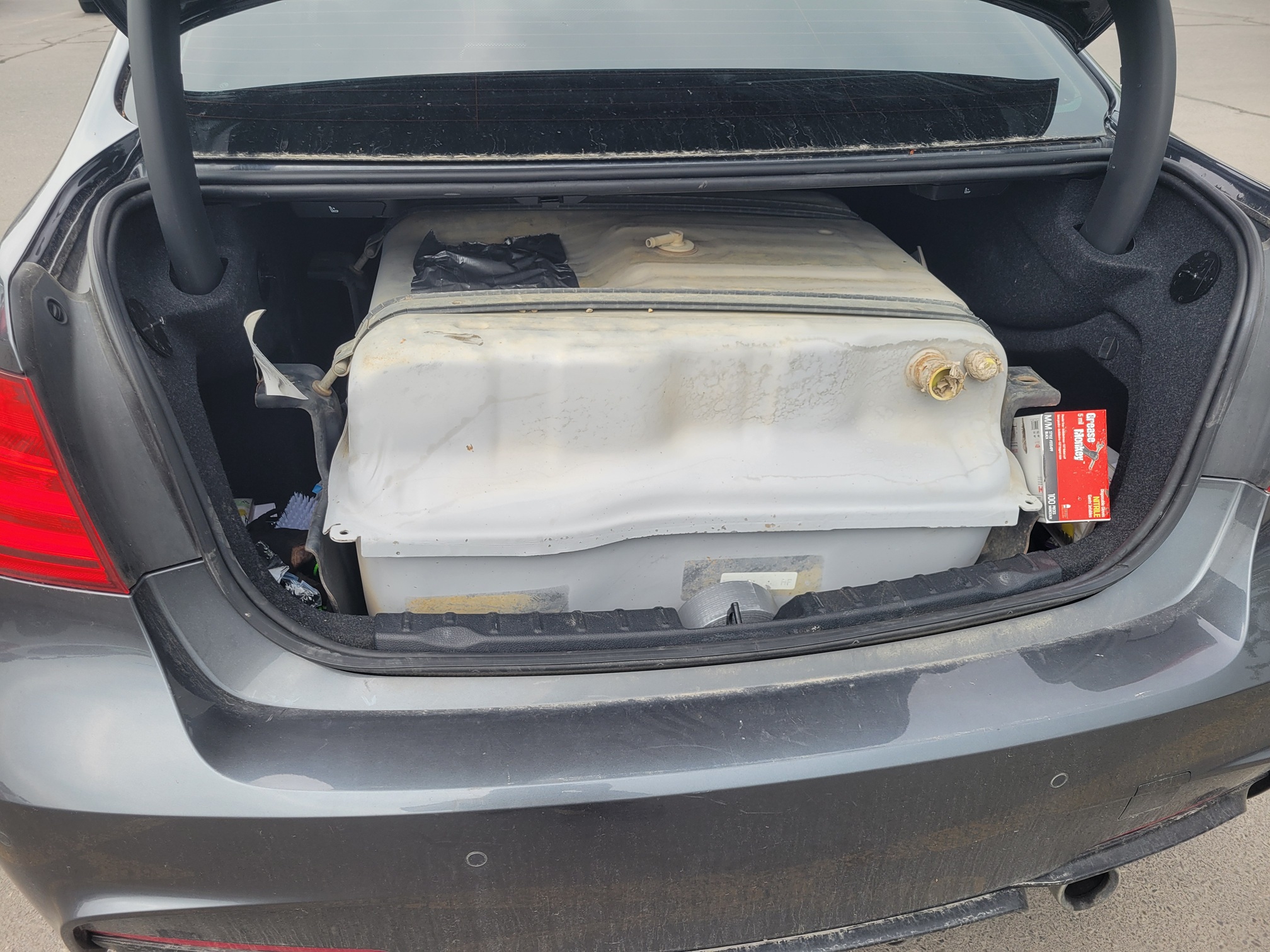

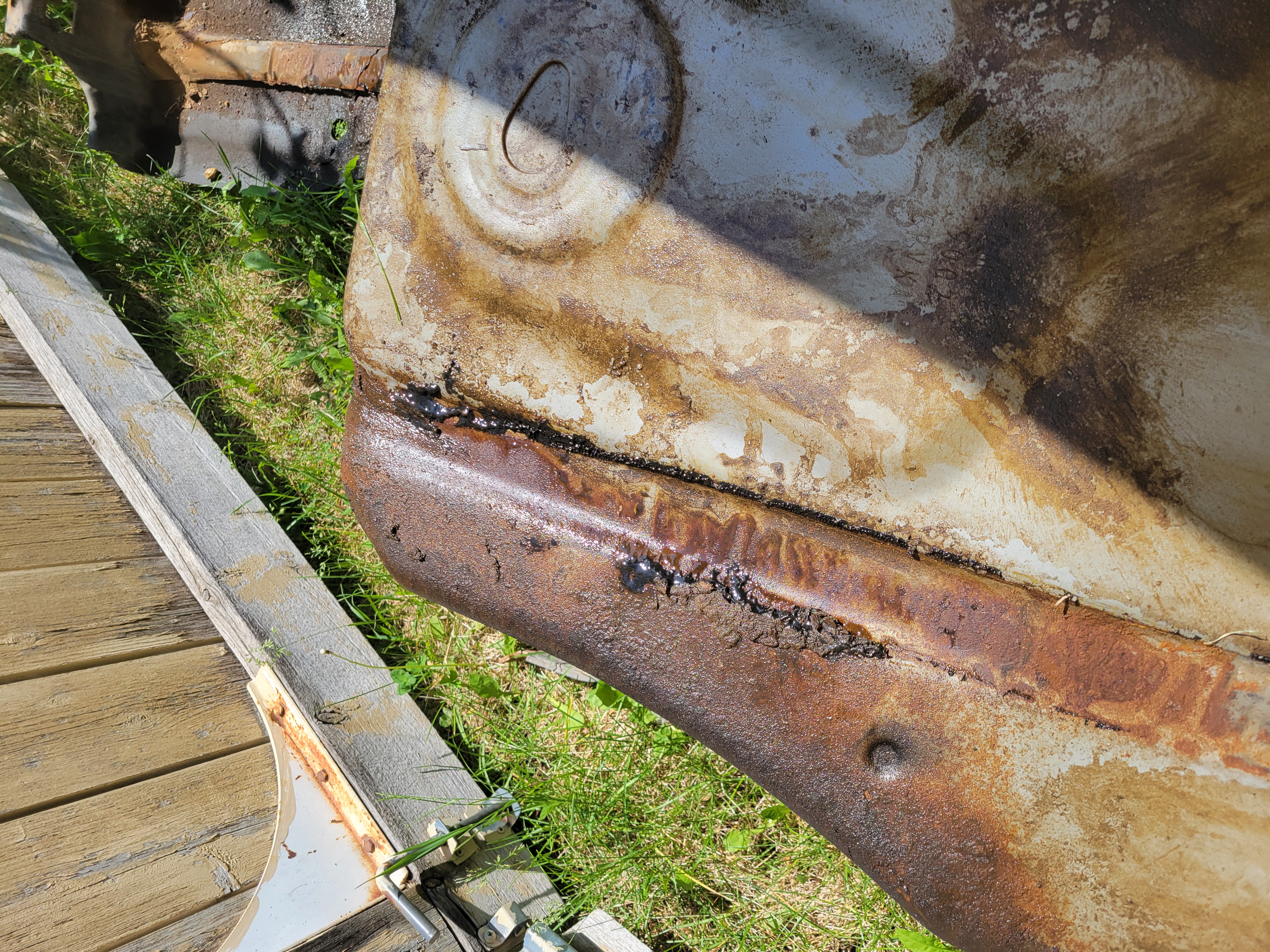

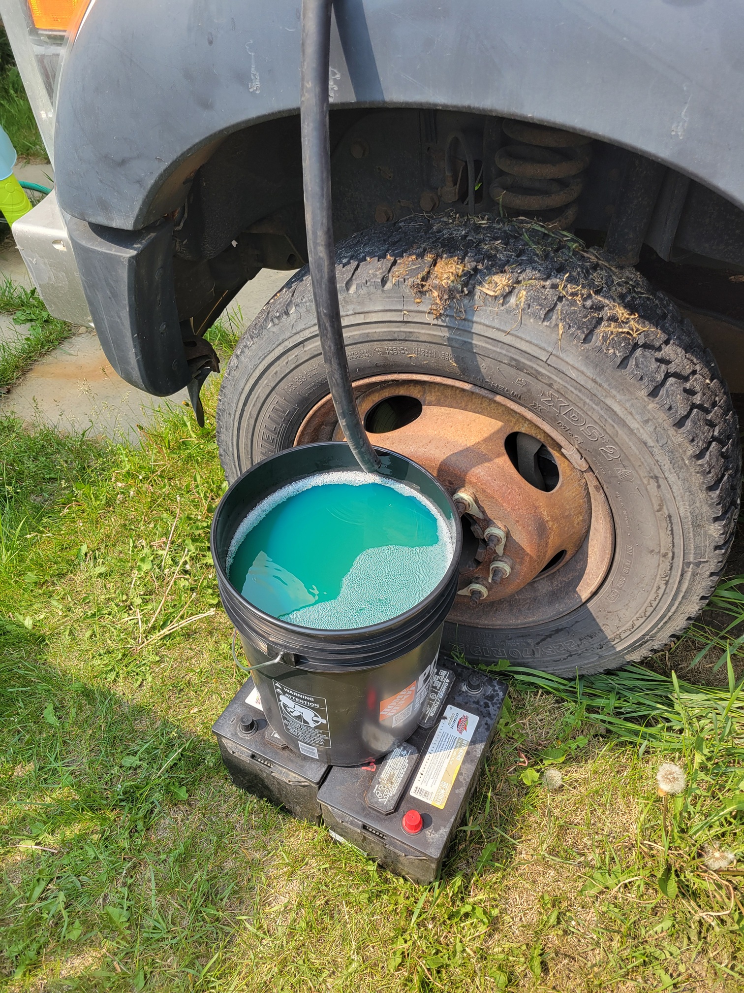

Okay, so I borrowed the heated ultrasonic cleaner, ran the carb through two cycles of that, and the generator runs like new. Starts on the first pull and it nice and smooth. Somehow, it even sounds quieter - maybe because of the valve adjustment.

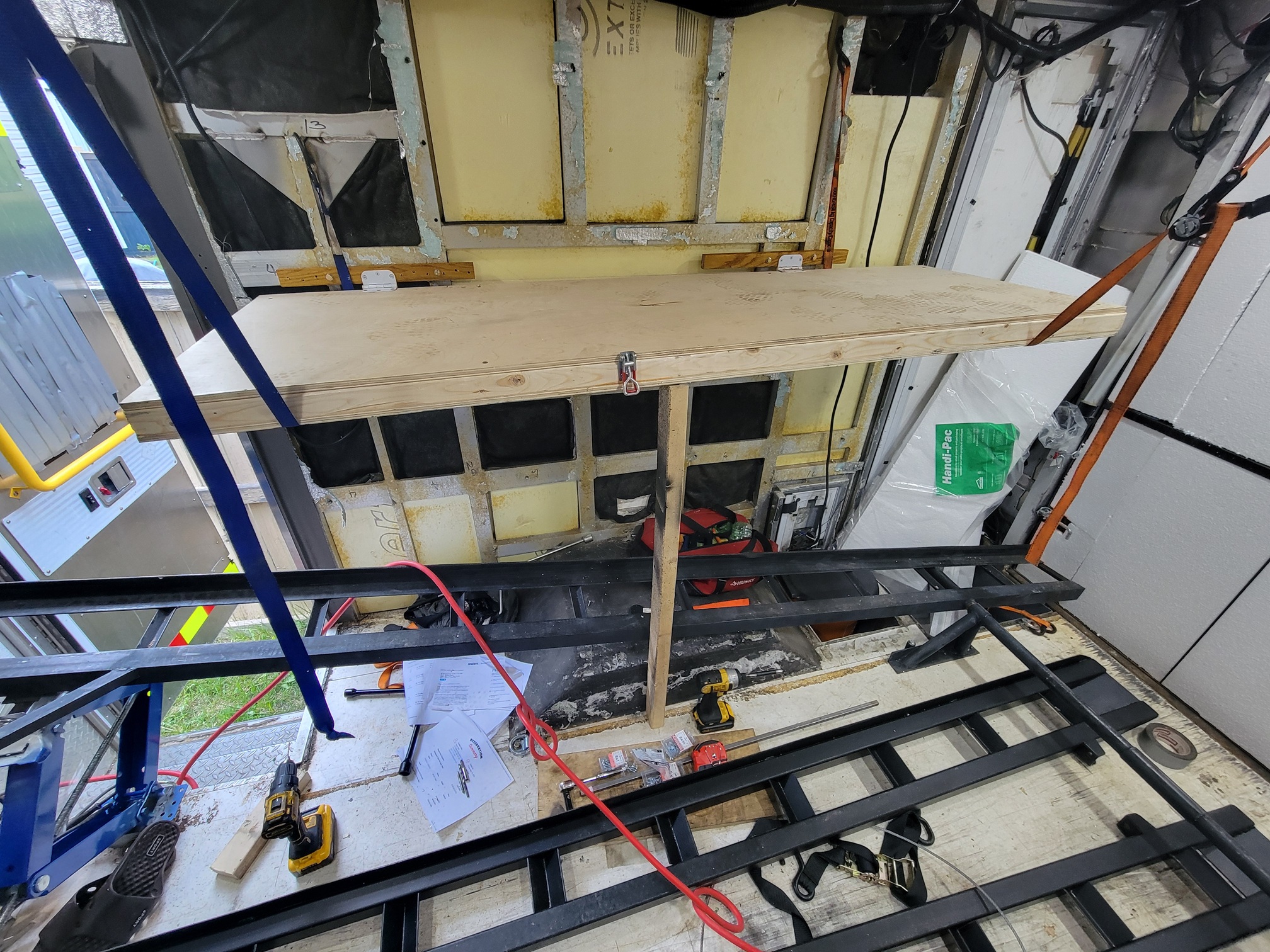

I made a fold-down shelf that will serve double duty as a table and a bed. Feels nice and strudy, though I can't seem to get the rope to cooperate so for now I just stuck a piece of wood under it. Got some cheap foam floor mats to add at least a little padding. Swaybar bent up ok, despite using a ram-style pipe bender. Probably thanks to the heavy wall. Nobody in town carries chromoly in that size apparently, so I went ahead with 1026 for the time being. Due to the way the bender works I wasn't able to get an exact estimate of where to put the center of each bend, so I did one bend, measured to my reference, did the second bend, and the damn thing still came out an inch too wide. There's still a bit of clearance to the coilovers though, so hopefully it works until I can get some chromoly to make another one. Also, I spent some more time thinking about the principles involved, reading more, and it clicked a bit better now how they are supposed to work. The idea isn't to just transfer 100% of the force from one coilover to the other - the bar itself acts a bit like a spring too, and not just as it acts between the two sides. If you hit a bump straight on both ends swivel up and nothing happens, then in a turn one wheel goes up but the other doesn't, causing twisting and bending on the bar. A lot of that force goes into the car through the mounts, rather than just transfering to the other side. I had to look at the reaction forces in my simulations and try adding an opposing force to the other end of the bar before it really sank in. Also, shortening up the bar allowed me to reduce the bending moment/max stress in the bar, and I only need to worry about an inch or so of deflection now. Numbers also worked out pretty good, though I did add a hole to my bracket so I can connect the end link to the center of the wishbone if I decide to go way stiffer. I was a little rushed with these brackets but they turned out good enough. Seems to clamp pretty tight so hopefully they last. Bottom joint is a bit close to the bracket, but the nice thing about the swaybar size is now I have a bunch of 3/4x1/2 tube that I can use to make some small spacers. Already did that for the heims inside the upper clamp.
And that's about where the good news ends. I was supposed to leave tomorrow to go racing, but yesterday I discovered the fuel tank on the ambulance sprang a leak. Rather than straps on the bottom like one might expect, these stupid things sit directly on a steel cradle/skid plate, and are strapped down to that from above. Perfect spot to trap dirt and moisture so it can rust through the tank. So, I grabbed an almost-long-enough bit of hose, connected it to the outlet of the fuel filter and spent a bunch of time cycling the key on and off to pump as much fuel out of the tank as possible. It's a big damn tank though, 80 gallons. I filled 5 x 5 gallon buckets.. apparently they are made from the same type of plastic as a diesel jerry can so hopefully it's ok to temporarily store it like this. Guess it can't be too much worse than just letting it all leak out into my yard..
Had to raise up the batteries a bit to reach the end of the hose, thankfully like any good redneck, I have an assortment of dead car batteries in my yard. Grabbed another tank from a local junkyard. Of course the cab&chassis trucks have a different tank to the pickup trucks so they're a bit hard to find. It JUST fit in my trunk. Was stored without the cap so it's disgusting inside. Wish me luck. Oh, and if you are wondering, if I filled that tank with gas and plumbed it into the car's actual gas tank, I'd have a little over 2000 kms of range. lol.

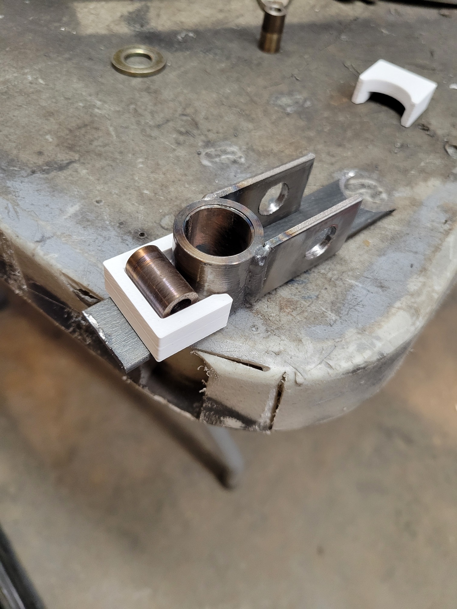

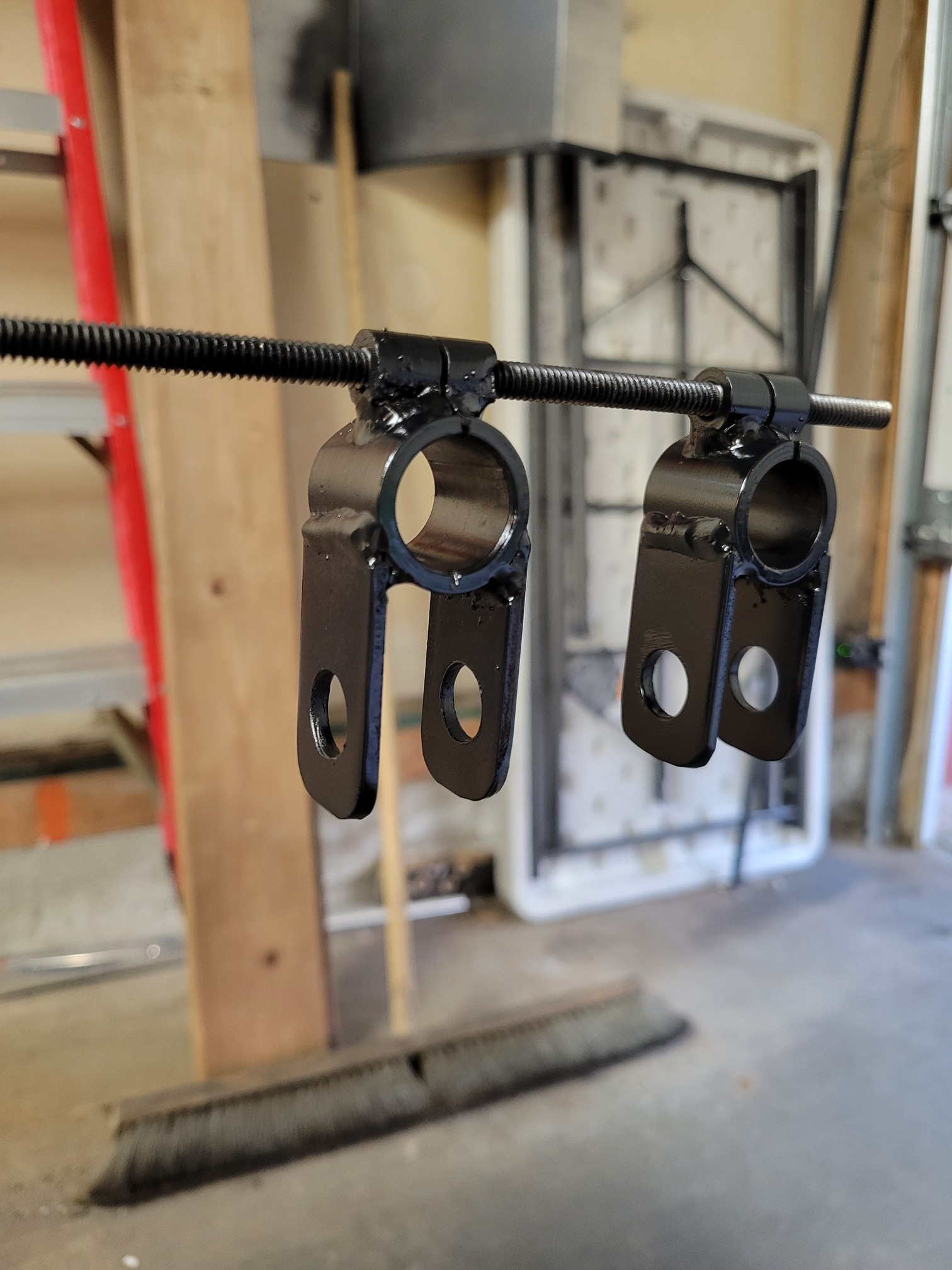

Yes, a swaybar is like a spring to transfer spring rate from one side's spring side to the other side's spring. A swaybar lowers the cornering weight transfer that happens on that axle which helps resist sway but lowers grip as the stiffness goes up compared to the other axle. It keeps the weight more balanced between the tires while cornering. The balancing trick is getting the axles weight transfer to balance cornering and keep the tires more in their sweet spot of downward (weight) to cornering force the tire can make while also watching tire lift off the ground. Tires make more cornering force ratio to weight at lower weights and it starts to fade as the weight goes up. Feels like a lot of circular / looping thinking for each piece of understanding these things.
The bar and bar adjuster link ends look great!
One of the bending tricks is to mark the tube every inch / cm before you bend with something that won't bleed through paint later. Mark some reference line with another color to your bender die as a starting point reference then bend. Then you can see where it bends from where you started and what length you lose / gain from bending.
The gas tank thing sucks. But foam / rubber can hold moisture and create / accelerate rust too. There have been lots of recalls over the years from gas tank strap foam causing rust and fuel leaks.
POR15 has tank sealer that worked really well for my old race car. It has a cleaner, zinc plate, then coating steps. You can buy and do just the cleaner if the POR15 coating worries you. There's something about zinc coating and heating oil so I'm sure it also translates to diesel. I don't think you want just a zinc coated tank. Raw steel or hard coated is likely best for it's injectors, pump, etc.
Got the tank replaced, the new one was a pain to clean out and I had to drop the old one with around 10 gallons still in it, but I got it done. Seems the cradle does still use a formed part with rubber lining to act as a strap, and yeah that's where it rusted. Not sure what to do with the stupid thing now.

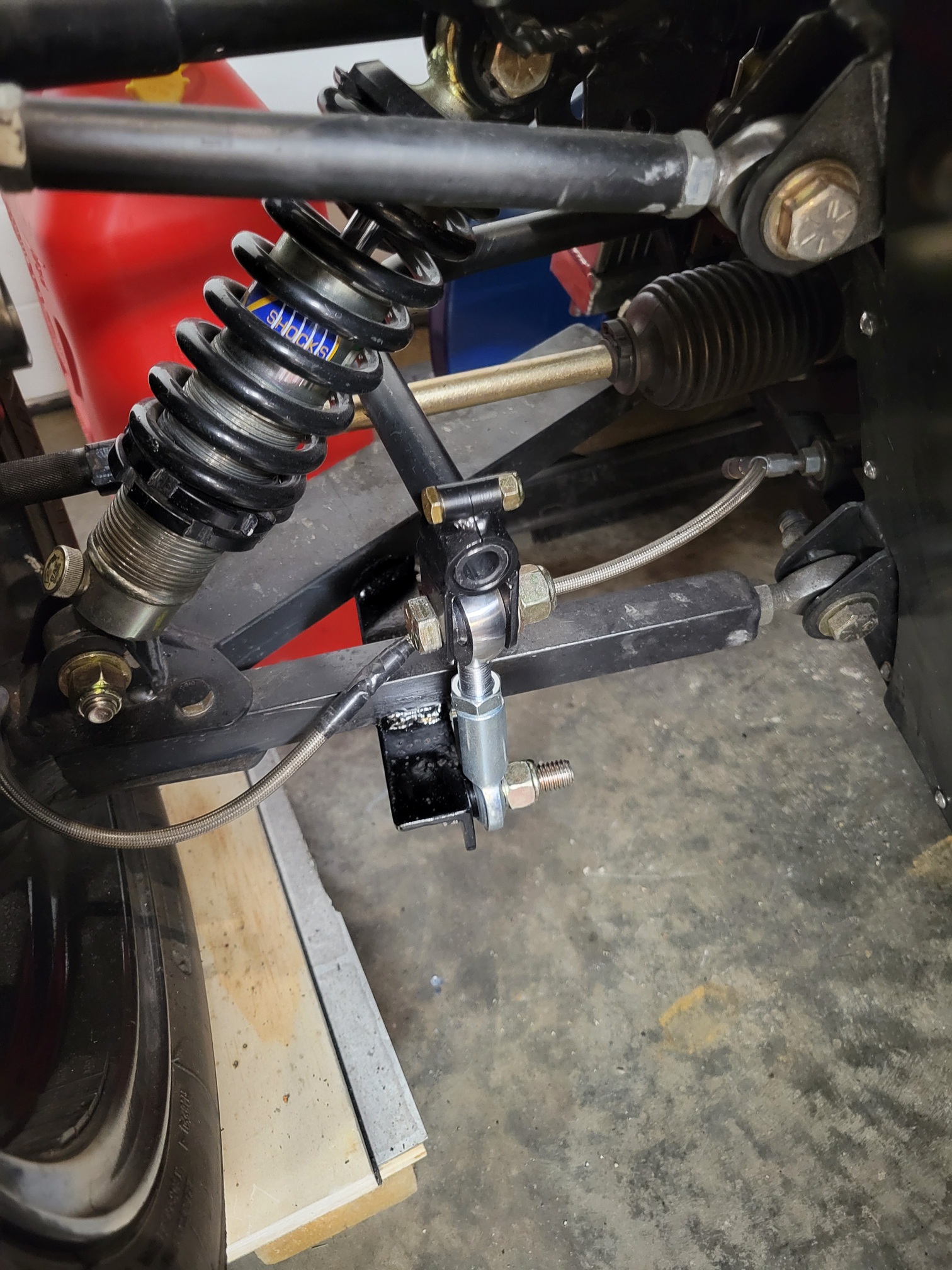

Took the car for a drive to test out the new sway bar and WOW what a difference! I guess I must be somewhere in the right ballpark because it was stiff enough to be immediately noticeable but not so stiff that I felt like it's going to understeer. Of course I won't know for sure until I can get it on track.
Also made some split shaft collars to clamp on the swaybar to prevent it moving side to side. Due to my error making it wider than intended it's close to the springs but doesn't seem to interfere. I could have bought collars but I figured I had the material laying around so why not. I did have to flatten the side that faces the frame rail for a little extra clearance in case the bushings deflect a bit. It's interesting because the reaction force at the other end of the bar is not the same as the upward force being exerted by the outside wheel in a corner. I think that's the part I really had to get my head around, and I suppose if those forces were the same it would just be a rigid connection. So now I get why the material used in the bushings matters so much! I'm really glad I finally tackled this, wish I had done it years ago. Was afraid to attempt it because I didn't understand it well enough to design. And now I've got a bit of time on my hands. Really bad timing with the fuel leak, because the next event I could go to isn't for another month. So I thought I might turn my attention back to some improvements on the ambulance. The speed limit in much of Montana is like 80mph(130kph). That's nice, but it does eat into your fuel mileage. I didn't calculate it by hand but the cluster is reporting 11mpg(22l/100km). That's not terrible but I wouldn't mind doing better, as long as the monetary investment will pay itself off in reasonably short order. I think the easiest things to look at are some kind of fairing or boat tail for the rear, and some kind of deflector for the front of the box above the cab.

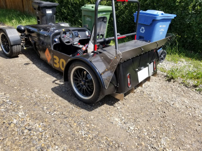

Boat tail example: 'nose cone' example for the front of the box: Now the nose cones are surprisingly expensive, but I find myself extremely tempted to make one by clamping a sheet of plastic in a wood form and just.. heating it up til it sags. I'm sure there's more to it than that, but man am I tempted. I can't imagine it making anything worse?

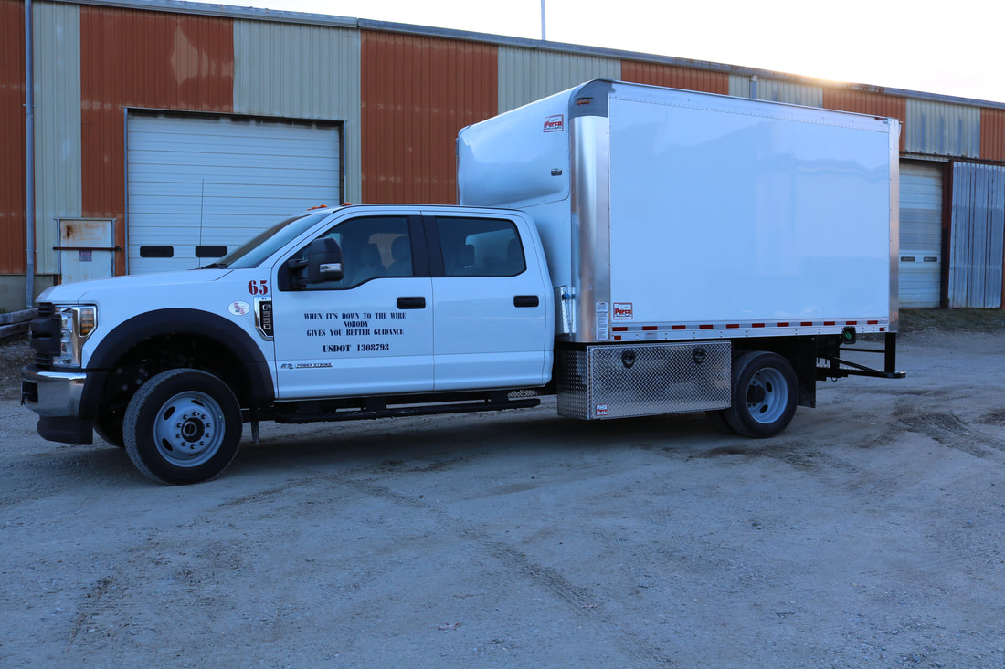

Old pic of the ambulance for reference, excuse the ICE car for also being in the shot.

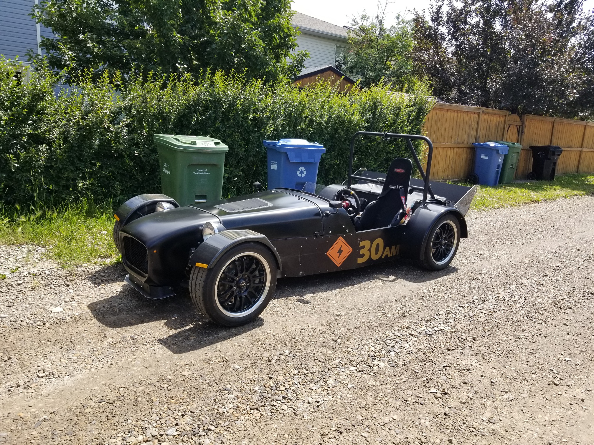

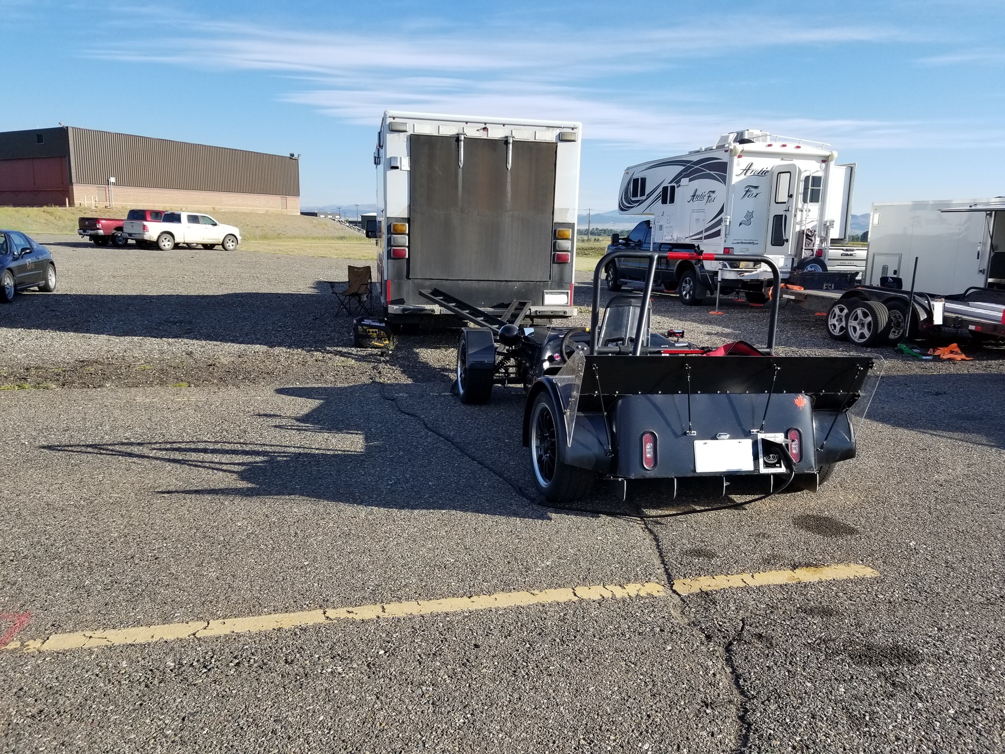

Well the same club in Montana had a short notice pick-up event last weekend and this time I made it out for both days. I told myself I wanted to add some aero before going back to that particular venue again, due to the higher speeds on the road course section. So I dredged up the concepts I had for a rear spoiler and front splitter many years ago and hastily put them into action. I didn't quite get the curvature of the nose cone correct in my CAD model so the splitter doesn't fit great, but I think it was good enough to at least try to help reduce the amount of lift that a typical nose cone creates. The spoiler turned out pretty well, although the side plates ended up a bit more batmobile-esque than I would have wanted. The support rods include a handful of threaded clevises that I salvaged from the ambulance when I tore it down. Always nice to be able to actually use something from that bin of hardware in the shed that you swear you'll need some day.
It was pretty hot - low 30s Celsius, and very sunny. My radiator fan was kicking on but the batteries didn't get above 35 or so. The generator didn't want to charge at 1.5kW so I had to run it at 1kW - not quite enough to get it back to 100% over the lunch break. Still used about 800Wh per 80-second run.
The car felt great. I had my brake bias very slightly front-heavy now so no issues with spinning out on corner entry. The sway bar really helped with front end roll and I think the spoiler helped with mid corner and high speed stability. Lowering accelmax made wheelspin a lot more manageable. I set it to approximately 1g of acceleration. Now when it does break traction the motor accelerates much more gradually, so it's easier to lift off and regain traction. Very helpful!
In the second half of the second day I had to skip my last few runs due to play in the rear toe links. Last year I had been wanting to redo them, but it was low priority. Well that's now at the top of the list. Aside from being difficult to adjust, the other effect of them being so close to the ball joint is that the force on the links is higher (too high, apparently). With the rear wheels able to 'steer' themselves a little under acceleration and braking, it caused the rear of the car to behave unpredictably and even wander. It happened midway into one run and I could immediately tell something was off so I slowed down and limped it back to grid. The links were the first thing I checked. Sure enough, there was a little play on one side and more play on the other. On the bright side, I was able to get two rides in a Model 3 Performance, and holy cow that was amazing. That was the first time I'd even been in another EV.
I also had one instance where the car died right after crossing the finish line. I had to restart the car to get it out of the way, so no time to go in and check lasterr. Best guess it might have been desat, but no way to know now. All spot values were in acceptable ranges when I was able to check a couple minutes later.
Took 4th overall in raw time, or 6th overall if you just count the first day which had more people (35 vs 23). The class-adjusted PAX times were predictably much worse.
Here you can see I took out the passenger seat and made a new cut down windshield to allow as much air as possible to reach the spoiler - and perhaps offset some small amount of the drag that it adds.

Looks good, I think you could use a bit more front swaybar stiffness but that may need to be balanced with more rear bar. I'm also thinking you may need the front raised / rear lowered a bit. But overall it looks much more stable!
How did the swaybar do? Look like it did when you bent it? No side to size mismatch?
Thanks! Yeah, I was trying to make small adjustments, but the swaybar only got adjusted during the second day, and only by about 3/8" on each side. I haven't been able to get the thing unloaded to inspect the toe links yet, but when I did check the sway bar it seemed okay. I think I'm confident that the size is in the correct range, just need to find somewhere to get the same size tube in chromoly. My local supplier wants $400 for a 5ft length and a 4 week lead time...
I did look at lowering the rear but it turns out the springs don't have much preload on them. It's sitting about 3/16" higher than intended but if I try to lower it any further the springs get loose at full droop. Need to order a set of helper springs, then yeah I will drop the rear a bit and see how that feels.

Okay, so it turns out that what happened at the end of my last trip to Helena was, the bolt on my rear toe adjustment link broke. It was still kind of holding on which is why I couldn't immediately tell exactly what happened, but upon taking it apart it was obvious. Also, because the centerline of the hub is slightly aft of the centerline of the balljoints, it has some inherent stability keeping it straight, which went away when I was reversing the car into the garage to take it apart.
Oh yeah, that's no good!
So I dusted off my designs for an extension bracket and machined them from a solid piece of steel (which took HOURS on my manual mill). The end result turned out well, it's a snug fit onto the upright with a 3/8 bolt in double shear where the toe link used to connect, and a larger 1/2" heim joint mounted further outboard. So two birds with one stone - it's a lot easier to adjust this time around. It also occurred to me that because of the suspension geometry, the a-arms don't pivot around parallel axes, so the effect is the upright has to rotate back slightly. We're talking fractions of a degree here, but the clevis I had on the inboard end of the toe link adjuster didn't allow any movement in that direction, so I'm sure that didn't help matters. All fixed now.
Here's a nice photo of my garage floor and cardboard mat, sorry the view is partially blocked by the finished toe link/bracket in the foreground. I found out there is a track in Alberta that does allow EVs and they can do so because they have their own insurance. They host some autocross events, though they don't follow the SCCA classing rules and the pace is pretty fast since it's done in the evenings on weekdays. So I hauled the thing up there and got 3rd place in the 'performance' class. 1st was a Miata with unknown mods, 2nd was a Golf R with a very large rear wing. I got my BMS logging slightly better, though it's still only polling at 2Hz, so there's some odd smoothing going on in the gauges. Still, neat to see what the battery's doing while on course.
