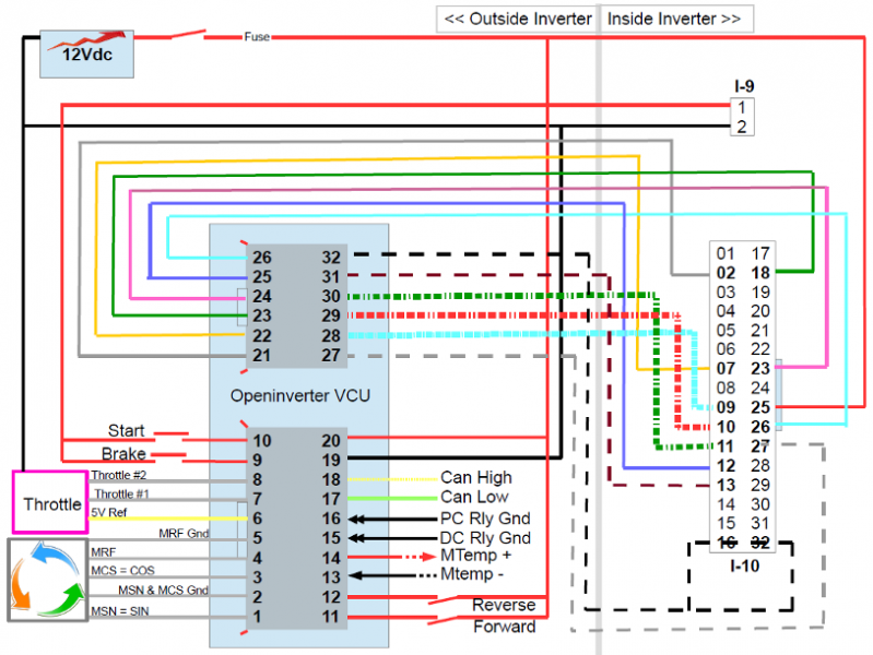

File:VCU to Gen2 Inverter.png
Size of this preview: 799 × 600 pixels. Other resolution: 814 × 611 pixels.
Original file (814 × 611 pixels, file size: 116 KB, MIME type: image/png)
Huebner VCU to Prius Gen2 wiring.
