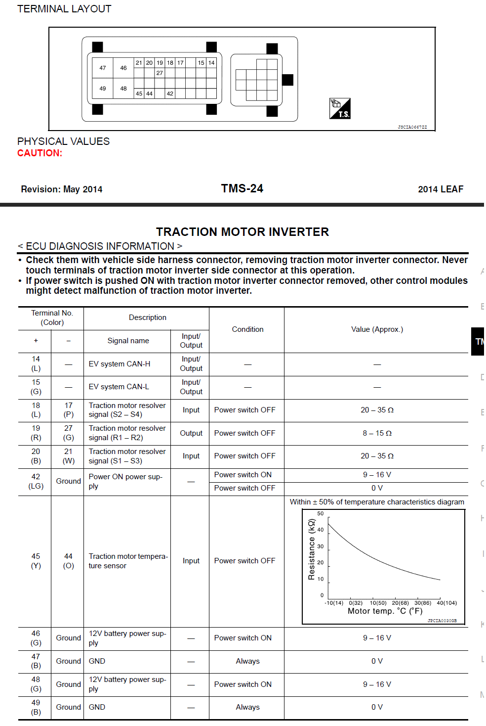

  • Nissan Leaf Gen1 inverter
Damien has presented his controler here: https://github.com/damienmaguire/Nissan-Leaf-Inverter-Controller
PDF file with multiple connector pinout: https://openinverter.org/forum/download/file.php?id=839
According to OEM: https://openinverter.org/forum/viewtopic.php?p=2207#p2207
