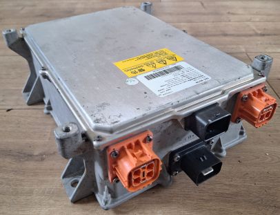

ZS10BC6600A
ZS10BC6600A Overview
ZS10BC6600A Pinout
LV Pinout
Specs:
AC input: 85-265V 32A Max
DC output 230-480V 20A Max (6.6KW Max)
To use the charger:
connect pins on the LV connector:
1 to switched 12V
2 to ground
3 to CAN H
4 to CAN L
8 Via a 100k resistor to pin 12
10 Via a 100k resistor to pin 12
12 see pin 8 and 10
connect pins on the AC HV connector to the charging port
When using Foccci the CP can also be connected to Zombie CPspoof
output through a 1k resistor.
connect pins on the DC HV connector to the DC bus.
the HV interlock needs shorting, integrated in the DC connector.
Controlling the charger:
This is simple it uses 1 CANbus message 0x29C at 100ms interval on a 500kbit bus
In this message there are 3 values:
Max AC current
Max DC current
Max DC voltage

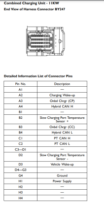

EP3CCU1130B
MG4 charger
LV pinout
Specs:
AC input 1: 85-265V 32A Max
AC input 2: 300-456V 16A Max per phase
DC output 1: 220-490V 24A Max
DC output 2: 220-490V 31.5A Max
