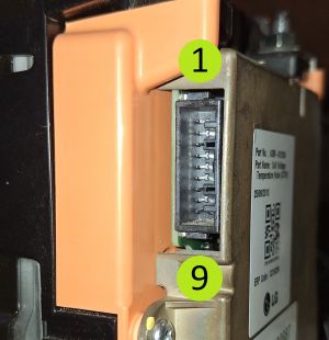

The BMS satellite module: LG calls them "Cell Voltage Temperature Node (CVTN).
External connector (9 pin):
The connector looks like a JST HCHFB-09-KE and uses SHCM-A03T-P025 pins.
Pin Function Note
1 +12V Vehicle 12V, switched by the BMS master, not regulated
2 CAN-L
3 CAN-H
4 Digital input internally 50K pulled up
5 GND only first slave has this pin connected to the master, guess for some kind of 'first slave present' detection
6 Digital output open collector with 1K in series
7 GND
8 CAN-L parallel to pin-2
9 CAN-H parallel to pin-3

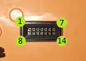

Internal connector (14 pin):
The connector seems to be a molex micro-fit 3.0 dual row 14 pin.
Pin Function Note
1 Cell 1 positive
2 Cell 1 negative connected to main negative terminal
3 Cell 1 negative connected to main negative terminal
4 NC not connected
5 Cell 10 positive connected to main positive terminal
6 Cell 10 positive connected to main positive terminal
7 Cell 9 positive
8 Cell 2 positive
9 Cell 3 positive
10 Cell 4 positive
11 Cell 5 positive
12 Cell 6 positive
13 Cell 7 positive
14 Cell 8 positive
