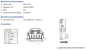

CAB300 connector, which is CAB500 connector as well:
4P Female P/N 1473672-1
Pins Female Crimp 1123343-1
