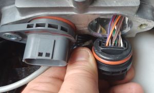

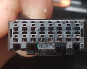

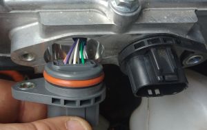

Inverter Resolver & Can Connector
The original Connectors:
1x Resolver/Motor Temperature sensor interface [Hirose GT18WB-14DP-HU - 14 way proprietary connector[4][5]] - Black
1x 12V Power/CAN Bus Interface [Hirose GT18WB-14P-HU - 14 way proprietary connector] - Grey
These connectors are unobtainable however Tom DeBree has created a 3d printable connector that utilises TE Pins and Dupont style connector:
https://openinverter.org/forum/viewtopic.php?t=682&start=75
It must be noted Chinese Dupont connectors are not good for much more than testing as they are not a good Fit.
It is recommended to use original motor to inverter cable for an easy life, however if you need to make up a cable or are splicing into the cable due to damaged socket etc, it is important to note that the motor will spin backwards if it runs forward or has a noticeable judder when trying to set off under load (see https://www.youtube.com/watch?v=6fq3Y90fYY8) it is very likely that the polarity of the resolver pairs maybe incorrect. (additional note: increasing "throtramp" in zombie can introduce a judder at low rpms).

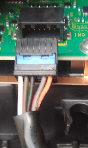

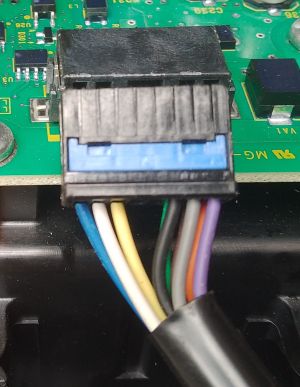

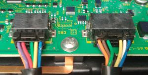

OEM Inverter OI modification
Inverter Phase Connections
Based on information within the Service diagrams [14] the following HV phase connections have been identified on the inverter.
