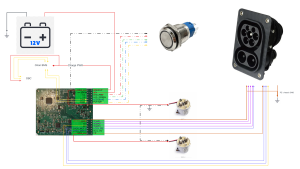

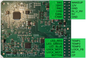

Pin description
External connector ("Deutsch Header")
Starting version 4.5b the pins were reshuffled to allow one wiring loom going to the charge port and one to the car side. Changed pins are bold.
Short name Pin up to 4.5a Pin from 4.5b Description
TEMP1 A1 A1 Power pin temperature sensor. It is pulled up to 3.3V with 10k and the sensor must pull down to GND. Sensor characteristics are configurable in software
TEMP2 A2 A2 As above
TEMP3 A3 A3 As Above
LOCKFB A4 A4 Feedback signal from connector lock. Pulled up to 3.3V with 10k, so feedback must pull down to GND. Thresholds configurable in software
IN_U_HV A5 B10 Analog input 0 to 5V, with pull-down-resistor. Can be used to measure the charge port voltage, using a converter board, e.g. the "muehlpower board"
CP A6 A6 CP (Control Pilot) pin from charge port
SW2(_LS) A7 B4 Output for charge port contactor 2. Low side switch until Foccci 4.4, high side switch starting 4.5
Controls one of the contactors to make the connection between the HV battery and the vehicle inlet.
The output can drive inductive load without additional circuits. It will clamp the turn-off voltage to ~40V. The driver has protection against shortcut and thermal overload.
The output can be configured to be just digital on/off, and can also be configured to use PWM. BUT: In Foccci versions 4.2 and 4.3 (maybe more) the output driver is only capable of slow PWM, which is hearable and may cause trouble with the contactors. So it is recommended to NOT use the PWM feature, and instead use contactors which do not require economizing or use external economizers. In case you want the PWM nevertheless, you need a external freewheeling diode.
Starting Foccci 4.5 PWM is working as intended at 18 kHz. It is a high side output starting v4.5, so the other side of the contactor must be connected to GND. Before v4.5 it is a low side output so the other side must be connected to 12V
LOCK_MOT2 A8 A8 Motor driver output for charge port lock servo
LOCK_MOT1 A9 A9
PP A10 A5 PP (Proximity Pilot) pin from charge port. If you want Foccci to wake up when an unpowered charge cord is plugged in you must close JP3 to pin 1 (towards R7). There mustn't be a pull-down resistor in the charge port in this case as that would permanently keep Foccci awake
5V A11 B11 5V, 500mA e.g. for supplying voltage sense board. This is an OUTPUT of Foccci. Do not apply an external voltage source here. Foccci contains a step-down-converter from the 12V supply to this 5V output.
GND A12 B12
CANH B1 B1 CAN communication
CANL B2 B2
n.c. B3 Unused pins were assigned GND in 4.5b
n.c. B4
GND B5 B5, B3
SW1(_LS) B6 B6 Output for the charge port contactor 1. See description of SW2(_LS).
WAKEUP B7 B7 Wakeup bus. Momentarily (or constantly) applying 12V wakes up the board. In the other direction Foccci can wake up (or supply with up to 1A) other devices via a 12V high side switch
12V B8 B8 Supply voltage, always on. 9 to 24V are fine.
LED_RED B9 A12 Status LEDs
LED_GREEN B10 A11
LED_BLUE B11 A10
BUTTON B12 A7 Wakes up Foccci or stops an ongoing charging session

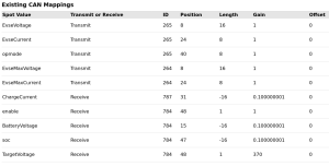

Basic communication considerations
Foccci can be configured to run at various baud rates and defaults to 500k. The Wifi interface mentioned below is hard coded to 500k. So when configuring a different baud rate you will loose communication with the Wifi interface. This might be fixed in the future by allowing variable baud rates for the wifi interface. Bottom line: keep it at 500k.
Apart from that it is mostly sufficient if Foccci can communicate, or more precisely, listen to the BMS. Foccci uses the flexible CAN mapping known from other OI firmware. There are 5 key parameters that need to be received via CAN:
  • ChargeCurrent: this is the single most important item. It is directly relayed to the charger and specifies the current the battery can accept at the given moment. This depends on battery voltage, temperature and other things to be determined by the BMS. Foccci itself does no battery monitoring of any kind, it is completely down to the BMS to specify a safe charge current. When this value is not updated for more than 2 seconds the charging session is terminated.
  • BatteryVoltage: this item is important for precharging the CCS chargers output to the momentary battery voltage. Most BMSes output the total pack voltage in a CAN message
  • TargetVoltage: In theory this is the maximum voltage you want the battery to be charged to. In practise the maximum battery voltage MUST be governed by specifying an appropriate ChargeCurrent. More importantly many chargers cut back charge power when approaching this voltage resulting in poor charging performance towards the top end. So in practise you want to set this to a voltage about 10V above charge end voltage of your battery.
  • soc: This is purely informative as far as we know. It displays the batteries state of charge on the chargers display
  • enable: this is optional as it defaults to always enabled. It can be used to completely terminate the charging session by setting it to 0.

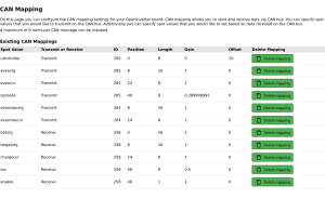

Configuring Foccci via CAN
Foccci exposes only one single CAN interface for vehicle communication and initial configuration. So we need a CAN counterpart to talk to it.
There are two main approaches to this: a) use a command line tool [2] or b) use an ESP based CAN module [3]
Both ways require knowing Focccis so called Node Id (similar to an IP address on a local network). By default this is 22. You can enter this node id on the bottom left navigation bar.

Making Foccci talk CHAdeMO on the CAN side
A pretty straightforward way to integrate CCS charging into your vehicle is to use the existing CHAdeMO (let's call it CDM from here on) CAN messaging. CDM has pretty much all data items we need to initiate a CCS charging session, so rather than defining a new set of messages we might as well adopt it. For example, Orion BMS or Zombieverter VCU natively support CHAdeMO anyway.
Screenshot of CAN mapping to interface Foccci CCS with CHAdeMO
Let's go over the items in the screenshot one by one. Note that the IDs are decimal! (256=0x100, 258=0x102, 264=0x108, 265=0x109)
  • UdcDivider - Actually, here we just select some dummy item as the important bit is in the Offset field: the version. In this case I signal non-existent CDM version 10. This tells the CDM module in my car that it talks to Foccci. It then includes the battery voltage in some unused message bytes - see below.
  • EvseVoltage - Transmits the charger's present output voltage back to the vehicle.
  • EvseCurrent - Transmits the charger's present output current back to the vehicle.
  • opmode - Observe the weird gain - this is forged to map Foccci state "CurrentDemand (13)" to CDM state "ConnectorLocked (4)". In my car's CDM module this is sufficient to initiate the charging progress. You may need to change it so that the ChargeEnable flag together with ConnectorLocked is forged (numerical value 5).
  • EvseMaxVoltage - Transmits the EVSE's maximum output voltage back to the vehicle.
  • EvseMaxCurrent - Transmits the EVSE's maximum output current back to the vehicle.
  • BatteryVoltage - Transmits the present battery voltage to the EVSE. This is the special item that normally doesn't exist in CDM and that unfortunately will prevent you from using this solution with an OEM car in a safe manner. Of course, you could manually set this to some medium battery voltage like 360V, but if you arrive with a really low battery at, say, 300V this might weld your charge port contactors. You could also manually enter the battery voltage before each charging session.
  • TargetVoltage - Transmits the charge end voltage to the EVSE.
  • ChargeCurrent - By far the most important data item: the charge current request.
  • soc - In CDM this isn't normally a percentage value but some encoded kWh value. In my car's CDM module I specify a full battery as "200" (no idea what this actually means in kWh) and thereby can just output the SoC in 0.5% steps.
  • enable - The car's charge enable flag. When 0 will stop the CCS session.
As an additional safety measure you could connect CDM pin 4 (charge enable) to Foccci's button input (at least once we added an active low mode for it). It might also be worthwhile to connect pin 7 (connection check) to the PP input for drive away protection when CDM is plugged in but not charging (again, once we have actually implemented this).

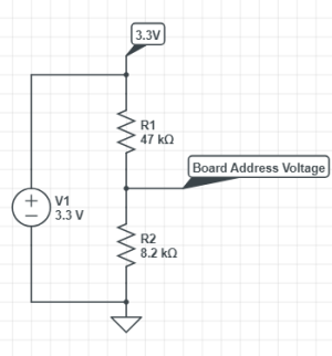

Hardware detection
To allow software to reliably detect which version hardware it runs on, in HW version 4.1 a version indication resistor was added. As opposed to some other boards that run at 5.3V, the voltage here is 3.3V.
Variant R1 R2 voltage ADC -3% +3%
- 47 2,7 0,179 222 216 229
- 47 3,3 0,217 269 261 277
- 47 3,9 0,253 314 304 323
- 47 4,7 0,300 372 361 383
- 47 5,1 0,323 401 389 413
- 47 5,6 0,351 436 423 449
- 47 6,8 0,417 518 502 533
- 47 7,5 0,454 564 547 580
4.0 with economizer 47 8,2 0,490 608 590 627
- 47 9,1 0,535 664 644 684
4.2 47 10 0,579 718 697 740
4.3 47 12 0,671 833 808 858
4.4 47 15 0,798 991 961 1020
4.5 47 18 0,914 1134 1100 1168
47 22 1,052 1306 1266 1345
47 27 1,204 1494 1449 1539
47 33 1,361 1689 1639 1740
47 39 1,497 1857 1801 1913
47 47 1,650 2048 1986 2109
47 56 1,794 2226 2160 2293
