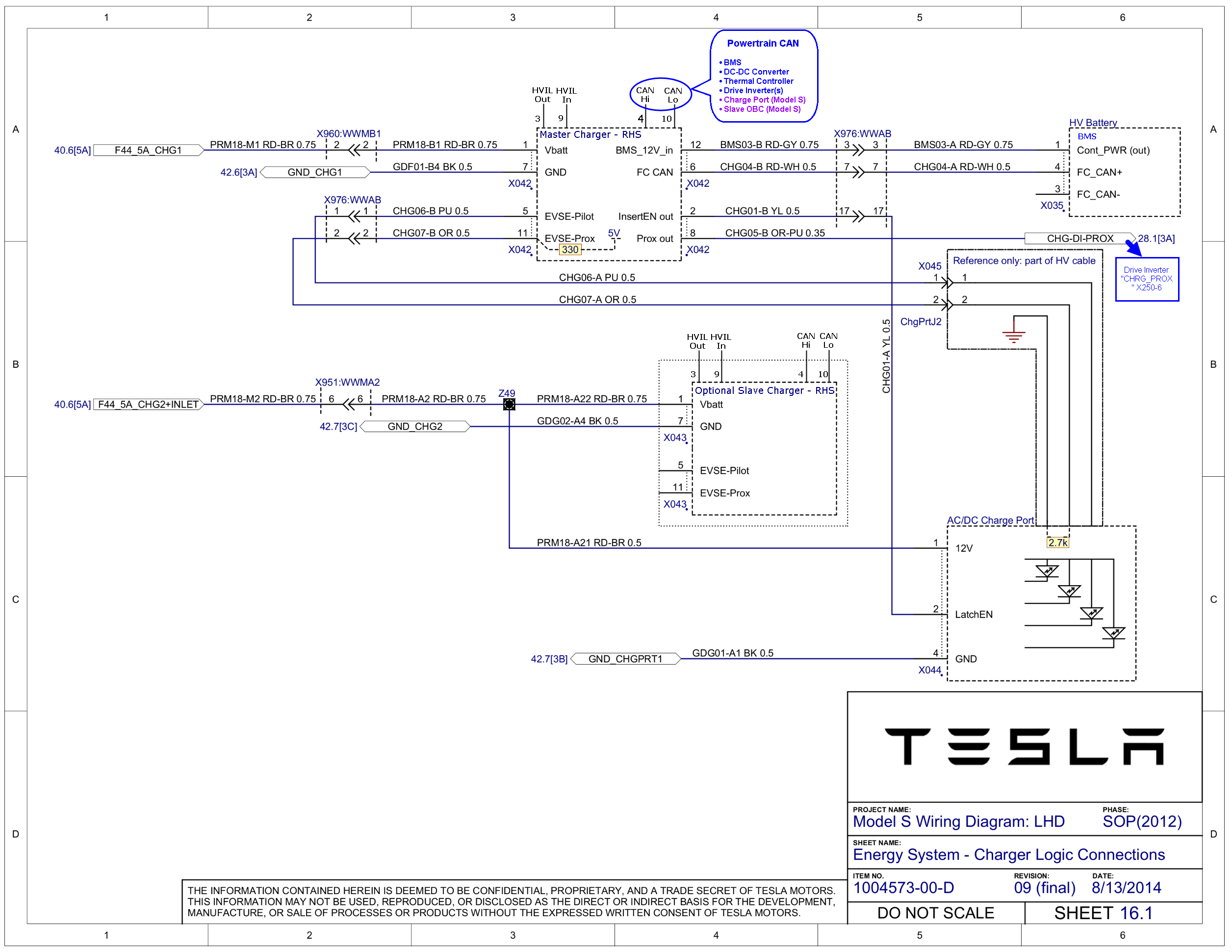

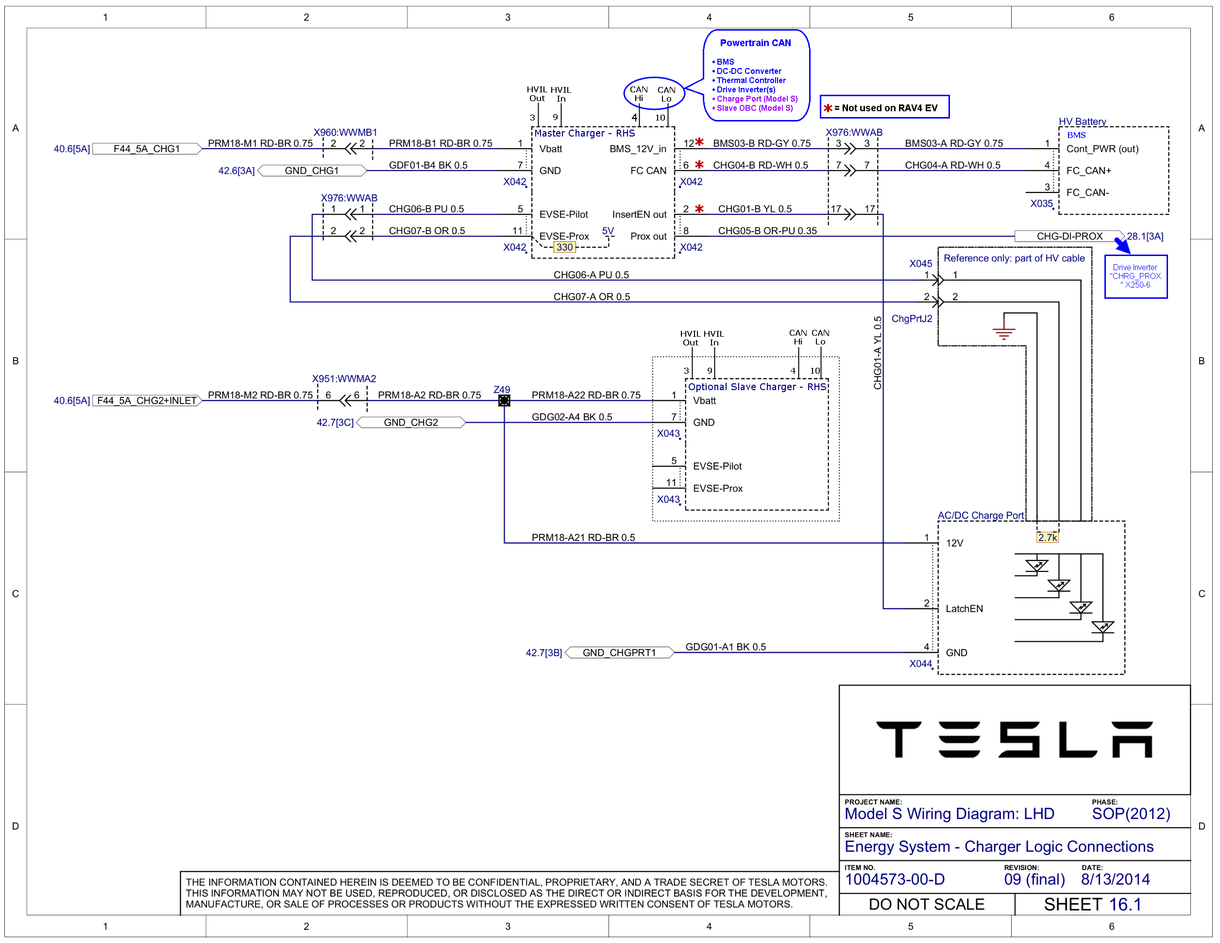

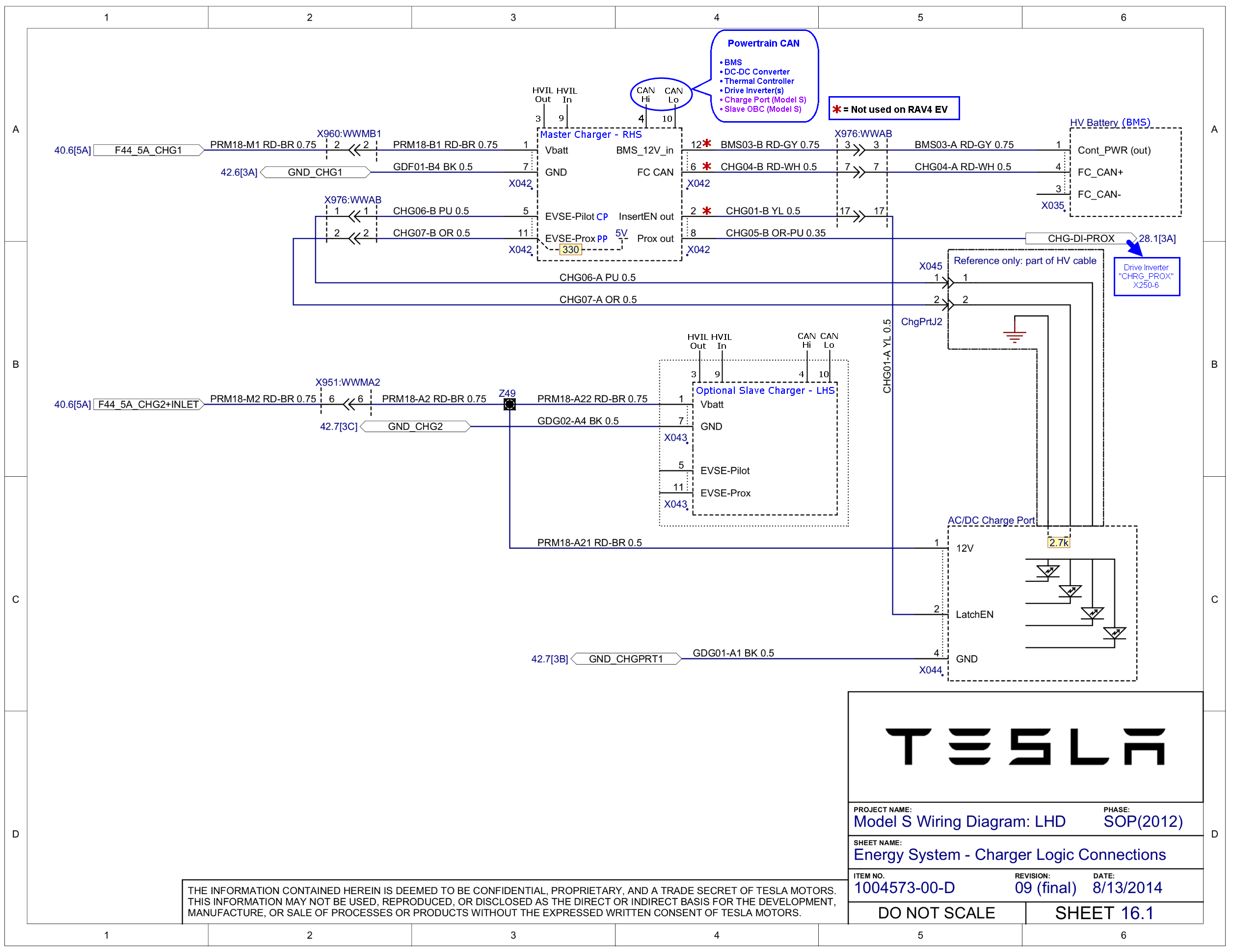

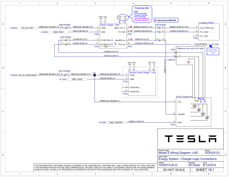

Tesla Model S GEN1 OBC Logic Connector X042 Wiring. Tesla wiring diagrams do not define all circuits for a connector. This diagram has been amended to include circuits from other pages, to completely describe X042.
current22:52, 30 January 2024Thumbnail for version as of 22:52, 30 January 20242,512 × 1,941 (502 KB)Asavage (talk | contribs)Added "CP", "PP" to Charge Inlet .
22:35, 30 January 2024Thumbnail for version as of 22:35, 30 January 20242,512 × 1,941 (502 KB)Asavage (talk | contribs)Added "CP", "PP"; correct "RHS" for Slave OBC; changed location & font of "BMS"; resized text box for "CHRG_PROX".
17:03, 10 April 2023Thumbnail for version as of 17:03, 10 April 20232,512 × 1,941 (501 KB)Asavage (talk | contribs)Added annotations regarding OBC Logic Connector pins not used on RAV4 EV installations.
